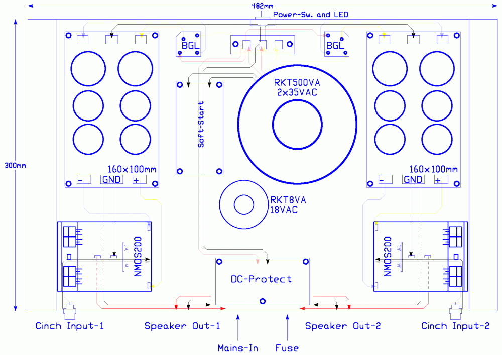

Hello again,
I am just sitting on the internal layout of the amp.
what you can see on the picture is just a brief idea, not very concrete.
It does not show the mains-wirering (would be to messy to schow every single wire), the primary (mains) wires are going to be routed from under the dc-protection board to the soft-start unit and from beyond that board to the mains switch and back.
For the soft-start unit and the dc-Protection I use my own Layouts, but they are very similar, just a bit more to my needs. Thats why I need the secondary AC voltage from the main transformer.
I still beleive there is a better solution. I.e. If I cut the Dc-Protection in two parts, then things would be mouch easier. But thats impossible.
Any Ideas, comments?

Black,
The layout looks great with one exception. I would try to see if you can change the input path so it does not pass across the power devices. The current wiring path of the inputs presents a possibility for induced noise/signal feedback into the input.
I know you said you cannot split the DC protection in two and that it has some features you like. Could you not elevate the DC Protection in the case and then move the input a bit to the inner part of the rear to run the input leads to the amp modules without crossing over the amp board? Then you could run the module output and the DC Protection output high until they are at the outer area where the input used to be?
I assume you are not using the quasi DC Protection?

I think the layout looks fine Black. With respect to the input leads, I think you have sufficient distance from noisy bits. Just avoid any parallel paths with AC or high current connections. The only thing I would do is swap the position of the slow turn-on PCB with the small transformer, but that's personal preference only and will allow more mains wiring to pass under the board (might look neater.

Thank's alot for Input!
Hello,
Your input is much appreciated.
First thing I'll do is to make the PSU-Boards a bit smaller, i.e. to 80 or even 70 x 160 depending on the capacitors.
This was also my first thought. At first I had both RCA jacks nearly on the same hight as the input pads on the NMOS boards, but after a few hours I decided that the jacks are too close to the mains-wires and to close to the Output leads (You know coupling output to input makes the amp instable).
The main probem of this drawing is, thats its only 2-dimensional. In reality I will give the input wires some distance to the board, so they won't lie on the (probably hot) power-devices.
Well, my dc-protection is very similar. First the highpass, then the 3 transistor-arrangement, then a current-source for the relays with BD679/681. The relay coils are wired in series. The hole unit is powered by the main transformer, having the profit of a switch-on delay time of about 5 to 10 seconds. The two 24V relays allow DC rails from 32V to over 60VDC, the use of an external DC- PSU (as Quasi does) is possible.
->"ZMP" is the centertap of the PT.
The Layout:
Ok, good idea. But I need this Board to be near to the primary wires of the big transformer.
As you can see:
The jacks on the board for the Transformer primaries are on the front side (if you look at the drawing of my internal layout), and the AC input for the small transformer are at the rear.
Actually the soft-start Unit is the same as Quasis, with a different relay-type/pinout, LED-out and added Relay to switch the Main transformer.
I already had a fitting switch by hand, but its current-rating was too weak for the 500VA PT, as relays are much cheaper than good quality switches, i decided to go for this (more flexible) solution. Still, if you like to switch both transoformers with one main switch, its easy to place a jumper over the relay-contacts.
I also included the 24V Output. But schamefully a cannot use it for my dc-protection, as I already ordered two 24V relays (as they are connected in series this wont work). I dont want to buy new relays.
Maybe i am way too careful (and mad?) about the internal layout, but ive desinged tube-amp layouts in the past and these are very sensitve soncerning the internal layout and the leaddress (high source impedance, ac heaters, no shielded cables ect.).
I just want to get the best possible performance for
for Quasis great design!
Greetings
Black
