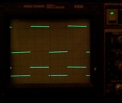

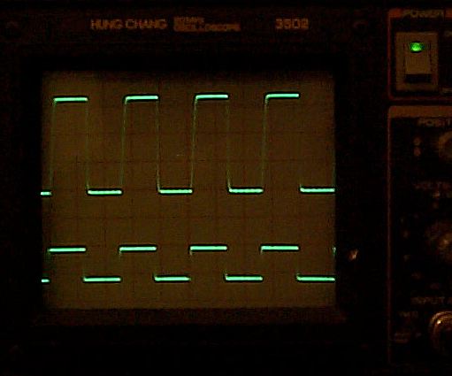

Have you any detailed pic of square wave ( 10 kHz ) into eight Ohm ? Or eight Ohm with parallel 100 n cap ? 3 dB bellow clipping ?
Hey Upupa Epops;
Piccy of square wave response at 1khz into 8 ohm resistive load taken at near rail to rail swing.
Cheers

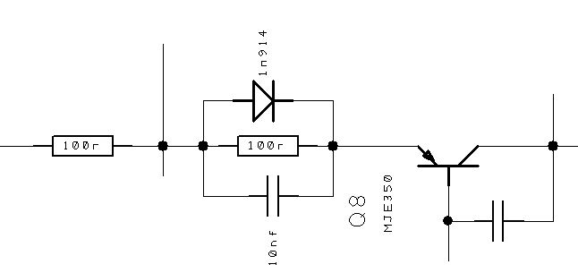

The other thought I had was this network on Q8's collector. I have just tried it and it seems to make the clipping more symmetrical within a volt or so. My theory was to add 4 volts between Q8 and the output.
Hmm....I don't like it though. :dodgy:
There wouldn't be any point making the output device run off a higher rail. The problem arises because you can't even get near to saturation with the upper rail, but you can pretty much fully saturate the lower rail.
Your additional circuit aids linearity, it's a good addition. Get rid of the diode and you will probably see an improvement. The capacitor used should attempt to mirror the upper output device Ciss. The diode is only any real use when using BJTs.
I don't understand your comment about adding voltage between Q8 and output. However, hopefully now you understand that the problem lies in the upper rail and that preventing the lower rail from saturating is a bad way to go.
