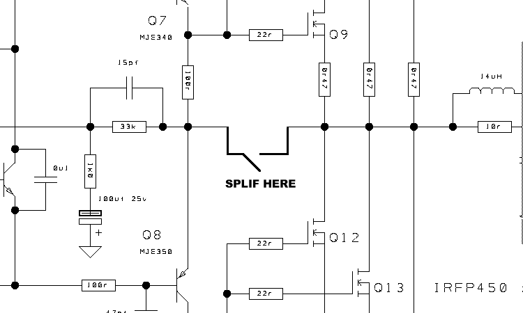

I just happened to come across 'The ALTMANN "SPLIF" Amplifier Topology"
<http://www.altmann.haan.de/splif_page/>
again while searching for something elese on internet.
The actual execution of this seems farily simple for your amp design I sense. I am not sure as I am not an "expert". If I understand the implementation of SPLIF and your amp design the SPLIF occurs in the area of Q7, Q8, Q9 and Q12 as per the attached schematic section I have edited to show (to save complicated and excessive words 😉 )
If you try it while remaining aware of points related to bias and offset as the information explains it woudl be interesting to know if you feel ther eis some value to this SPLIF idea. Seems in theory to make sense.

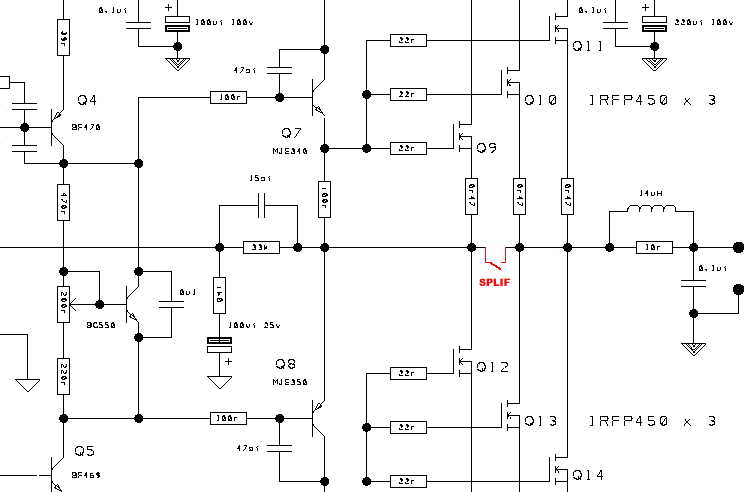

Re SPLIF;
It's a coincidence. This is something that I tried just two days ago. This forces that stage to self centre rather than reference to the output.
I am going to re-visit this option after I finish the amp.
There are other possibilities here also e.g. the swith could be replaced with a resistor and another to ground to provide localised feedback for that stage. This is something else that I plan to try.
But I have spent enough time trying different things, it is now time to finish.

Re: To SPLIF or not to SPLIF ... that is the question
I think, there is wrong slpit place is shown. First mosfet pair MUST be in
feedback loop. Splitting must be done between the first and the rest mosfet
pairs.
Just my mind.
Do not splif anything before your or my version will be proved by
gurus 🙂
Andrew

Re[05]: To SPLIF or not to SPLIF ... that is the question
Hi Andrew,
My appologies, youare absolutely correct my Post #121
<http://www.diyaudio.com/forums/showthread.php?postid=534292#post534292>
schematic segment to show the SPLIF location was incorectly placed. My appologies gents. I have posted with this message the corrected SPLIF.
In adding a SPLIF the way I have done to the existing amp design of quasi will need add another output driver pair to restore the intended power design handling of the amp. I did not add an extra output device pair to this schematic example of quasi's amp design as I do not have the software or design file.

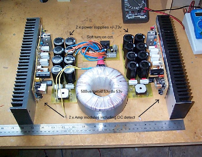

Final Schematic;
This is the final schematic of the amp module. Two modules have been built and it is time to assemble the complete amp.
The major changes to the design are;
1. The split supplies have been removed and common rails feed the whole amp.
2. The cascode transistors have been removed from the input stage and replaced with a current mirror (Q4 & Q5). This change has been made to ensure symetrical current flows through Q2 & Q3.
3. Removing the cascode stage has required high voltage transistors for Q2 & Q3. I have settled on 2SC1845. These are low noise transistors with Vce of 120 volts.
4. Some resistor and capacitor values have been changed to try and achieve a balance of noise, distortion and thermal peformance.
There are other improvements that can be made to this schematic and these will be implemented at another time. But this is the schematic that will be put to service in the completed amplifier.
Many forum contributors will see their suggestions in this schematic and to you I say thankyou.
Cheers

Thanks hienrich, demogorgon & rajeev;
Thanks heaps for your compliments. This has taken a long time but it's getting closer to the end.
When it is finished I will post all the ccts and layouts for anyone who is interested.
During this exercise I have found areas that can be improved but the board layouts don't allow this easily. Even so the amp as it is performs very well, is very quiet and clean.
I will attempt some specifications when the case is finished and all the components are fixed.
The best part about this amp is that it has been built using mostly second hand parts found in junked electronics (power supplies etc.) or parts recycled from other projects. To date the whole project has cost under $100 AUS ($75US) and I have everything I need for the case.
Thanks once again for your kind thoughts.
Cheers & Happy New Year🙂
