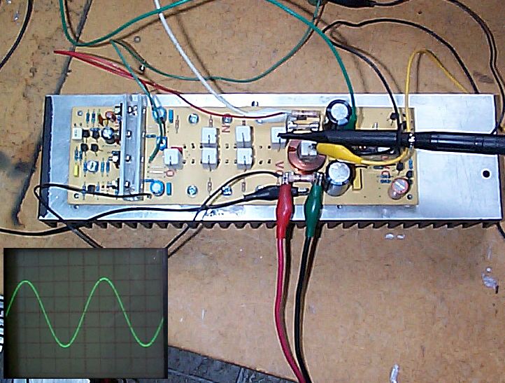

It works !!!
IT WORKS! ...Whoooohooo!
It works.
CRO shows a 10 Khz waveform into an 8 ohm resistive load at 86 volts pk to pk (around 110 watts).
Now I'll make another one for the other channel.
Still to come is the power supply, soft turn on cct, and a case. In the final configuration it will deliver 200 watts into 8 ohms and about 350 watts into 4 ohms.
But hey IT WORKS !

Thanks;
Thanks Upupa Epops & Rajeev Luthra
I feel more relief than anything.
Have you any detailed pic of square wave ( 10 kHz ) into eight Ohm ? Or eight Ohm with parallel 100 n cap ? 3 dB bellow clipping ?
I will do these tests when I finish the planned power supply. The test was done using my bench supply and it's only good for about 100 watts. If I do demanding tests with this power supply I know I will get poor results.
So I have to wait until the new power supply is built.
Thanks & Cheers

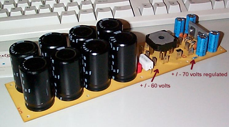

Only sine waves have passed through the amp module at this stage. There are some small changes that I have to make to it and the power supply.
I tried to make a simple transistor regulator for the +/- 70 volt rails but the cct's performance is unsatisfactory. I'm going to use 3 terminal regulators now and these boards are being made tonight.
I think it will still be 2 weeks or so before it plays any music.
You are most welcome to build this amp. When the amp is completed and I am happy with everything then I will post all the ccts and layouts for anyone who is interested.
