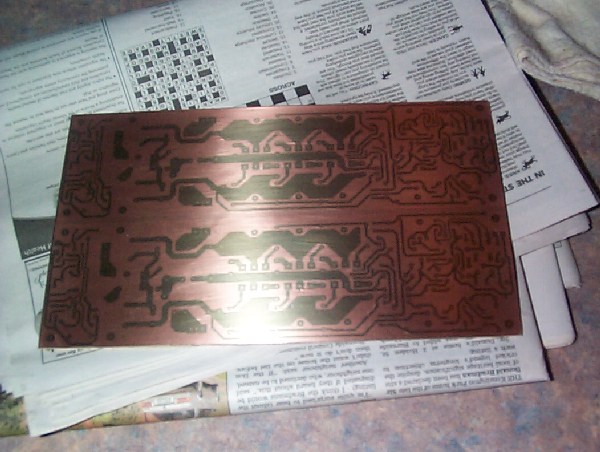

Power amp under development

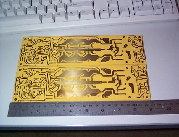

Image exposed & developed
Ok the exposed board is developed in a caustic soda solution and looks something like this. Time for a nasty bath.

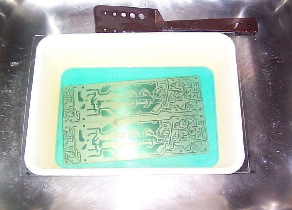

Re: Ferric chloride
Yes, I used to use ferric cholride and other stuff too.
I like using the nitric because it's clear and quite re-usable. The solution shown in the photo is 2 generations old. I.e. it has already been used to make a couple of large boards.
It is also cheaper to buy (around here anyway) then ferric.
Finally with the nitric, when the bubble stop the boards done.
But while it's clean, it does need to be handled with care.
Cheers

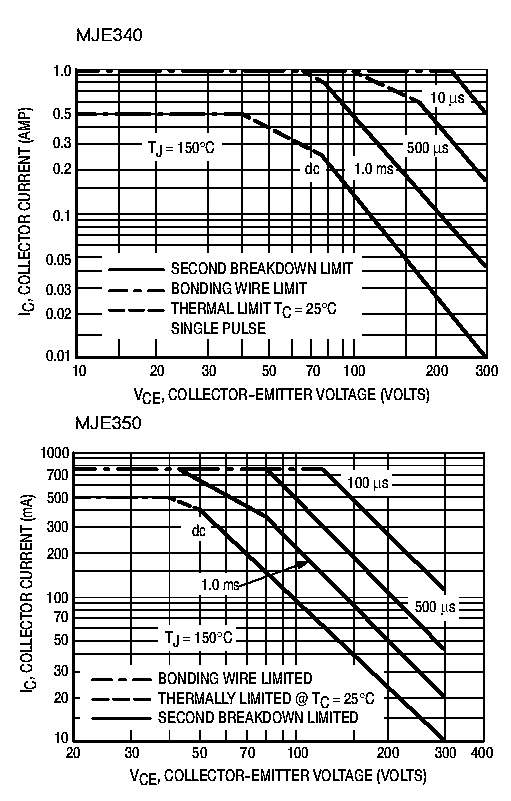

Well i think ur driver transistors emmiter and collector resistors is too low in value. As the Safe operating area will be crossed and the trannies will be damaged. Try to inc. their value .
Regards
Workhorse Technologies.
SOAR for mje340/350
Worst case conditions are around 120 volts across each of these when the amp is swinging to full opposite rail (near clipping). This voltage and the max. current of around 70 mA for this stage occurs only for a very short time during this part of the waveform half-cycle.
Yes the DC SOAR for the mje350 is around 65mA at 120 volts, but the 1ms SOAR is for 155mA and this is more relevant during the output conditions described above.
If the amp had a bi-polar transistor output where the base current was dependant on the output load then yes they would die. But with FETS I am only charging the gate so the loading on this stage is more constant.
Anyway if I'm wrong I'll post the dead transistors.

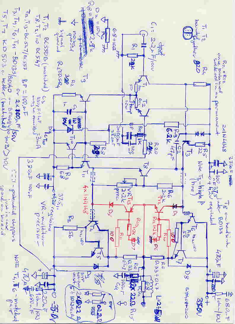

I have completely forgot but 25 years ago I designed a quasi-complementary PA from a scratch. It was my first amp I ever designed. I discovered that last weekend when looking through my old audio files. It is 50W into 8 ohms version with a pair of BJTs K503. These were made in Poland or Czechoslovakia and were somewhat better than 3055s. As far as I remember 8 amps were built all for active systems. Later modifications included current mirrors and cascode voltage stage. I still have notes of the calculations. Unregulated supply was +/- 35V nominal used for calculations.
I include the scan of the original sketch. Although it is history but someone may find it interesting as it looks that quasi amps become more popular.
Hey Janusz
Thanks very much for the drawings. Funny how not a lot changes after 25 years. I guess the fundamental design is always there. The circuit is very similar to mine the main difference being my 3rd stage where instead of a darlington output stage I have a voltage drive for the FETS.

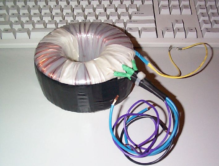

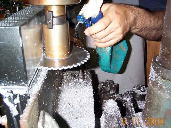

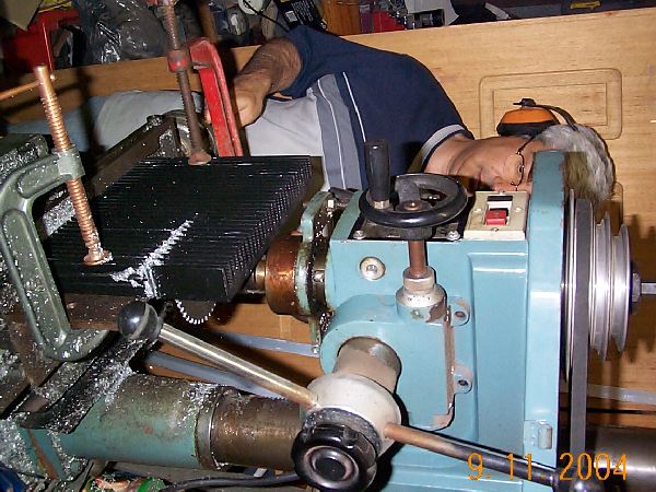

The amp works are going slowly. Tonight I just finished cutting heatsinks for the case and I am part way re-winding a 500va toroid transformer to achieve the voltages I require. This amp will be built as cheaply as possible using stuff I already have. So far I have not had to buy anything
Anyway here's a couple of piccies of heatsink cutting.
Cheers

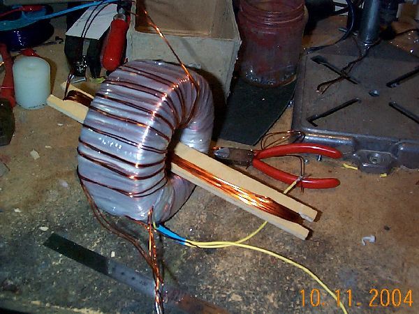

Is there a tidy way to rewind the secondaries of a toroid?
Some kind of slim bobbin to pass through the middle maybe?
I have only done a partial unwind and found the tangled mess ended in the bin. But ok since I was reducing the voltage.
regards Andrew T.
Tidy way of winding a toroid
Hey AndrewT;
A tidy way of winding a toroid?
Probably, but this doesn't apply to my efforts. Here is how I do it. I figure it don't matter as long as the wire is tight. Anyway no-one will know once the tape is replaced.
The winding going on in this pic is over another secondary I wound last night. See, once the tape is on it's hard to see the work quality anyway....
Ok everybody...let me have it!

Using Nitric Acid
Hey Rajeev
Nitric Acid is quite dangerous. If any gets on your skin you must wash it immediately.
I use a deep tub and I keep everything in there. That way if there is a spill it is contained. I also keep a bucket of water handy in case I need it. Nitric acid releases corrosive fumes while it's etching so it needs to be covered. The photo in this thread shows my etching container within a deep tub.
When I etch a board I use just enough acid to cover it by a few millimetres and then cover the etching container with a glass panel to contain the fumes. No agitation is required, in fact it works faster if left alone.
When the etching is finished I use plastic utensils to remove and rinse the board. Then I pour the acid (now a blue colour) back into a bottle to re-use later.
Then I rinse everything including the bottle of acid, all the utensils, etching container and the deep tub.
Sounds dangerous but like all things it is very safe if you are organised and take precautions.

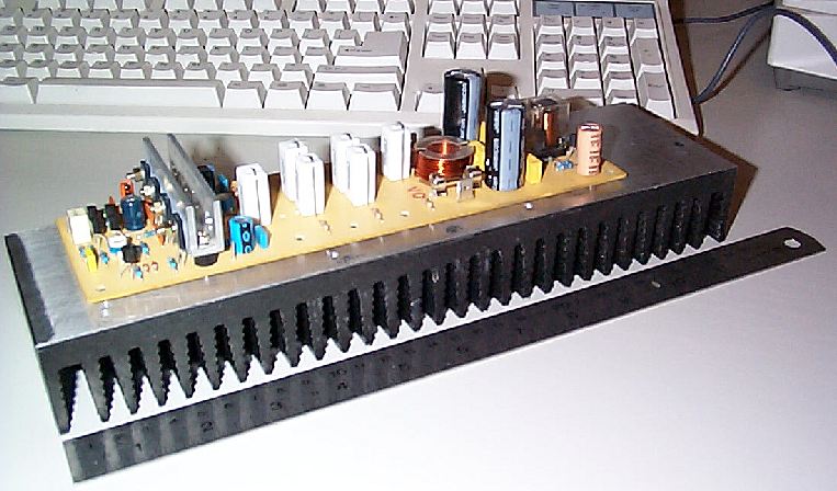

Anyway here is a photo of the half comleted amp module and it's heatsink (no FETS mounted yet).
