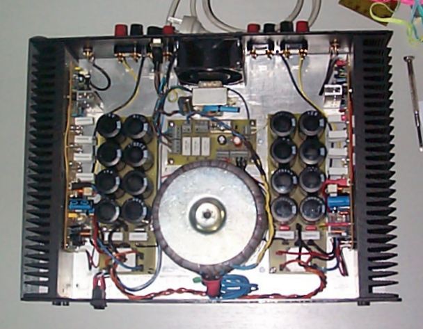

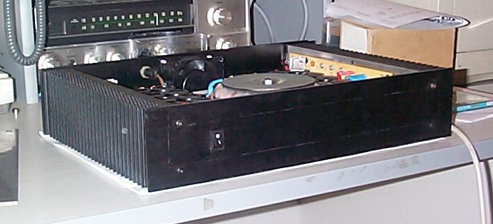

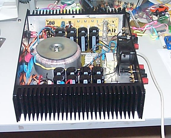

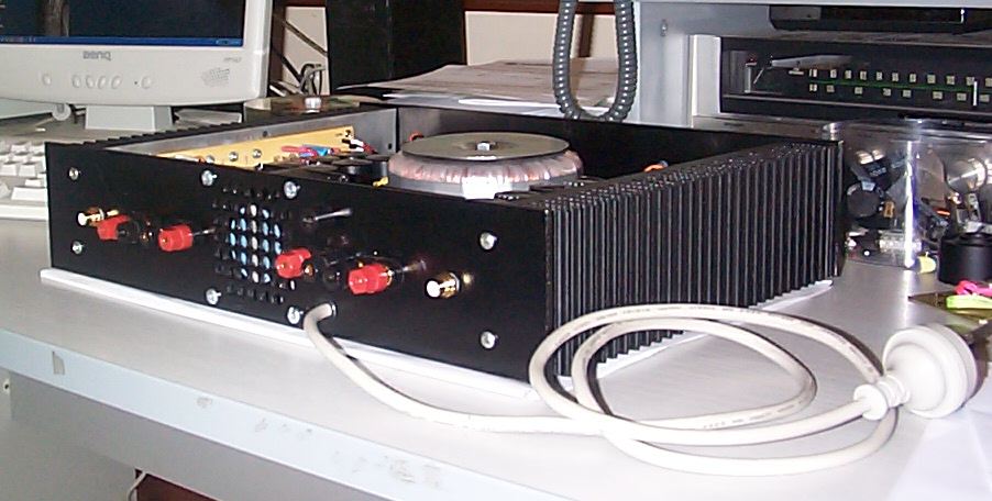

Finished at last.
Well after taking a lot longer than I thought this amp is finished at last.
The amp delivers 210 watts into 8 ohms and 360 watts into 4 ohms before the onset of clipping.
Here are some piccies of it. The pencil marks on the front panel will be removed tonight.
Thanks to all who have helped and commented along the way.
I will post final layouts and schematics over the next week or so.
Cheers

very-very-very nice work, my friend!
congratulations!!!
i've got a little question:
isn't the 500VA transformer undersized for a 2*360W amp?
the amplifier picks up 1000W power from the trafo when working fully to 4ohm. I think the trafo would be so hot in this case!

Hey Edl,
Of course you are right if the amp was asked to deliver 2 x 360 watts of sine wave for extended periods. This would cause the transformer to burn out. Music is nothing like sine wave fortunately and even at full output the transformer is probably only delivering an average of maybe 100 watts. I believe it's completely irrelevant testing an amp for continuous RMS power for more than say 15 seconds, because this is never required under any music condition.
The test I did was with one channel driven. With both channels driven the continous power output would be less. But again music is nothing like the test condition so the actual effective output is probably more than 360 watts. This could be called dynamic headroom I suppose.
Of course the above applies to a class A/B amplifier and not to a class A.
