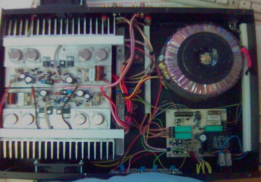

i finalllllly test my amp 🙂 ...
do u remember me ? i posted some photos of my incomplete amp , finally i got a chance to finish and test my amp this days , and i just turn it on for the first time , i test it for a few mins , and it s JUST GREAT ! ,
i ll test it completly and will post some photos as soon as i can ,
just wanna say , thanks a lotttttt quasiii 🙂
Pic of finished amp

Well done Ahmad, well done indeed. You are truly dedicated to DIY. I look forward to the photos.
kraft said:
I have build quasi amplifier with bipolar output. Amp is working very good about two months without any problems.:bigeyes:
What is the max +/-Vcc for four pices of MJ15024 per rail
Sorry for my bad english:xeye:
Another great effort Kraft. I am only halfway through this PCB and to see yours is great because now I will use some of your ideas. There are some things about your layout I would like to explore and develop, so maybe we should start a new thread.
Any thoughts from followers of this thread, moderators ?
Onsemi only publish a DC SOAR for the MJ15024 so I can only estimate it's 100mS SOAR which is more relevant for music signals. Even so the MJ15024 is quite a strong transistor and it's SOAR is similar to most transistors with this power rating (interestingly at 100v an MJ15003 is stronger).
With 4 devices per rail (8 per amp board) I would not go above +/- 75v for safe operation into a nominal 4 ohms impedance.
Cheers

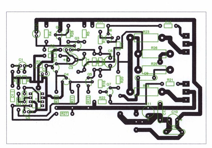

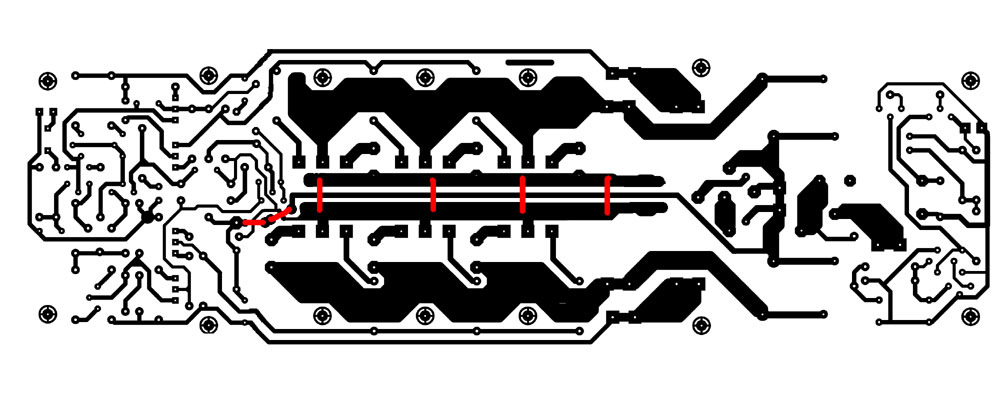

PCB return Wire
I was just loving to hate the wire under the PCB😉 Could the common trace be split in two forming an open center to hold the trail of what exists as a "wire" in the current board layout? I put this together in a second in photoshop so please excuse the roughness. Just wondering if the concept is acceptabe?
Shawn.
