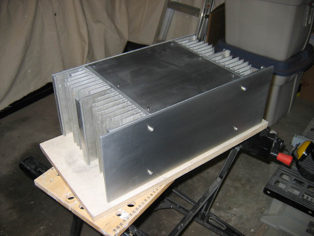

By the way Shawn, nice case.
Cheers
vicelord said:Hello again and sorry for duble posting
Post away and don't hold back, I don't 😉
quasi said:By the way Shawn, nice case.
You should see it tonight. I'm wiring it up
Shawn
