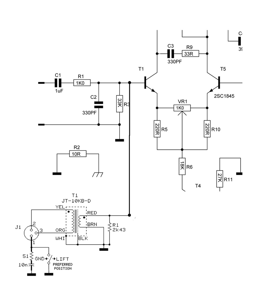

Balanced input for Quasi
I discovered Jensen Transformers in my search for parts to give my Quasi a balanced input. Then I read some of their schematics and I just added this on to the circuit. Can a balanced input be added this way? Or should it be done with an opamp? Or are there are other solutions?
I think RCA and Balanced is what I need because this amp ( like everything I make) may be used Pro or consumer.
Cheers, Shawn.
The Jesen transformer part # JT-10KB-D?
Cheers, Shawn.
Hi Tom,
I think you can do more to integrate the XLR and RCA inputs.
In particular you should still keep the two input filters for the XLR input signal.
Look further into the Jensen site and also at Rane. I am almost certain one or other show a dual input circuit.

Hi Shawn, do you have a good reason for using a balanced input?
I.e, long and noisy run?
Thanks AndrewT and Ilimzn for yur informative answers in my absence.
Cheers
Re: Re; Balanced input for Quasi
Yes, it is more than possible this amp will be used in Pro audio use. I'm going to take it everywhere I can; on the road, in the studio and at home. In fact, my system at home is mixed and I do have recording gear here as well. I'm involved in a lot of different audio activities 😉
If I had a choice of one interconnect, it would be balanced. So Quasi, I guess you may have some suggestions? Andrew, I will look further into the Jensen Site as they do have many input/output scenarios and I barely skimmed the surface over there.
Shawn.
quasi said:Hi Shawn, do you have a good reason for using a balanced input?
Shawn.
