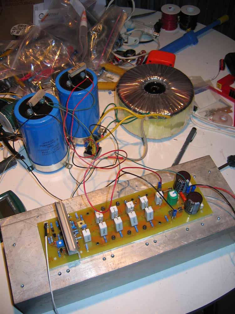

Module A Works
I have one of the modules fired up and it rocks! Its first thing that came out of it was the Dennis Hopper bit on Gorillaz Demon Days. But that was what was inside the Portable CD player.
Board B is next, then the case and on to some real listening. Observations right now; it is very loud and has a tremendous head room. The transformer and large heat sink are room temperature. I might put on a dummy load and blast it to hell. I have 4pcs of 5ohm 100watt wirewounds.

Shawn,
Excellent. I am sure you can hardly wait for the case to return back to put it all together.
Quick few quick questions:
1) How cool, warm, hot is the onboard heatsink for the drivers?
2) Many have made reference to how "loud" quasi's amp is. I understand what excellent dynamics means, but I have no clue what "loud" means in what I assume is the qualitive, or perhaps it is an objective qualitive, word.
3) What did you set your bias to?
4) What is the V rail while your amp is idle at the PCB MOSFETs?
John L. Males
Willowdale, Ontario
Canada
21 June 2006 01:37
[Q
originally posted by keypunch
1) How cool, warm, hot is the onboard heat sink for the drivers?
Warm, very warm but you can touch it. I'd guess the entire sink may have a couple watts of dissipation on it but I'm guessing.
2) Many have made reference to how "loud" quasi's amp is. I understand what excellent dynamics means, but I have no clue what "loud" means in what I assume is the qualitive, or perhaps it is an objective qualitive, word./B]
I have a sound level pressure meter and a frequency generator/counter to go with it to measure STC sound levels, I use this at work to measure my studio designs. I guess I could set it up at home but what is the point? I and my speakers could only stand so much and it would be a high dB but the amp would be taking a nap.This amp will deliver, more so it will deliver into a difficult and low resistance load=POWER...1KVA of transformer and and 20 IRFP450s has got to do something. The head room is endless as I do not have a speaker set up or a room large enough to unfurl this freaky beast. It needs a concert hall or a mad scientist Hi-Fi nutt with some crazy 1 ohm load speakers. Really I need to take it to a concert hall to unwind it into an array of speakers. It is just to much power...That is the reason why I chose it! I wanted the excess.
3) What did you set your bias to?/B]
I did not set it, I don't know how to set it and I can't find it in the thread for the 10 mosfet PCB? I'm affraid to set up some nasty tests 'cause it may not be ready yet.
4) What is the V rail while your amp is idle at the PCB MOSFETs?[ B]
I'm very dissipointed by the rail voltages as it meaures +/-56.2VDC. I was hoping for 62VDC as I estimated. It is not a great concern because the damn thing works so great but I may open my eyes to some 1KVA 60-0-60 toroids cause I think this circuit really needs it...to be be pushed that is. I would like to drive the ten mosfet board to it limits and then back it off a little and set up shop there...Who said that?...Tubelab (http://www.diyaudio.com/forums/member.php?s=&action=getinfo&userid=48762 ) . And well said as it is the way I think too.
But more so than all this is the sound. I hooked up a little studio monitor design I've ben working on since the 80's. I think I'm one step away from finallizing the design, well, I couldn't help myself, I hooked one of the monitors up to Quasi and voila, brilliance! The vifa tweeter was amazing and the stage was large but I need to finish the full amp before getting carried away. I think the Quasi could be like a giant Mark and Levinson with real balls. Or a Bryston without the uneccessary kindness. Make any sense?
I am a little disappointed by the previous builders of this amp on this thread. I think it is very likely each of them has used sub-par components to build, each at different points in the design. Because they should all come back screaming about the open sound stage and ENDLESS headroom. I made no such sacrifices and still I’m waiting for some “high-end” caps to use on the input.(early next week I’ll have them) so my sound is only going to get better.
More rigid guidelines may need to be given to builders to realize what the Quasi has intended.
No more about sound until it is in the case and running stereo. Back to soldering. John, is your solder iron plugged in or is it still in the blister pack? I'm bad! You can beat me up if you want to.
What's the set up?
Shawn.

The (- )screw terminal on the caps is a little corroded and I did not tighten them enough, so as it turns out I now have +/- 60.2 VDC from 44-0-44 AC. The bridge drops 1.1V on each junction. Part # is GBPC5010. All is good.
Sorry,
Shawn.
T, you rock, thanks.

VDC no Load
I removed the 2700ohm! 10Watt resistors bypassing each of the main caps and I read +/- 61.1VDC going into the amp module. I'm using these R's to discharge the main caps rapidly between handling. Perhaps not a good idea?

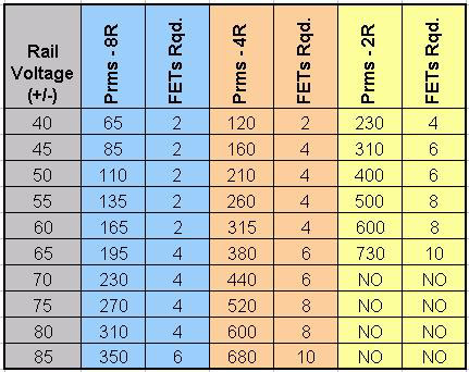

rolandong said:
hi tom,
sorry to butt in, how about 6 pairs of irfp450 ?
does that makes sense if i'm in for serious power and enough juice from ps ?
are the mje's capable ?
thanks
Talk to Quasi. He posted this table but I'm certain it is not written it stone. You will have issues with the current carrying capability of the traces on your circuit board etc. Many issues evolve fro high current applications. I'll step aside and the wizzards will advise. Does this mean you will out beat me on the Quasi amp! Jeeze, I can't stand for it, already I forsee bridged versions in mono blocks delivering over 1KW per channel but that is just me...
Shawn.
Look to Quasi's table for initial guide. Yes I believe this amp can do more but the PCB and drive circuity would need adjustment. Yes is the answer, I know it can deliver more.
