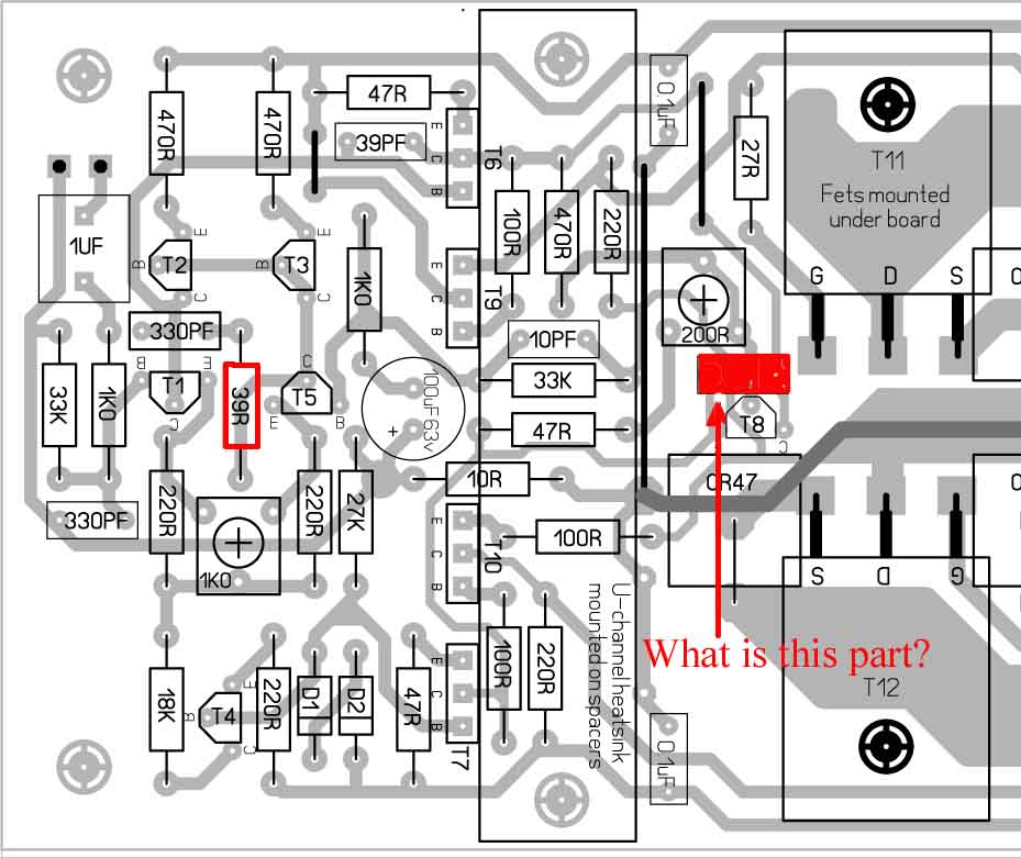

The mystery component is a 0.1 uF poly or MKT capacitor.
33 ohms is cool there and won't make any difference.
Mounting T8;
Using the PCB (or printed layout) as a template, I marked and drilled a hole directly below T8's location. The hole should be big enough for a snug fit. Then I inserted T8 into the PCB from below, made sure it was straight and had enough lead length for the transistor body to go in the hole and bent the leads above the PCB. That done I lifted the board soldered only the centre lead and repeated the procedure. Once I was happy with the line up I carefully lifted the board without moving the transistor and soldered the remaining two leads. Then I put some heat-transfer compound into the hole and remounted the board.
This link shows a picture of the end result.
http://www.diyaudio.com/forums/showthread.php?postid=800468#post800468

Mounting T8
That is crazy drilling a hole right in the heat sink! I love it. I have seen this done when servicing amps when I was a technician. Back reading I see someone used a different transistor and mounted it to the heat sink old school. What are your thoughts on this method and if it was the way to go what transistor would you use?
Also, is there any risk running the amp modules with out the heat sink to check and test before mounting them. I'm low priority over at the metal shop but his price is good so I should be patient. This will give me time to get the rest of it together. Can't wait
Shawn.
Sorry Shawn, can't run them at all without a heatsink. The FETs will heat up real fast and without the thermal feedback via the heatsink I givem about 10 seconds tops.
With respect to T8's mounting some constructors have gone for TO126 style transistors and mounted them with fly leads back to T8's location. A BD139 or similar is ok, just mount it close to the FETs and watch the pinouts.

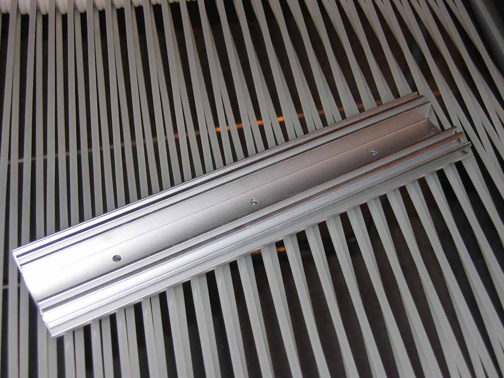

Very nice drivers heatsink. Is this a cut heatsink from one that had the fins on both sides?
Yes, see attached pic. I just cut them by hand with a hack saw and flipped them around the grinder for a minute or so. They are so light and with all four transistors bolted on, I don' think I'll worry about mounting it to the board. OMG Quasi will kill me :devilr: Perhaps some brackets just in case.

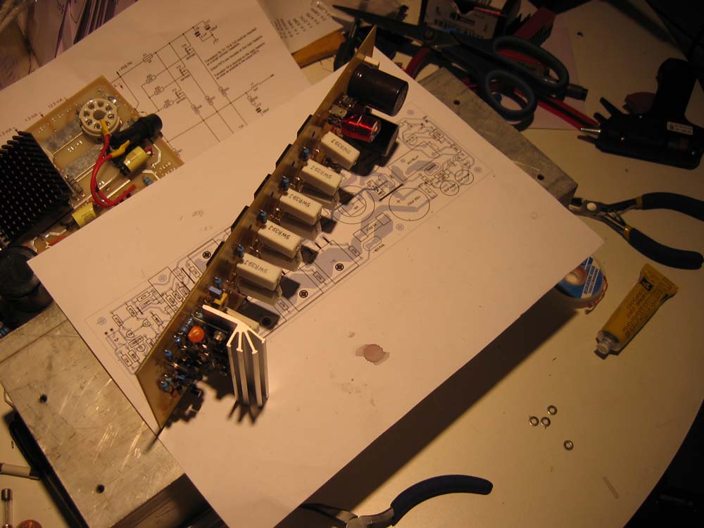

I will use the TO-126 with the mounting hole, easier for me and Quasi says it’s ok. Still, I love the hidden T8.
I hope your case returns soon so you can fire up your modules to setup/test and then listen to them. [/B]
Actually, I can’t wait. I purchased a tap and die set and I already mounted one of the boards to an extra slab of heat sink extrusion. It is good to get this practice in now because I snapped my first tap off in the hole! But I think I have a very good feel for it and I’ll be ready when the case comes through. I hope to have a set of boards tested and running ASAP

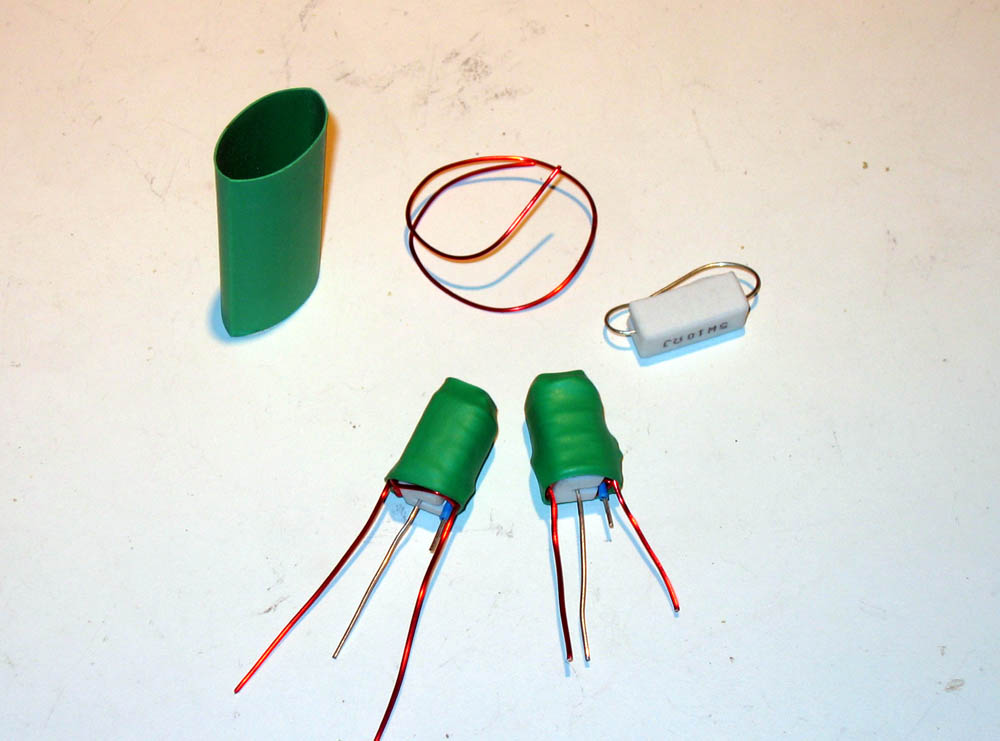

I made some better inductor/resistors today and wrapped them in 3/4" heatshrink and now they look bettern than the cat's XXX. The online java applet said 20AWG wrapped 20-21 times around 10mm core would give 4uH. Close enough, yes?
Shawn.

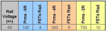

keypunch said:
I look forward to how your amp performs once you have it built. My calculations show with the 44V toroid you have, like me, power for 8 ohms will be anywhere from 120 - 170W, depending on losses which I have not been able to really estimate very well./B]
How about this? The work has already been done.
Shawn
Hi Shawn,
Thanks. I am aware of the table quasi made. I actually know the math behind the values to the table. The basic part of the math is fixed and repeatable. The various formulas I have to do the "same" calculation, result in different end power ratings. The reason for the wide difference of 120 - 170W is strickly a case of how much PSU rail loss there is. So on least rail loss side one has about 170W possible, but on low end with larger losses only about 120W for same 44V toroid.
For a 44V toroid rails would be at best 66.22VDC assuming no losses. The table suggests 195Wrms output indicating rail is 56.25 , ergo a loss of about 9V using the 65V rails. I think 9V rail loss is on very good side and likley to be more 12-13V loss for 8 ohom impedance. If you do the simple math approach, a 44V toroid would have rail net of 53.25 which translates into 37.65 Vrms = 177Wrms. These all assume a VA capacity that will not limit the voltage swing for the speaker/passive crossover load current demands.
I have created a set of spreadsheets using the different PSU calculations and embedded in it specs of various mosfets so I can see how many output devices for a given impedance I need for a given toroid with various loss voltages/factors while evaluating some of the other finer points of the mosfet device specs, such as combined Ciss.
Others can correct me if I am wrong, but the more output devices there are the larger the rail losses. One reason some like to build using only one pair of output devices, as well as no need for emitter resistors using one pair, is to keep rail losses to bare minimum. There are pros and cons sonic quality of using just one output device pair. Aside from the more parallel pairs adding to rail losses, the required emitter resistors add to the losses, in combination with bridge, filter capacitor and other PSU elements that vary with design or personal choices.
