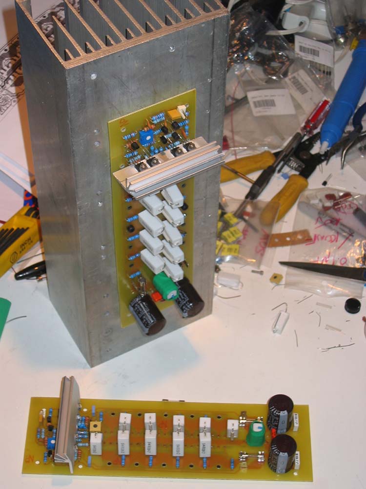

My gosh I love your heatsink *drooling*, I wish I could find such lovely heatsinks. Your modules look clean and well made both the compoents and PCB build. Excellent work Shawn. What T8 device did you choose?

My my Shawn that is a big main heatsink. Concerning the other one (the one that is supported by the transistors only!) how does it feel?
Anyway I go to some length to make sure the 10 FET board can be printed on an A4 page, and what do I discover? .....a mezzanine DC detect board?
Seriously your construction thus far looks good, let us know when you fire it up.

The driver heat sink is good and very light but I’m worried long term vibration and mechanical shock would jeopardize the solder points so I have reconsidered and mounting brackets are a must.quasi said:My my Shawn that is a big main heatsink. Concerning the other one (the one that is supported by the transistors only!) how does it feel?
And it breaks your heart There is a few reasons and luck too. I decided when reading the beginning of the thread to build the Quasi amp, then further in reading the 10fet amp came up but I already bought a few parts ie PCB boards. I use presensitized PCBs and the 12 inch boards cost a small fortune$$. The aluminum extrusions will be stacked side by side with the fins vertical for max convection. Two extrusions wide only measures 10-1/4 inches, that’s lucky.quasi said:Anyway I go to some length to make sure the 10 FET board can be printed on an A4 page, and what do I discover? .....a mezzanine DC detect board?[/B]
Thank you but I have a few questions first in a post to follow…quasi said:Seriously your construction thus far looks good, let us know when you fire it up. Cheers [/B]
I purchased 4 or 5 of those and it measures 3-1/2” by 5-1/16” by 14” long. The PCBs will be mounted perpendicular to the direction on the fins and the image is just a test set up. Also, in the same purchase there is a bunch of heat sinks of the same extrusion but the length is shorter at 9-1/4 inches long. I have 4 of the smaller ones.bigpanda said:Hi Shawn,

I was aware you would use an "external" T8, and it would be a TO-126 device. I was curious what you were going to use, as in a BD139, etc?
Have you fired up either of the modules yet? Even tried to play music through after the initial Vbe bias setup?
