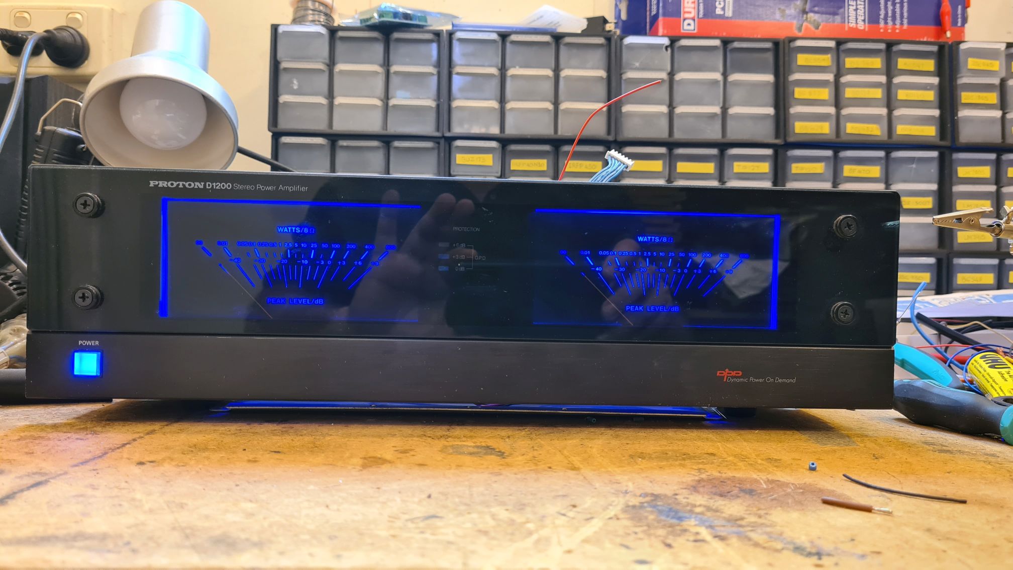

Anyway I have started a new project; A high power complementary design to refit an empty Proton D1200 chassis a friend of mine gave me. I hope to post some details soon.
Some photo's of my very slow progress below.

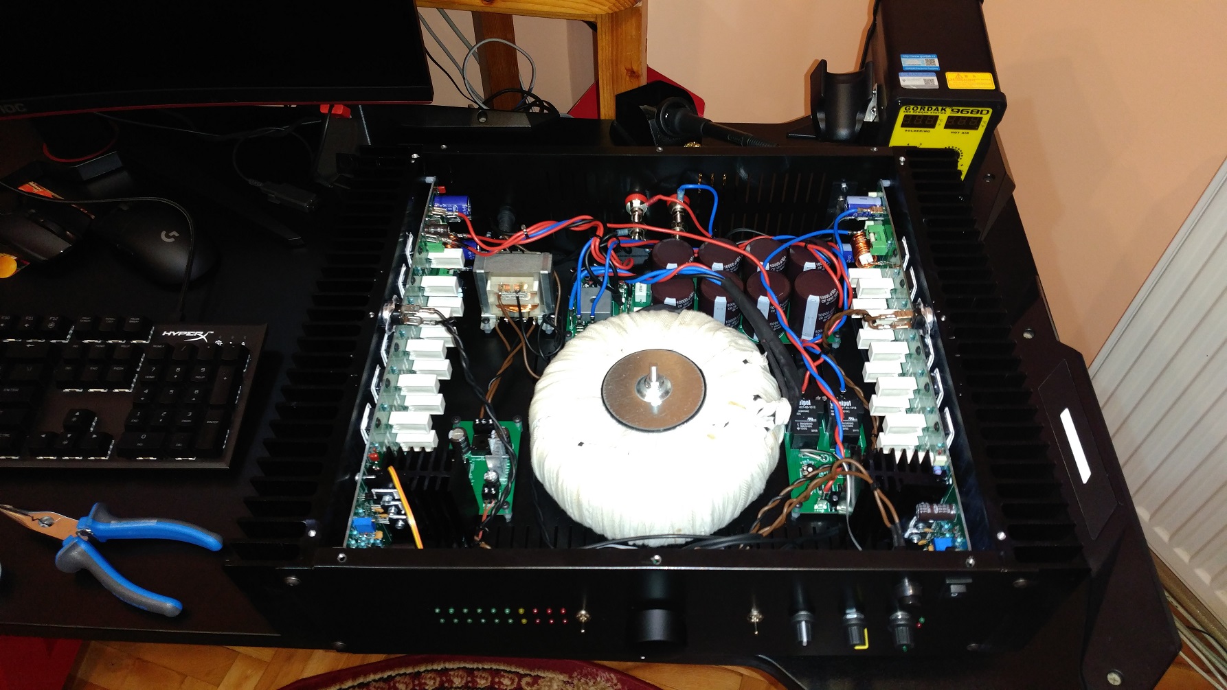

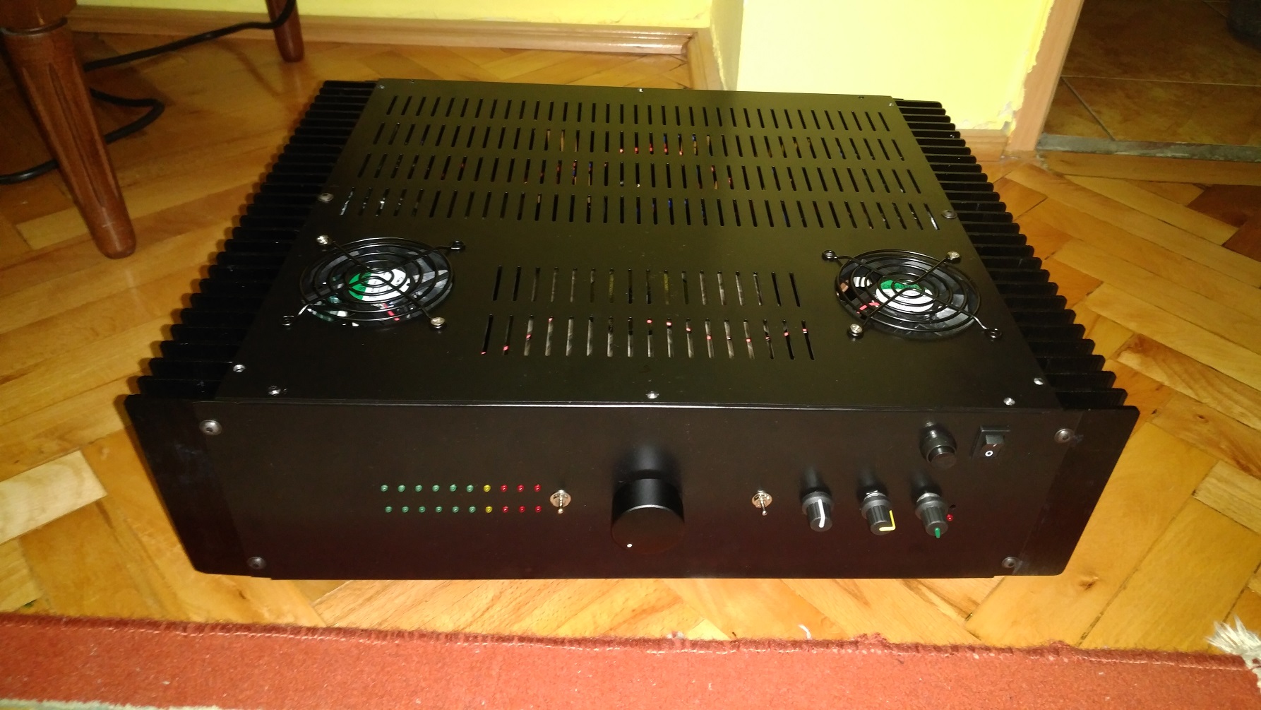

Thanks a lot for your appreciation. Indeed, the rail could be higher, but for now I use it with the trafo I have that is +/-76V plus 10V for command stage. Maybe in the future I will build a better transformer. For now I use two modules with a pair of t.box 252 eco mk2 (500W - 4 ohm) and it drives them very well.
