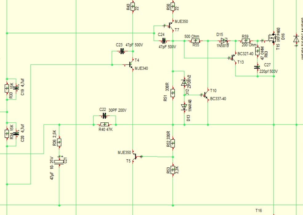

Hi FocusST225
Unfortunately with this type of failure it can be difficult to figure out what failed first. Did the faulty output take out the driver stage or did a faulty driver stage take out the output.
The good news is it cant get any worse. I would remove the faulty MOSFET (dont replace it yet) and replace R2. I would also replace C7 as it would have been stressed when output stage failed. Insert the setup resistors in place of the fuses - and run through the setup procedure. If everything is fine then you should be able to complete the setup procedure. You can run through the setup procedure without the MOSFET replaced. If you can't or if the setup resistors fail then we progress back into the amp.
Personally my next step would be to remove and check the both second stage transistors and also T4 the constant current source.
The gain resistor value change is to ensure the amp will reach full output with a resonable input of say 1.5v p-p.
Good luck

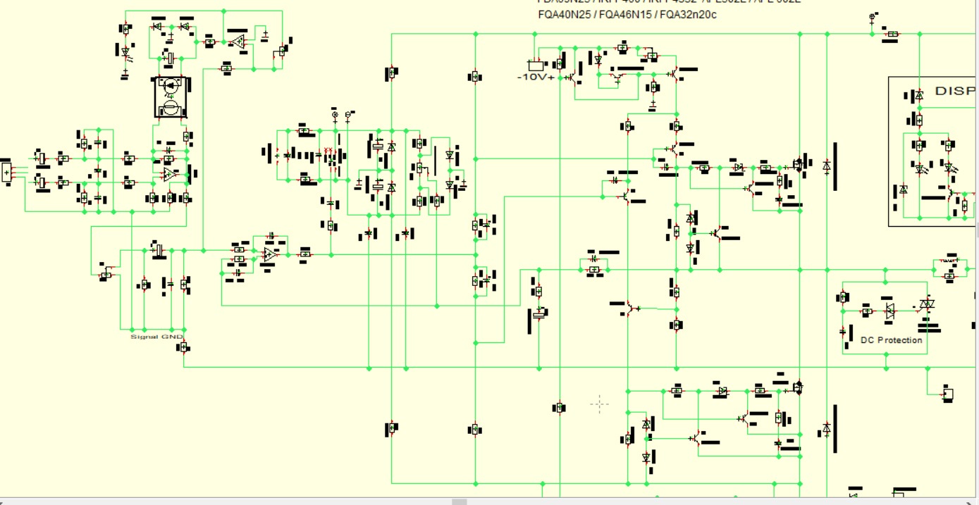

I've read a lots of posts in this thread, but still need some help regarding MOSFET choice - is there any other property too be looked for except Vdss? For example, I could use any MOSFET which Vdss is rated more than rail voltage? The output power will be limited by device's Rds(on), but I can pick any NMOS, or not?
Also, what is maximum level of input signal it can handle without clipping? I can't get more than 1.1Vpp in simulation. Or it doesn't have a relation with output MOSFET choice?
Hi Rankot
The Rds(on) of the type of MOSFETs you need will have very little impact on the output level. Other Factors to consider are Vdss which must be more than twice the rail voltage and Ciss (input capacitance) - the lower the better although hard to find very low in power MOSFETs.
The maximum input level the amp will take befor clipping is dependant on the feedback network of R17 & R18. Reducing R17 reduces the gain with the gain ratio being R17/R18. Try this in the SIM first.

Thank You Quasi.
Found T10 was damaged. 2nd stage, T4 and C7 checked out fine. Replaced R2, T10 and damage Mosfet. Passed the setup procedure and module now working again. I suspect the output Mosfet failed creating the other issues. Thanks for the assistance.

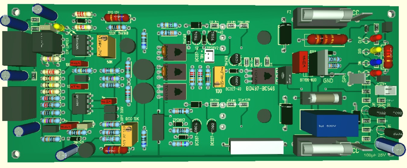

Quasis ACTRK 400/600 reborn
for Pro and domestic HI-FI
Op Front End
Balanced In,
Clip Limiter,
OCP Over Current portection
Crowbar DC Protection
Solid State Turn on delay / Fast off
Somebody interested to build ?

1. For small power HI-FI IRFP4227 sure no problem
2. For PA Application 70 Volt DC use 2 pair FDA69N25 for Hi-Fi 55 Volt DC 1 pair FDA 69N25
3. WITHOUT the extra higher 10 volt dc supply you will NOT symmetrical clipping, dont care for Hi-FI ist important for PA high power

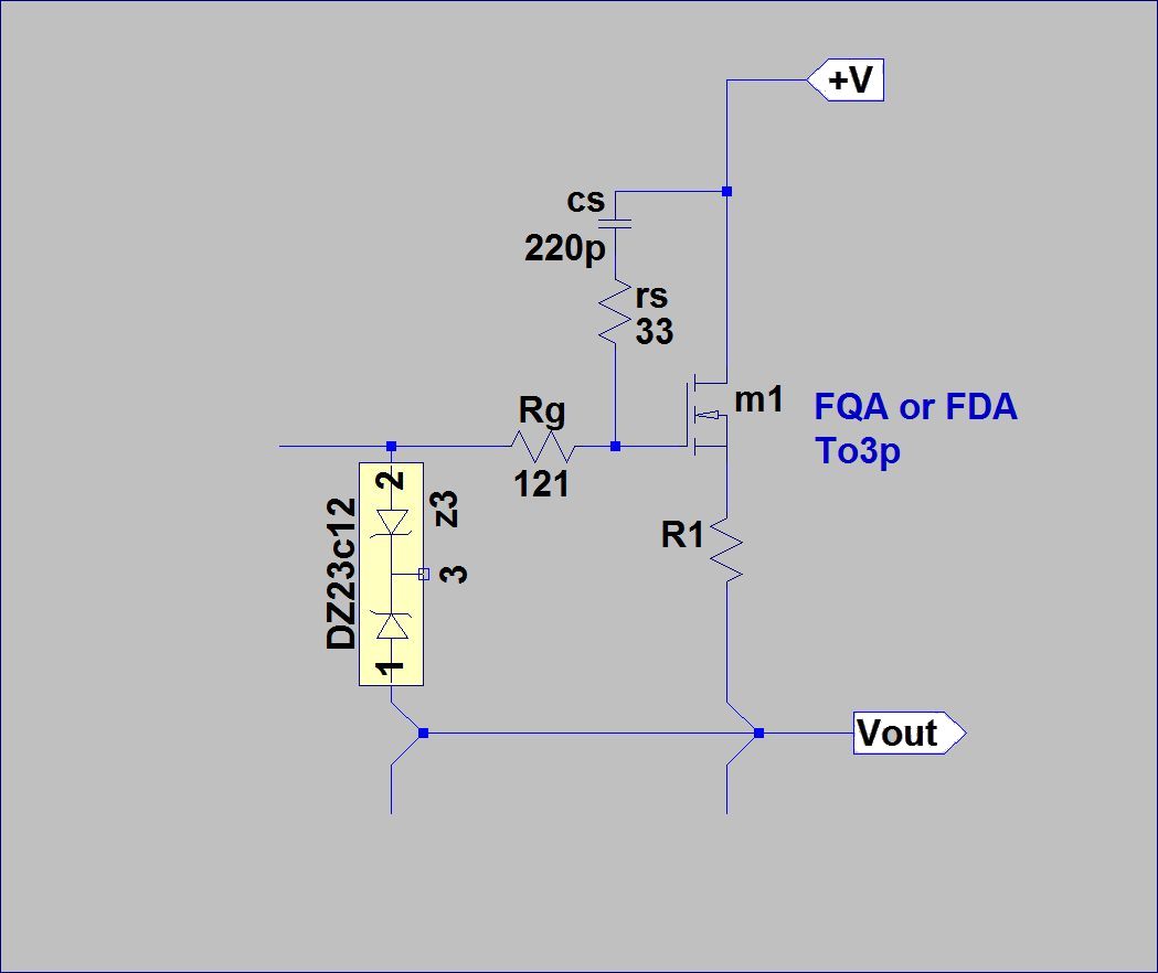

mosfets will work for audio amplifiers, but ONLY if you use
a gate/drain snubber if you paralleling mosfets,
if you use only 1 pair for Hi-Fi you no need snubbers
Without the snubbers they WILL burst into oscillation and
destroy themselves quite quickly.
I suggest you use 1206 size smd components for Cs and Rs, and that you make the gate resistor
(Rg) a low power resistor (1/8 watt or 1206 or 1210) so that if the mosfet does decide to fail, the
gate resistor will quickly fail and save the rest of the circuit. Keep the track lengths between the
gate and the Rs and Rg resistors small (ie 5mm).
If you are using large mosfets, with 480W ratings, I would suggest 47R and 220p. This
is not particularly critical, but it's related to the nasty phenomenon and comes back to
the architecture of the die and the parasitics, particularly Ciss.
Most of the time there will be no oscillation without snubbers.
However, in a day, a week, a year, it will appear and destroy the device......
