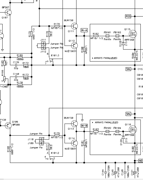

I think to add external 12V for symmetrical Clipping could be good idea?
To avoid Mosfet oscillation Ferrit Bead or resistor and condensator in series Gate do Drain should be look PIC

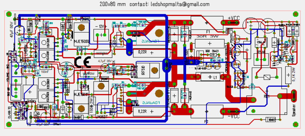

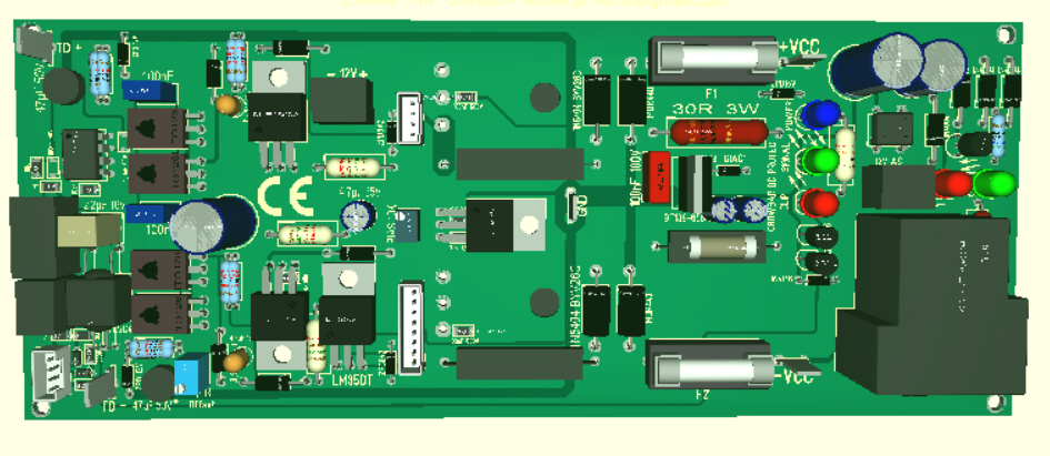

contact me if interested, I share Gerber and schematic
If you are using IXYS: IXTK46N50L / IXTK110N20L2
only 1 Pair Mosfets required for High Power 500 - 1000W
PCB Quasi ACTRK 600 amp is small 160 x 80 mm

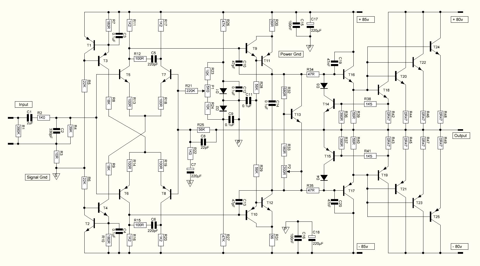

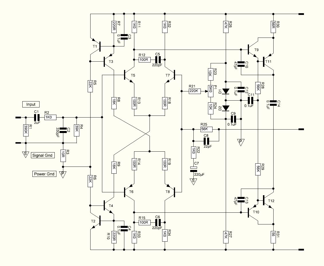

Hi folks,
A little out place here but I wanted to ask a question about an amp cct I'm tinkering with. It concerns the thermal and current stability of the 2nd stage.
This is what I'm worried about. Excluding T9 & T10 for the moment, Transistors T11 & T12 are driven by the voltage across R11 & R33 and this sets the current through them. What happens to the current when T11 & T12 get hot (and they will). I'm worried that a current increase here will make a big difference to the idle current of the output stage (not shown).

Hi quasi,
Always a pleasure! Yes, too long.
Thermally bond T9 to T11, T10 to T12. You can't forget about T9 and T10 as they will affect the bias. I don't use spice, but at this point I would build it up and try it even if I did.
What are your rails and transistor types? This could be a signal amp or scale up to a medium powered amplifier.
Best, Chris
Best, Chris
Thanks Chris,
This is the full schematic of what I had in mind. Split rails to achieve rail to rail output - it Sim's to less than 1v of rail. I started designing the PCB when I became worried about the thermal problem of the second stage.
Transistors:
CCS: BC546 & BC556
Input stage - 2SC1845 & 2SA992
Second stage - not sure yet
Driver & Output stages NJW0281G & NJW0302G
