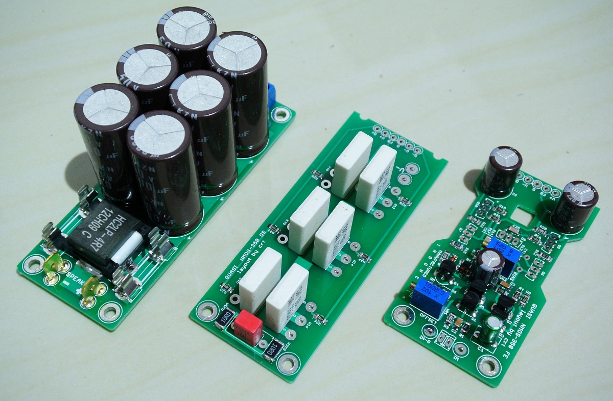

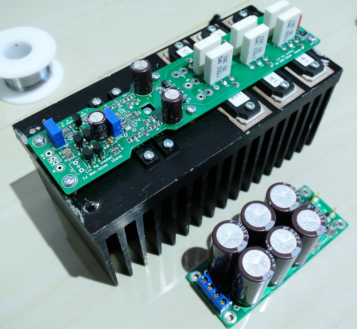

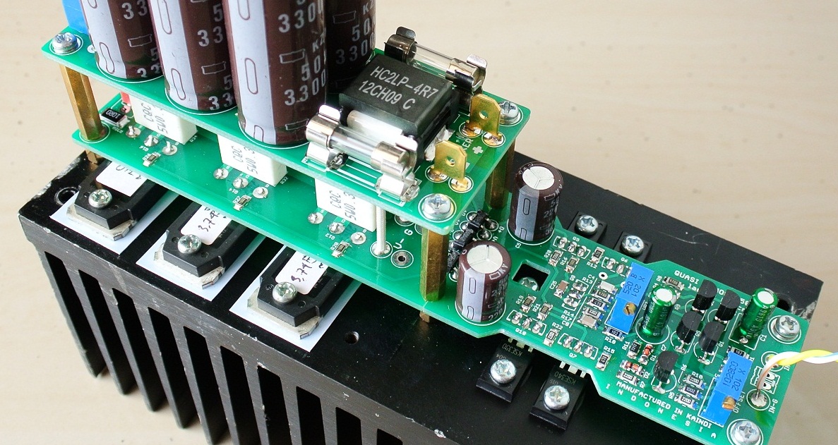

It's been a while I did not build a new amplifier.
Using SMD part and IRFP240 since i have few of them lying around
Partial finish, still waiting heatsink for the other channel.
Feed it using switching power supply @ +/-46V since my target about 200W @ 4 Ohm. It working flawless.
Thank's Quasi for your circuit
