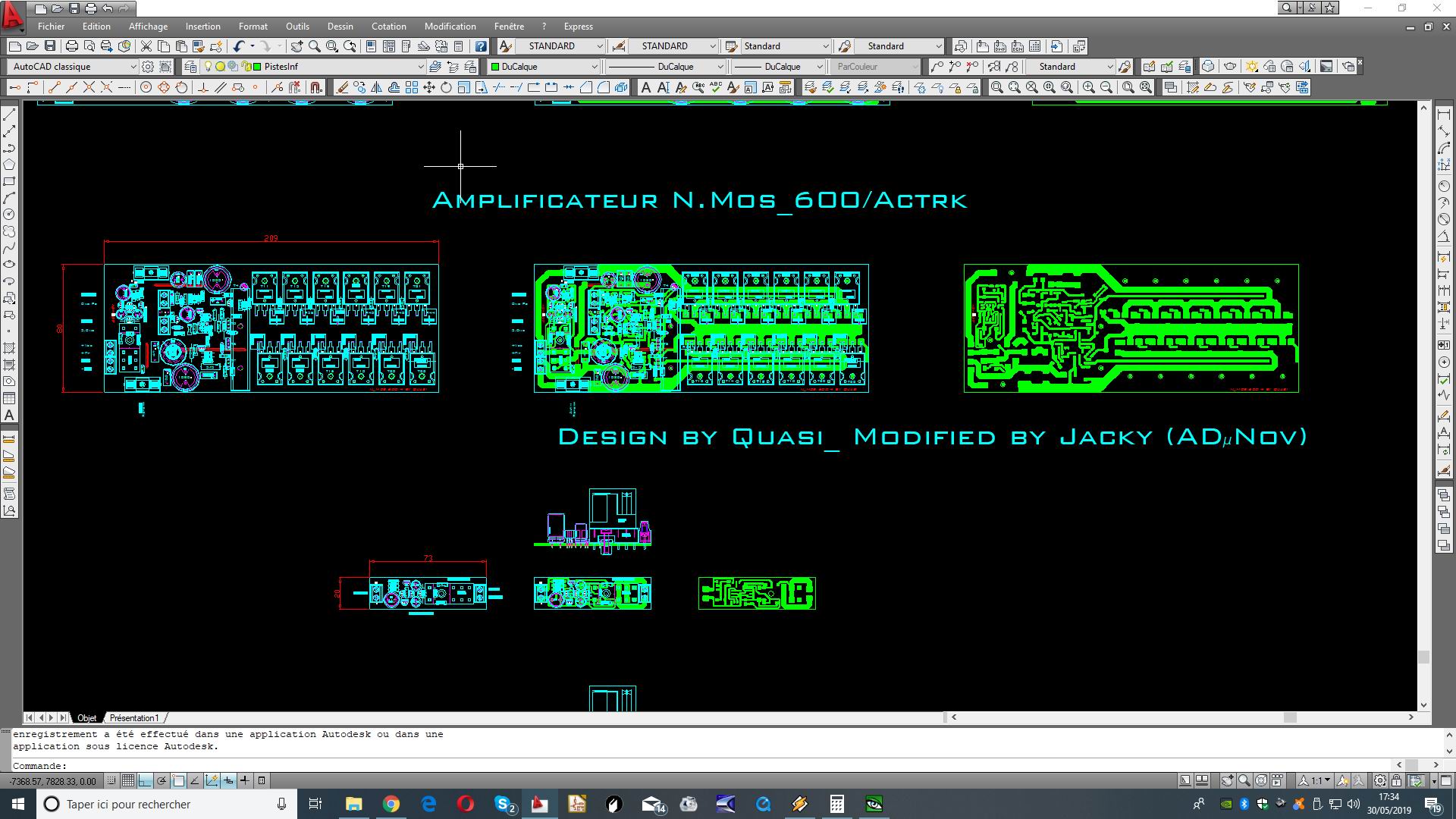

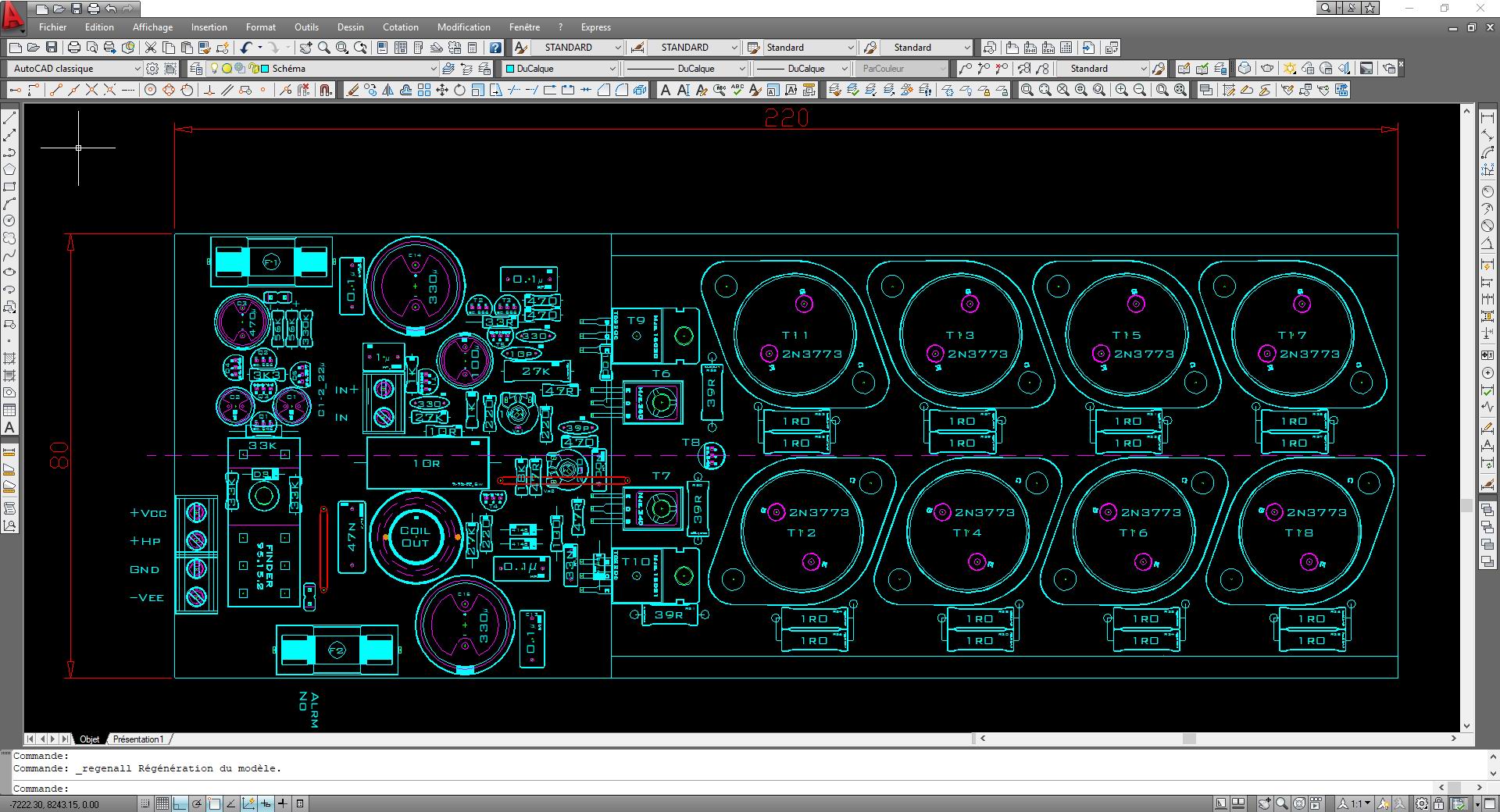

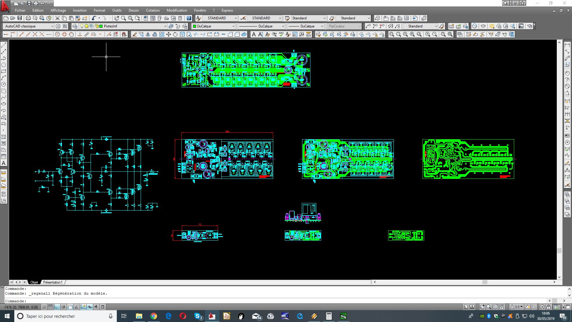

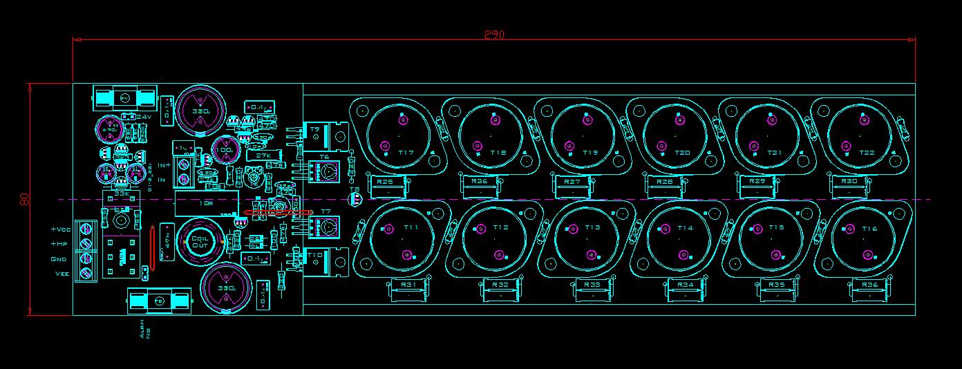

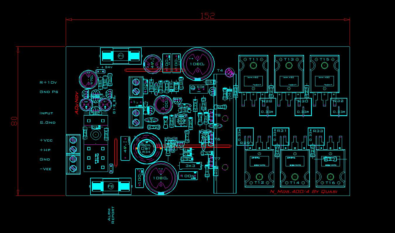

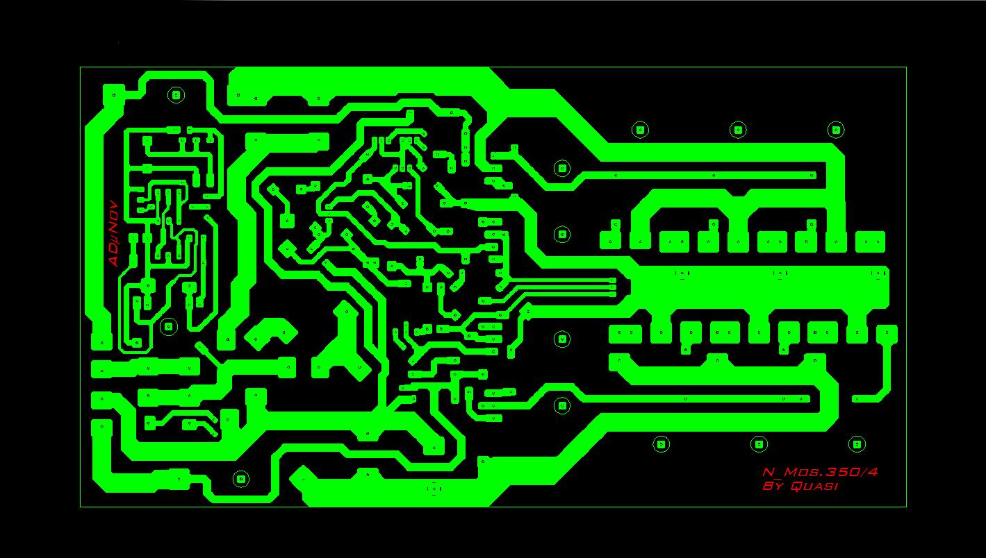

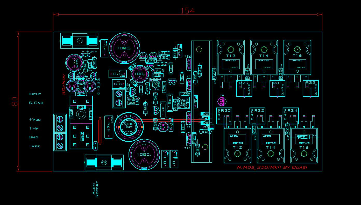

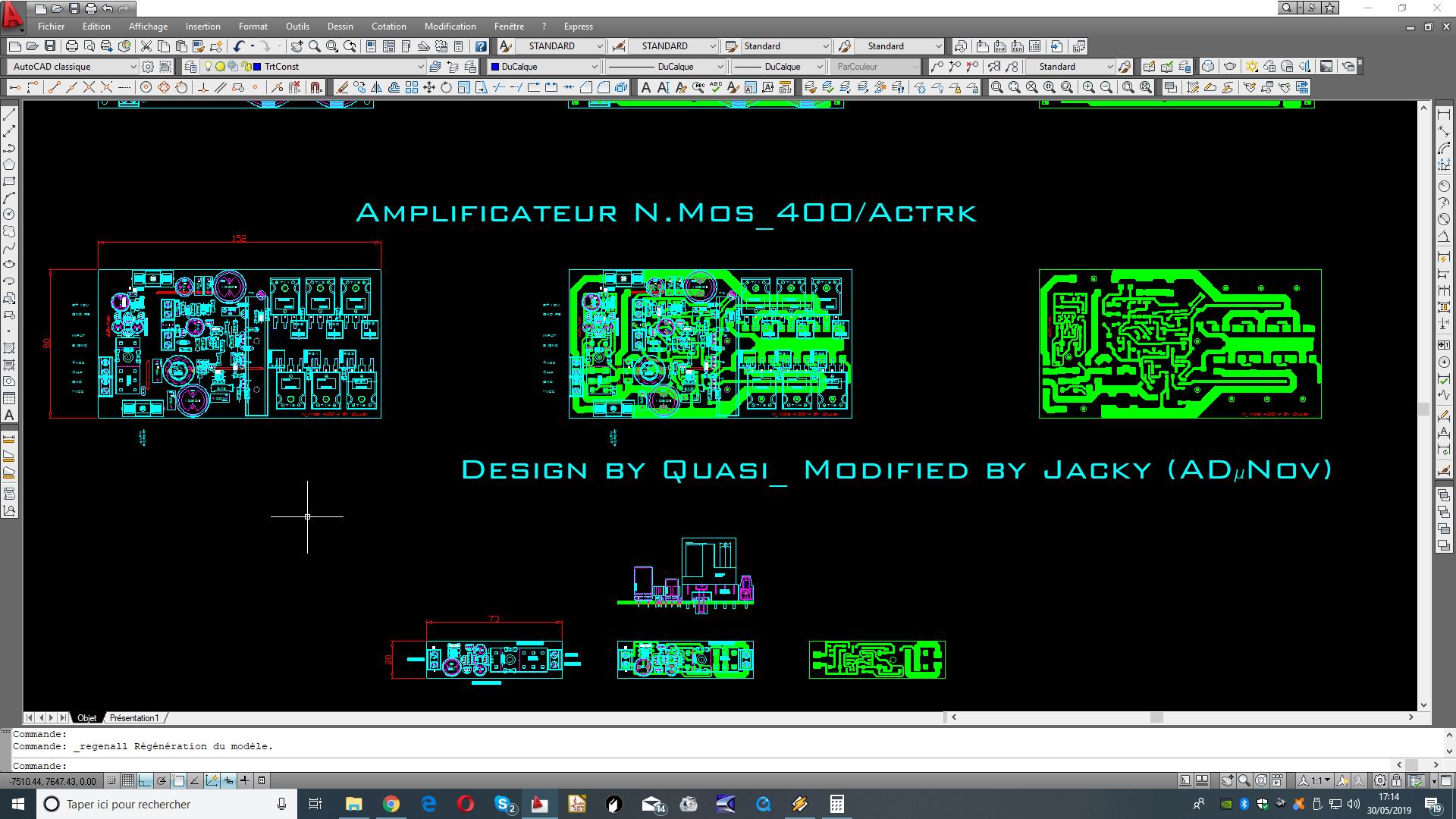

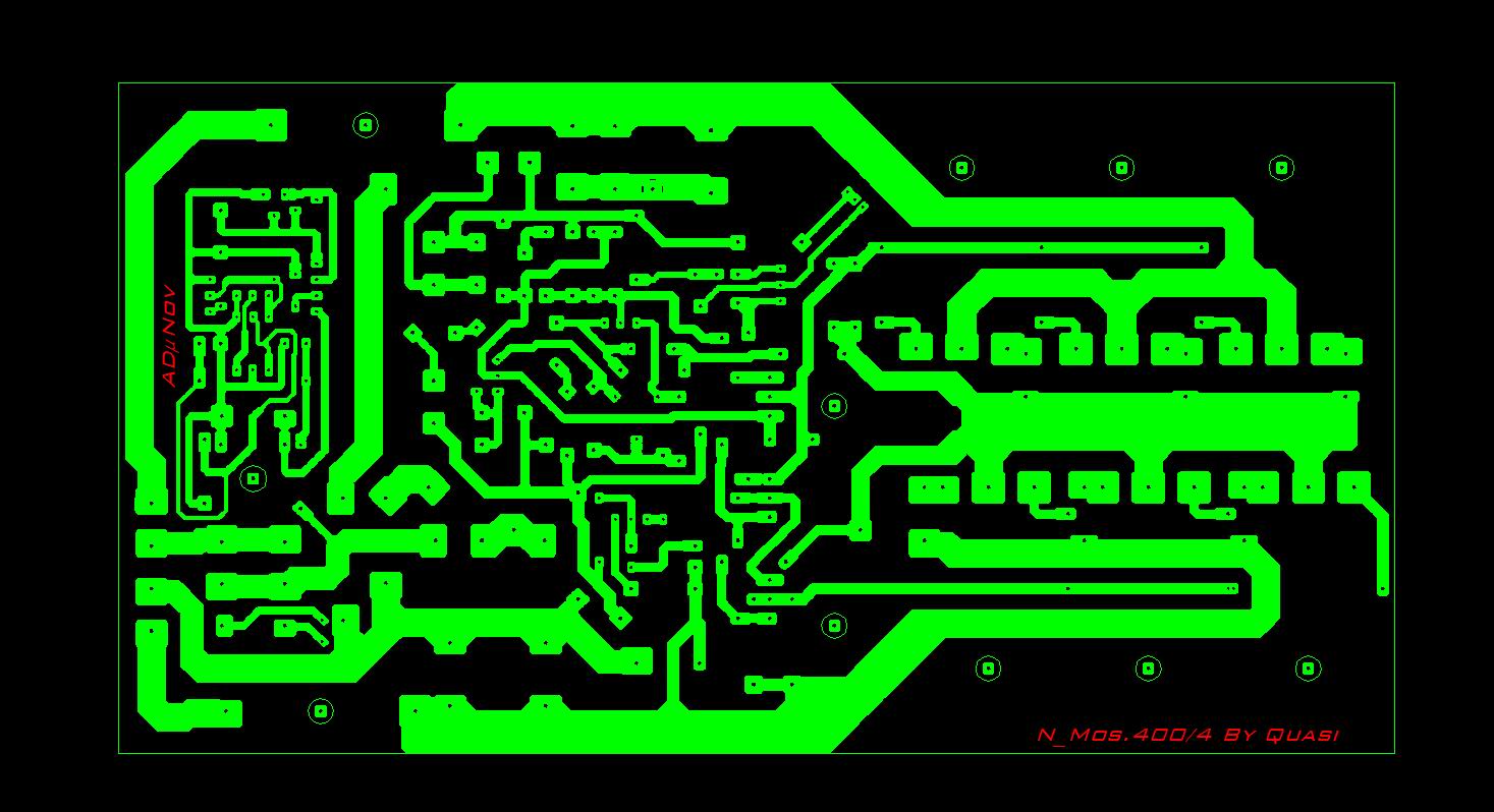

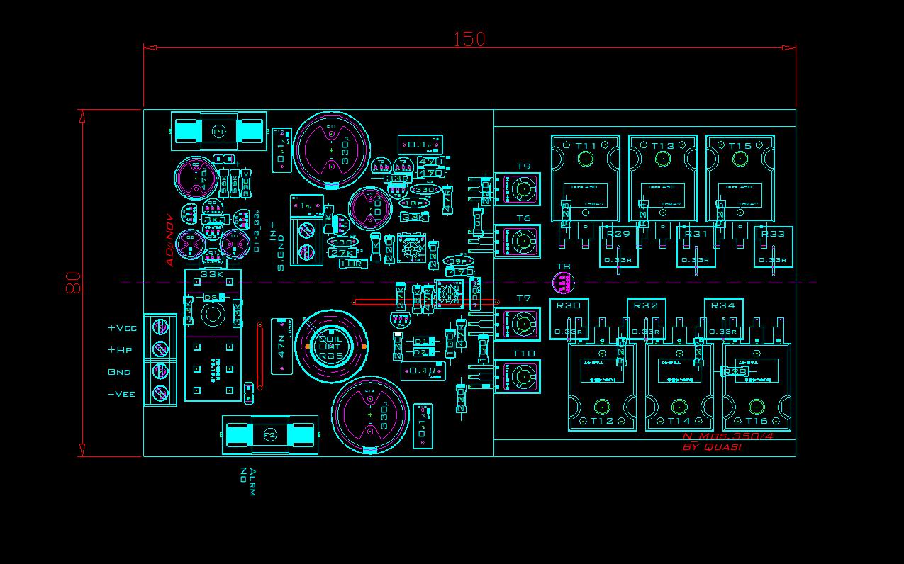

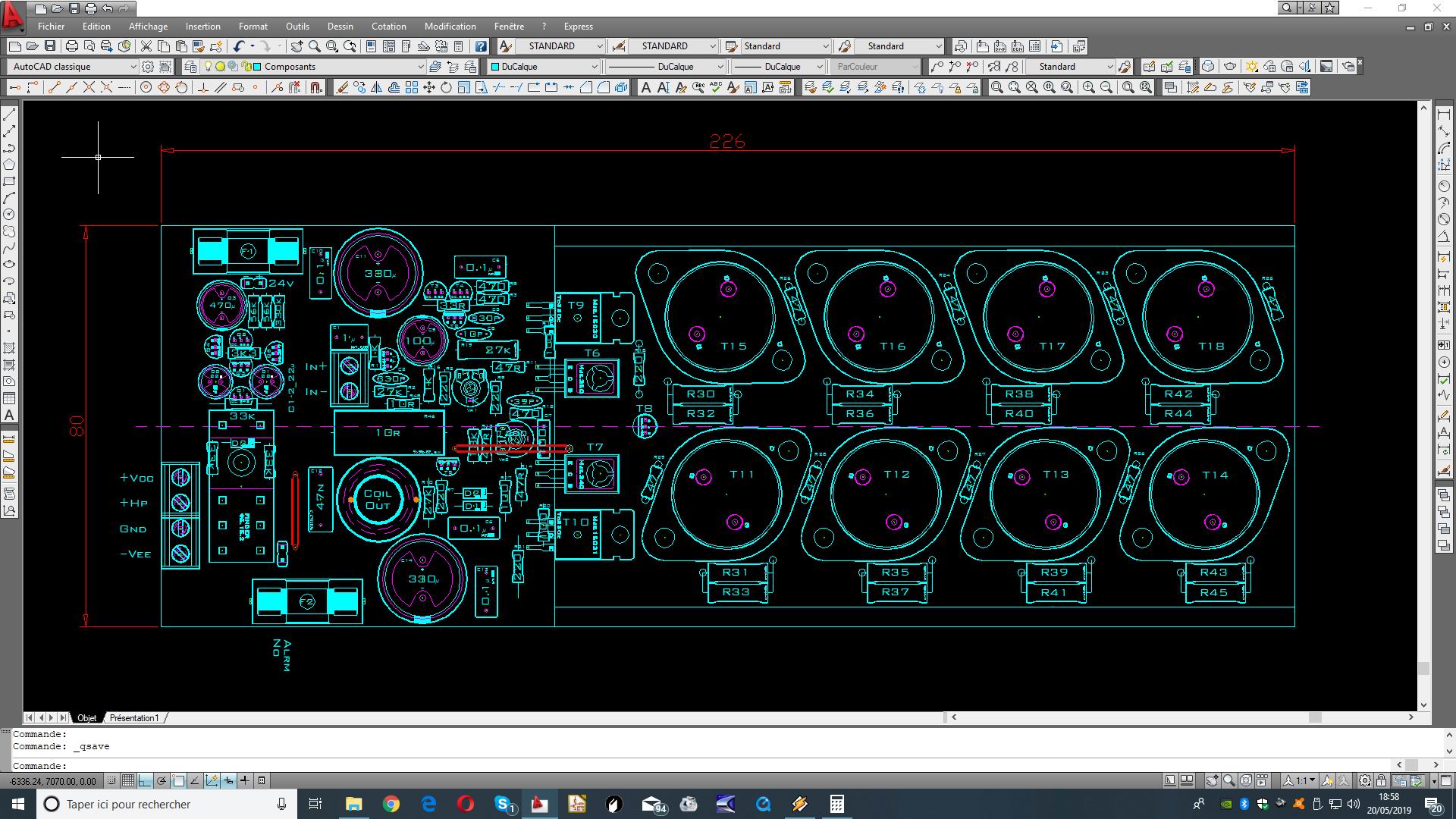

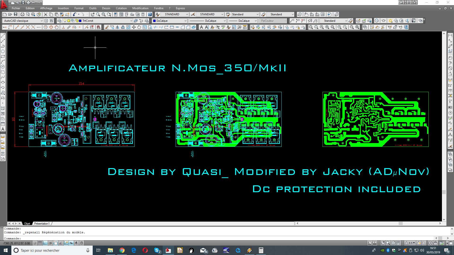

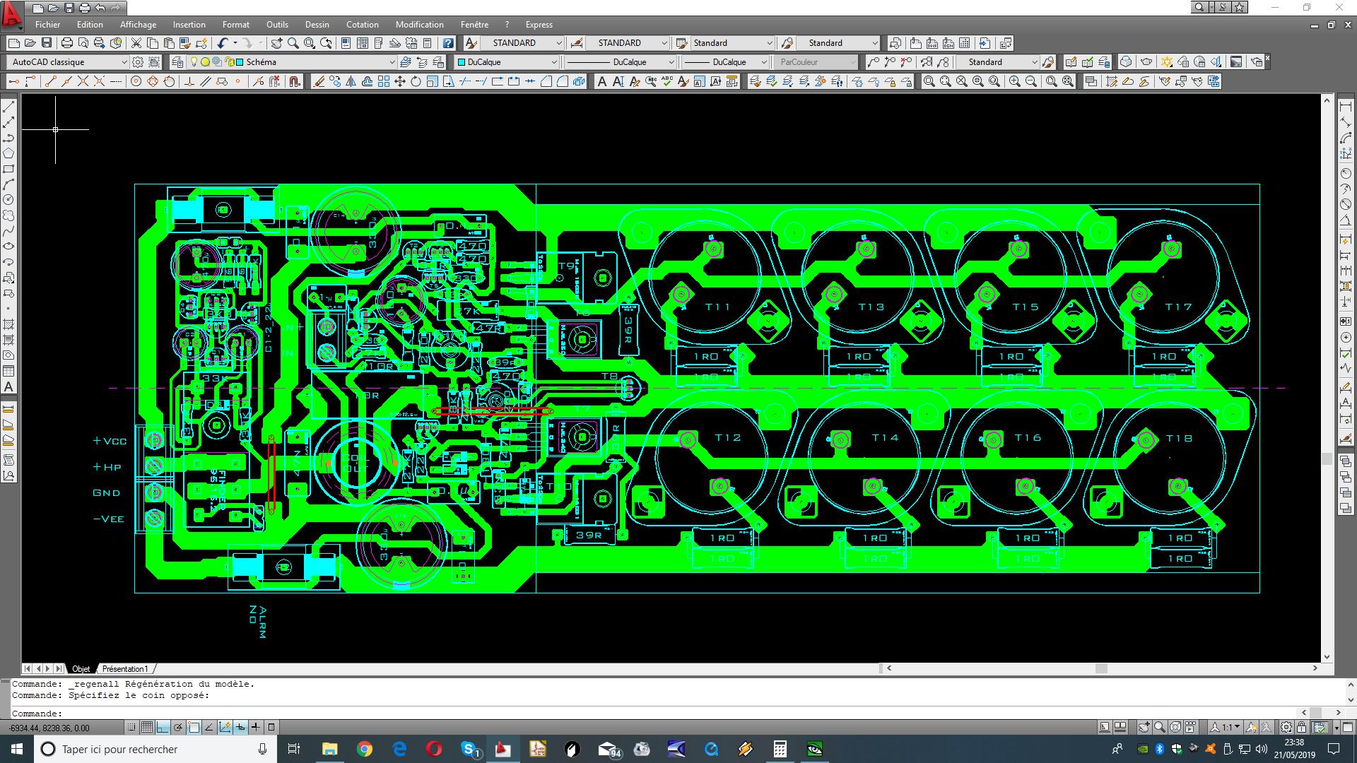

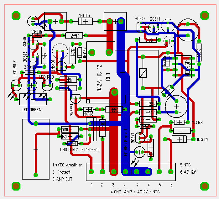

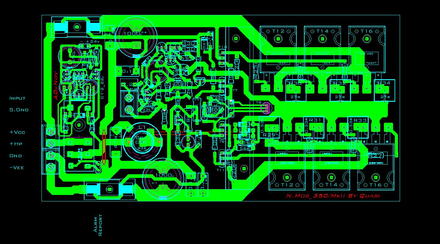

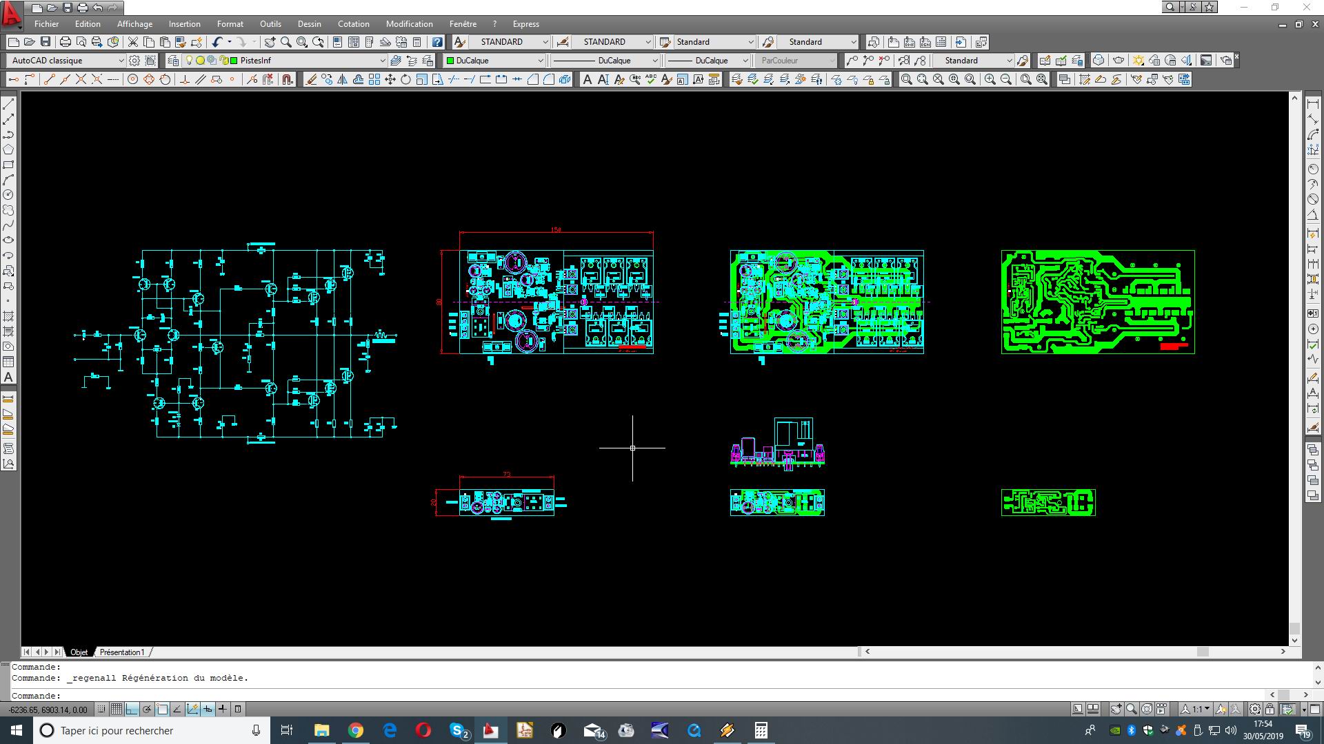

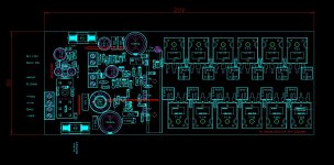

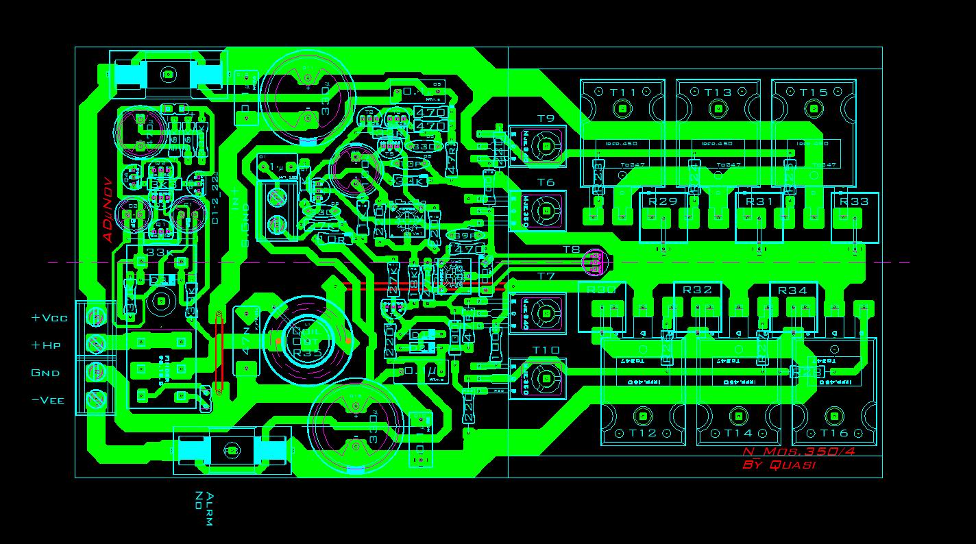

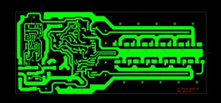

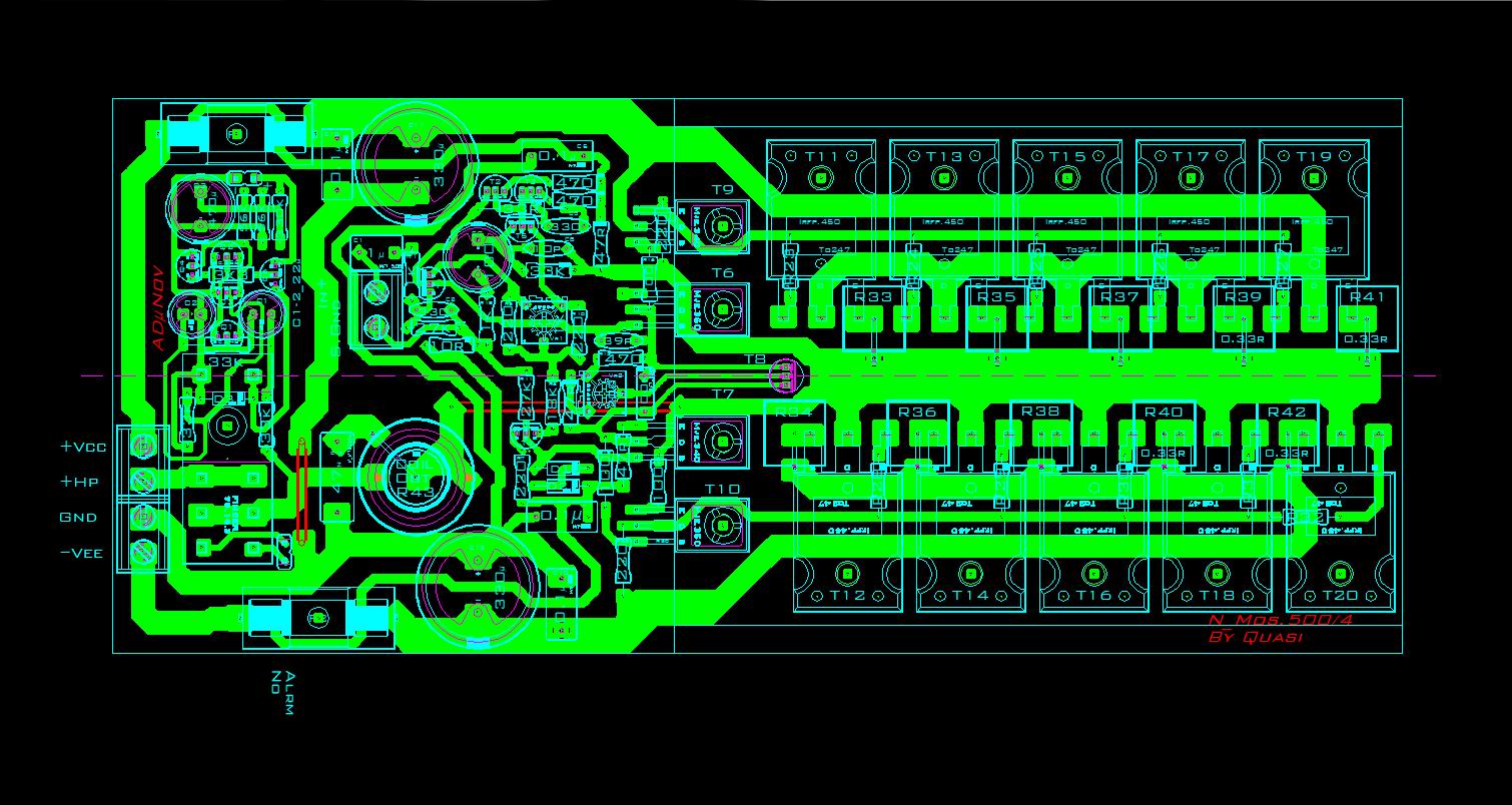

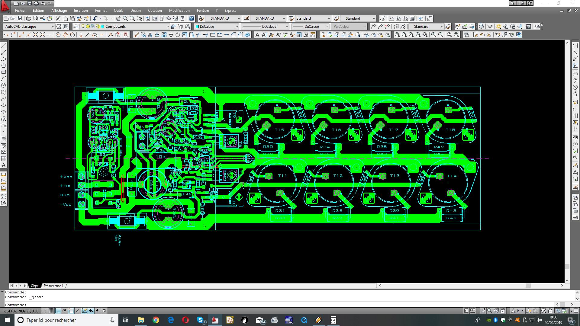

Amplifier Quasi
Hello everyone. Hello Quasi.
Well, I have to go back to sea to find and save refugees.
We are an NGO Emmaus, Abbé Pierre for those who know. We recycle all the electronic equipment. There is an infernal amount of material. We love HIfi. Average age 58 years. So generation Travolta and so on. We love the amp Quasi, so we worked on it very hard, I must say. Since the circuits are very similar, we tried to unify the PCBs as much as possible. See the attached files. We start building as soon as we come back from the sea campaign! Hoping to run all the amplifiers almost at best. There were some problems, but to see later. I have to go see you soon.
Jacky (ADμNov)
Amplifier Quasi
Next
Next
Amplifier Quasi
The end
The end

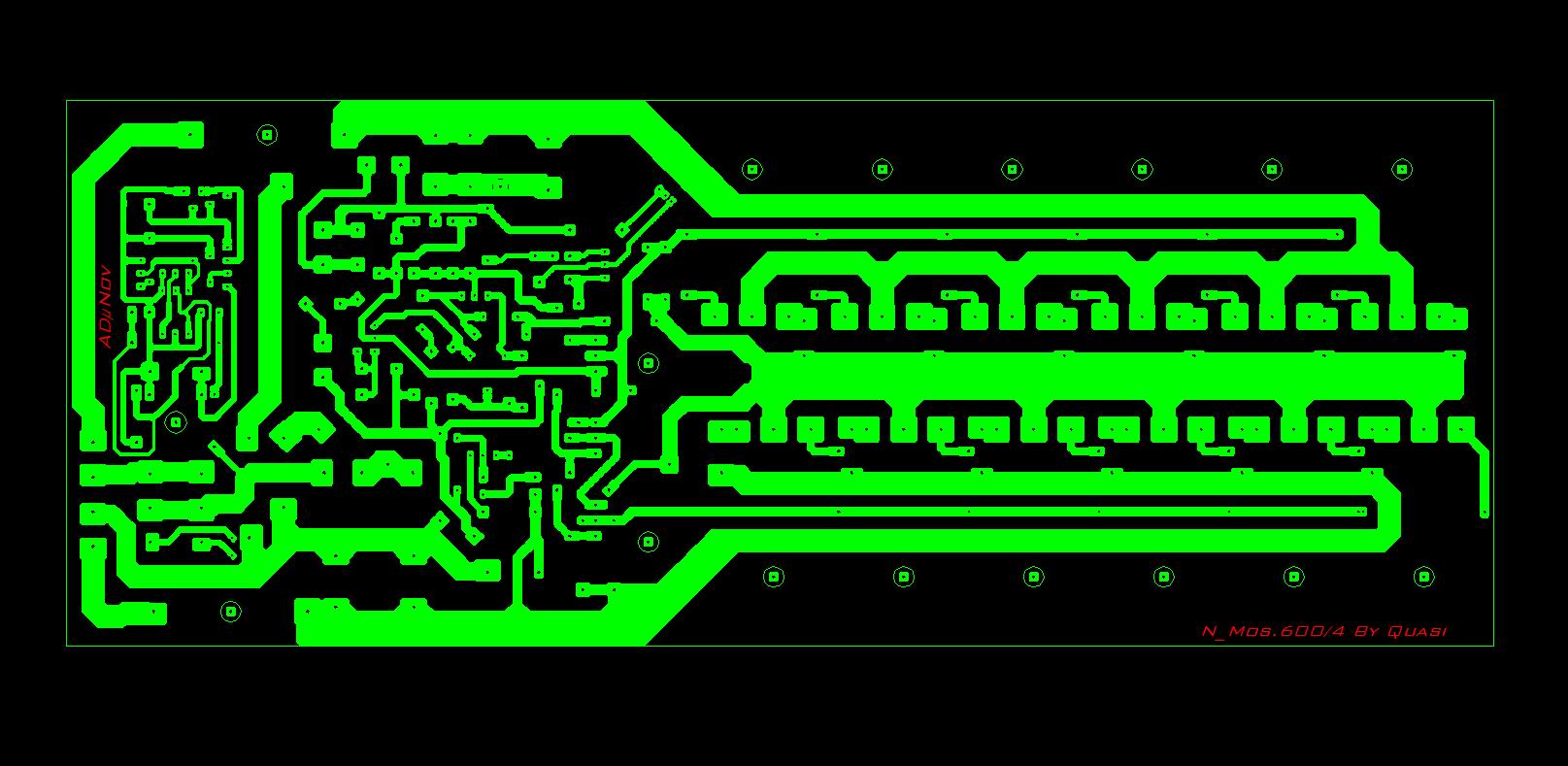

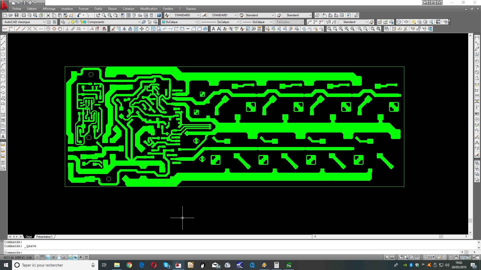

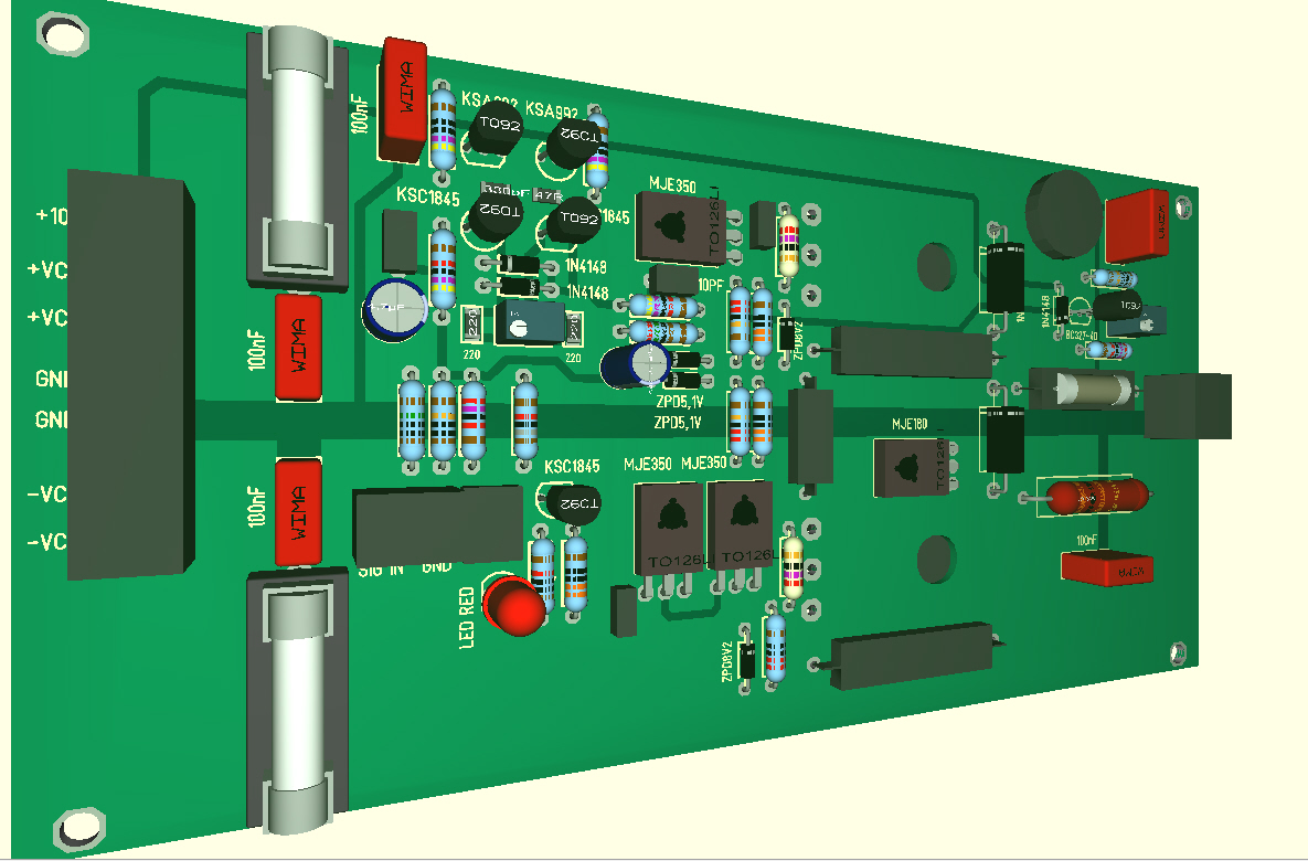

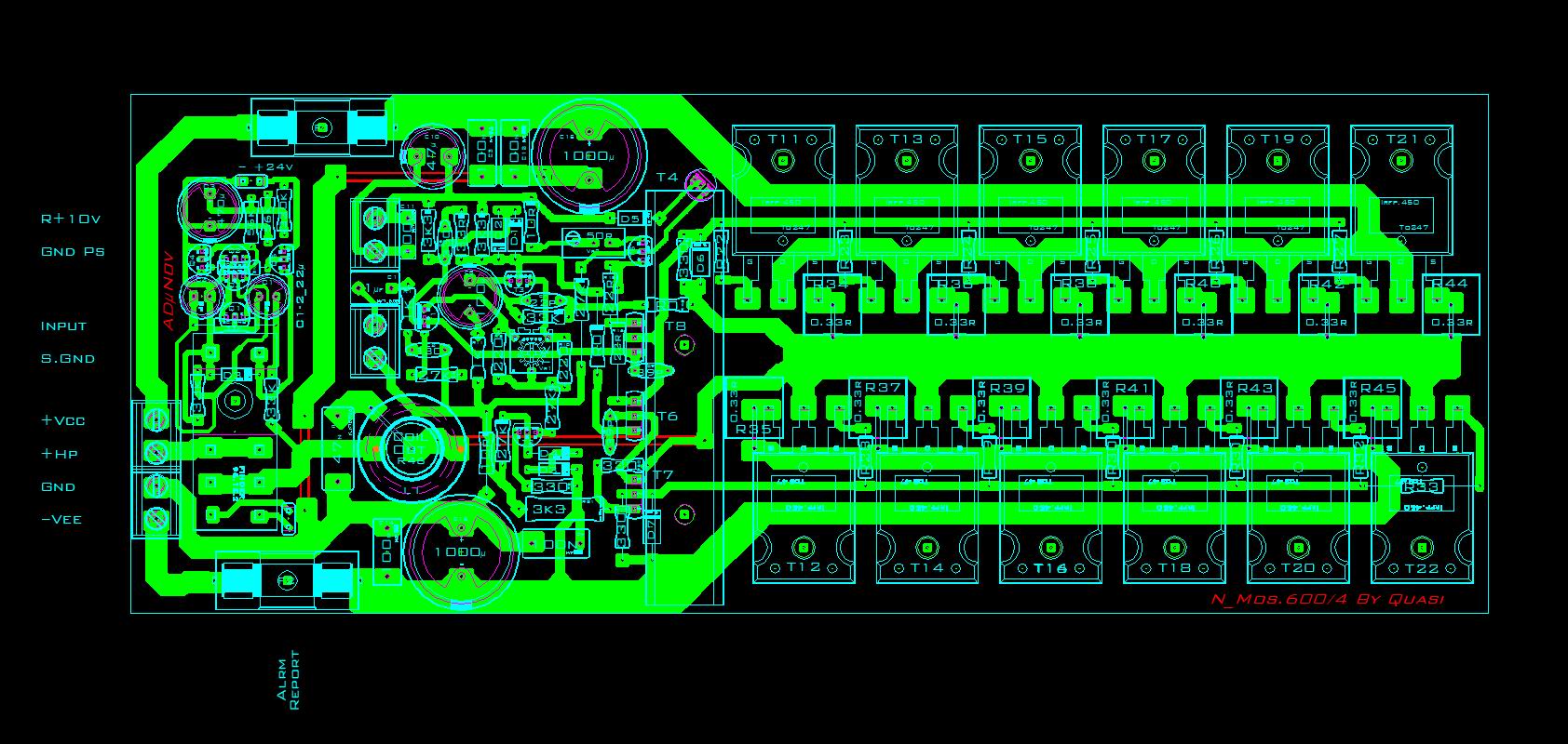

I did build this Quasi Amp 9 years ago
working fine, no issues, but much more heat dissipation compare to ACTRK400/600
I have changed to ACTRK600 its another quasi design,
much more efficient with excellent sound and reliability from same designer

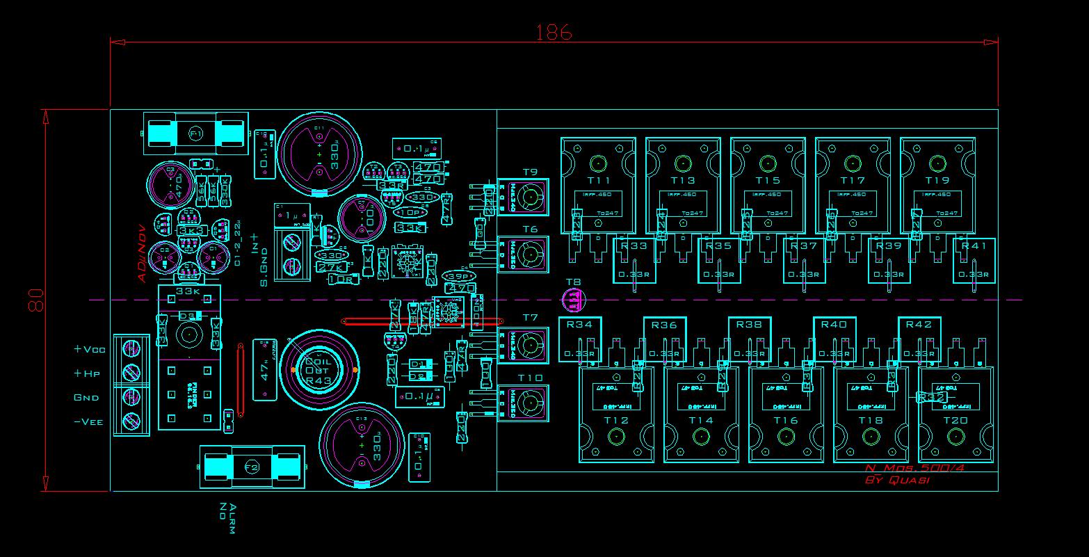

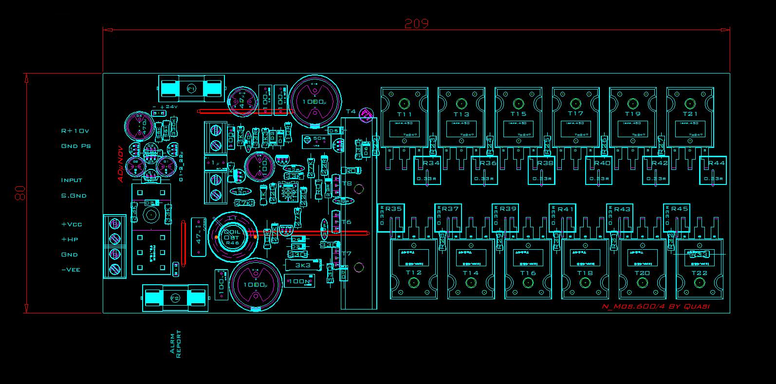

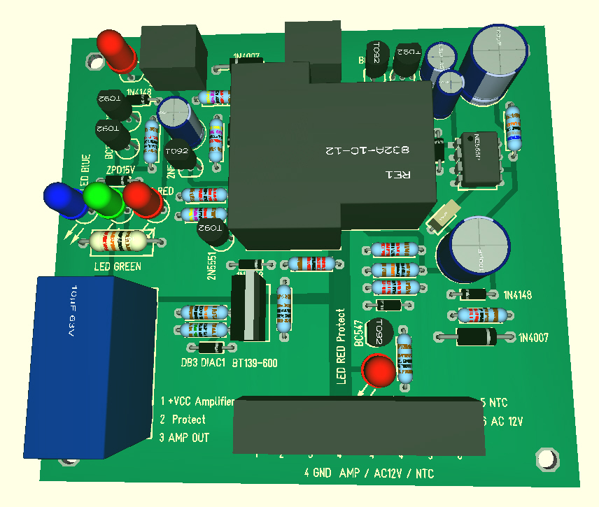

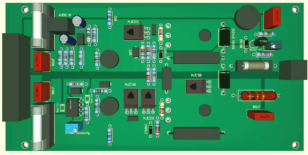

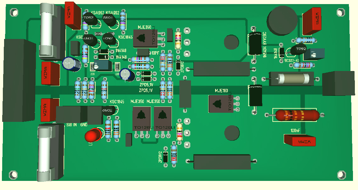

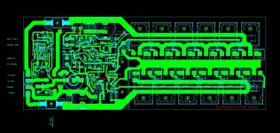

Quasi ACTRK400/600 with OP input stage
I forget
LED Status
ON Power
Signal
Clip
Clip Limiter
contact me if interested, I share Gerber and schematic
If you are using IXYS: IXTK46N50L / IXTK110N20L2
only 1 Pair Mosfets required for High Power 500 - 1000W
PCB Quasi ACTRK 600 amp is small 160 x 80 mm
LED Status
ON Power
Signal
Clip
Clip Limiter

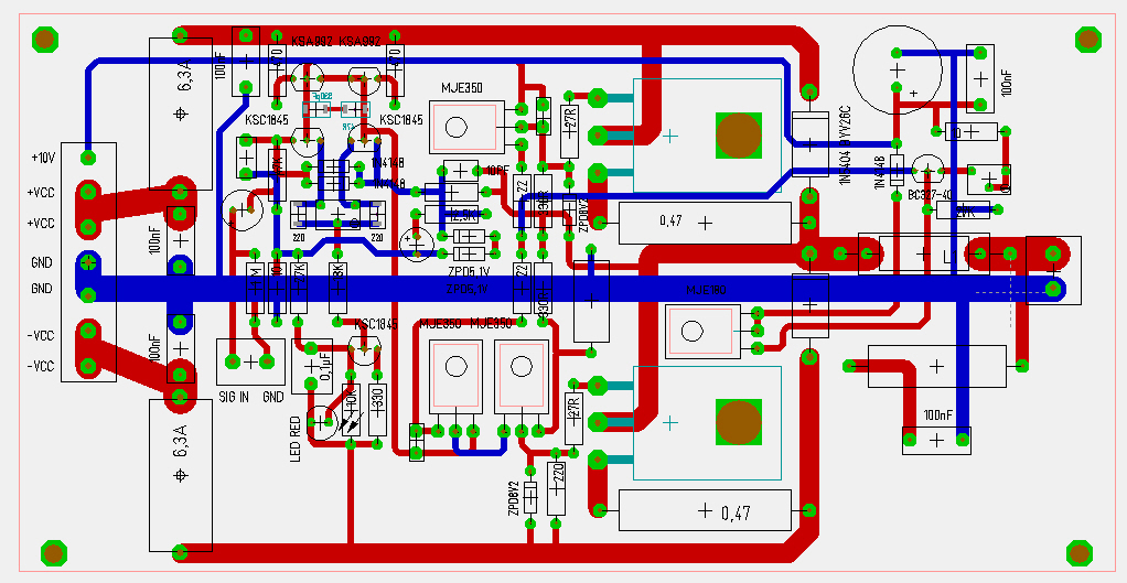

Hello NMOS. Congratulations on your initiative.
I am happy to know that the Actrk600 has less heat dissipation.
Could you please share the GERBER and schematic?
I do not need much power, I have available to use the IRFP450 and IRFP460. Would you recommend any of these?
Thank you for your help. (my email: grechejr@gmail.com)

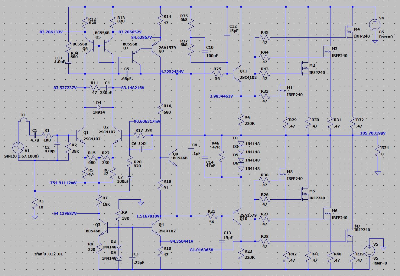

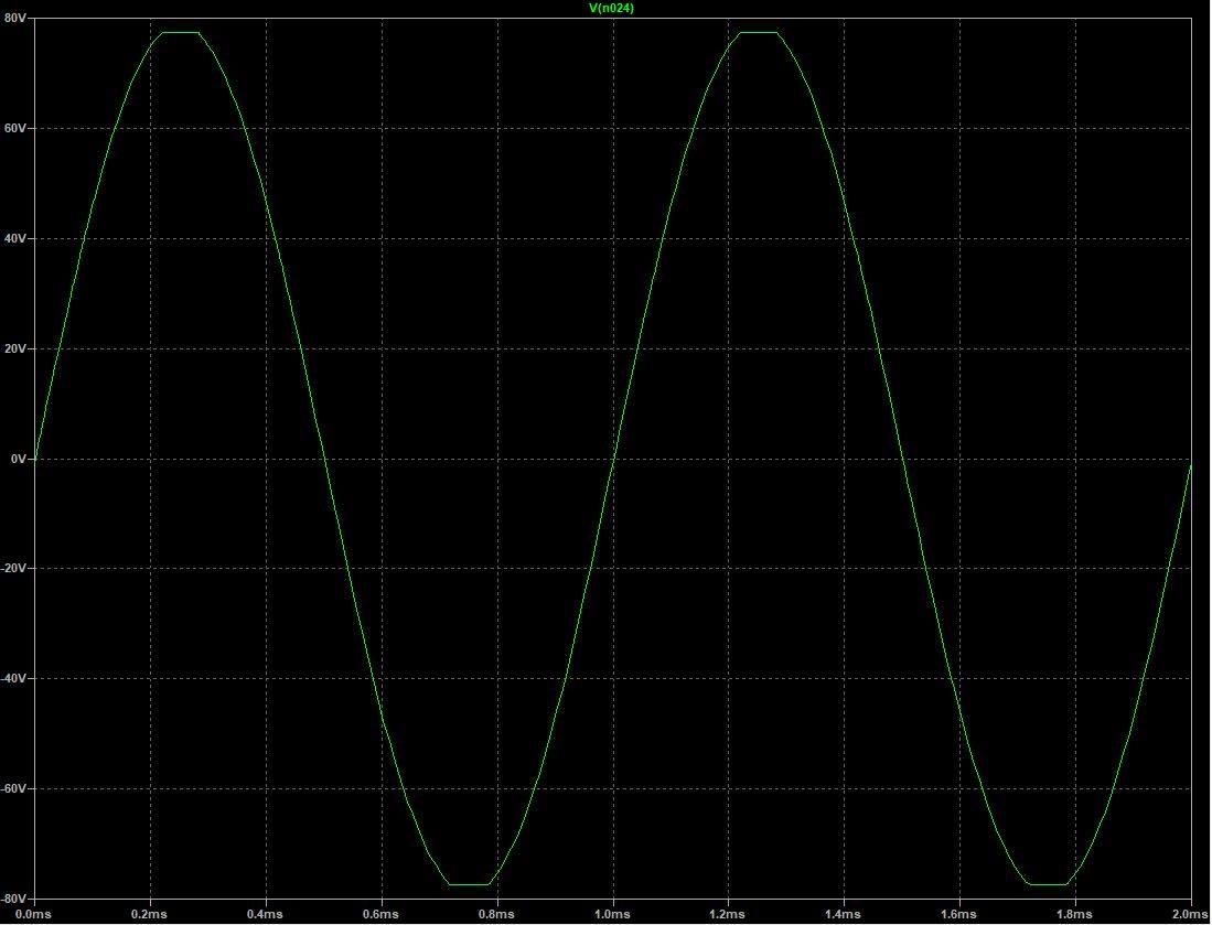

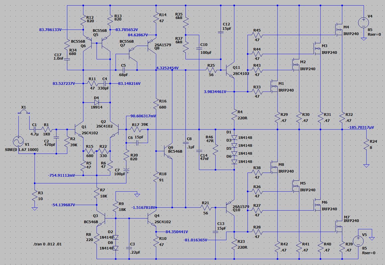

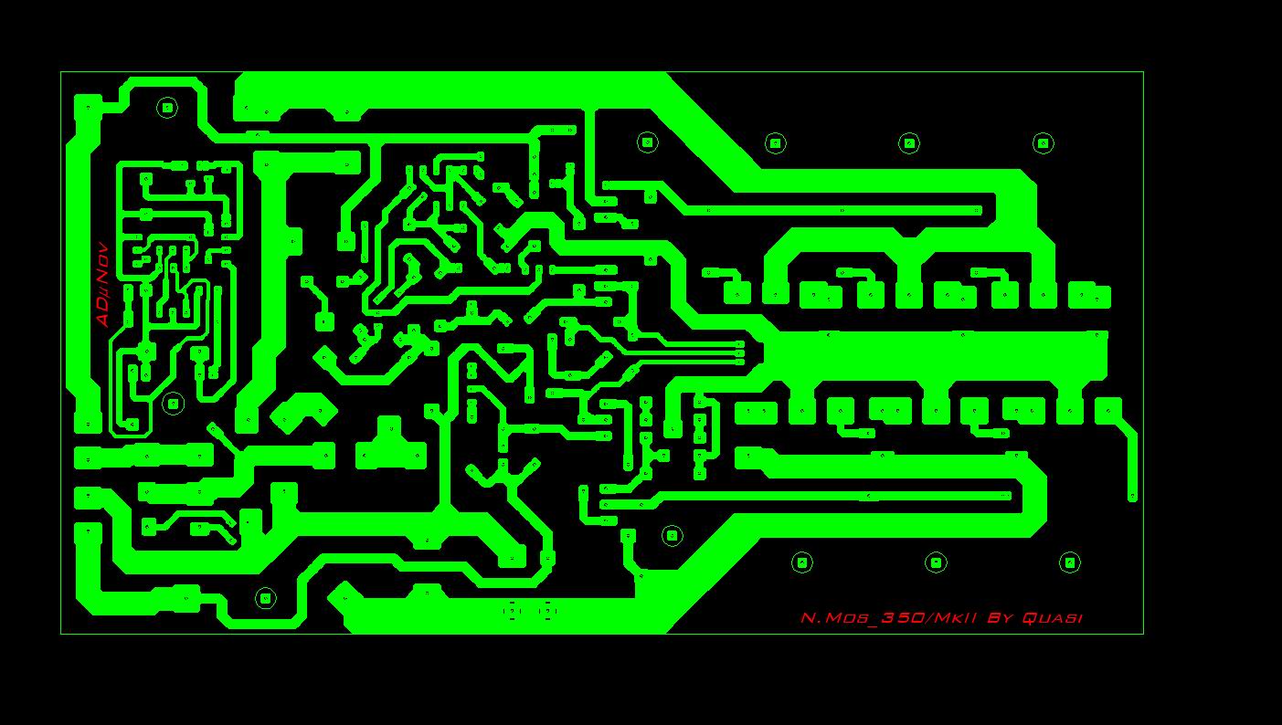

Greetings - long time no Quasi.
Anyway started playing around again, trying to improve the Nmos350 / 500. A few changes around the second stage, component values throughout and tiny bits of filtering to add more control.
This is the SIM, not perfect but not bad. Looking forward to further improving it with your ideas. SIM file plus screen shots to follow.
I feel to much components in front end without benefits ,
op amp front end NE5534A could be better solution and more DIYer friendly,
no need matching transistors, less components

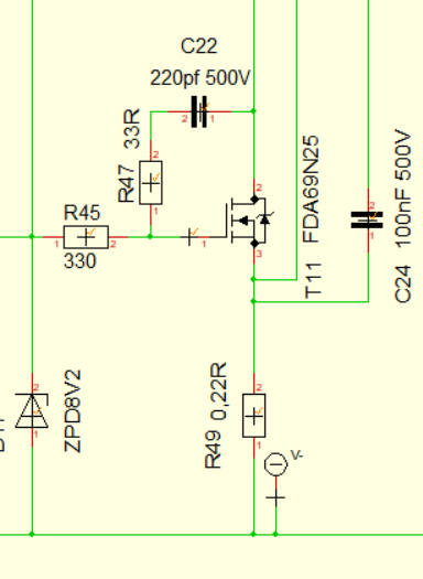

1 pcs. Mosfet FDA69N25 can replace 3 -4 pcs. IRFP240, save cost and space

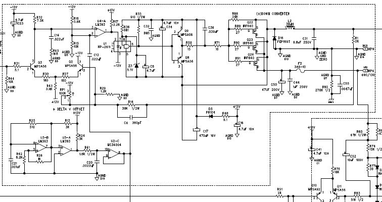

To improve efficiency from NMOS we should add CLass TD Rail switcher its
cheap with less components, dissipation for NMOS about 50W at fullpower compare before about 400W
1 pcs. Mosfet FDA69N25 is more enough for full output power
look attachment schematic tracking Downconverter
I have build 10 years ago your NMOS
NMOS MK3 should have real impovements
