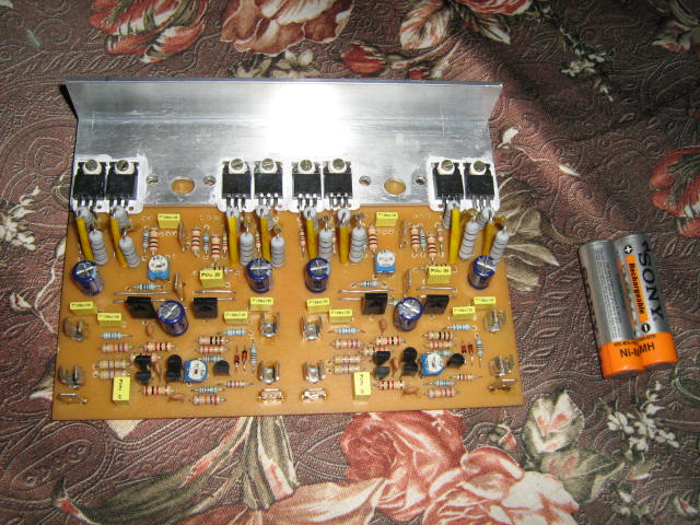

I am almost done with building two NMOS200 modules. How much should the bias current be? There are two presets, which do I use to adjust bias?
Also I have used 12K (R7) instead of 10K since I did not have the latter value with me. Is that okay?

Nice work Vivek.
What device do intend to use for T8?
The trimmer (200R) closest tho the main heatsink bracket is is adjusted to set the bias (idle) current through the output stage. The other (1K0) near the front of the board sets the output offset and should be adjusted so that there is less than 10mV between the output and ground.
Cheers

Thanks quasi. Initially I will be using +/- 35V to do the testing.
I will be using BC546 for T8. As you can see, I have made holes in the 'L' plate to fit it in. Have I made a mistake?
And some more doubts here:
1) How much should the bias current be? And do I set it while measuring the voltage across the 1 ohmr resistors?
2) While setting the output offset, what should be at the input?
3) Also I have used 12K (R7) instead of 10K since I did not have the latter value with me. Is that okay or is 10K an absolute necessity?
Vivek
Vivek
The hole seems to be too big for the BC546. It should be a snug fit so that good contact is made with the heatsink bracket. If this is now not possible you will be better off mounting it flat against the heatsink bracket and running the leads back through the hole.
1. The bias current shoud be 30mA to 40mA per FET pair. You need to follow the setup procedure described in this thread somewhere that involves replacing the fuses with resistors. I'll try and find it and post it again.
2. Nothing should be connected to the input when setting the offset voltage or the bias current.
3. The 12k resistor is too large for 35 volt rails but it will be ok for rails of 40v or more up to 50v. If you don't have a 10k resistor use an 8k2 or even 6k8.
Cheers

Setup Guide for Nmos series.
I found the set-up guide.
Note: The Nmos200 is limited to 50 volts maximum and suitable only for 8 & 4 ohm loads. For the TO220 version minimum FET spec is Vds = 140v and Pd = 125 watt @ 25° C. Minimum spec for TO247 version is Vds = 140v and Pd = 250 watt.
The setup is done without a load connected to the power amp module. First check your work and make sure output devices are insulated from heatsink.
1. Remove fuses and replace with 100 ohm 5 watt resistors.
2. Make sure power supply polarity is correct and connect amp to power supply and turn on.
3. Check output offset voltage and adjust VR1 to achieve an offset of less than 10 mV.
4. All being well a place a voltmeter across one of the 100 ohm resistors.
5. Adjust VR2 to set the output stage bias current, by measuring the voltage across one of the 100 ohm resistors. Adjust for a reading of 3 volts per output FET pair. I.e; For a 2 FET board set for 3 volts. For a 6 FET board set for a voltage of 9 volts. This equates to a bias current of 30mA per FET pair or 90 mA total. For a 10 FET board set for a voltage of 15 volts.
6. All being well replace the 100 ohm resistors with 10 ohms 1 watt resistors and re-adjust VR2 to get 0.3 volts per FET pair.
7. Once done, remove the resistors and put the fuses in. Re-check the offset voltage and adjust with VR1 if necessary. The amp is ready.

When checking and setting the output offset, fit a shorting plug to the input and leave the output open circuit.
Re-check the offset after connecting the pre-amp/source. If the offset has changed, then investigate.

Thanks mate, for the bias setup procedure. I went to the market and bought 10K resistors.
About the BC546, how will I make it stay on the heatsink bracket?

Vivek said:Thanks mate, for the bias setup procedure. I went to the market and bought 10K resistors.
Andrew, I will use a light bulb but does it go between the AC mains and the primary winding of the transformer?
You can use a small clamp made from a metal strip and screw into the heatsink bracket. Or use a BD139 and screw that to the heatsink bracket, but watch for the different pinouts.
The light bulb goes in series with the transformer primary.
