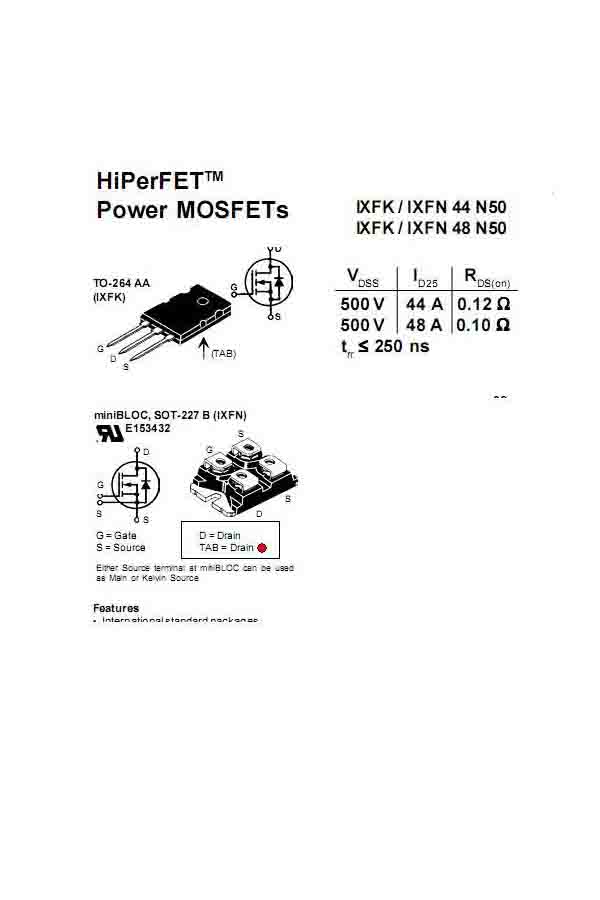

Once again I made some mesurements ,and interesting but TAB from power mosfets is not connected to D like in data sheet
strange!

alex mm said:TAB from power mosfets is not connected to D like in data sheet
Very strange indeed, each IXYS power Mosfet i have needs to be insulated.

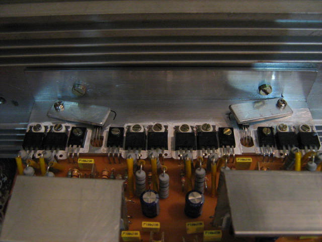

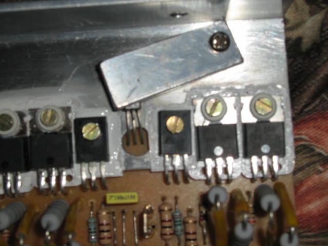

that aluminium angle between the outputs and the heatsink looks quite thin in the pics.
Check you device operating temperatures when you get it running.
I would use 6mm thick angle, you may get by with 4mm.
2mm sounds very thin and will have significant thermal resistance.

AndrewT is absolutely right, I prefer (and other DIYers too) ~5mm thin alu angle. That has enough low thermal res and easy to find in most countries - for reasonably price.

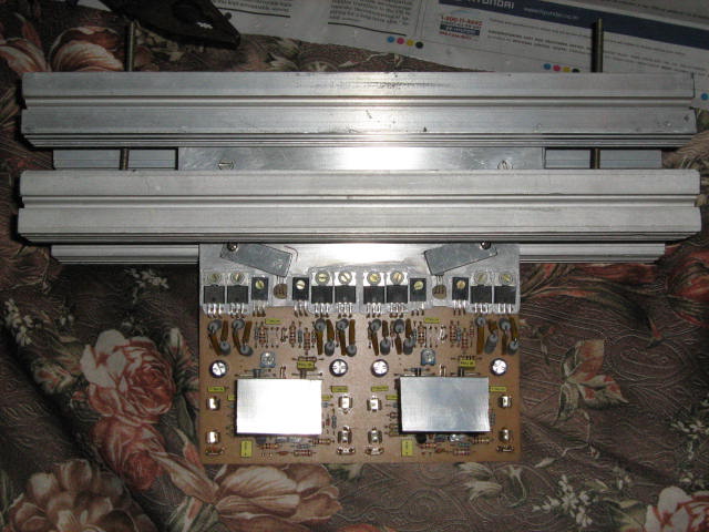

AndrewT said:Check you device operating temperatures when you get it running.
no.Vivek said:That means I have to dismantle the whole thing and do it all over again.
Check quiescent and running temperatures of the devices, the angle and the sink.
Note that if there is significant difference in temperature, that is telling you there is significant thermal resistance.
I would suggest that the devices must be less than 10Cdegrees above the sink temperature, preferably <5Cdegrees difference.

anything that allows sensible readings to be taken.Vivek said:Thanks Andrew. What kind of a thermometer should I use?
Even your finger is quite a good guide although estimating the 5 or 10degree difference will probably take quite a bit of experience.
