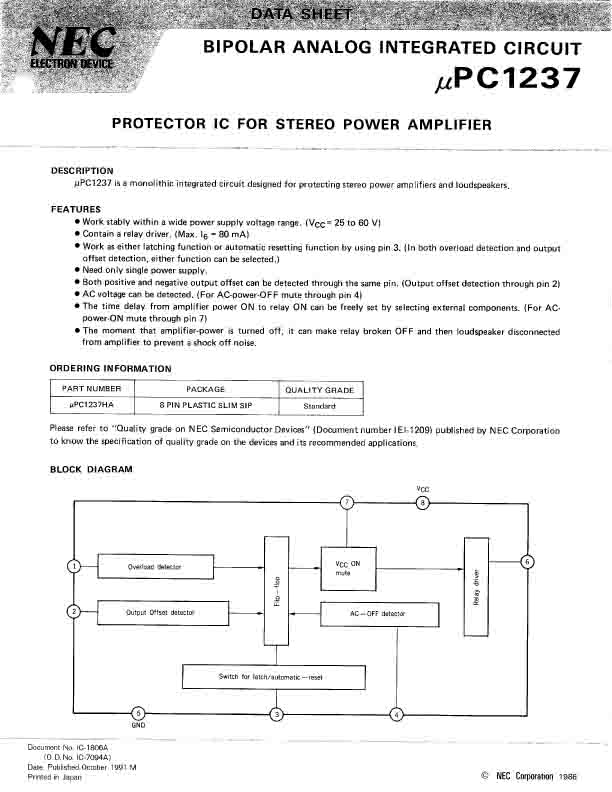

Hi quasi
Any development on short circuit protection?
UPC 1237 IC and some Trans may solve this
See this data sheet
cheers
ravi
See this data sheet
cheers
ravi

salut alex mm🙂
Great job
Temperature and dc protection, delay turn on relay this is really very nice
but short circuit protection is missing!
hear an idea for quasi 300/500 amp short circuit protection using 1237 (not tested )😉
cheers
ravi
Great job
cheers
ravi
