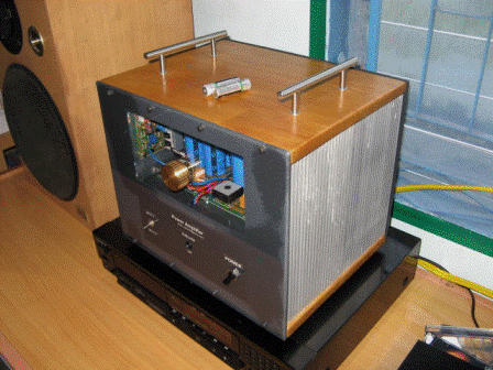

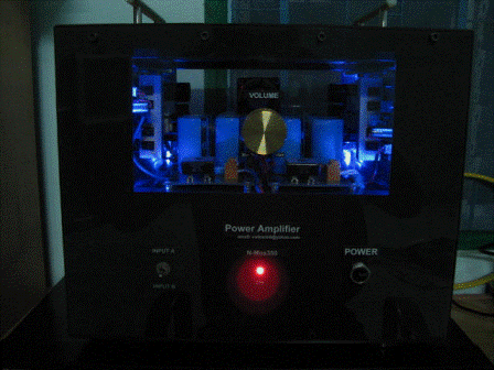

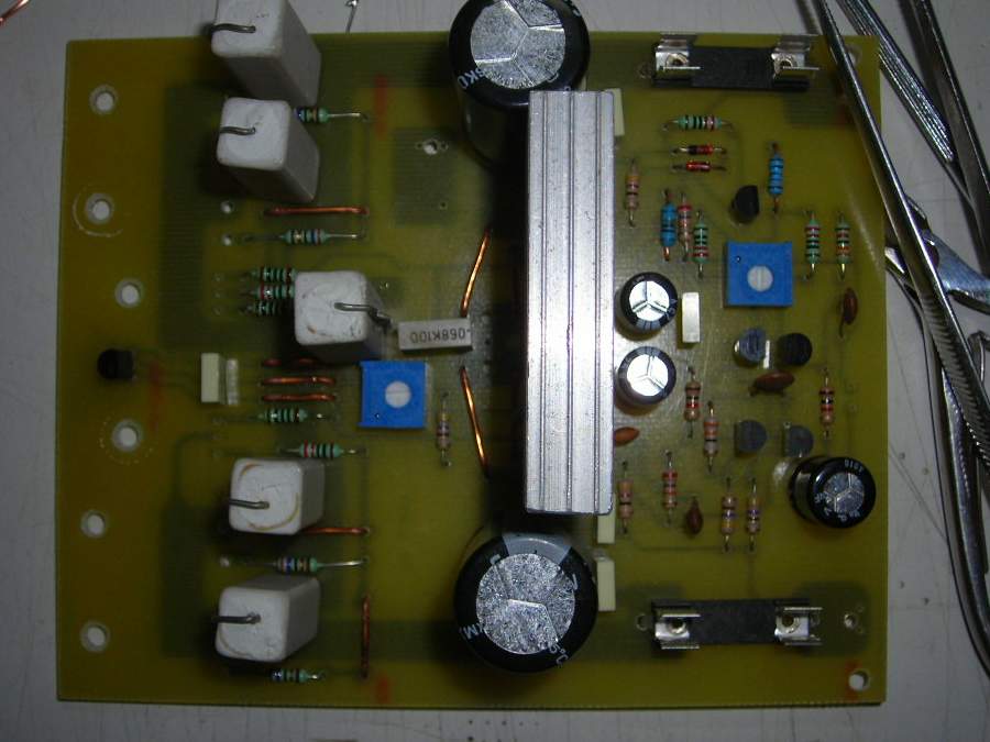

Hello all,
I finished my Nmos350 amplifier. I'm very happy because it's nice working just only small heatsink very hot (I can't touch 5 seconds). Therefore I must be use small fan. I can't say so much because my English very poor.
Thanks for design's Quasi and all of DIYer.
I think Thanh is refering to the small heatsink for the 2nd and 3rd stage transistors. This can be quite warm depending on the rail voltage used. The MJE340 / 350 are quite rugged though and will still dissipate 11 watts at 80 degC. This is one of the reasons they were selected. If you are concerned by this then you need to use a larger heatsink with more surface area, or use fan cooling.
Anyway Thanh, this is one of the most creative and nicest Nmos350 builds I have seen. Well done.
I do agree with Zeonrider though. The airflow for the large heatsinks is blocked by the top panel. Then maybe with heatsinks that big it does not matter, please let us know.
Finally that looks like a very heavy amp sitting on top of your other units.
Cheers
Q

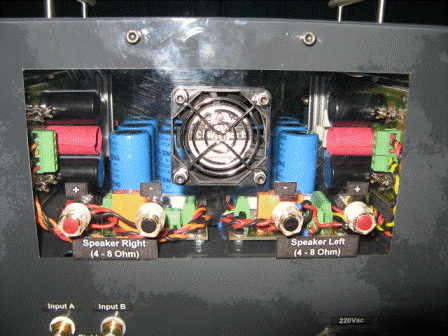

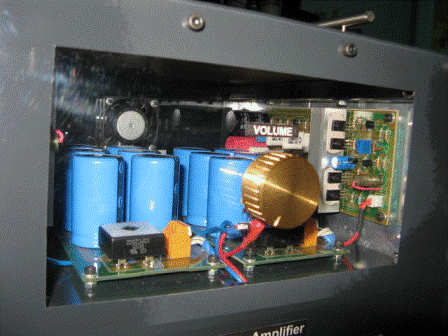

If these huge heatsinks are getting so hot then a bias problem must there (too high bias). What's your current bias setting?
The rail voltage use +/- 53Vdc. My current bias setting is 60mA because I use 2 pair IRFP450. The Huge heatsinks very cool then small heatsinks of MJE340/350 very hot.
Hi Quasi
Yes, I use small fan at back amp. I can not use larger heatsink that not enough space to do.
Thanks all.

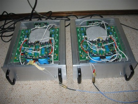

Re: First monoblock is working
This evening I completed the initial debug of the first of two 400W/ch error-correcting monoblock unitsutilizing BUZ901/906 series lateral MOSFETS...
The attached image shows the two monoblock amps. Positive and negative output stages are thermally attached to the two heatsinks on either side. The (gain stage) differential, VAS, and EC, resides on a separate PCB that is attached to the front panel and is not visible. The PCB in the center foreground is for power distribution and connects to the main electrolytics as well as a pair of floating +/- 15V supplies for the EC and +/-12V supplies that boost the main supply of +/-65V to +/- 78V that supplies the gain stage. The small PCB at the back is for power management and implements inrush limiting and speaker turnon delay.
I have tested the amps up to 400W/ch into 4 ohms || with 0.5 ohm and 1 uf, withno signs of instability.
I still have to complete wiring to the input jack (that is why there is loose wiring coming out of the top). Other than that, the monoblock amps test out fine and sound great driving a pair of Snell type A speakers. All that remains is to disassemble the chassis, send it to the anodizing shop, and then put things back together.
