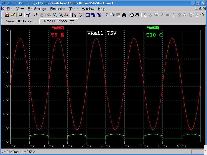

Hi All,
I have been snooping about with LTspice simulation until I have the time to make a special prototype board for the NMOS350. This will be the first of a few questions I like to ask the "experts" until I have a chance to confirm my simulation observations with a prototype board designed to allow me to "tinker".
The attachment shows that T9-E (input to +Vrail output MOSFETs) seems to swing almost the full +Vrail to -Vrail (+75V to -75V) 68.1V to -61.9V, while T10-C (input to -Vrail MOSFETs) only swings a few volts -75V (-Vrail) to -68.3V. This despite a symetrical voltages +68.8V to -61.4V and +63.4V to -66.7V for T9-B and T10-B respectively.
Does this simulation concur with the actual module behaviour? If so, can anyone offer an explaination why there is such a big difference in the output of T9-E vs T10-C bevahiour?

AndrewT said:Hi,
do you mean drain and source of the driver Fets?
Which schematic should we refer to?
Hi Andrew,
I am referencing the current NMOS350 schematic and T9-E to R20/R23/R24/R25 voltage (red trace) and T10-C to R22/R26/R27/R28 voltage (green trace).

Hi Key,
you don't seem to understand quasi topology.
The Vgs of FETs behaves a bit like Vbe of BJTs.
The Vgs is nearly constant (around 4V instead of 600mV).
Now look at the gate voltages of T11 and T12.
Both are about 4V above their source voltages.
One is [-Vrail +4v] the other is [output voltage +4V].
As the -Vrail hardly moves you would expect that the FET source voltage to stay nearly constant and by topology, the gate voltage must also stay fairly constant. The variation on the gates is defined by the transconductance of the FETs. Look up the Id vs Vgs graph to see the voltage changes to turn the FET current up or down.
Now consider the upper FET bank.
The output rail moves with signal voltage. The FET source voltage must also move with the output voltage and this demands that the gate voltage must track the output voltage hence the swing from near rail to rail.
Does any of that make sense?

Hi Andrew,
One reason for my poking about with the simulation is for me to better understand the design.
The simulation does show a 5V difference between T11 and T12 Gate and Source is 5V. That is fine and that I understand.
The input signal is a 1KHz @ 1.9V P-P sine wave. Where I am not understanding is why there is such a difference in the gate voltages and lack of symmetry for the gate voltages with respect to the input signal? The simulation I posted is the drive gate voltage before the 27R0 gate resistors. This of course means the gates of the output MOSFETs are seeing a very different drive voltage that does not match the input signal symmerty.
Where my understanding seems to be lost is the lower MSOFET bank (-Vrail) voltage, does not swing in a symmetrical manner with respect to the upper MOSFET bank (+Vrail) voltage. All of the FETs have a 27R0 gate resistor. That said, I find the currents for R20 and R22 the same currents and symmetry, and alternating with each other. This makes sense as each alternates from 0ma to 30ma, where from 18ma to 30ma is the waveform and 0ma to 18ma appears to be the MOSFET threshold, but the voltages feeding the gates of the MOSFETs very different as I observed. So from a current perspective all looks fine for R20 and R22, but from a voltage perspective I am am not understanding.

Re: Post #2429
Andrew,
As a followup to Post #2429 I have attached the simulation output that shows the T9-E and T10-C voltages and the respective currents of R20 and R22. The simulation is with 75V rails and a 1.9 P-P sine wave input.

Hi all,
what are the little currents in R20 before it switches fully off/on?
They seem to go from 2mA to zero hold at zero, then rise to 2mA again before turning fully on when the curent jumps to 18mA upto 30mA and this mimics the current in R22.
Are those little 2mA wings something to do with crossocer distortion and lack of output FET bias current?

Hi Key,
using a simulator to learn HOW a circuit works is going to be confusing.
Learn how it works by following a schematic and doing some calcualtions on what currents are flowing during different parts of the output waveform's cycle, or during quiescent when output current is zero.
I would suggest that sims are for fine tuning and investigating the details after you know what is happening.
If you don't know where to look or what to expect you're unlikely to stumble into the operation generalities.
