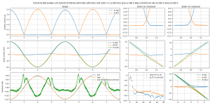

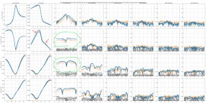

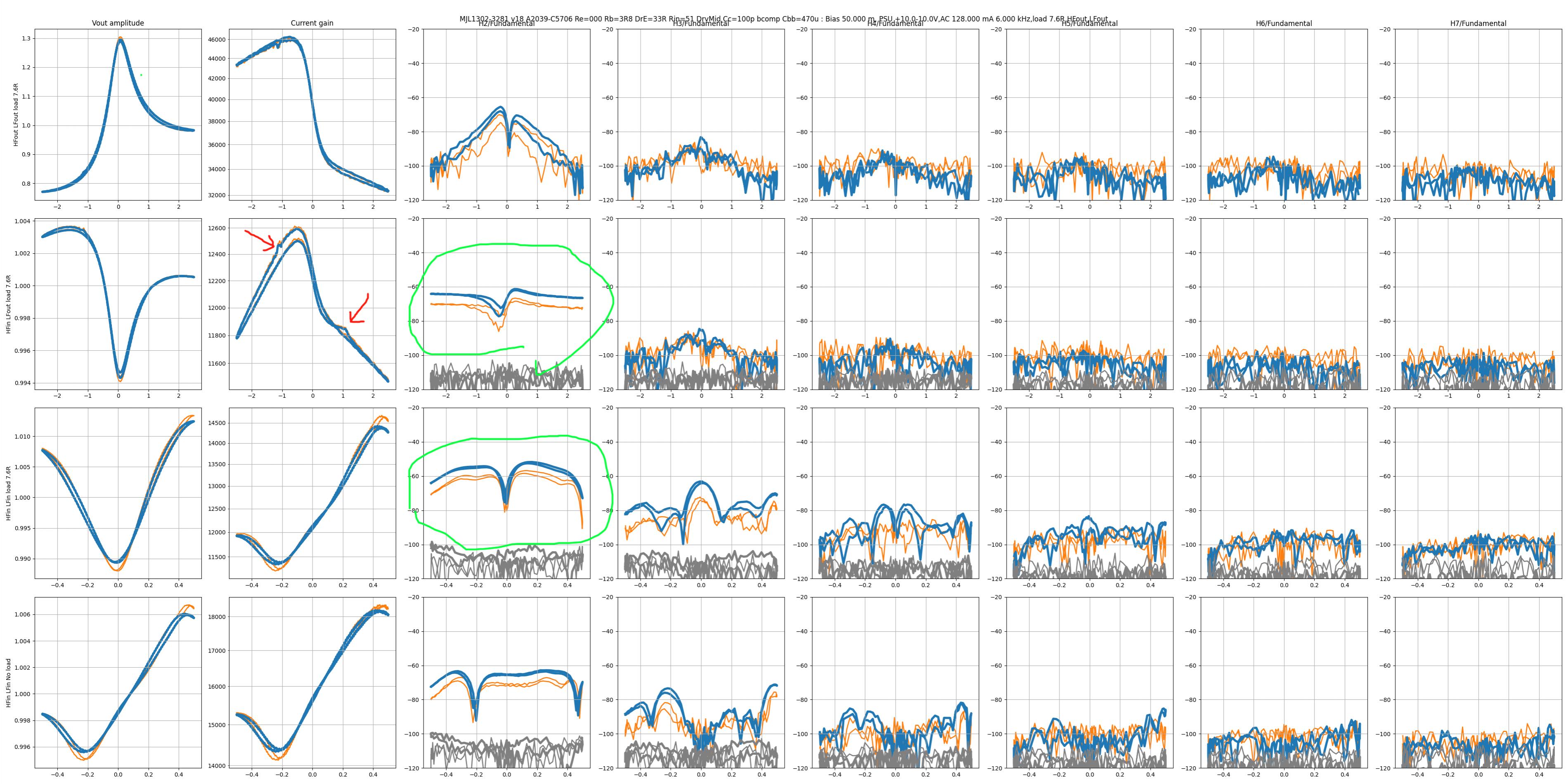

With the 470µF cap, increase in H2 occurs even in the class A zone, both transistors are on, so it is not related to turn on or turn off. It also occurs when only one transistor is on, long after the other turned off. It does not happen in simulation at all.
Class A output push pull stages don't work anywhere close to constant base charge/current, only a SE class A could be approximated this way. As such, while not related to switching on/off, a large capacitor will still impede the ideal large signal base charge variations. I would think that for a Class A push pull, no cap would be the best option, but I have no direct experience with that.
While a cap helps evacuating the stored charge in the bipolar base, a too large cap will slow down the turn on of the bipolars
I had a second look at measurement results and I think what you mention is happening where the red arrows point, on the current gain graph. There are two bumps that shouldn't be there. Thanks for pointing that out.
Green circle shows high H2 over the whole range of output currents though, not just at turn-on/turn-off. So the large capacitor doesn't cause one problem, but two distinct problems.
Note I used an "insanely high" value because I wanted to know if this circuit, which is supposed to work with a large cap, would actually work with a large cap. Well, it doesn't.

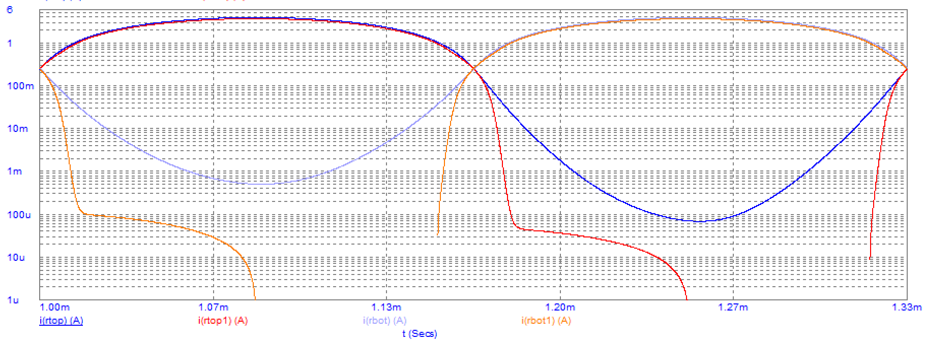

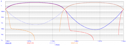

Yes, I think this is the case too. Here are the emitter currents of a push pull stage with (red) and without resistors (blue), in simulation:
I used a log vertical scale to make the low currents easier to see. Without resistors it stays in class A up to a much higher current, which means the transistor that will turn off does so at a lower di/dt, so it has more time to get rid of stored charge. Both factors mean a softer turn-off. On top of that, without emitter resistors, transconductance of the transistor that is on at this moment is not limited to 1/Re but much higher instead. The one that is turning off has very low transconductance, so if it tries to make a mess at turn-off, the other is better able to controls the output... unless the transistor that is turning off couples with the other's base through the "speedup cap" and forces it to output the wrong signal, which seems to be another gotcha with this cap.
In fact, since I replaced the slow drivers with faster ones and got rid of the emitter resistors, I'm not seeing any turn-off spikes at all with the MJL's.
What I am seeing is: when going through the middle of the crossover, gm gets lower, so the base voltage has to swing faster to compensate, and due to base capacitance this requires an increase in drive current at this point of the waveform. Basically, the Cbe*dVbe/dt part of Ib becomes significant relative to the Ic/hFe part of Ib. This also looks like a spike, but it's not the same mechanism.

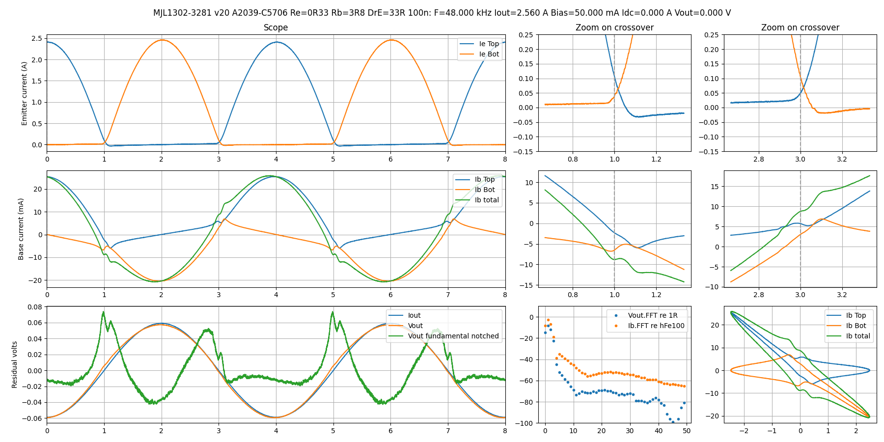

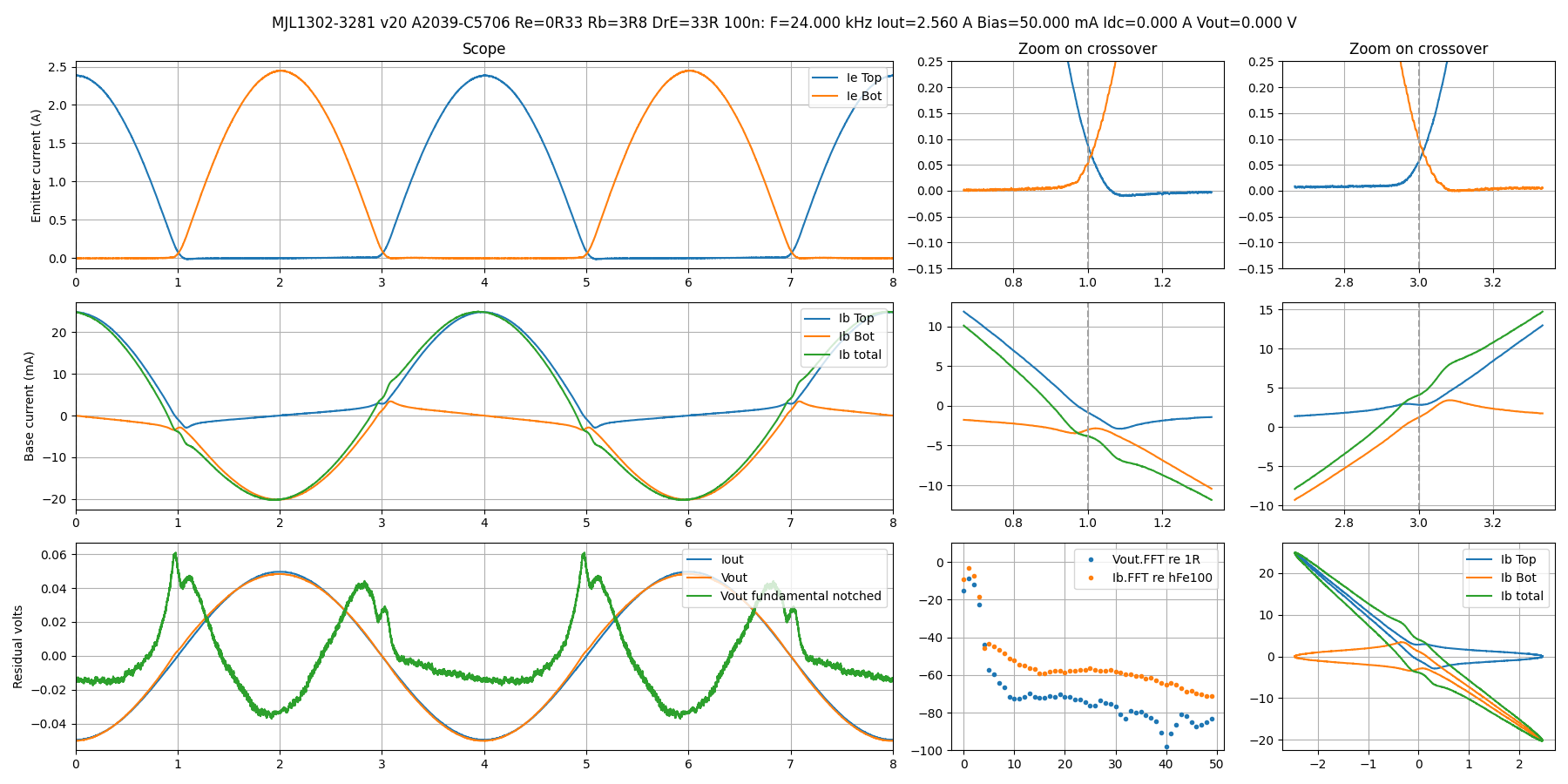

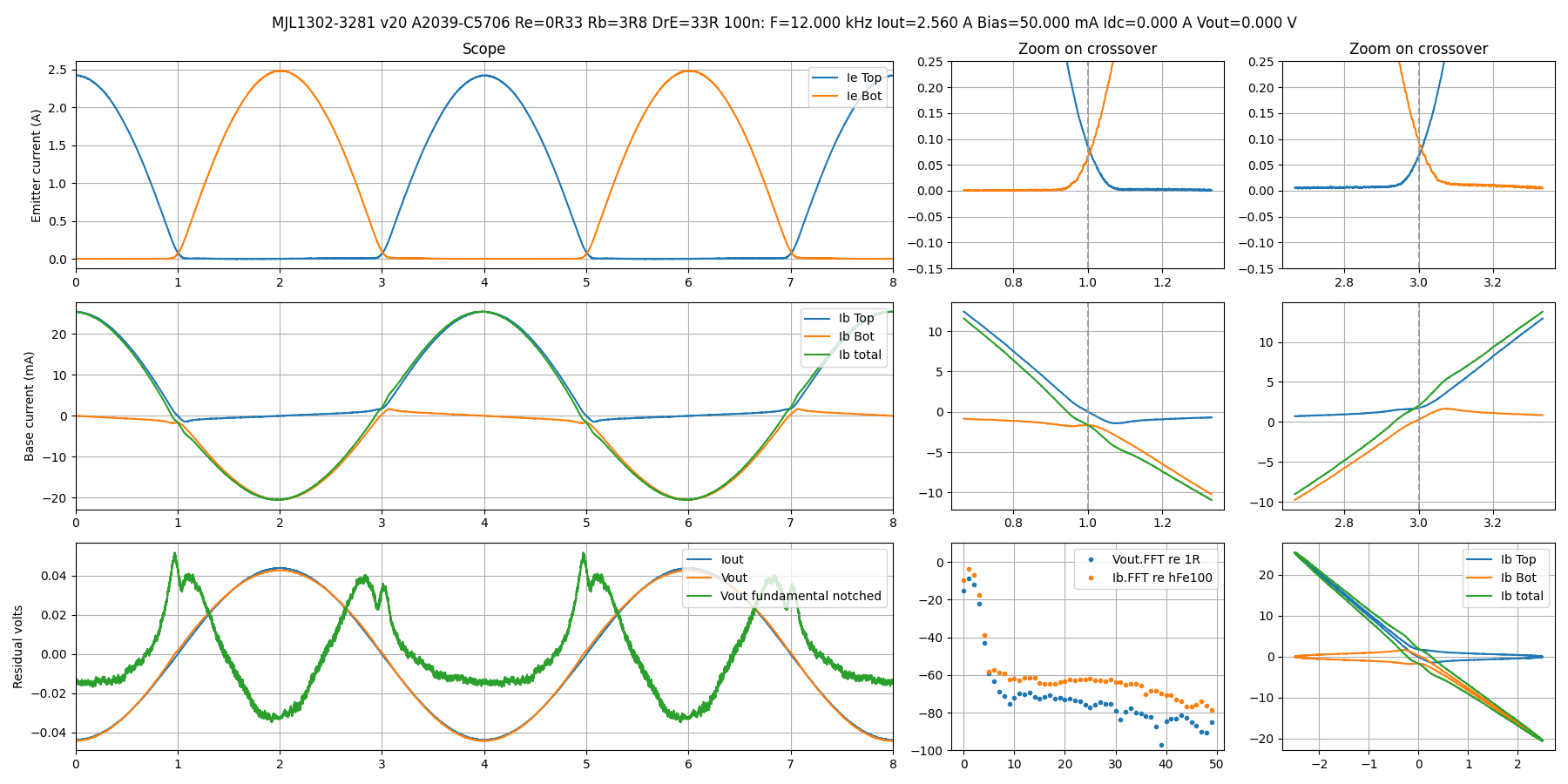

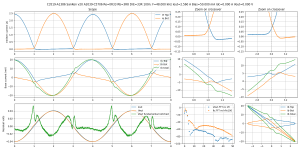

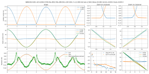

I re-ran MJL1302 and MJL3281 through the spike test for reference. This is 50mA bias, 2.5A current.
Much uglier with the emitter resistors than without them...
Can you share the schematics?
Meanwhile...
scope-Bias=50.000 mA Iout=2.560 A F=12.000 kHz--MJL1302-3281 v20 A2039-C5706 Re=0R33 Rb=3R8 DrE=.png262.1 KB · Views: 317
scope-Bias=50.000 mA Iout=2.560 A F=24.000 kHz--MJL1302-3281 v20 A2039-C5706 Re=0R33 Rb=3R8 DrE=.png277.8 KB · Views: 321
scope-Bias=50.000 mA Iout=2.560 A F=48.000 kHz--MJL1302-3281 v20 A2039-C5706 Re=0R33 Rb=3R8 DrE=.png289 KB · Views: 331

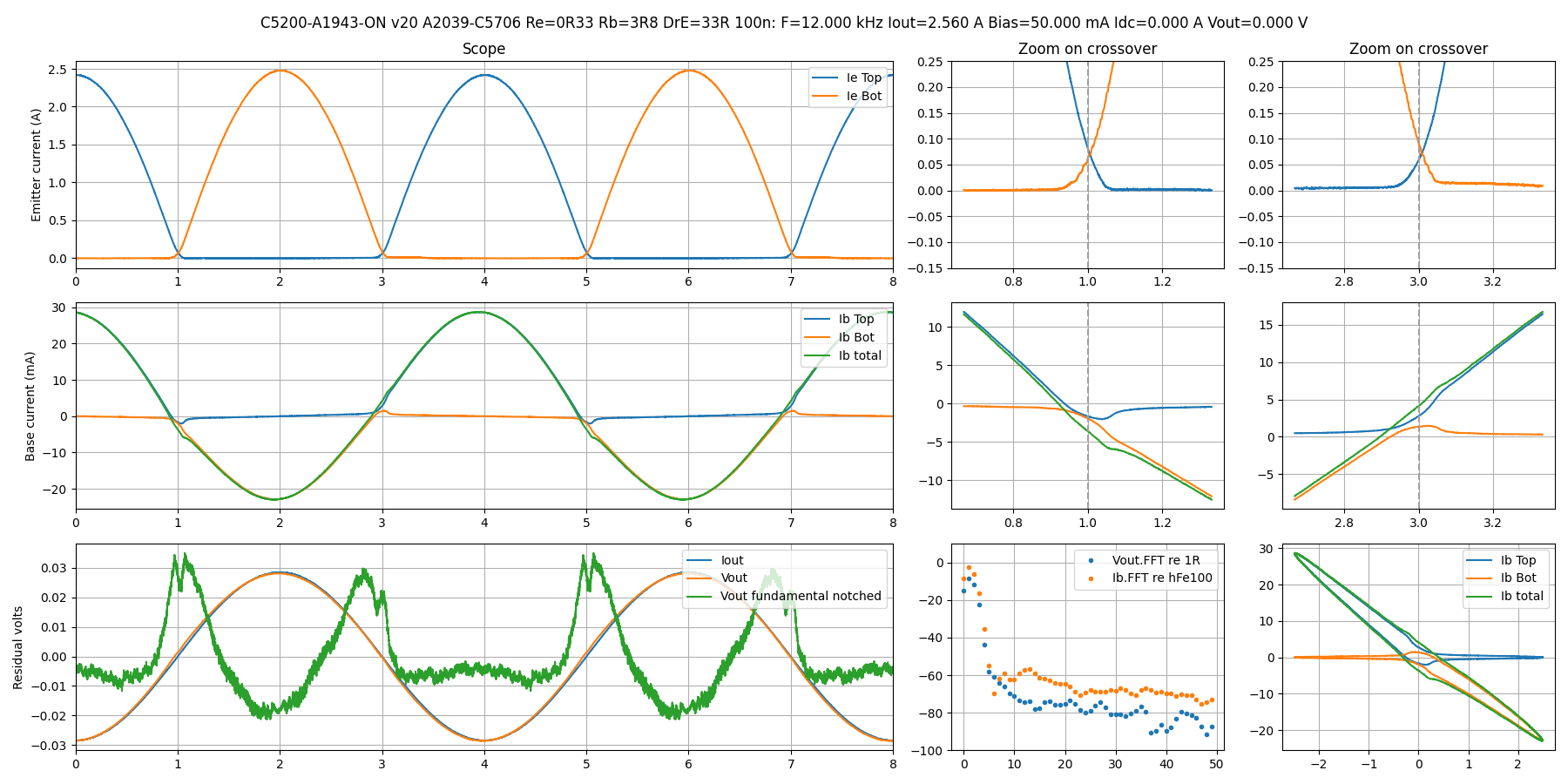

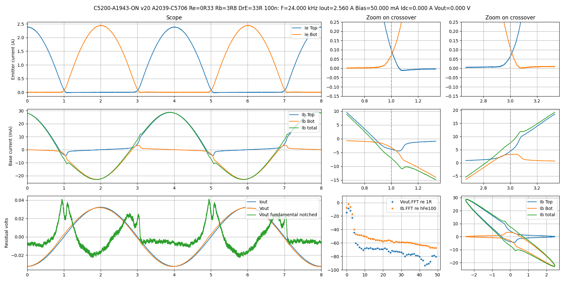

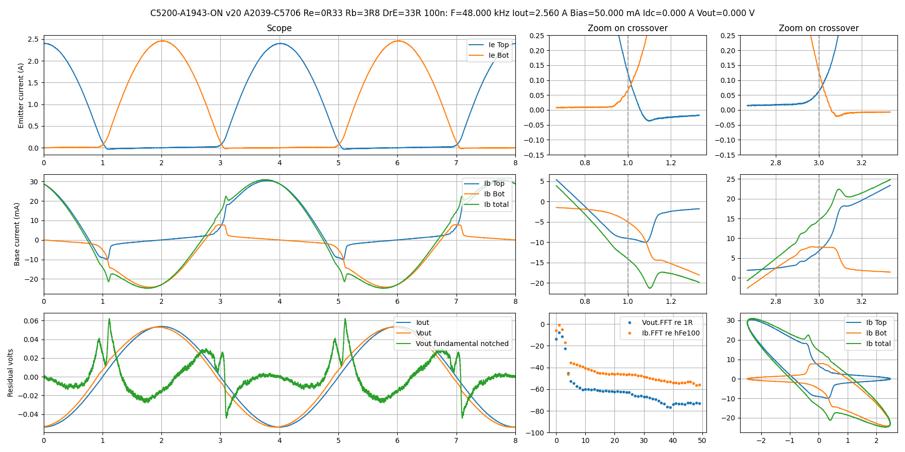

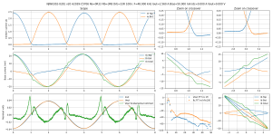

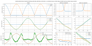

And this is the previously tested 2SC5200/2SA1943 from ON/Fairchild. I'm running them again to check the result is the same as before.
It is the same: they seem to take much longer to turn off, and when it finally happens, there is a vertical cliff on the THD residue (bottom plot).
FAIL
FAIL
scope-Bias=50.000 mA Iout=2.560 A F=48.000 kHz--C5200-A1943-ON v20 A2039-C5706 Re=0R33 Rb=3R8 Dr.png292.2 KB · Views: 317
scope-Bias=50.000 mA Iout=2.560 A F=24.000 kHz--C5200-A1943-ON v20 A2039-C5706 Re=0R33 Rb=3R8 Dr.png273.4 KB · Views: 309
scope-Bias=50.000 mA Iout=2.560 A F=12.000 kHz--C5200-A1943-ON v20 A2039-C5706 Re=0R33 Rb=3R8 Dr.png262.8 KB · Views: 140

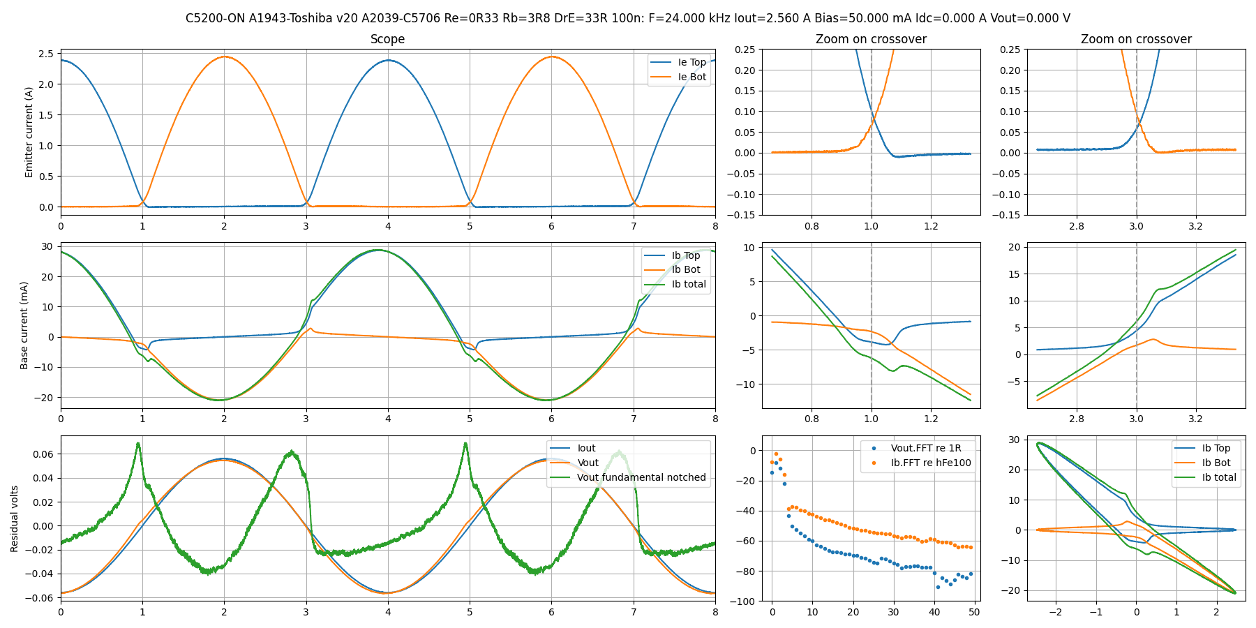

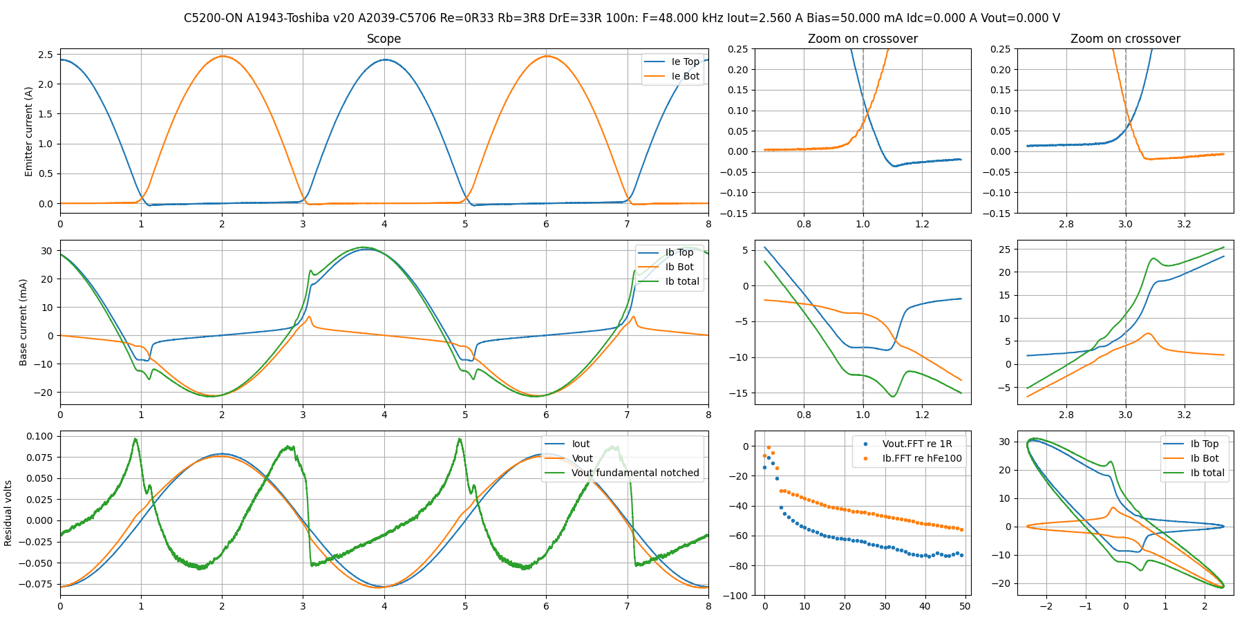

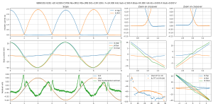

Unfortunately, Toshiba 2SC5200 was out of stock, but I got a Toshiba 2SA1943.
I test it paired with OnSemi C5200.
It is still a bit worse than the MJLs, but much better than the ON version.
So, if you like A1943/C5200, Toshiba looks like a better choice for this test.
A1943 from ON also had some hFe droop issues at high current, so I will keep these for the distortion test.
I hope I can find a Toshiba C5200...

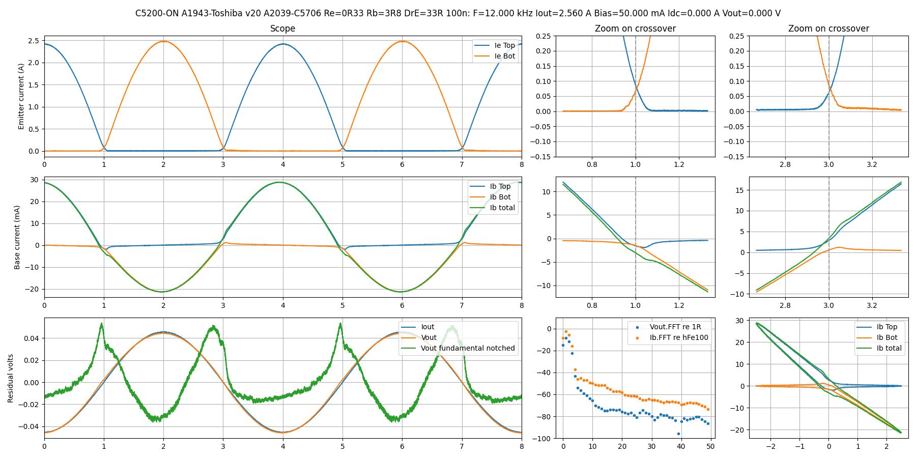

scope-Bias=50.000 mA Iout=2.560 A F=12.000 kHz--C5200-ON A1943-Toshiba v20 A2039-C5706 Re=0R33 R.png261.9 KB · Views: 108
scope-Bias=50.000 mA Iout=2.560 A F=24.000 kHz--C5200-ON A1943-Toshiba v20 A2039-C5706 Re=0R33 R.png277 KB · Views: 109
scope-Bias=50.000 mA Iout=2.560 A F=48.000 kHz--C5200-ON A1943-Toshiba v20 A2039-C5706 Re=0R33 R.png296.4 KB · Views: 132

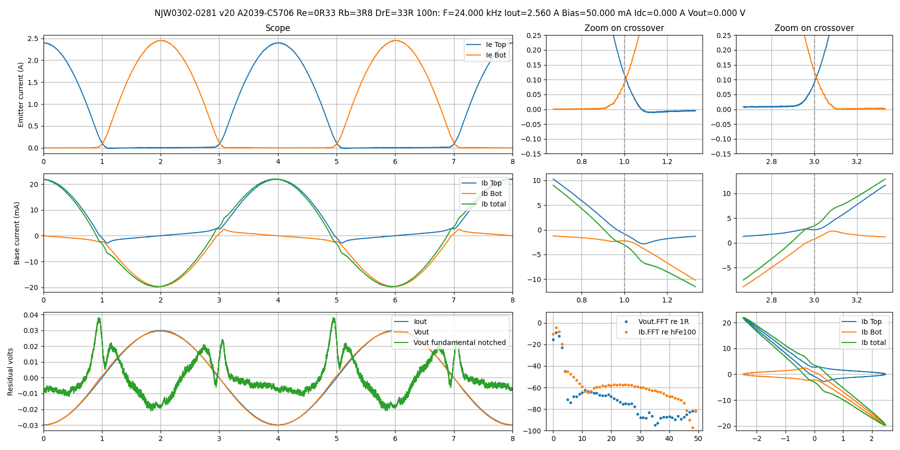

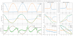

NJW0302/NJW0281 from ON are the smaller cheaper versions of the big MJL transistors.
They behave in a very similar manner, turn-off is even a little bit cleaner.
Being smaller, they self-heated to about 120mA on the 50mA setting, whereas the big ones only self-heated to 75mA. That doesn't change the results much, because with resistors, you always get the switching spikes no matter what the bias is 😀
Result: WIN
Result: WIN

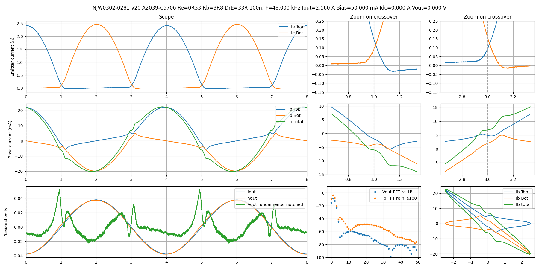

scope-Bias=50.000 mA Iout=2.560 A F=48.000 kHz--NJW0302-0281 v20 A2039-C5706 Re=0R33 Rb=3R8 DrE=.png286.1 KB · Views: 146
scope-Bias=50.000 mA Iout=2.560 A F=24.000 kHz--NJW0302-0281 v20 A2039-C5706 Re=0R33 Rb=3R8 DrE=.png278.9 KB · Views: 127
scope-Bias=50.000 mA Iout=2.560 A F=12.000 kHz--NJW0302-0281 v20 A2039-C5706 Re=0R33 Rb=3R8 DrE=.png263.4 KB · Views: 113

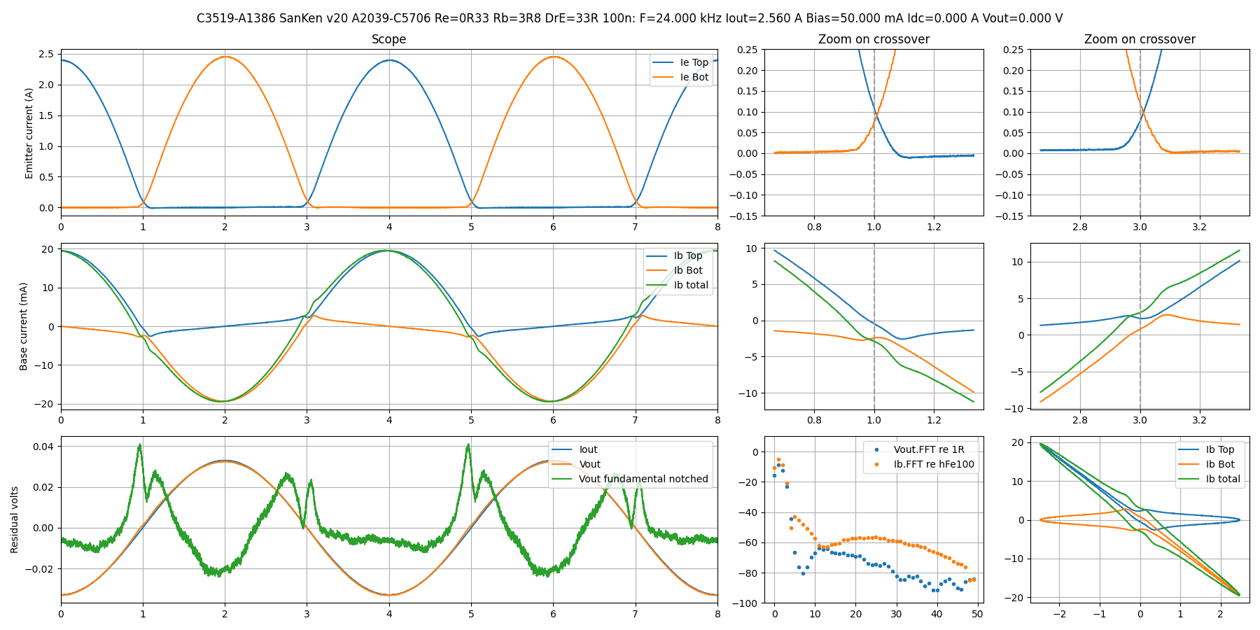

SanKen C3519-A1386 from Bensen 😀
They are very similar to ON NJW0302/0281.
ON's have a few dB less harmonics on the FFT, but the SanKen's have better hFe matching, although that could be a lucky pair.
Result: WIN
Result: WIN
scope-Bias=50.000 mA Iout=2.560 A F=48.000 kHz--C3519-A1386 SanKen v20 A2039-C5706 Re=0R33 Rb=3R.png287.6 KB · Views: 141
scope-Bias=50.000 mA Iout=2.560 A F=24.000 kHz--C3519-A1386 SanKen v20 A2039-C5706 Re=0R33 Rb=3R.png276.2 KB · Views: 132
scope-Bias=50.000 mA Iout=2.560 A F=12.000 kHz--C3519-A1386 SanKen v20 A2039-C5706 Re=0R33 Rb=3R.png267.7 KB · Views: 125
