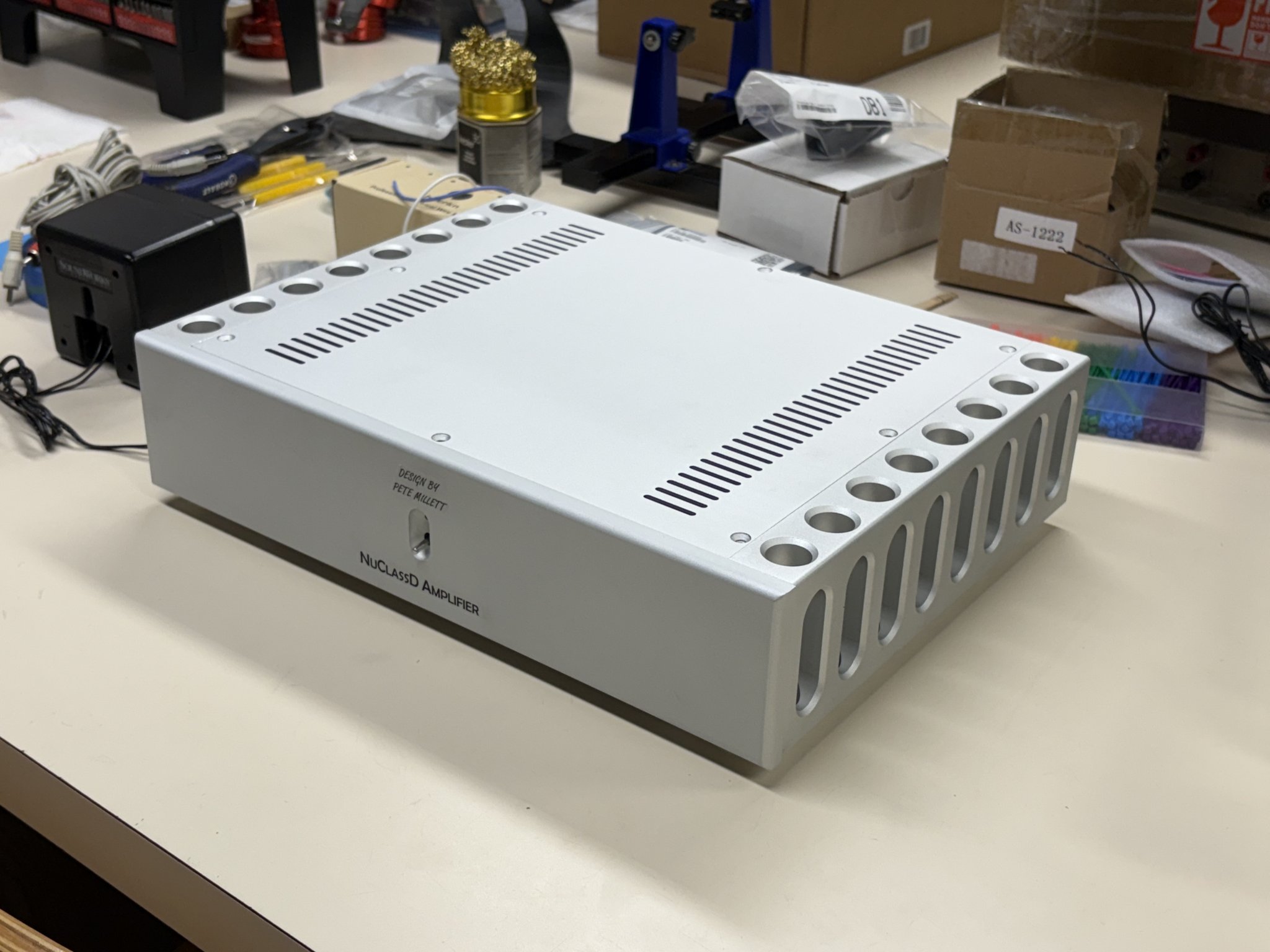

Hello Steve, your amp is one of the nicest builds I have seen on these forums.. Could I ask where you obtained your enclosure?
Thanks,
Ken
Thanks,
Ken

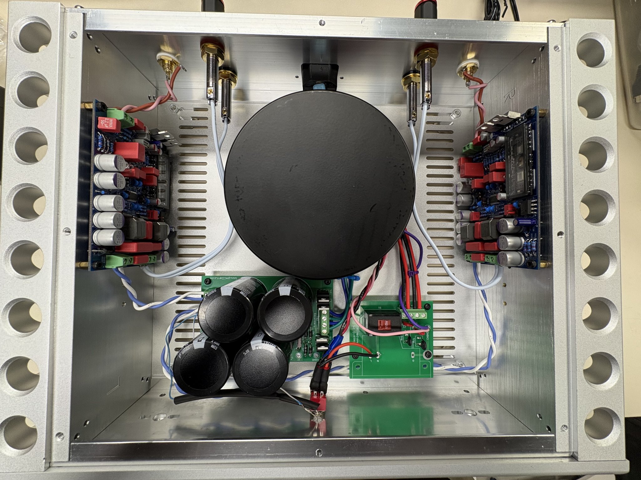

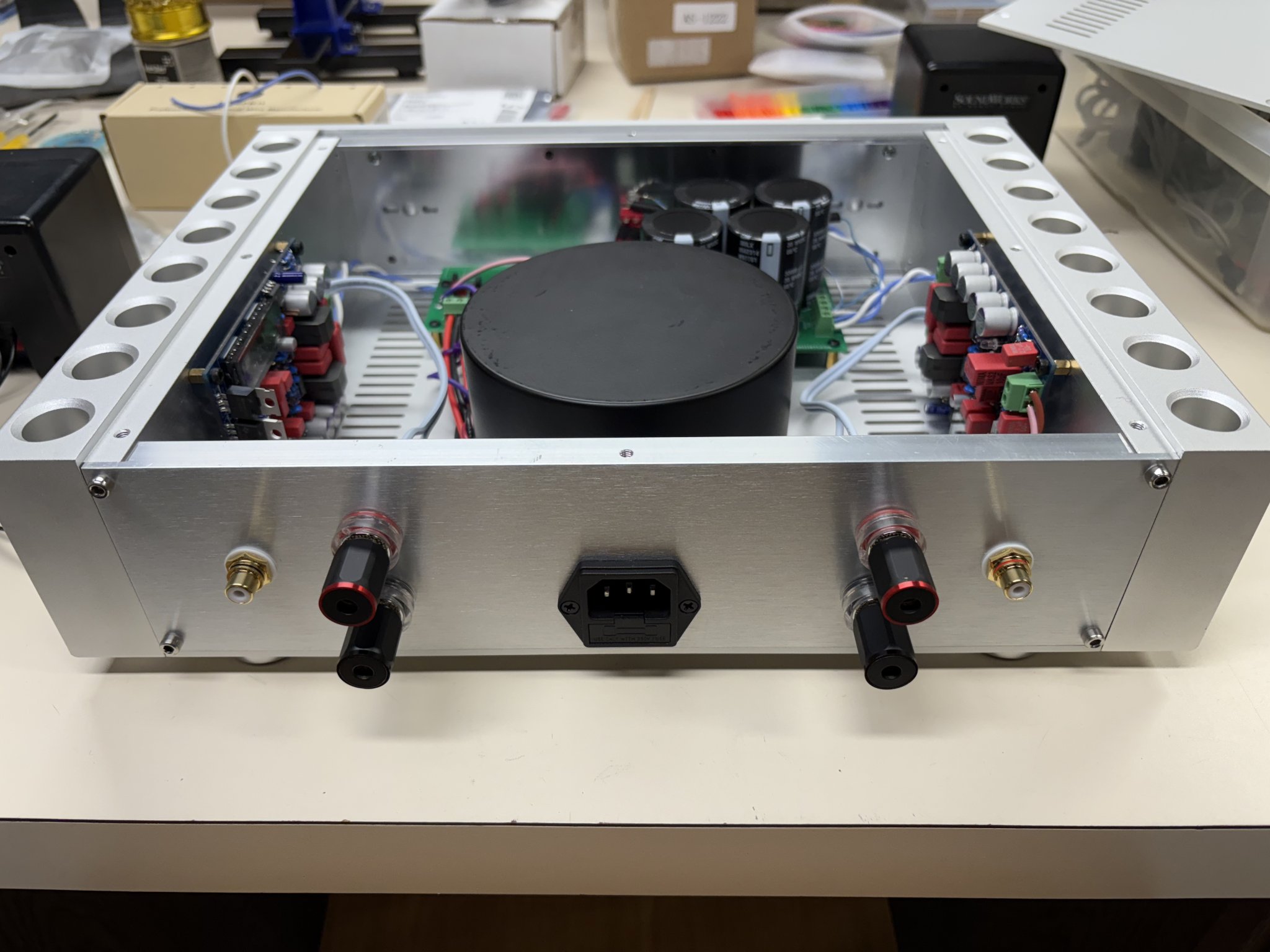

Thank you Ken 🙂 It's just an aluminum case from China via eBay. It is beautifully finished - there were no manufacturing defects that I could see. I knew I needed at least 80mm of height to fit the boards vertically, so that's all I searched for. I wish it came in black, but it doesn't. I loved the case so much I tried to find the amp kit that the heatsinks are predrilled for but never found anything. I would totally buy another one just the build the amp it was designed for lol.
Yukon888:I built mine using the Landfall Systems chassis, like Pete did.
If you want to use the Landfall chassis, the power led, binding posts, and rca jacks are not listed in the bom. Here's what I used:
RCA Jacks:
NYS367-2 - red
NYS367-9 - white
Speaker binding posts:
Keystone 4109
Front panel power light:
CNX722C400FVW (amber)
Pete uses CNX722C600FVW (blue) from the same series.
I just emailed them to order one of these up and it seems Pete M recommendeds a 3" wider chassis now. Yours looks like the original dimensions?
