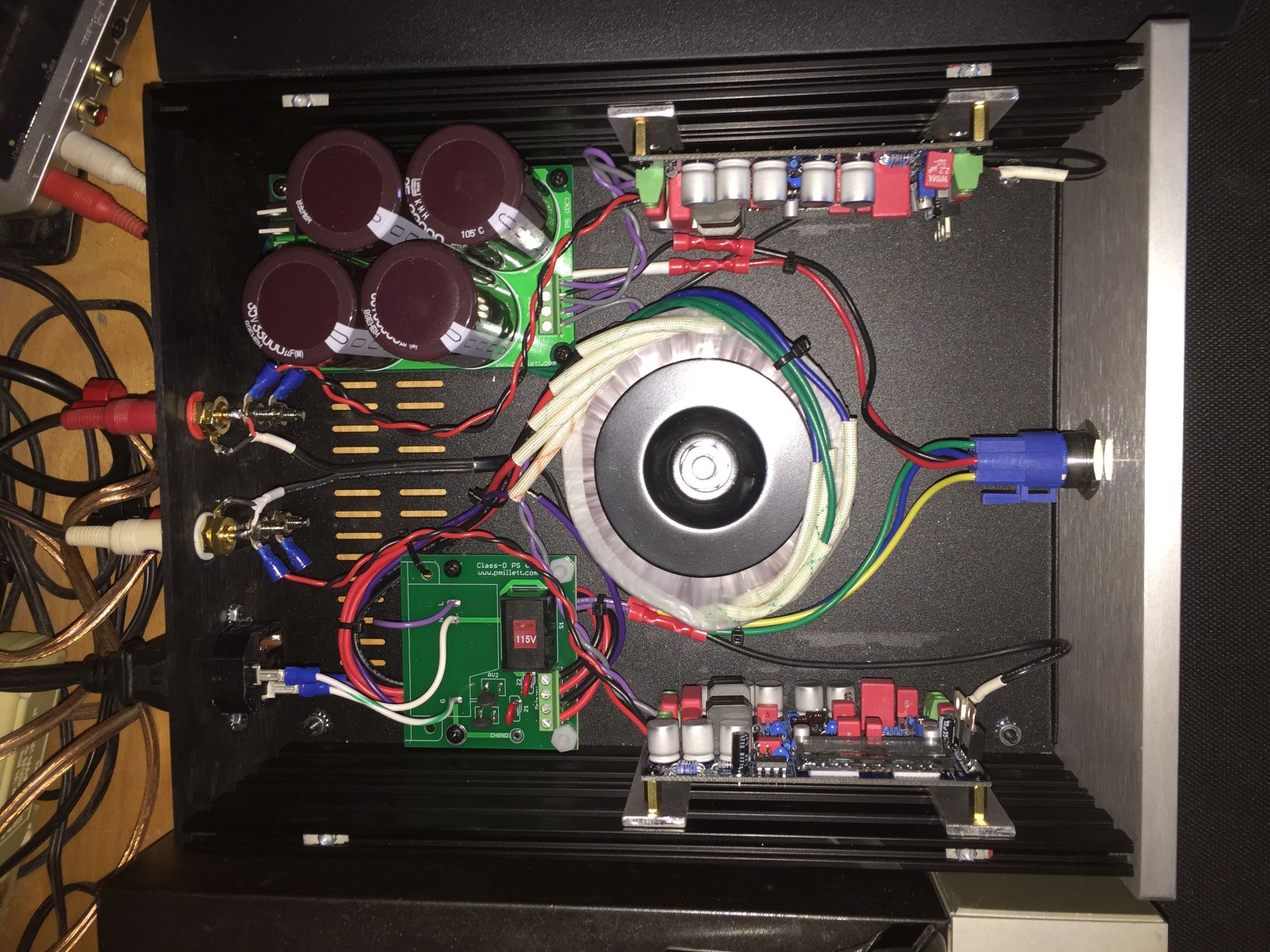

NuClassD Amp Build Notes
Here's my build for a NuClassD stereo amp with common power supply. All parts used for the PCB ended up being stock per Pete's BOM except the Korg plate resistor values (more on that later). I also used his power supply PCB and BOM.
This is not a project for newbees. It is perhaps the most difficult PCB I have ever stuffed and soldered. It has a very tight layout. An extra fine tip iron and small diameter solder is recommended, along with a magnifier for construction and inspection. Also, a lot of patience and minimal coffee for a steady hand.
A few spots (mostly at ground plane locations) have what appears at first to be funky thru hole plating but all solder joints turned out functionally OK. When I first fed a 1K sine wave into a board and put my dual trace scope on both the input and output to have a look at the waveform and look for the unwanted, I was greeted by a flashing fault LED. There was that sinking feeling until I had the “oh, duh!” moment when I realized the scope probe negative clip was grounding the negative side of the loudspeaker output, a total no-no for a bridged amp design. But nice to know the protection circuit works. I ended up checking for DC on the outputs with my Fluke meter and found around 10 – 15 mV, terminals unloaded, a very reasonable value.

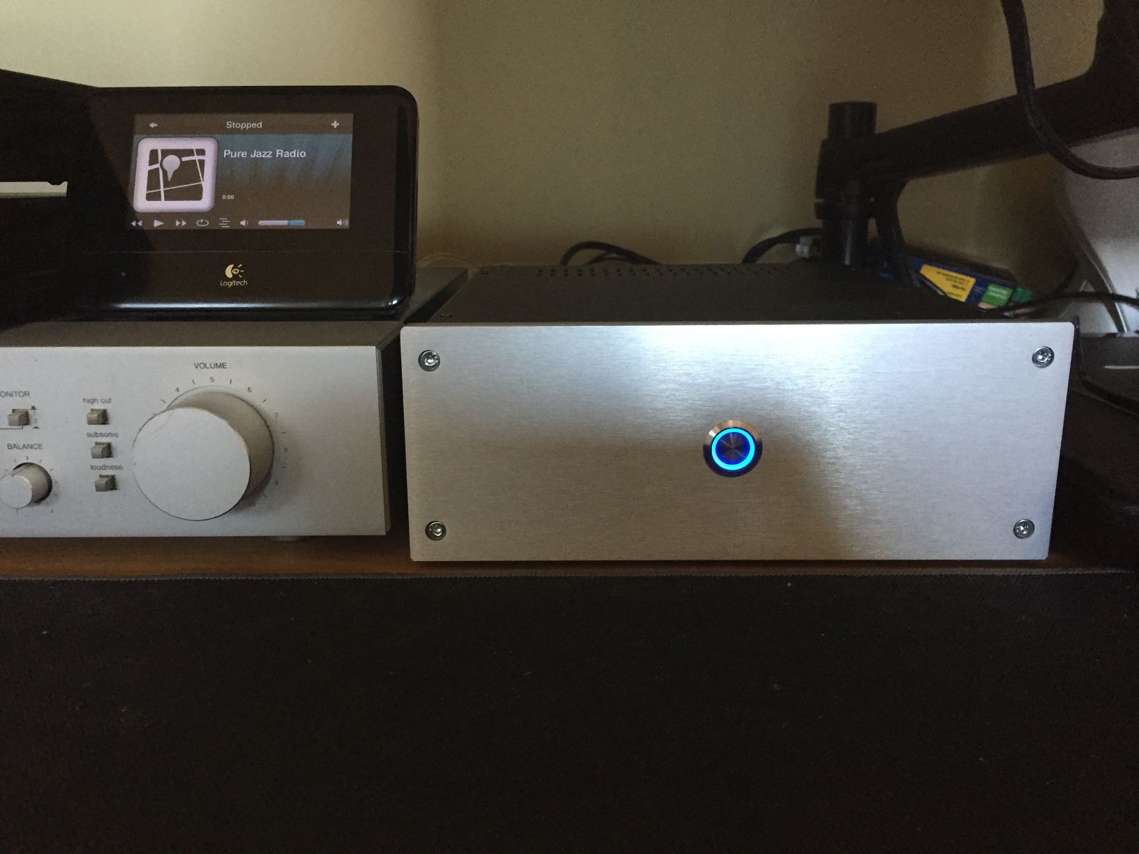

The chassis is a diyAudio store Galaxy 2U 230X280 w/ 10mm front panel. The integral LED ring front panel power switch is an API-ELE 19mm Latching Push Button Switch purchased from Amazon. It's essentially a Bulgin knockoff for under $10. I used a 10K external current limiting resistor in addition to the internal 12V one for setting the LED brightness. I used a different IEC unswitched fused power socket that I had on the shelf and mounted the IEC PCB separately on standoffs.
This is not an inexpensive project for a 50 w/ch class D amplifier. Total parts cost was about $400. My leap of faith was based on a positive outcome from building Pete's NuTube Buffer preamp. On first listen to this amp I was a bit dismayed, but only a bit, because I had found it impossible to run the Korg plate voltages at less than 14.2 VDC. Pete's schematic showed 13 VDC. A quick email to Pete and an equally quick response came with a recommendation to change the plate resistors to 150K, perhaps as high as 200K, since I said I was looking for more second order harmonic. I settled on 160K and 11.75 VDC on the plates. Channel gain was set using a 0.1V 1kHz sine wave input, starting with one channel at the multi-turn pot mid-point (nominally 1 meg total of NFB resistance), measuring the output voltage on that channel and then adjusting the other channel's output to match.
How does it sound? I've been listening at my desk on a pair of mid-1980's ADS 6” 2-way bookshelf speakers. Preamp is an even older harman/kardon hk 725 discreet FET design. The ADS had previously always sounded a bit soft and tubby in the bottom end. Not any more. Nice tight bass, plenty of power. That clarity and control extends across the entire bandwidth. This is a very revealing amplifier with a bit of triode excitement thrown in. I am preferring the h/k preamp set at -2 dB in the treble (10kHz knee) on most source material.
My next step is to connect it to my REW distortion analysis setup running on my PC and see what is going on with the balance between second and third order harmonic content. I may yet play around some more with the plate loading on the Korg tube. So far, the more I listen to this amp, the more I like it, which is a good sign. In the past, I've easily spent $400 building FirstWatt Class A clones from the diyAudio store. This amp holds it's own against them in overall quality but is a very different beast. If you are up for a build challenge, this might just be your amp.

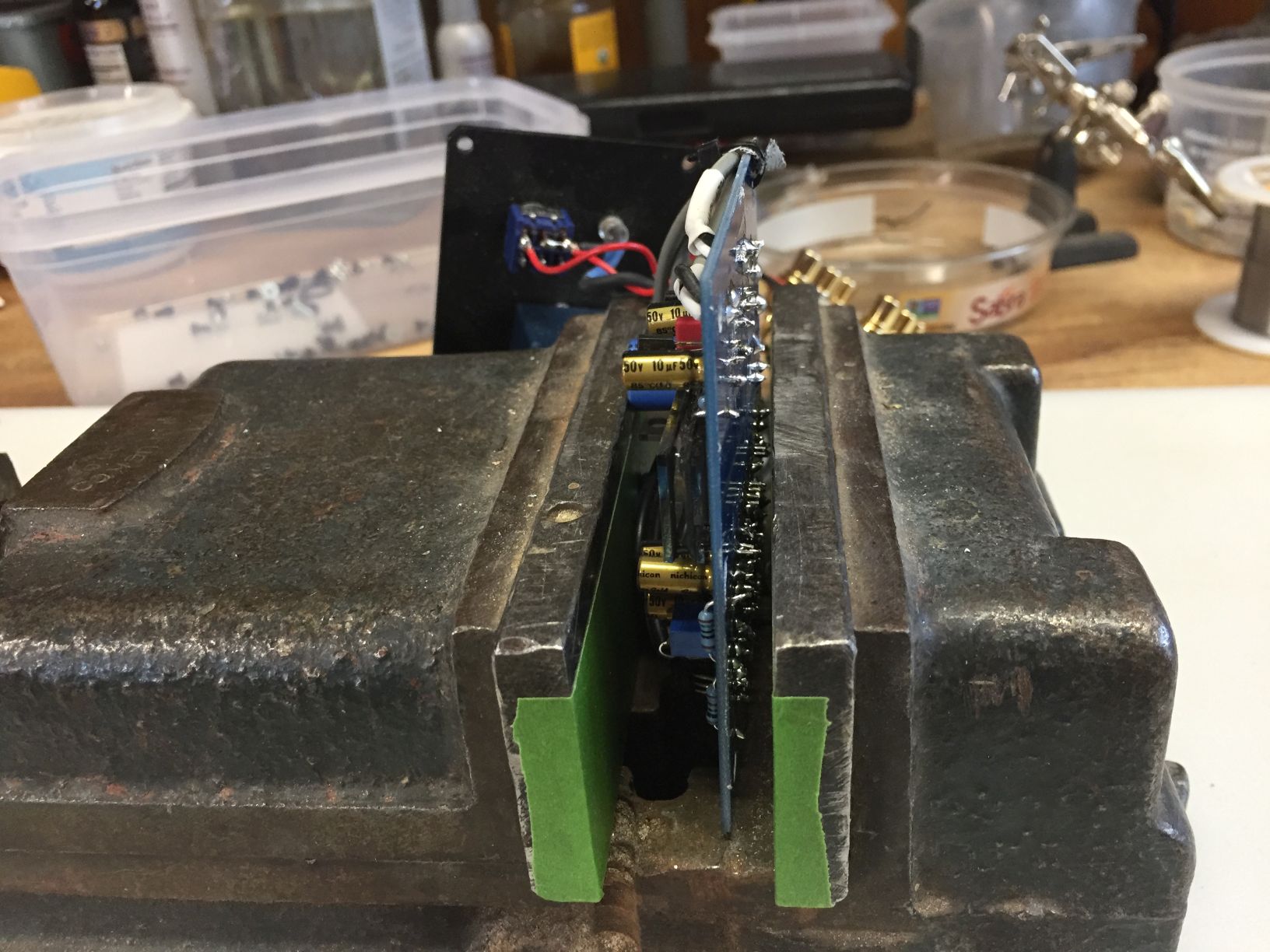

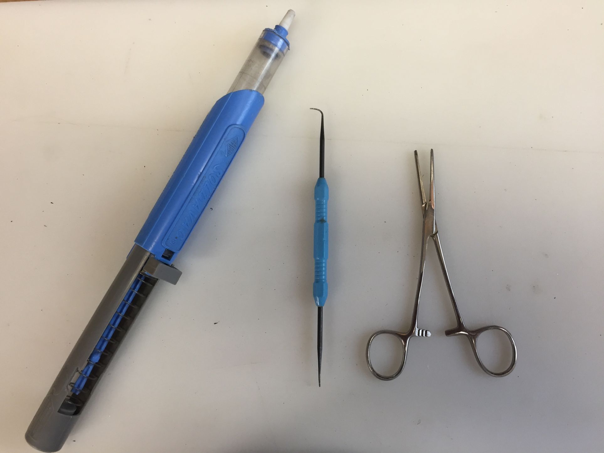

In the mean time, changing R4 on the NuClassD PCB can be daunting due to the tight spaces and thru-hole plating, so I thought I'd share how I do it relatively painlessly:
First, you need some way of holding the PCB vertically on edge. If you are right handed, with the component side to the left and the bottom side to the right. I use an old smooth jawed drill press vise with the jaws taped and barely closed enough to keep the board stable. Some blocks of wood screwed or clamped to a board or something else could also work.
You also need a serrated jaw locking hemostat, a solder vac tool and a very slender tapered pick or needle with a point smaller than a PCB trace hole tapering smoothly up to something larger than the hole.
Start by marking the bottom of the PCB with a fine point sharpie. I draw a line between the two pads I am about to desolder. This makes relocating the pads easy and helps reduce mistakes. Clamp the tip of the hemostat on the component side to one leg of R4 and hold the tool in a way that allows some extended spare fingers to apply pressure to the component side of the board. Apply the soldering iron tip to the pad on the bottom and the resistor leg should pull right out fairly easily. Repeat with the other leg.
Now apply the solder vac perpendicular and tight to the component side of a hole, the iron to the other and suck out the leftover solder. Take a look against the light to make sure the hole is completely clear. Finally, use the pick or needle on each side of the hole to gently burnish away any micro roughness.
