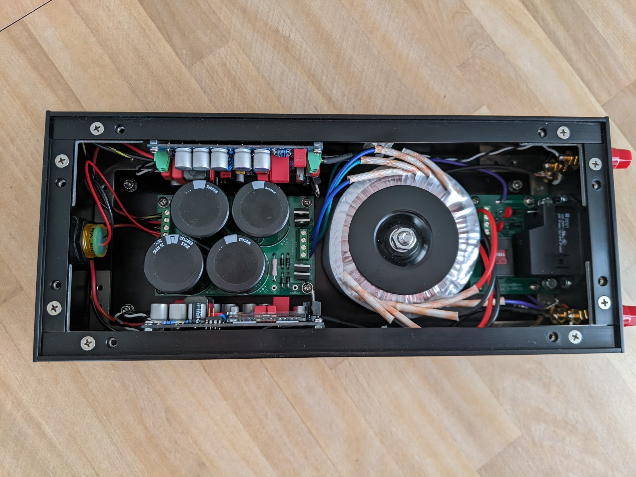

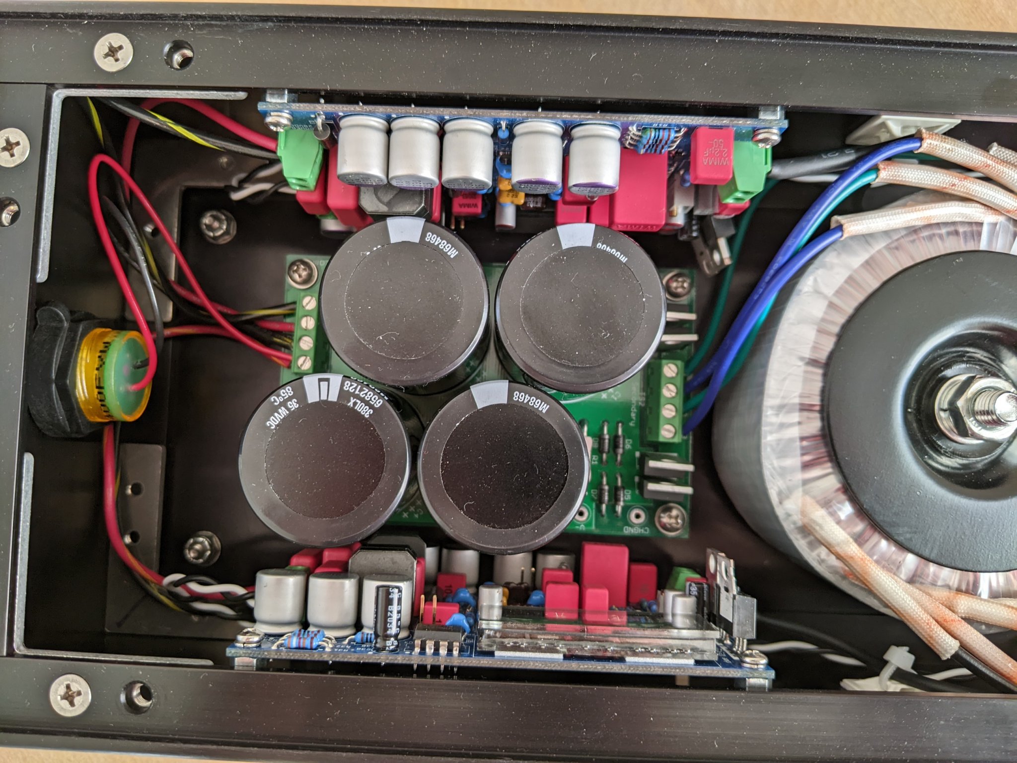

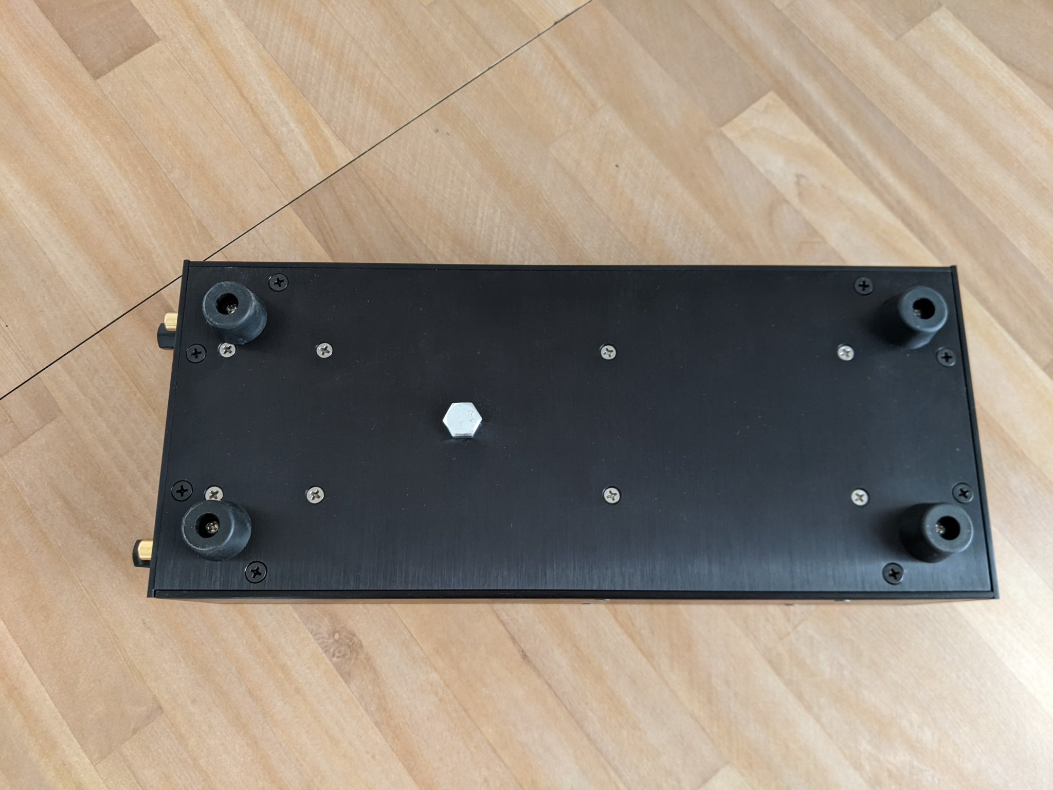

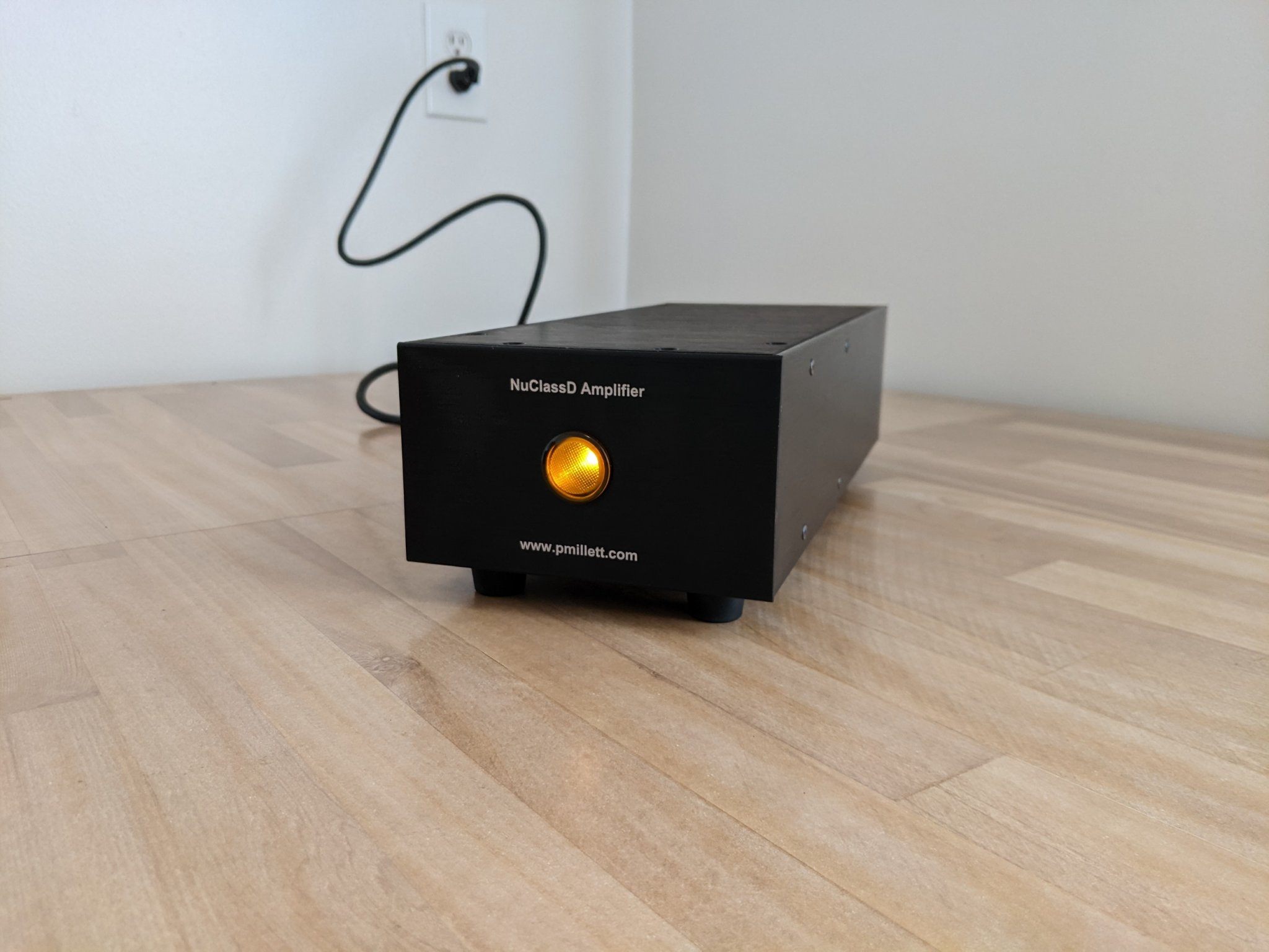

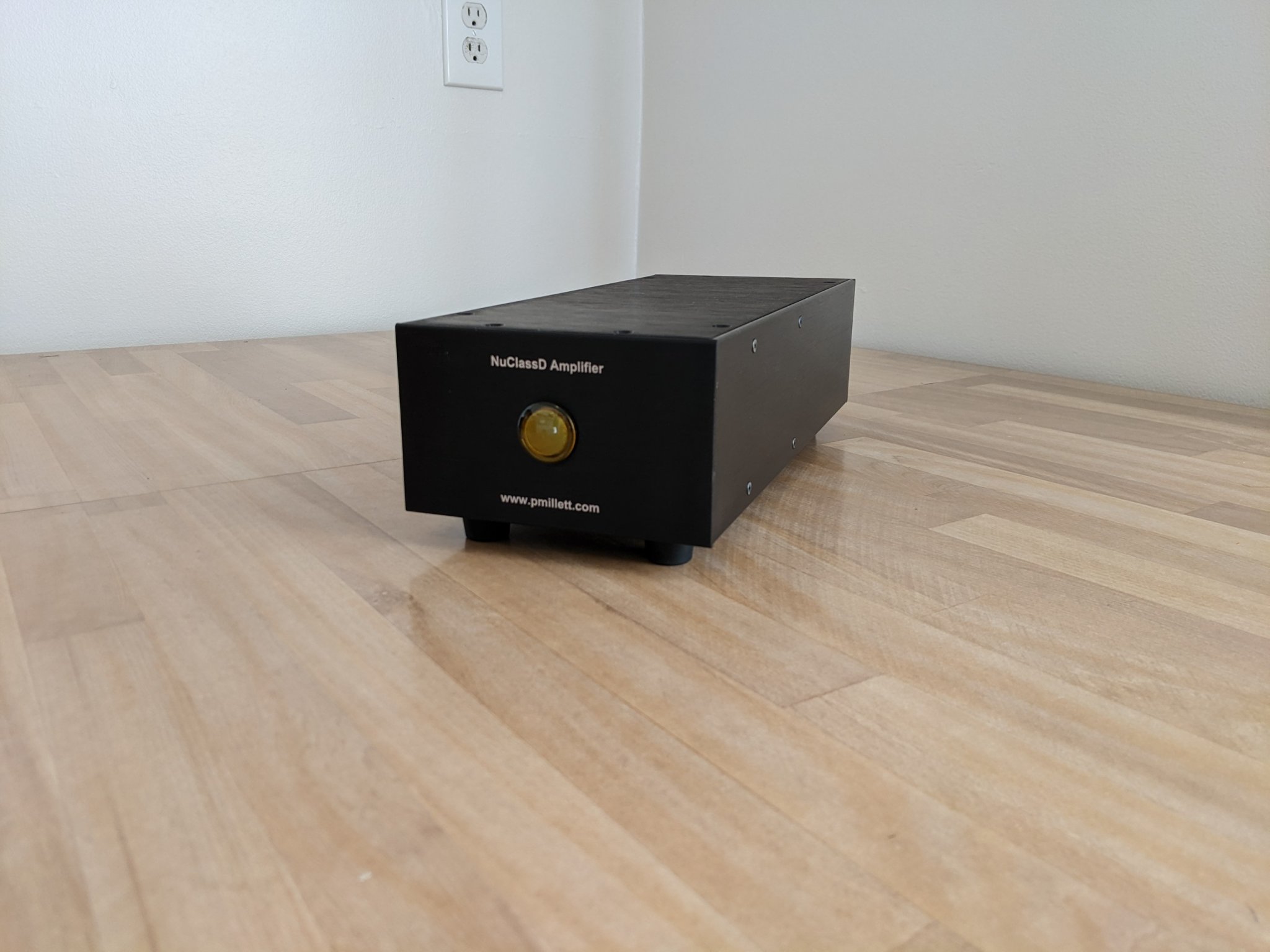

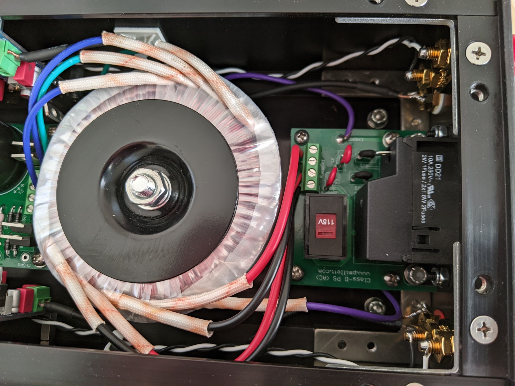

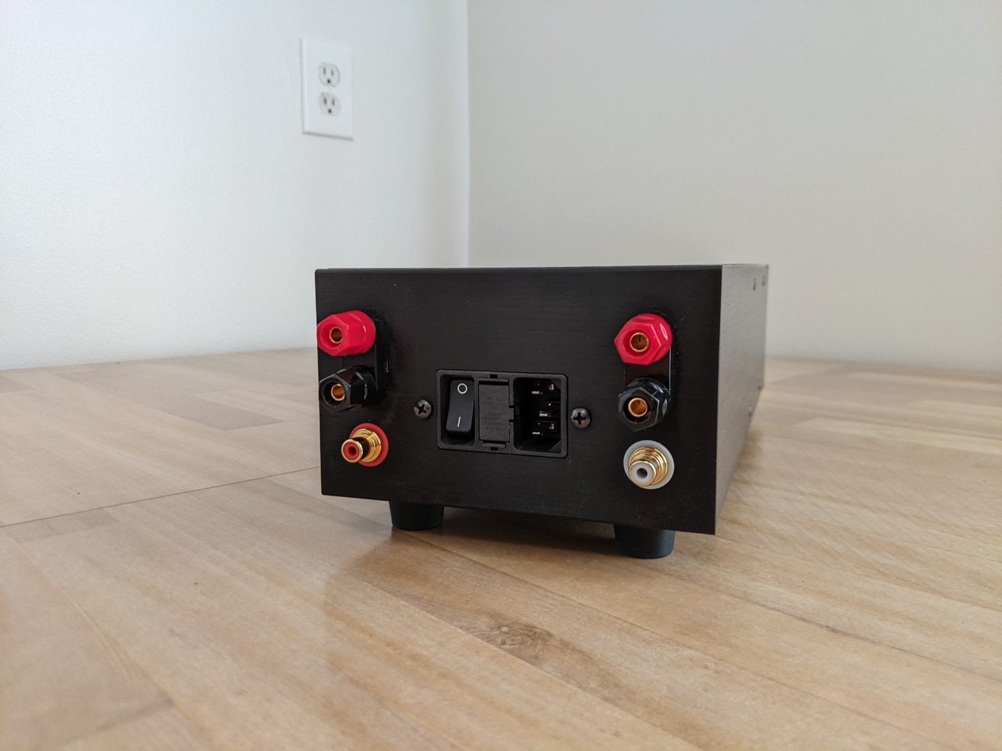

avdesignguru,
Just wanted to say thanks for your efforts on this amp. I recently built mine and your posts here have been very helpful.
I built mine using the Landfall Systems chassis, like Pete did.
If you want to use the Landfall chassis, the power led, binding posts, and rca jacks are not listed in the bom. Here's what I used:
RCA Jacks:
NYS367-2 - red
NYS367-9 - white
Speaker binding posts:
Keystone 4109
Front panel power light:
CNX722C400FVW (amber)
Pete uses CNX722C600FVW (blue) from the same series.
RCA Jacks:
NYS367-2 - red
NYS367-9 - white
Keystone 4109
Some tips that might be helpful to newbies:
RV1 - bias trim pot - before you fire up the amp up for the first time, give this pot about 10 turns clockwise. This will give you the lowest bias setting, and you can adjust up from there.
R4 - plate resistor - the bom specifies 100k here. Based on my experience and others here, you may need to increase this value (see posts #22 and #28). I ended up with 200k in mine. While you are putting in your Mouser order, you might as well grab a few values in between 100k and 200k. They are cheap enough. I would also recommend having R4 raised above the board a few millimeters to make removal a bit easier.
Setting the gain - I followed avdesignguru's method that he explained in post #34. This worked well for me.
This amp was a fun build. It sounds very good and it runs super cool. It will be my main summer amp.
