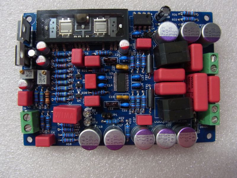

I finally got to documenting the design of the 50 watt hybrid amp design I've been playing with for some time. It uses the Korg Nutube as a gain stage in front of a Monolithic Power MP7770 self-oscillating class-D amp chip (as well as a few JFETs).
You can find details here: NuClassD 50W Nutube hybrid amp

512-P6KE30A was all sold out at Mouser, assuming this is a good sub? 625-P6KE30A-E3
Also, are 2% resistors okay, or do they need to be 1% on the amp boards?

2% resistors are OK, as is the TVS substitute.

Does the board need any additional heatsinking?
Not for normal music applications. If you run a 50W sine wave, though, it will hit a thermal limit and shut down after some time.
I haven't tried adding any external heatsinks.
Pete

Hi Pete,
Can this amp push 2 ohm load? And what's the output at 2ohm it is capable of?

Pete will answer, but it is already in "bridged output" mode, so pushing 2 Ω is asking for trouble. Internally it has a self-protection-on-thermal-overload circuit, so you could safely try it, but don't expect great results. At least that's from y review of the circuit schematic and Class-D power amplifier module docs. GoatGuy

This amplifier looks rather interesting. I really like the idea of it and also that it fits in a rather small chassis. Would I need to add a speaker protection circuit to it?
You shouldn't need to. Assuming you use a power supply with lots of cap (like a linear supply), the amp powers up and down gracefully. If you power it from a generic SMPS with small output caps, the rise and fall times are so fast you may get a thunk.

As was mentioned... it can drive 2 ohms but the current will be high, so the IC will heat up at fairly low power outputs. I^2*R, you know...
