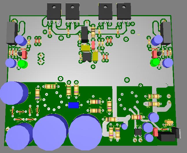

Yes it is ultiboard within multisim nice 3D option..
After I am ready with testing see photo,s before.
this pcb is of a old version just as a example.

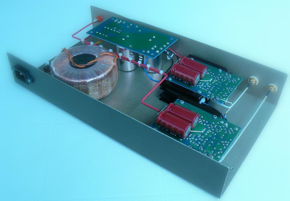

My Leach amp

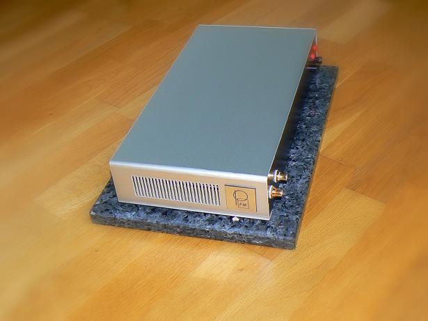

My DIY Leach AMP 4.5 :

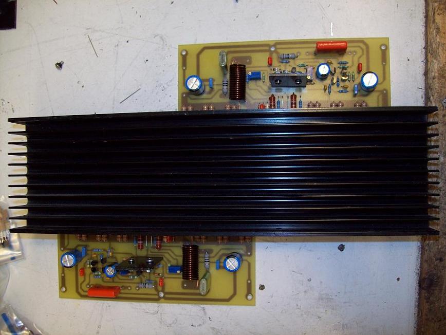

more quasi

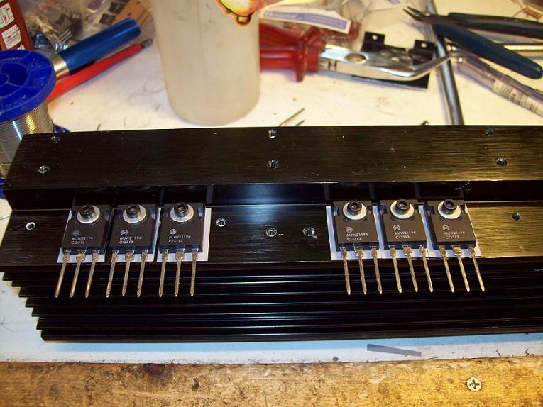

under construction
under construction
and one more
Sakis, if you pit such a heatsink horizontally a forced air flow is needed in parallel with fins, otherwise it is waste of aluminium.
yes
it is sceduled to have 2x 12 cm ventilators working inside a canal to make sure that air flow can remove as much heat from the heatsink .

Controlled convection really works 🙂
If you use fans fore doing that, it would mean that the fan should be sucking air from the box at one end, and the fresh air inlet holes positioned at the opposite end, or just below the heatsink
I would consider a couple of those exstremely small highspeed ones fore PC
But generally I hate fans
If its not a highpower amp, or driving low impedance, it should be sufficient to make the fresh air intake below the heatsink
Hot air will try to escape, no matter how the heatsink is oriented
Convection cooling done properly would just as efficient as outside mounted heatsink, or maybe even better

yes exactly ...this is what i go for ... but forget this PC fans .... this is PA equipment ....beter think 12cm 220v papst fans will do the trick

PA? ok then
Im not sure about the fan size
Smaller fans can run at unbelieveable high speed, and are probably very effective
But in the end I suppose its just a matter of how much air they can move

But small fans running at unbelievable speed also emit unbelievable amounts of noise, sounding like small jet engines. 😀
12cm fans, on the other hand, can move impressive amounts of air and still have low noise level.

Probably so
But a small trick with those small highspeed ones
Dismantle, clean it up, and supply a small drop of finest oil
At first it might be very noisy, but after a while you wont hear it at all 😉
