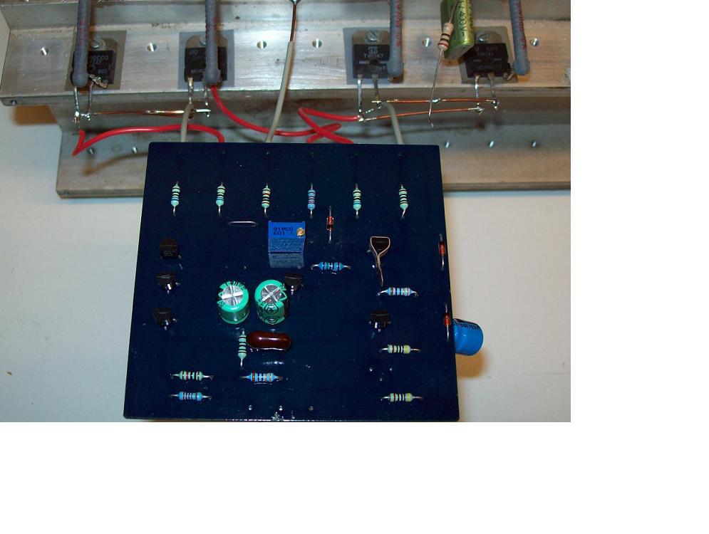

nelson pass a40 ....
ready and working allright but it will have to freeze for a while before get ready to be a ready made device since no decent tip142-147 are found in the Greek market yet and then on the other hand i dont really wana go for cans ..... too much mechano to do that i am not up to these days
also another reason to freeze this is that the mosfet used for a current source is almost impossible to get ( as we speak only one resistor+cap is used ) so this part needs to be redesigned ....
the pcb is the original but i am actually tempted to make my own since i really dont like outputs wired to the pcb ..... this is something i would never do .....
regards sakis
PS .... it measures pretty fine but still havent heard anything from it ....i dont wana spoil my ears before everything very ready first ..... ha ha ha
regards sakis

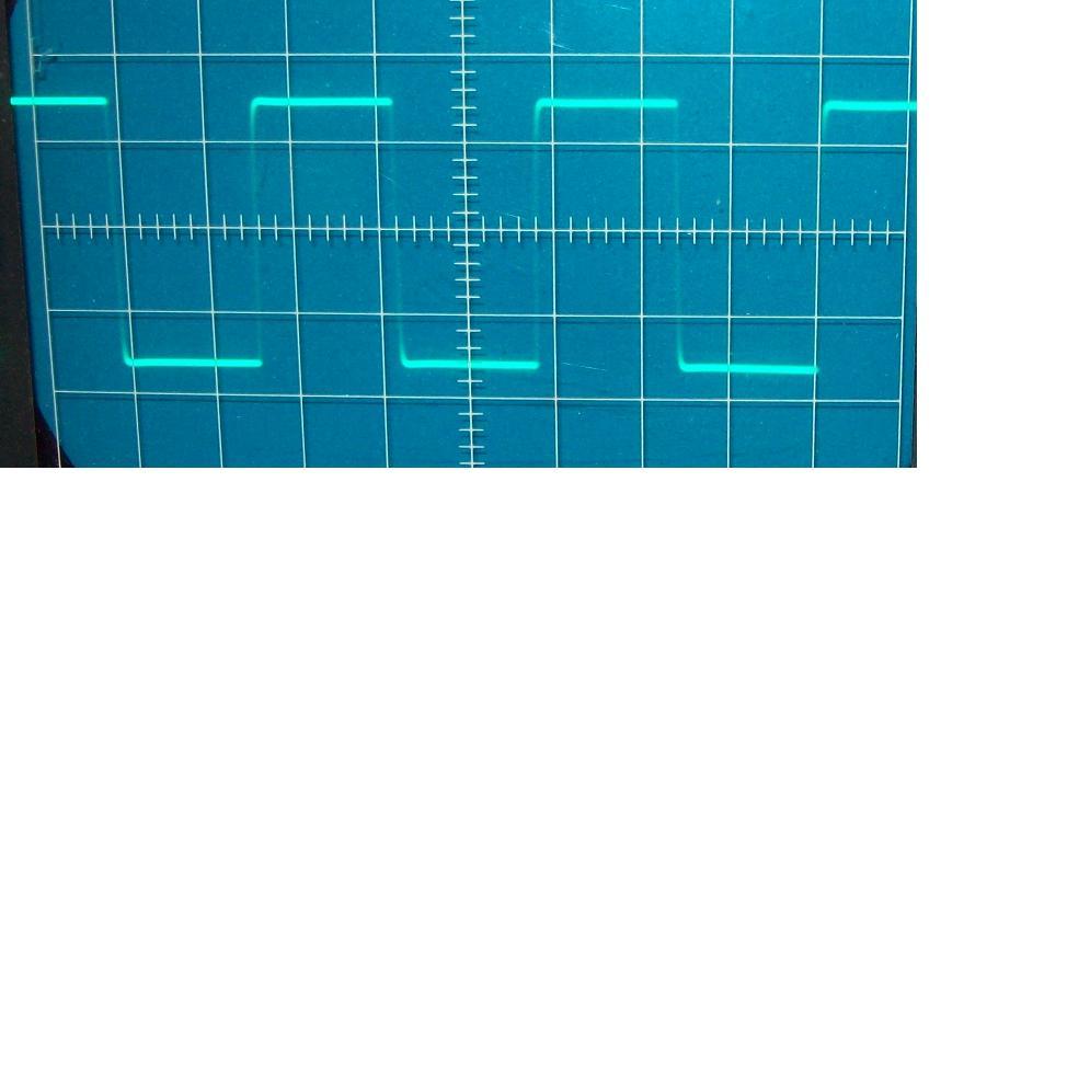

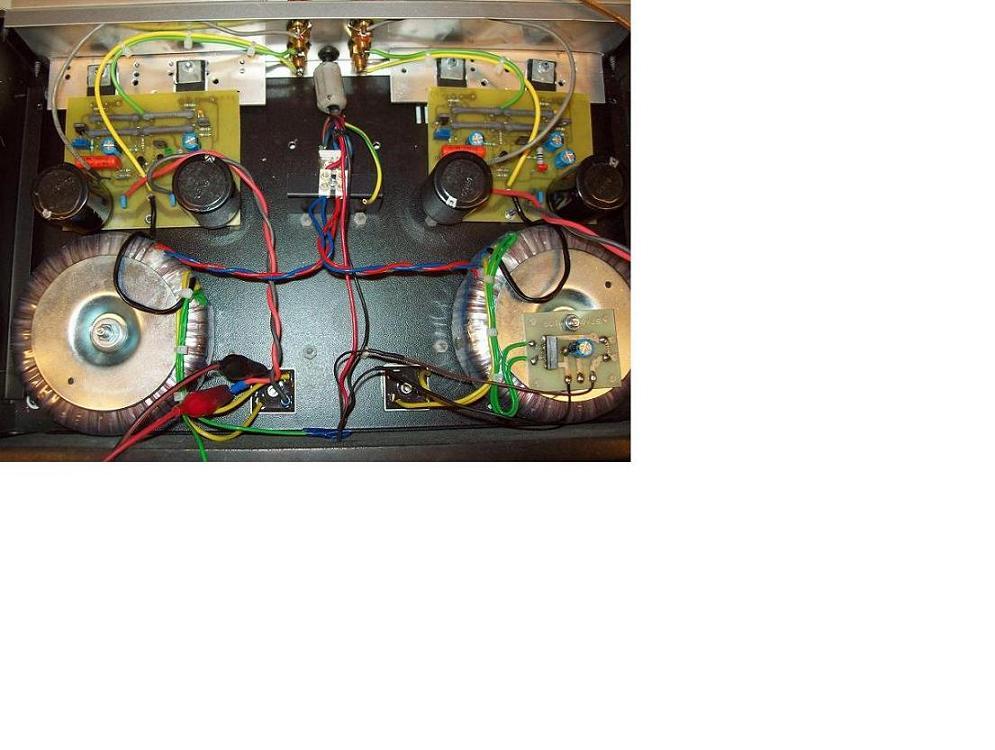

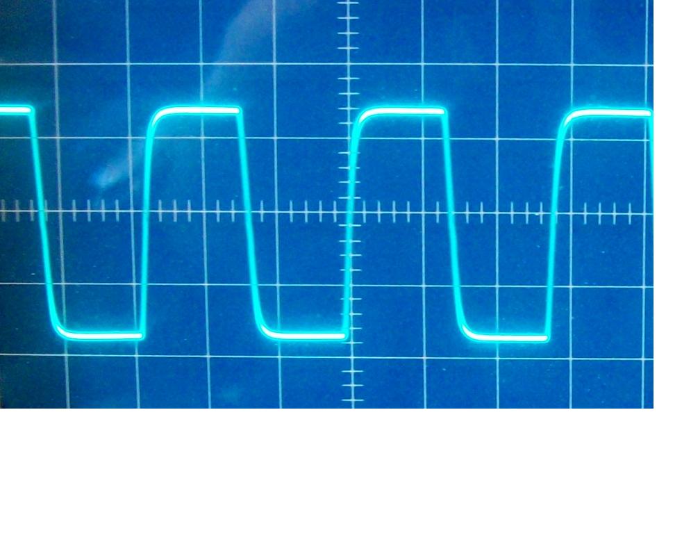

my easter toy ....as a dual mono version
i apologize for the construction since most of the construction i make looks really nice but this particular one was originally builted as Legend 4 but failed .... for about 20 times and then reconstructed again and again and again till i decided to do something finally useful with it ....
here is the pictures and also scope readings ....with the first one at 10 khz and the second one .....at 100khz ..... nice baby heeee

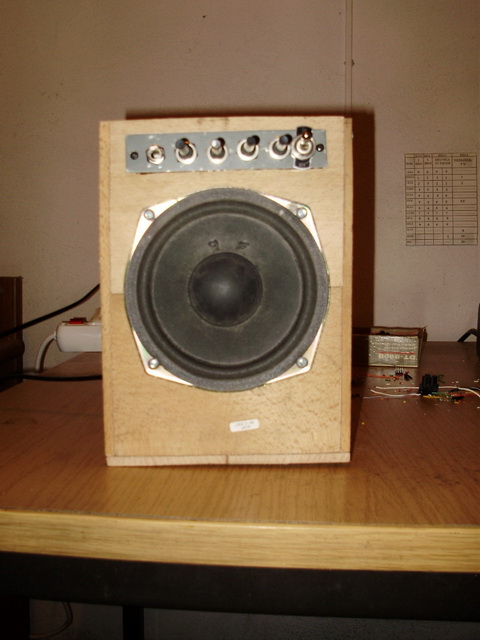

Hi Guys
I'm totally new here and my amp will look funny in comparation with every other posted here.
This my first guitar amp that I made and it is based on tda2030 IC.
Preamp is a fet version of fender blackface.
Speaker is a 15W 4 ohm which i took out from a portable CD player.
That pretty much says it all!
Cheap,simple and good enough for practise until I buy myself a decent guitar amp. 😀
