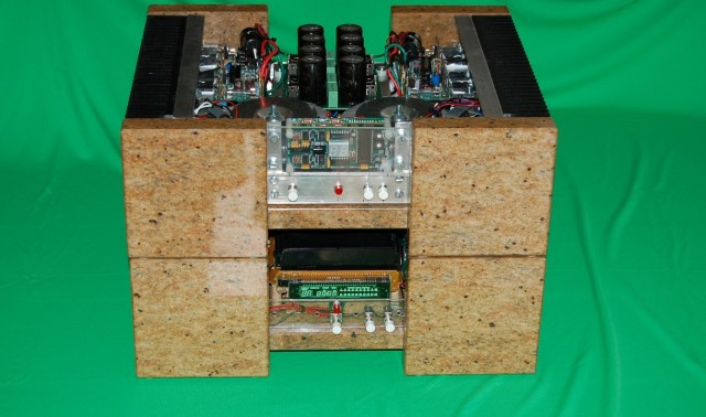

Here’s what I’m working on right now… an Aspen Lifeforce 100 safely embedded in Kashmir Gold Granite. It’s part of a set, the CD player was posted in “introductions”.

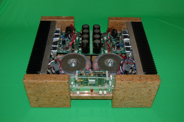

Here’s what they look like together. Obviously the front and cover are not done. The face plate will be fine grain polished wood, the cover will be perforated steel.
They've been playing for a while now and the combination is absolutely stunning! The set, as it is now, weights a total of 50 Kilos.
Final note: after having some success with an aluminum sub frame for the Amp I've decided to do the same with the CD Player. You may note that the button layout is different on both pieces, this will be corrected once the CD player has its own aluminum subframe.

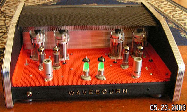

Here is my last power amp prototype (Pyramid-VII): http://wavebourn.com/forum/download.php?id=123&f=7
It is optimized to drive ribbon speakers (short, tight, fast feedback loops across output tubes). To drive them 6P15P power penthodes are used.

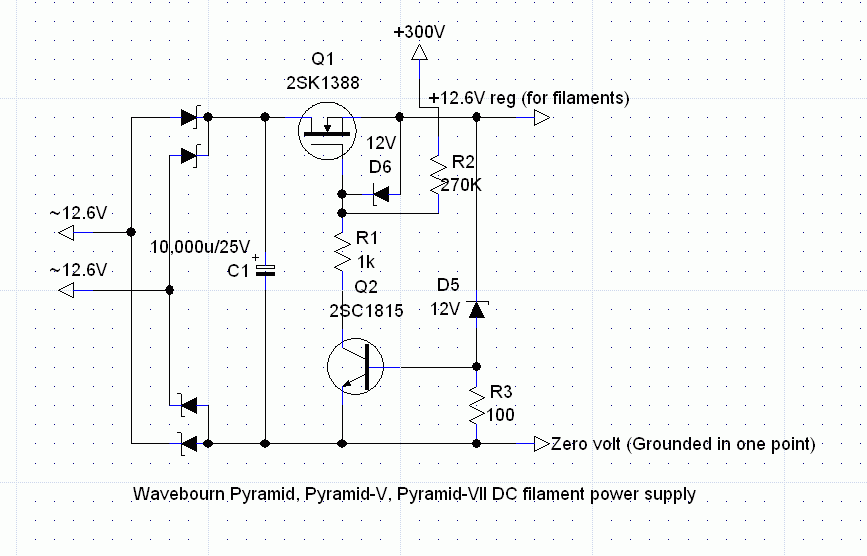

Filament, bias, screen grid, preamp B+ voltages are regulated by MOSFETs. Proprietary optical compressors prevent sudden clipping on practically any input level, they are tuned to limit output power on 80W / channel (160W total).
RCA ins, banana outs for 4 and 8 Ohms, TS outs for 16 Ohm.

you have one hybrid amplifier there.
Where transistors clean up the currents, the supply for the tubes / valves.
(I do not like to use 'sand' because only those that downclass our dear good old transistors
usually write that ugly word.)
In fact Silicon we can find in the GLASS of the tubes as well..
Si, silikon, kisel, is one of the components when making ceramics + window glass.
Anyhow, you have that lovely, very beautiful red color, Wavebourn.
Did you paint?
Or was it red color already when you got it?
I see.
Well, good work Wavebourn.
