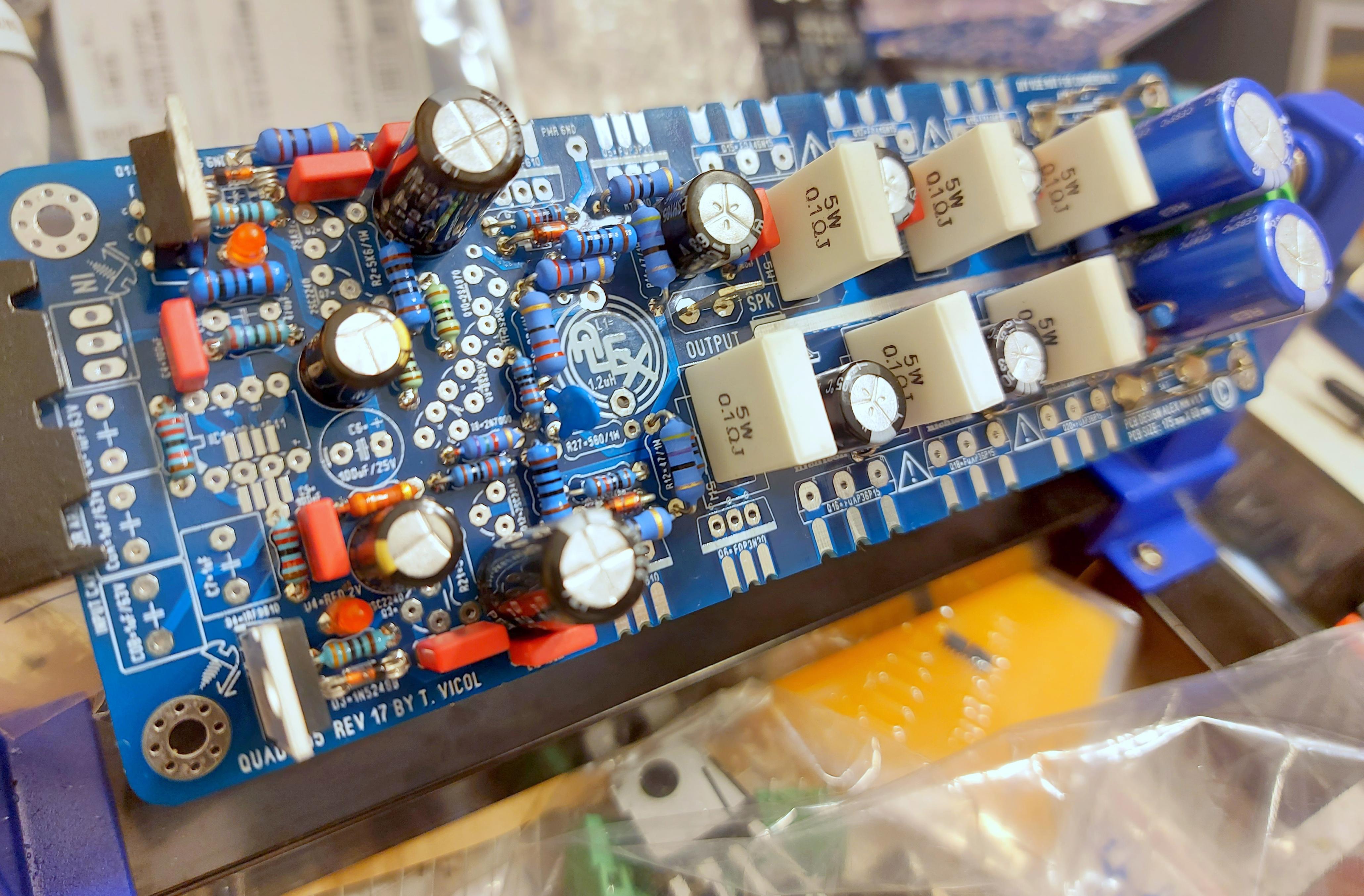

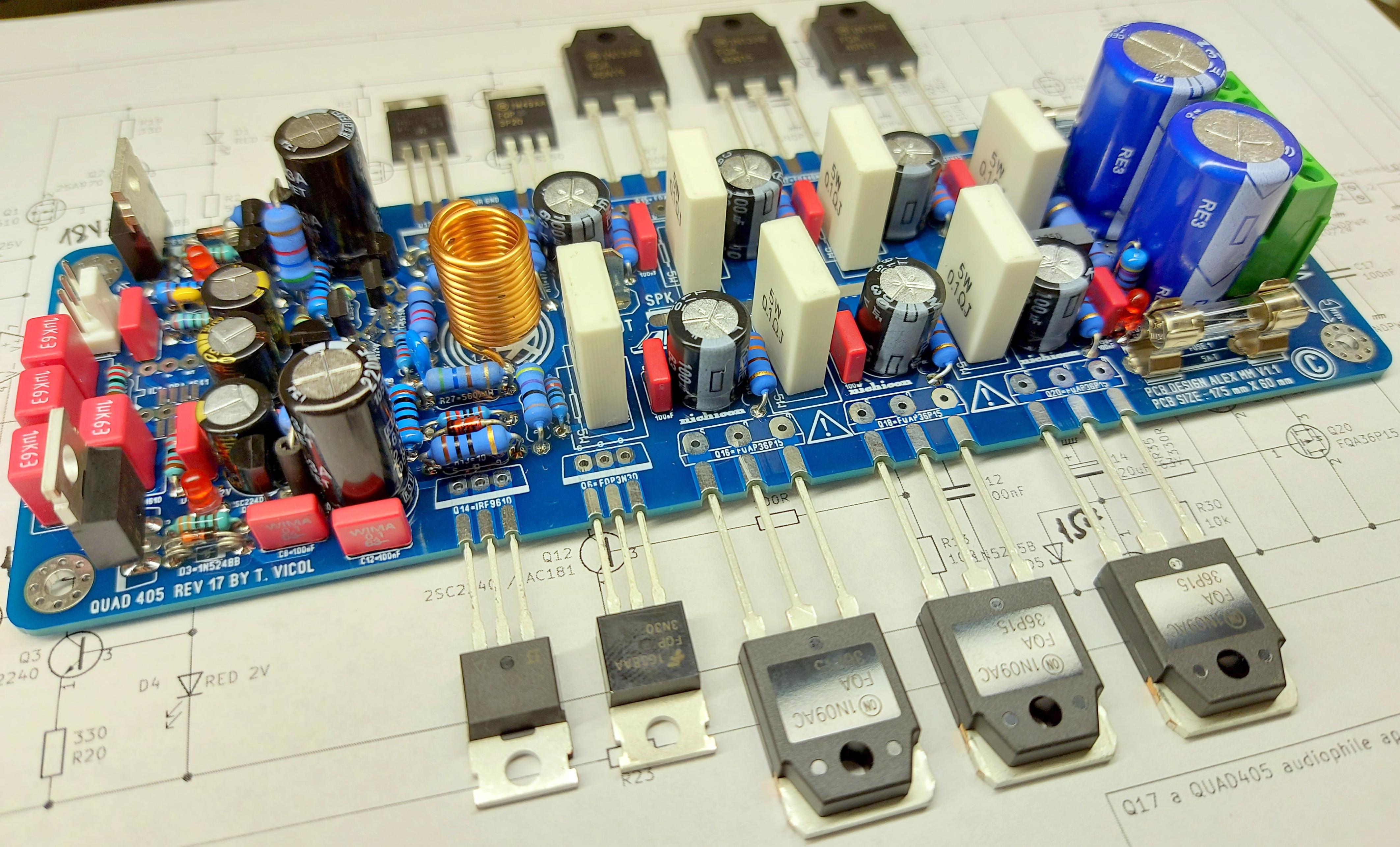

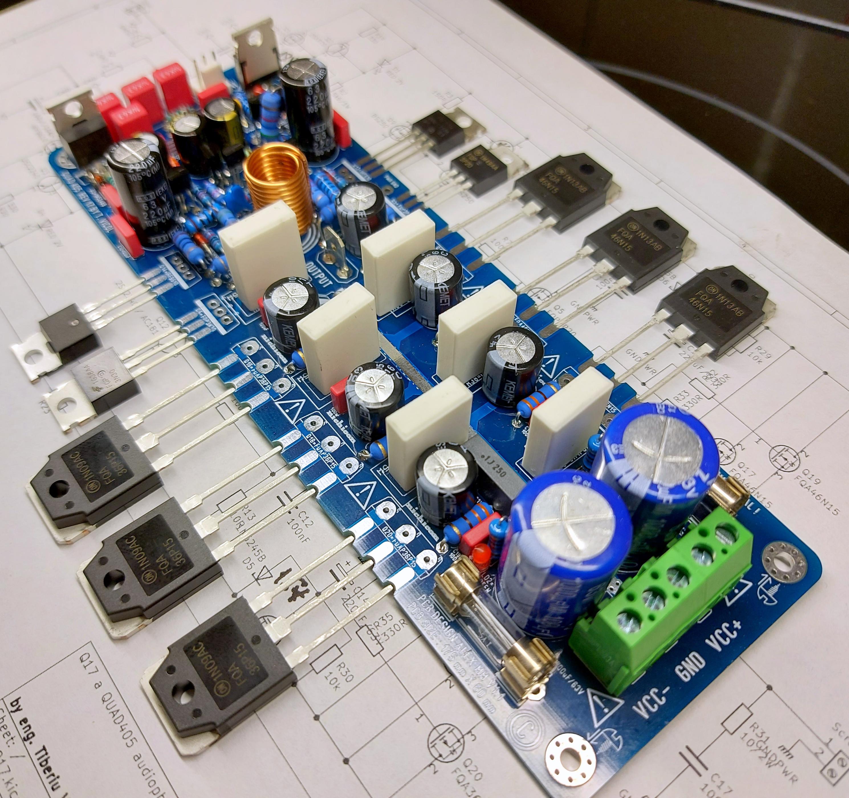

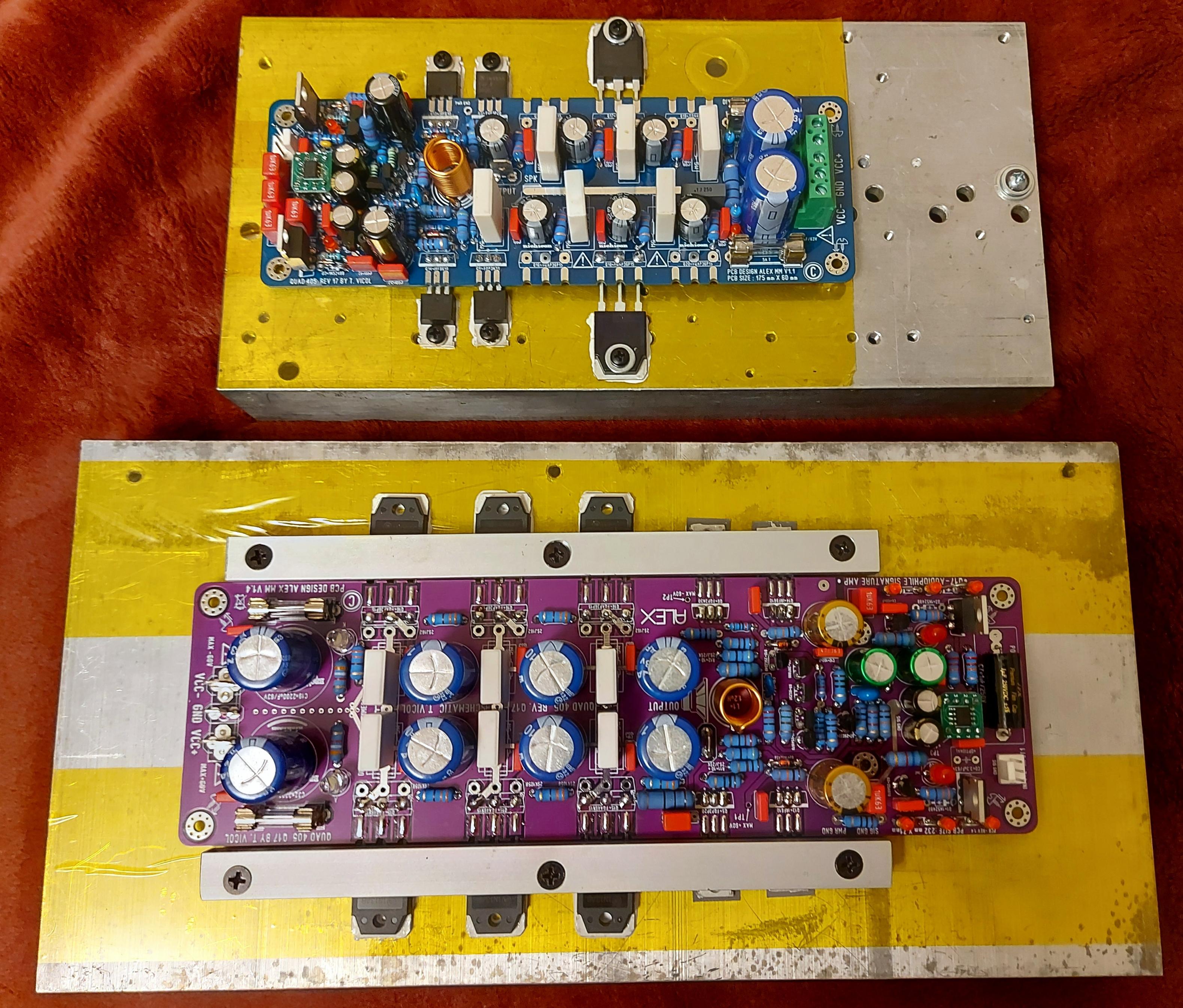

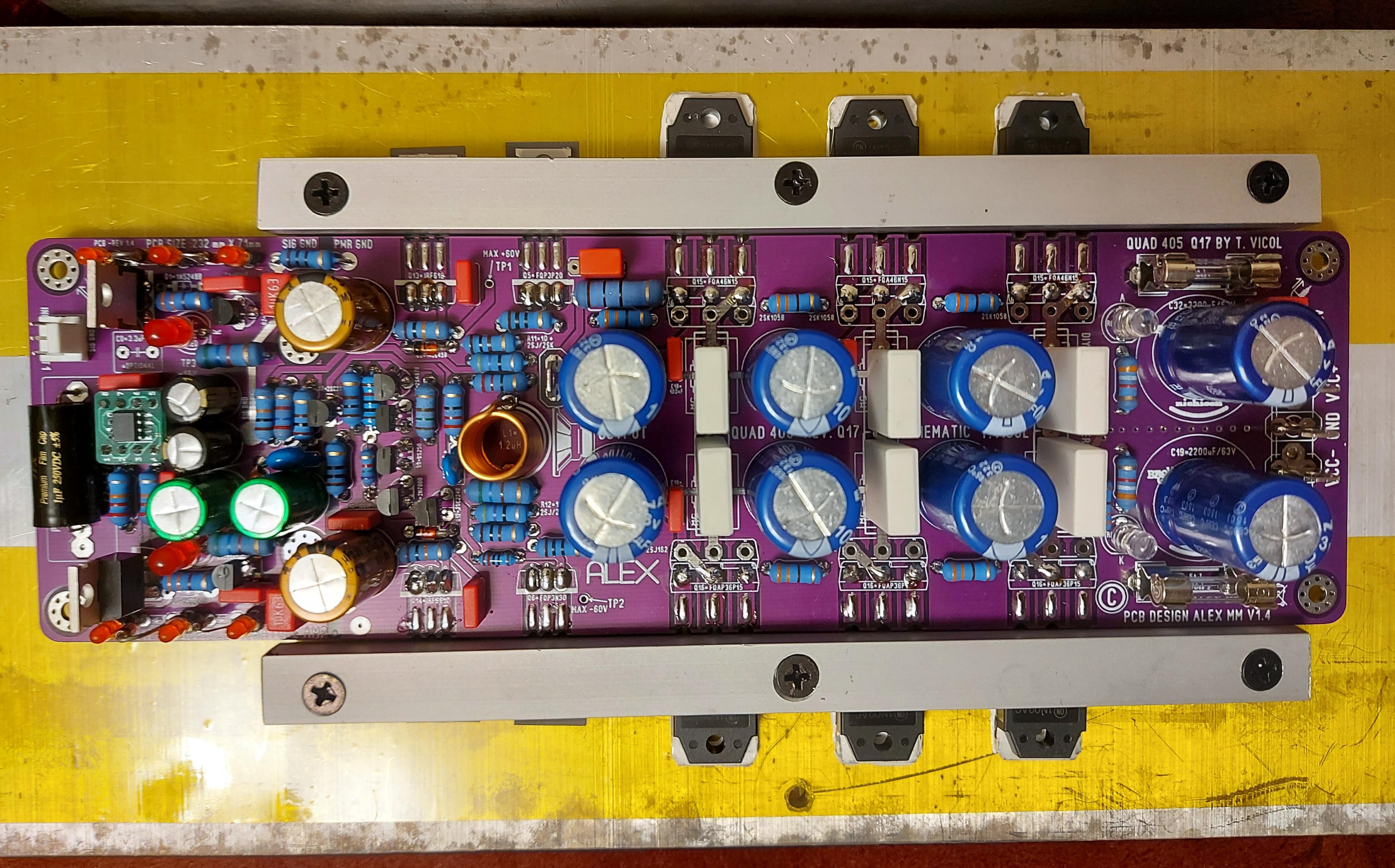

New Quad 405 Q17 by Tiberiu Vicol schematic, and PCB by me . 🙂

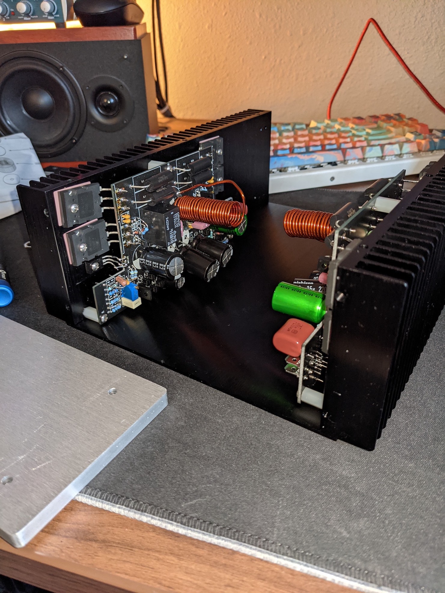

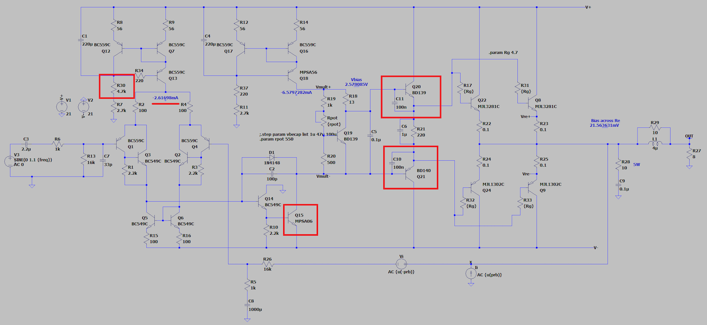

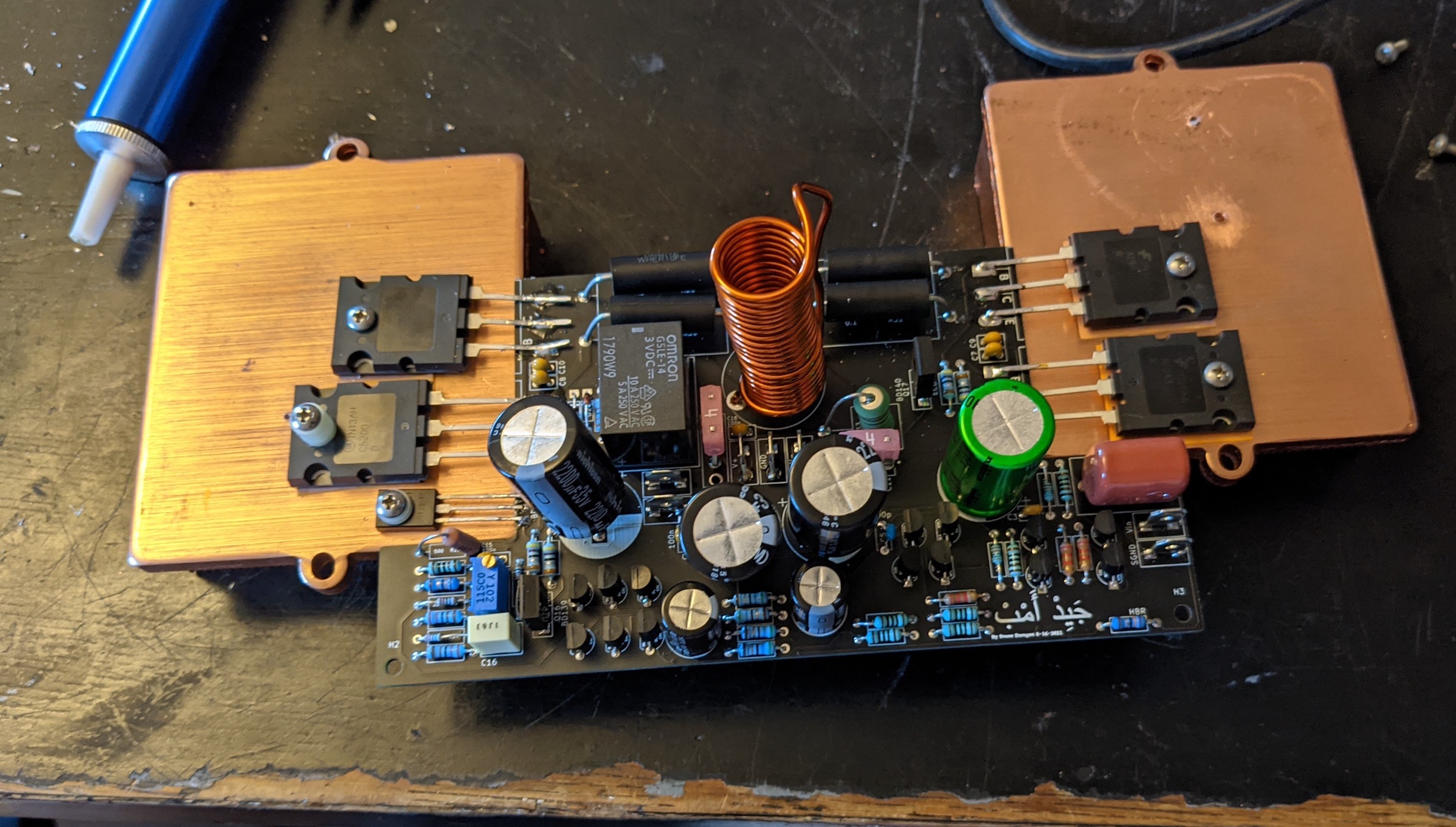

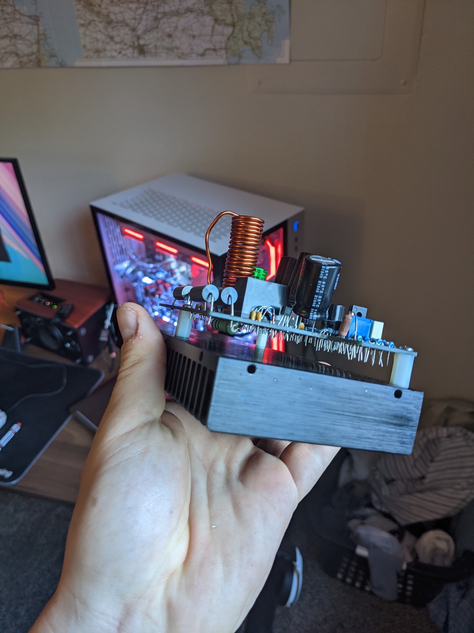

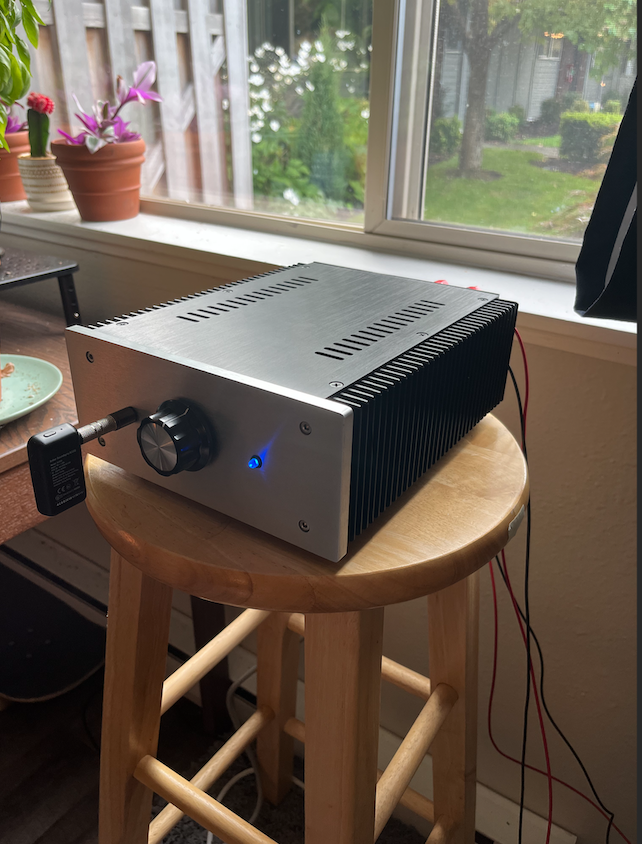

Big thanks to Bonsai and jxdking for their assistance on my signal ground question thread.

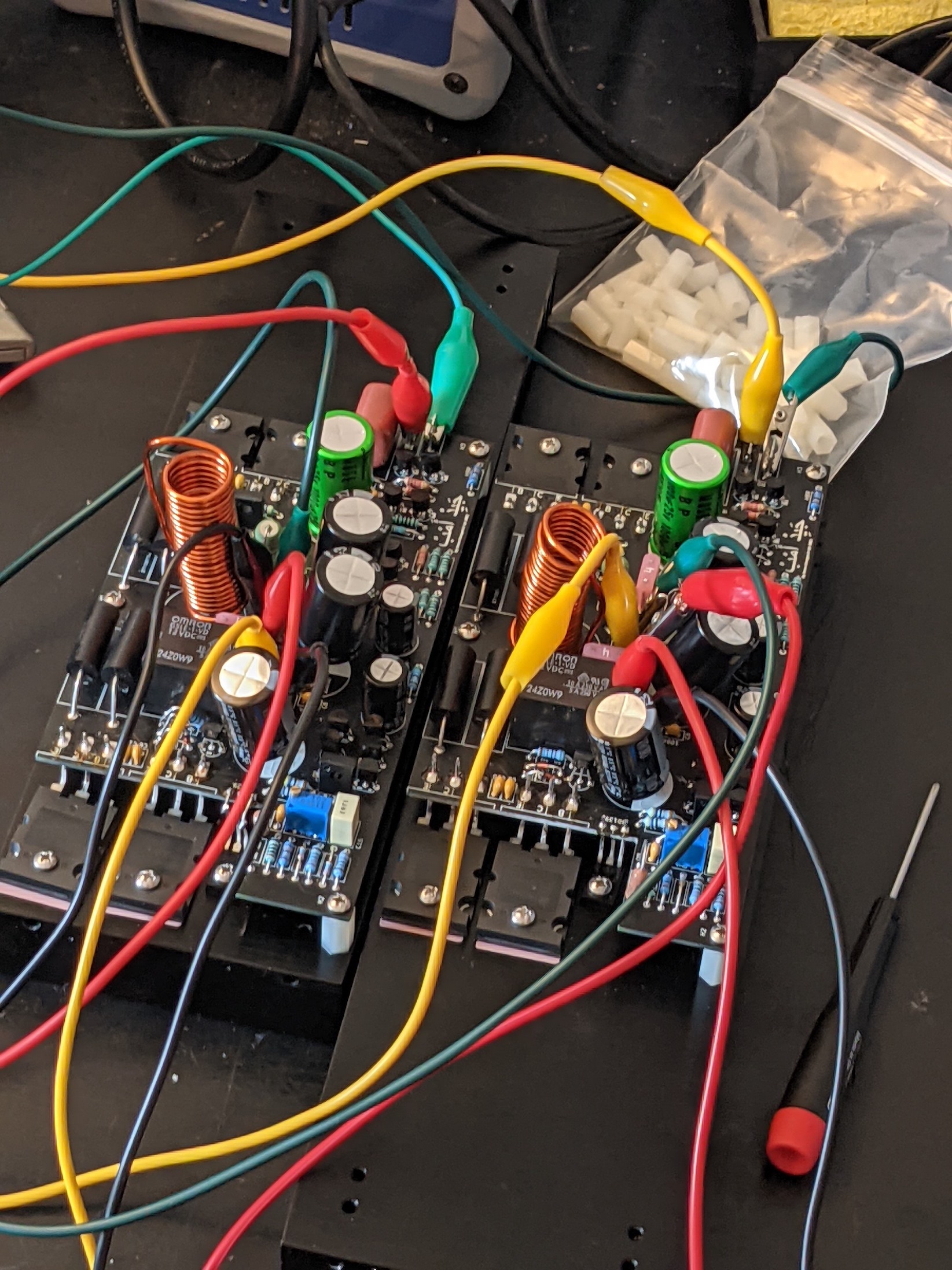

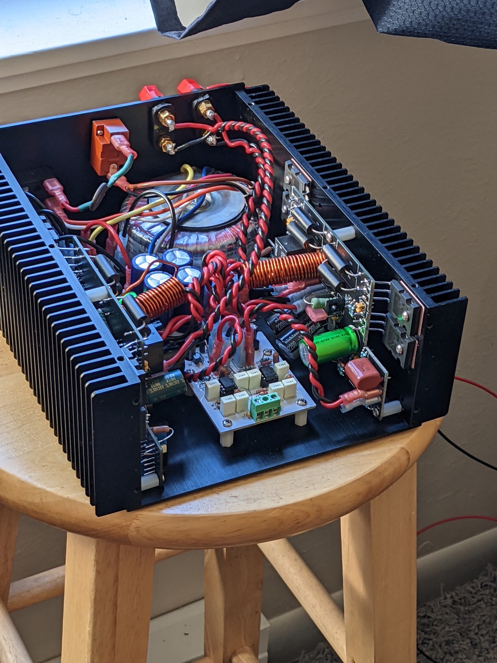

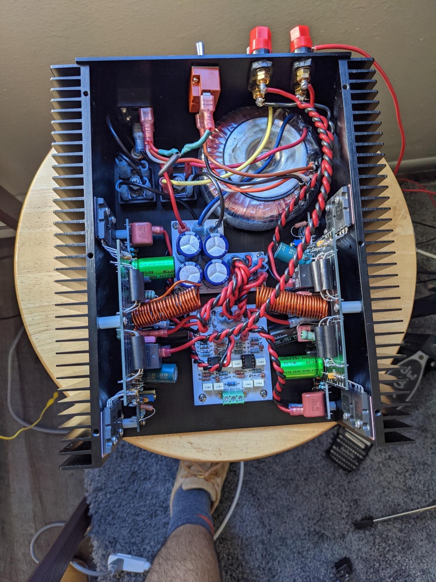

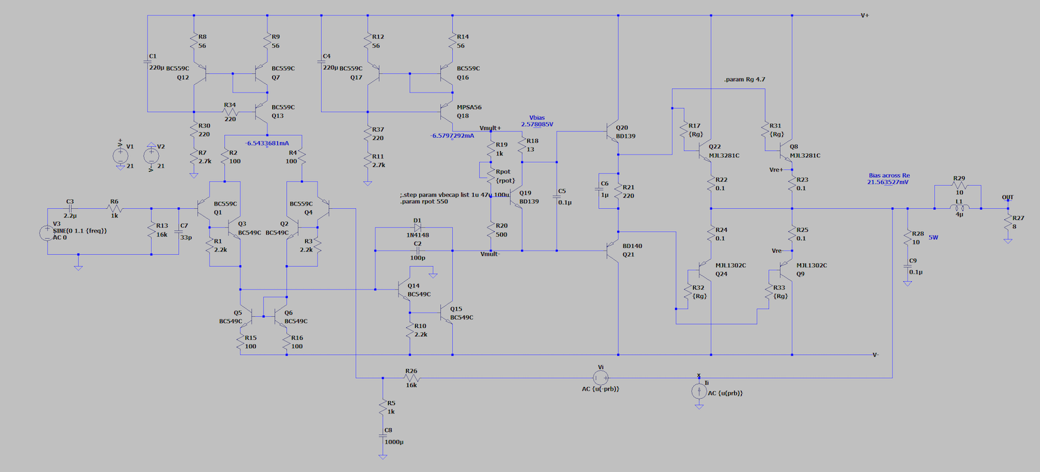

I'll start out with schematic:
- I believe this is just a basic blameless amplifier
- both channels biased for 20 mV across emitter resistors
- EF follower VAS
- easy peasy 100pF miller cap
- ran into stability issues
First issue:
- realized design was bad with main VAS TR as BC549C, too low Vce rating, rails are +/- 21 V (not rms) after transformer
- replaced with MPSA06
Second issue:
- after replacing with VAS TR to a MPSA06, right channel heatsink incredibly hot
- look at bias, 100 mV
- take amplifier out of chassis
- attach to external psu

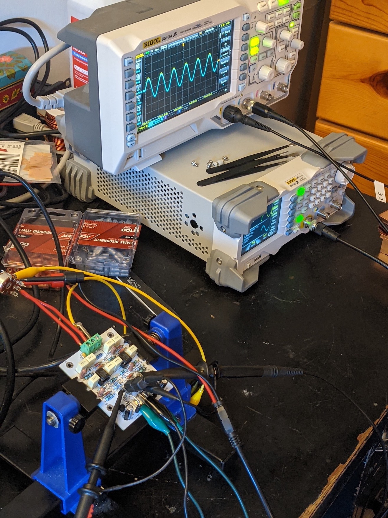

- PSU starts to pull an amp from each rail when I probe base of MPSA06, the VAS TR
- after sitting on it for a few days, finally probe output with oscilloscope (should have done this earlier, duh)
- turns out there is an incredibly clean oscillation at 11 MHz
Fixing second issue:
- you can see pic where I reposted schematic with changes
- first change: lowering tail current in input stage, this brought phase margin back 20-40 degrees, at least in simulation, by itself didn't cure oscillation
- second change: added 100n caps across base emitter junction of driver TRs
- after second change oscillation completely went away
- can now probe base of MPSA06 and everything looks good
Anyways, that's the most interesting part of the journey, here are the pics.

Nice amplifier. Interesting fixes, but this isn't the place to share thoughts on them. I hope those capacitors on the output don't affect SQ much.
Ahh. As every design experience is a combination of things you got right and things you got wrong, I thought providing a small explanation or context of what that journey was like for me would be a nice addition. My apologies, I did not intend to pollute this thread with that type of discussion. If a moderator deems it inappropriate, please feel free to remove it. Thank you!Nice amplifier. Interesting fixes, but this isn't the place to share thoughts on them. I hope those capacitors on the output don't affect SQ much.
edit: I forgot to mention, it sounds great! 🙂
Sorry, not at all, I read every word. If you did have a thread on it, I would be keen on finding out more. I'm glad it sounds good!

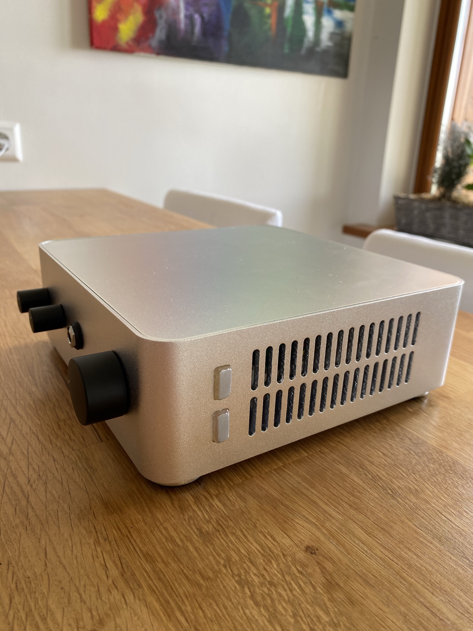

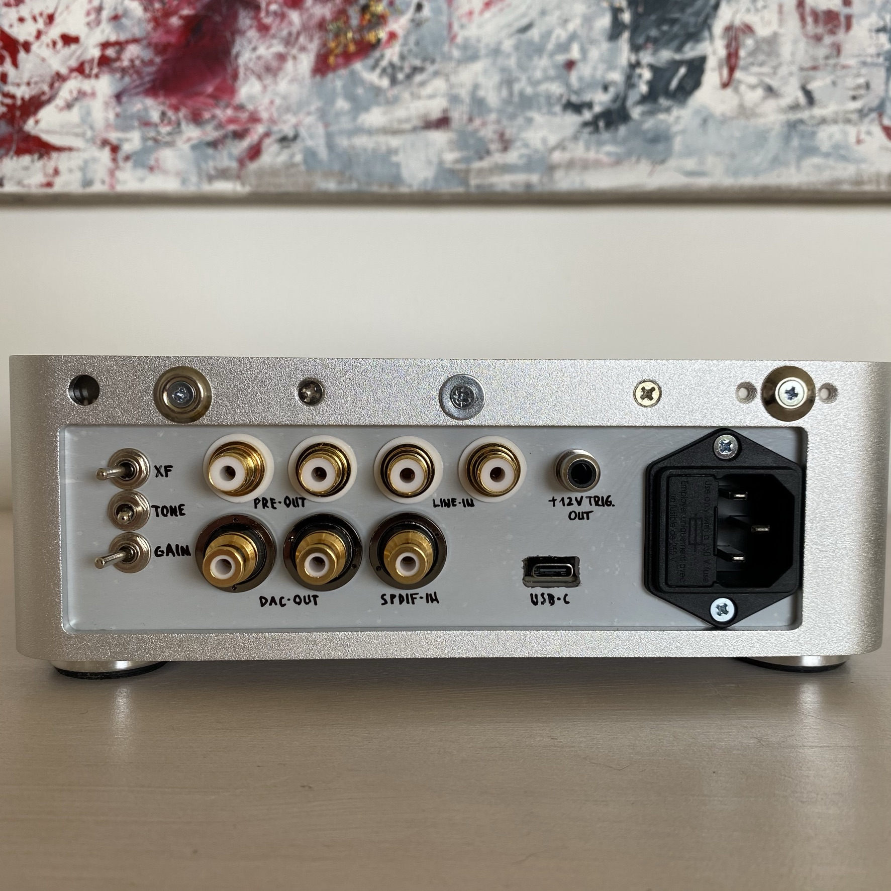

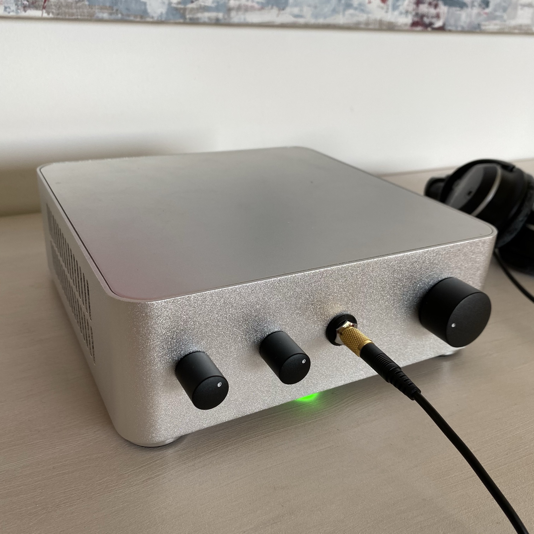

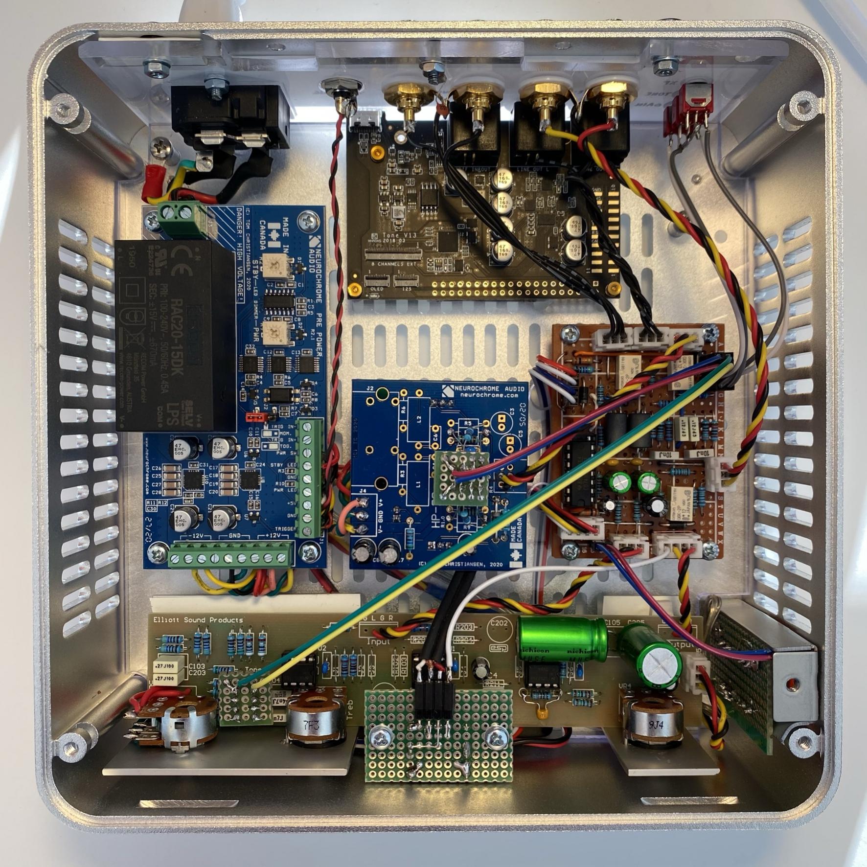

Here comes my little modular build.
Pre-amp: Rod Elliott's P97 with tone controls, however skipped the balance regulator. It has two inputs - Line-in and DAC - toggled by the top button on the right side of the chassis and logic circuit with relay (the module on the right). The tone controls can be bypassed toggling the switch on the back driving another small relay.
DAC: Khadas ToneBoard, as is.
HP-amp: Neurochrome's HP-22. The module (in the center) looks strangely deserted but I just had to move most components elsewhere to accommodate all the ideas in the end. Hope TomChr does not mind🙂. I also added switchable gain (high/low) and cross-feed (modified schematic by Xen/Patrick from another thread) by two switches on the back + small relays.
PSU: again Neurochrome's ready module. The lower button on the right side of the chassis switches the whole thing on and off.
