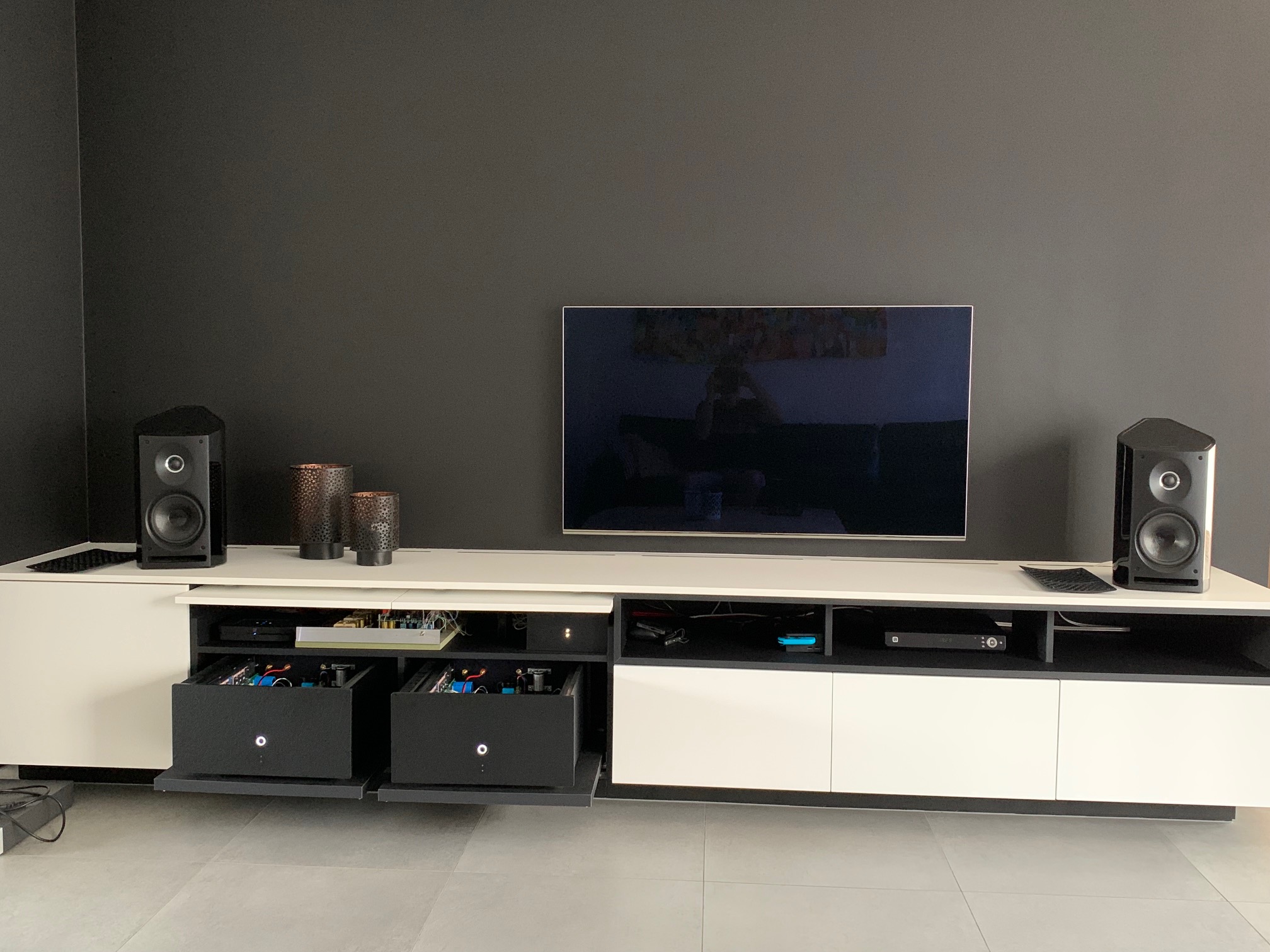

Just seen ...Here's something I originally built around 20 years ago, but renovated/finished off during lockdown.
Dual mono, Class A, 8W/channel into 8 Ohms (Could be biased for more, but that's plenty for the 97dB@1W "Dallas II" horn speakers I built).
Finally an amplifier housing design not in the usual rectangular brick shape.
I like it.

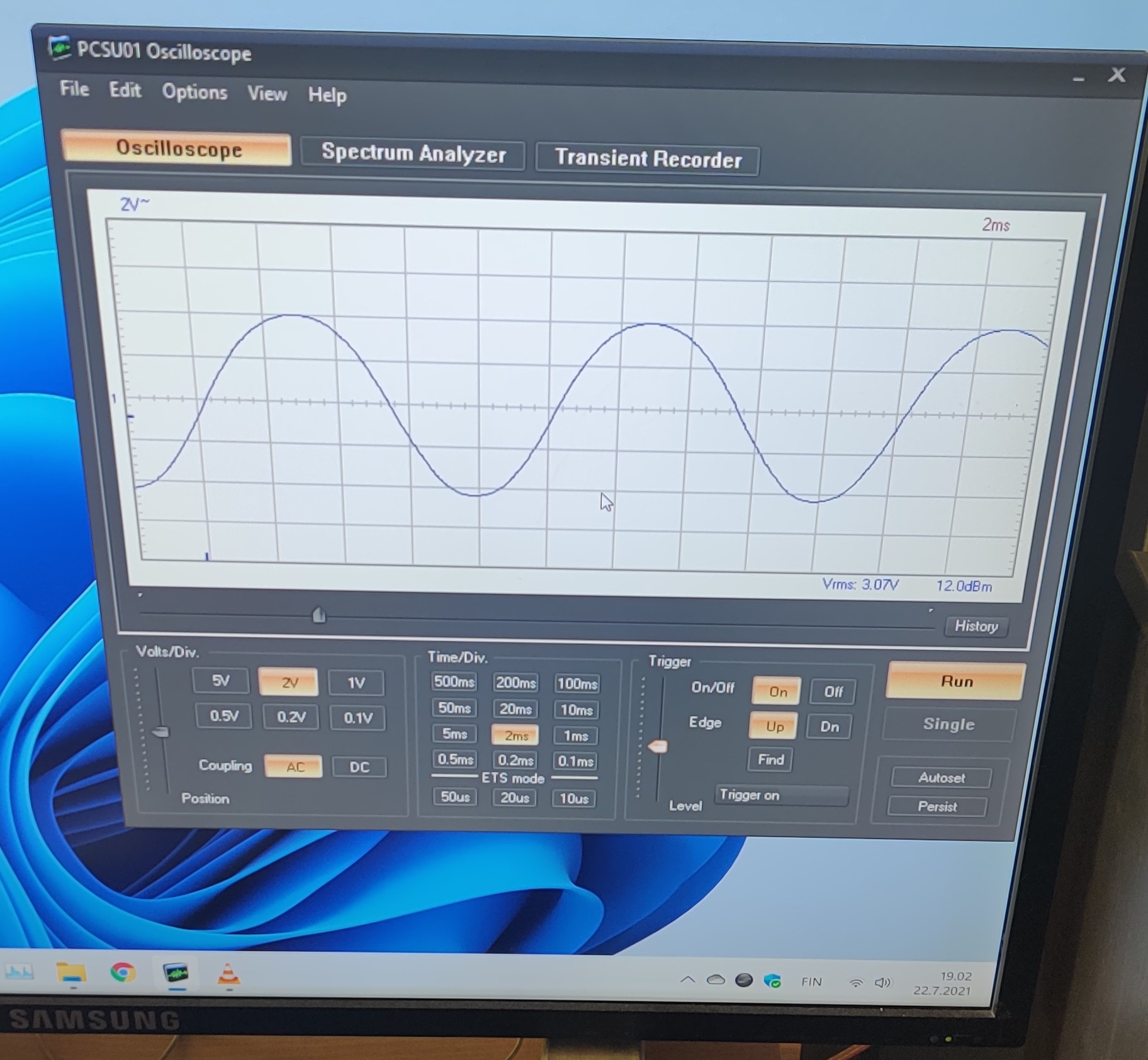

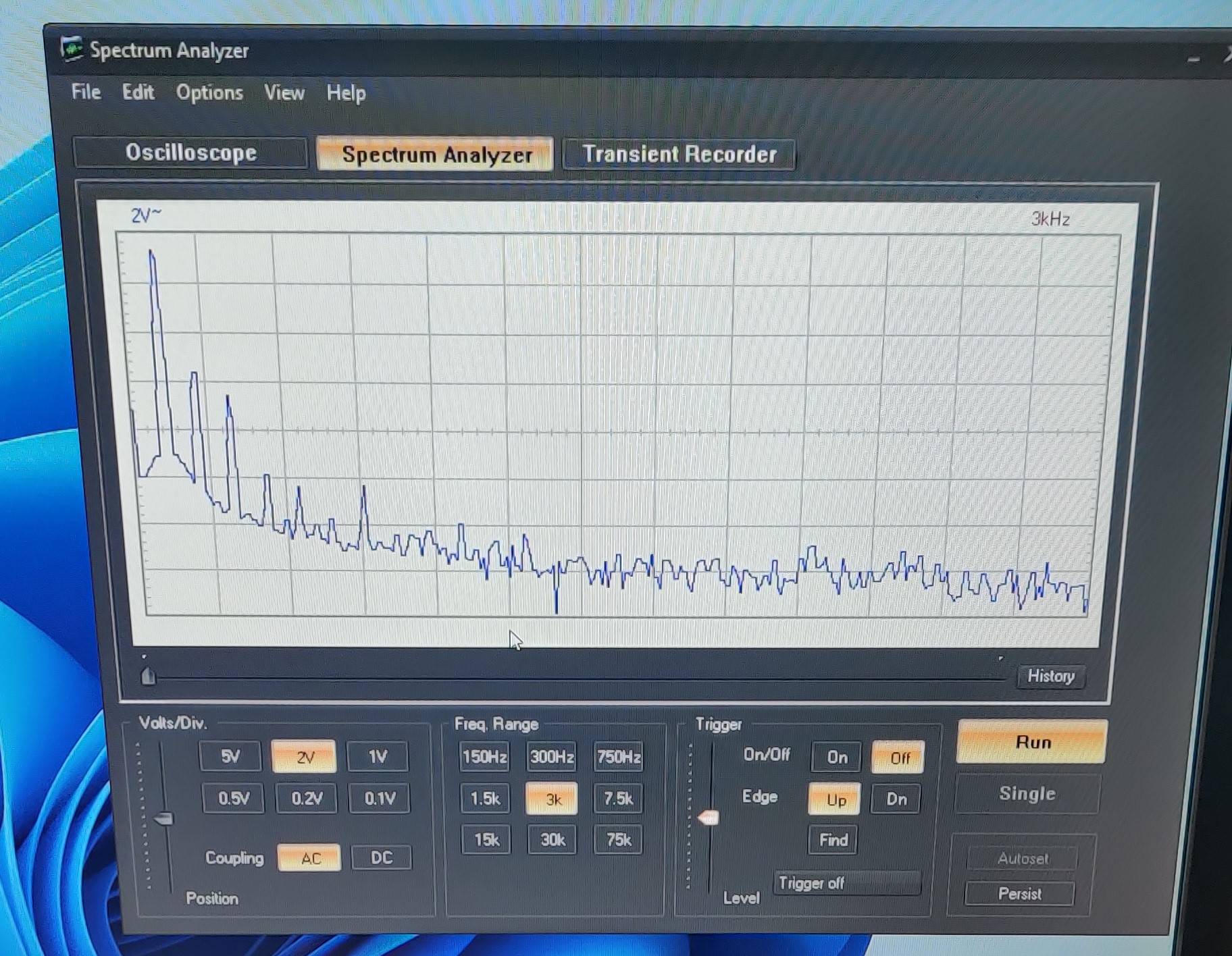

Some measurements.
Have to say, that with my mono amplifier hooked up to big speakers left and right around tv, measurements wont tell nothing for what i have been experienced sound quality and loudness.
One speaker is 4ohm and 90db/w and inside is two 8" bass elements, one 6.5" mid element and one tweeter.
test have been made with 4Ohm resistor and cheap usb scope for pc.
Some measurements.

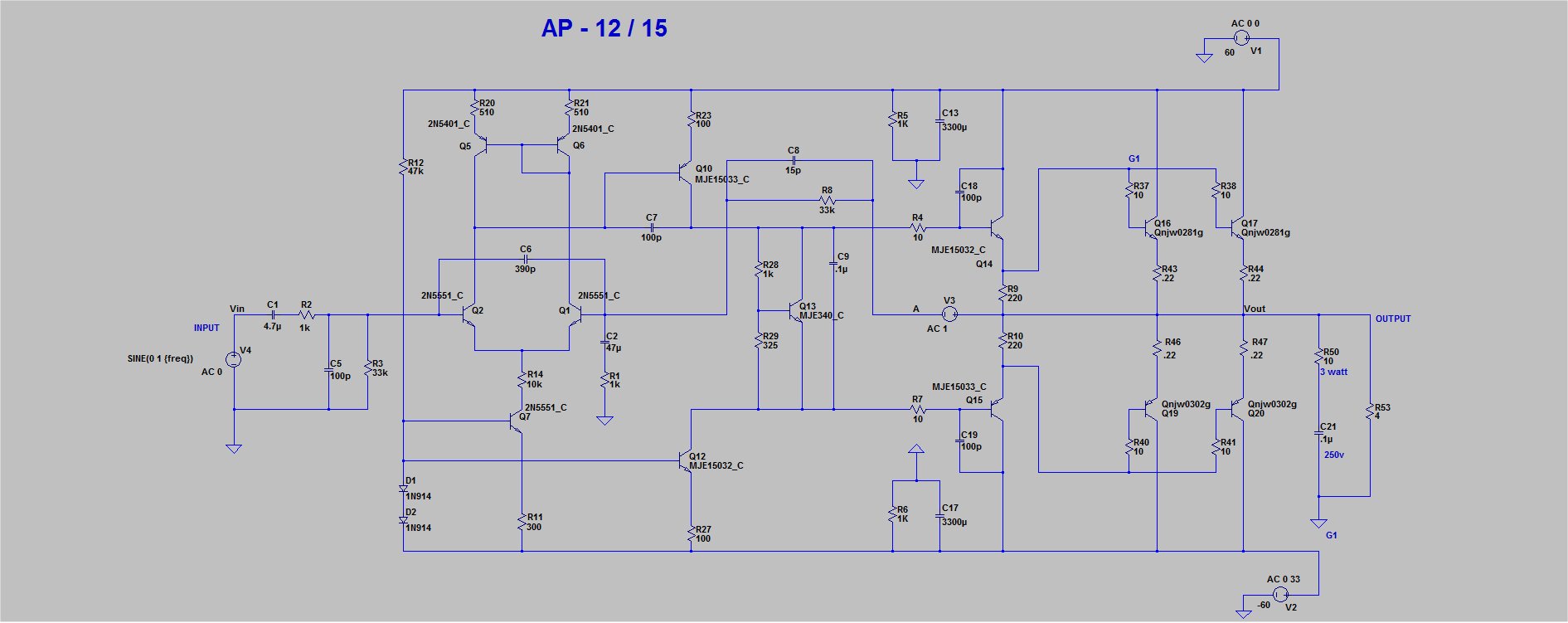

System and amps used is: (you will recognize the amp schematic, it was not the intention in first place, but all kind of issues moved me in the direction to were I landed)
https://www.diyaudio.com/forums/solid-state/96192-post-solid-pics-683.html#post6288826

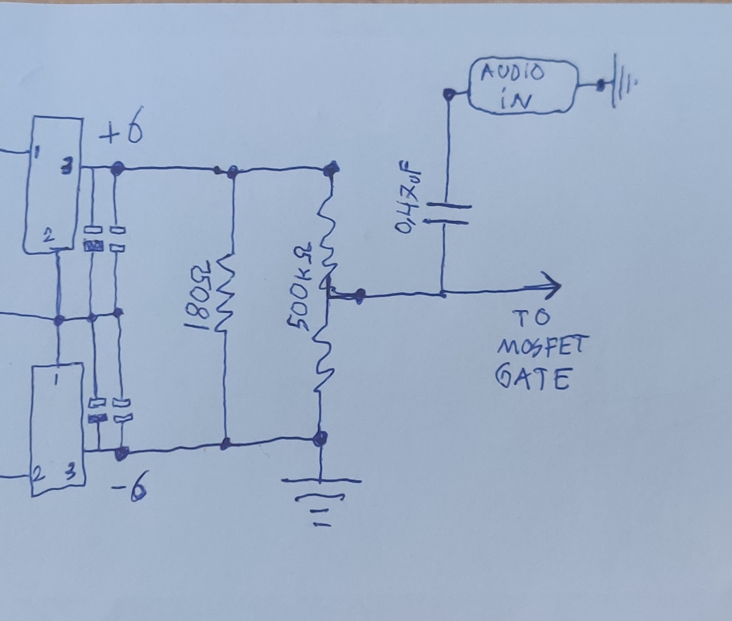

I've done a fast and easy mock-up on a piece of wood in combination with a 10k Pot.
Holy s..t, is that coming out of my Sonus Faber bookshelves... the bass is really nice, it goes much furter then my PS-audio preamp. It looks like these are big floorstander speakers. Understand me well, it is not as if there is a big sub playing which add's to much bass, all is still nice in balance, hights, mid's, vocals, bass.
Wonder how the sound will change after powered on for several weeks. Many don't believe in burning-in, I experienced a rather big improvement wiht my amp's once powered on for about 200.300hours.

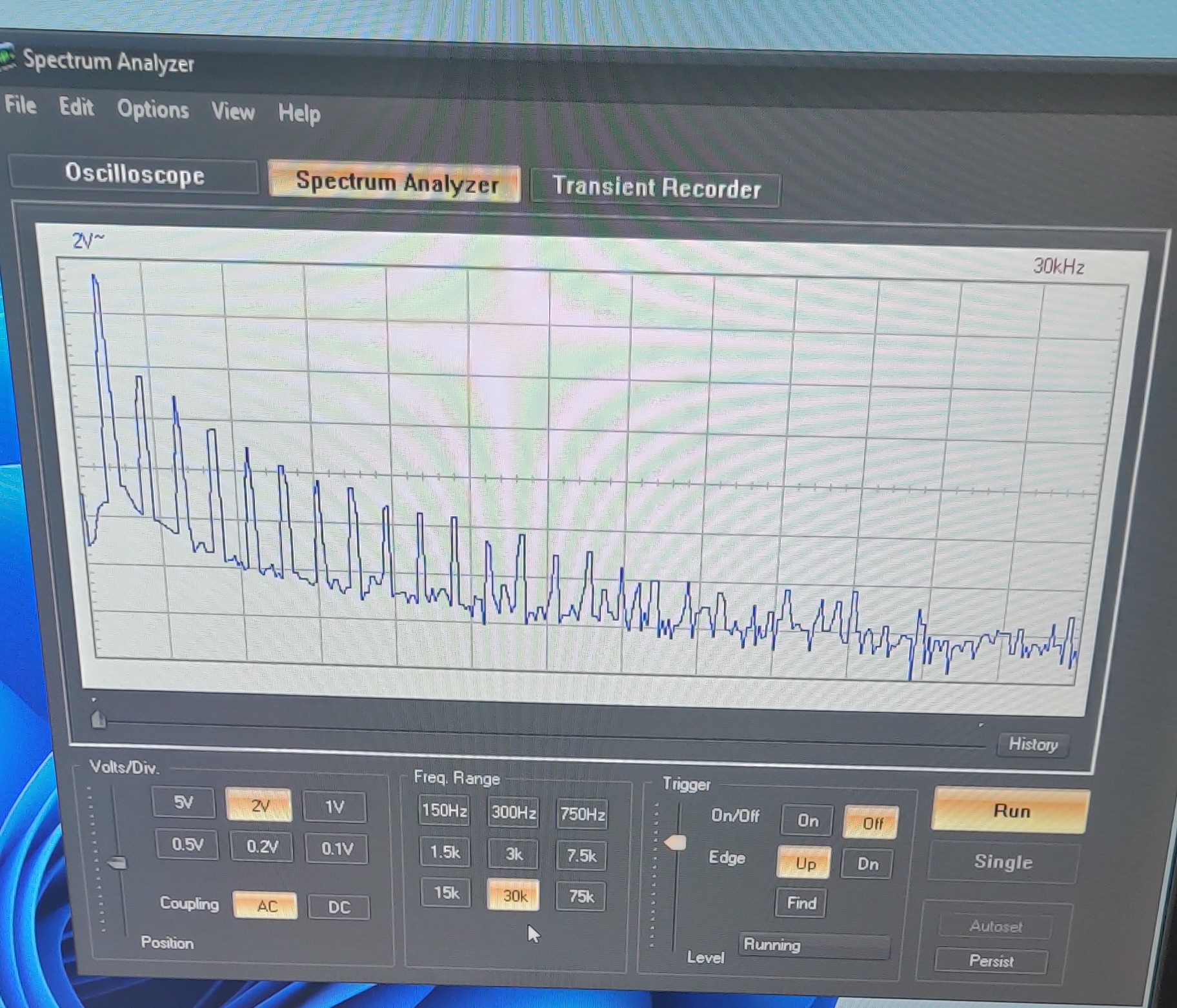

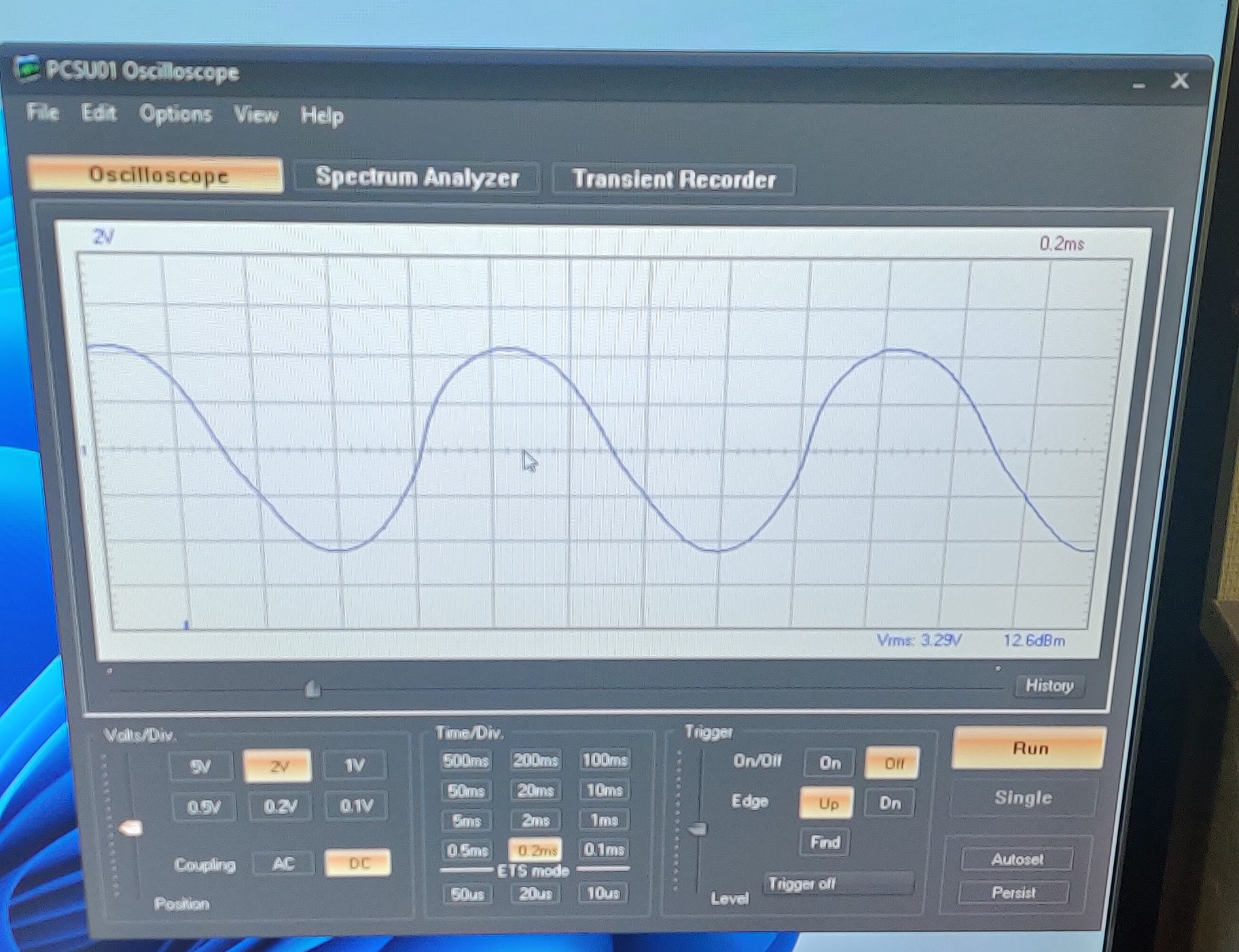

Some measurements.
OMG that's utterly horrendous - although the 100Hz waveform is the only one that's not obviously crippled, there's no FFT for it (nor are the axes labelled in the FFTs anyway). At a guess I'd estimate THD at 100Hz as ~1%, at 1kHz 10%, at 10kHz 40%
First observation you are trying to drive a FET gate directly from the soundcard - at higher frequencies a FET gate is going to look quite low impedance due to the large capacitance between gate and source and the Miller capacitance between gate and drain. Also this capacitance varies significantly with the drain current, which may account for the hyper-severe distortion at 1kHz and above, as this non-linear capacitance forms a divider with the output impedance of the sound card.

Have you thought about buffering the signal before driving the gate to see how much improvement?

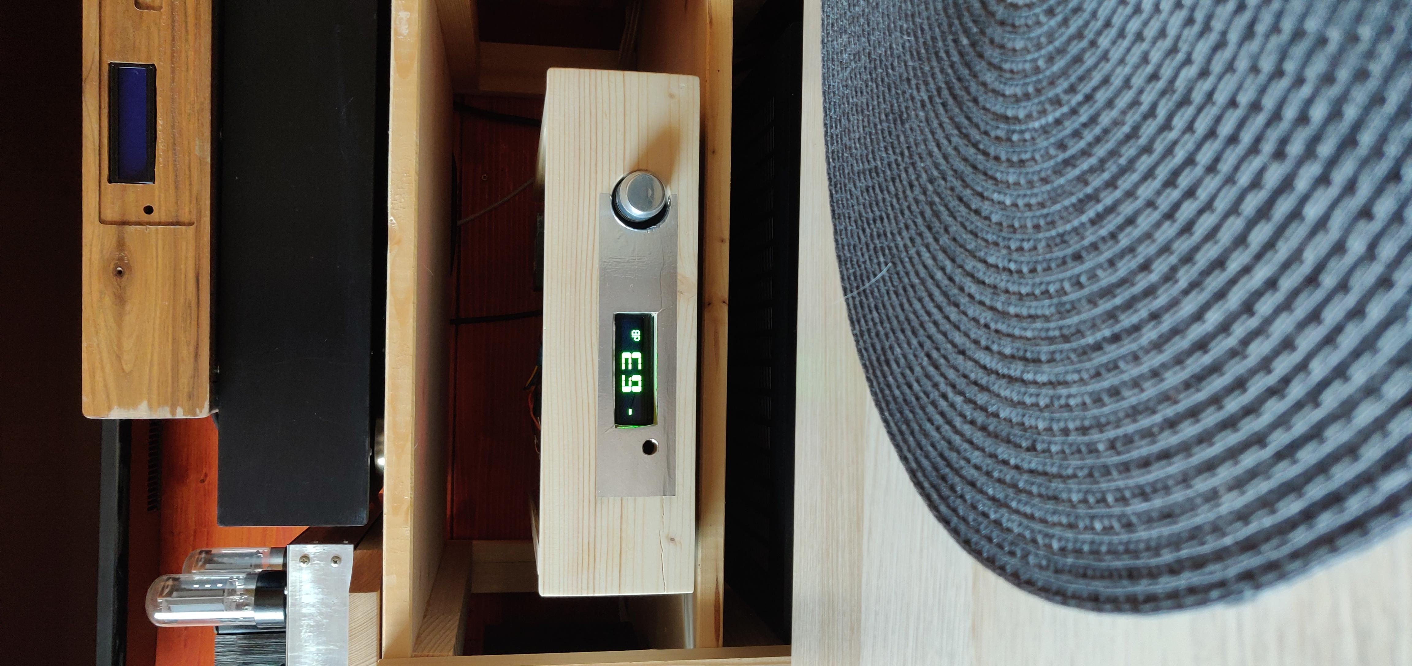

Pictures....

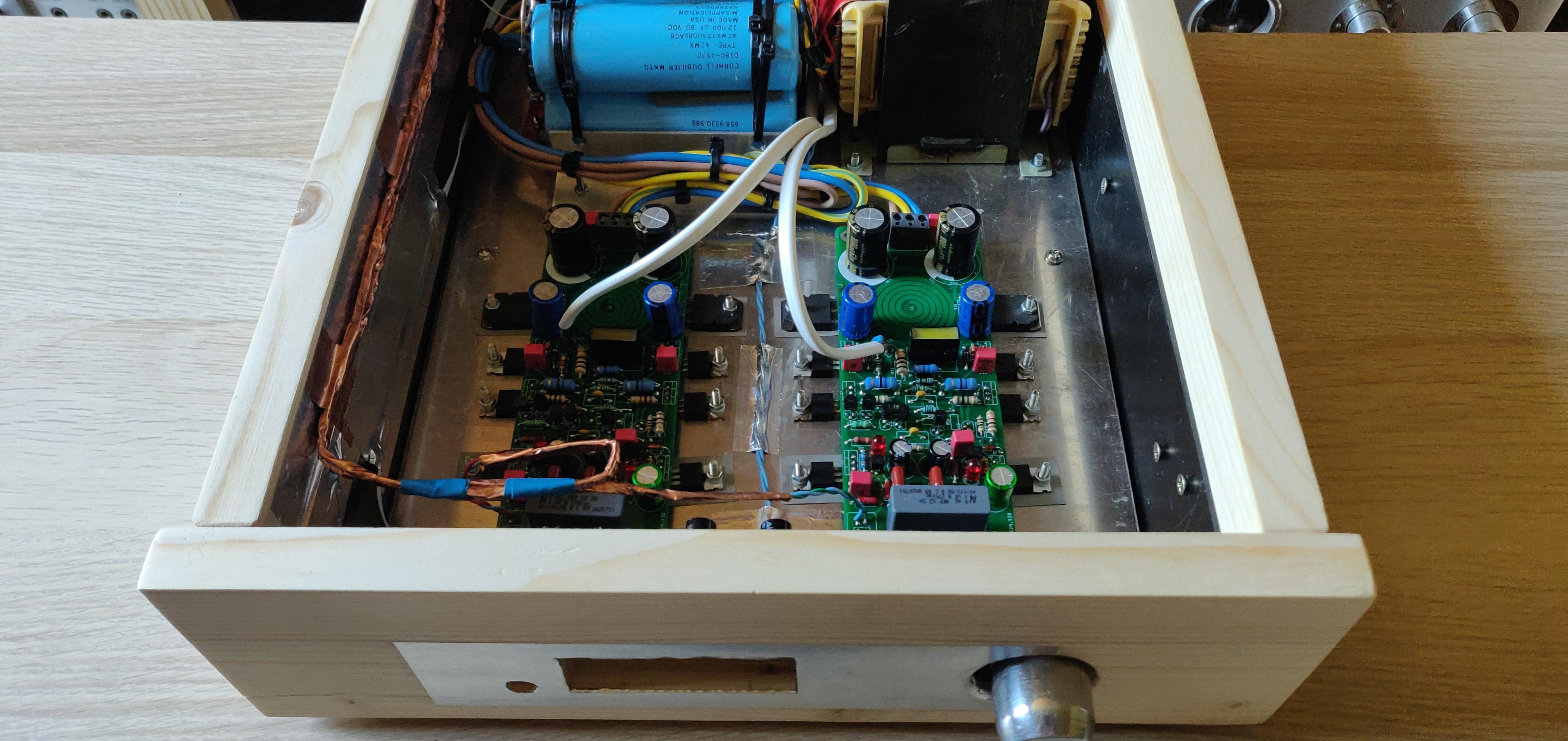

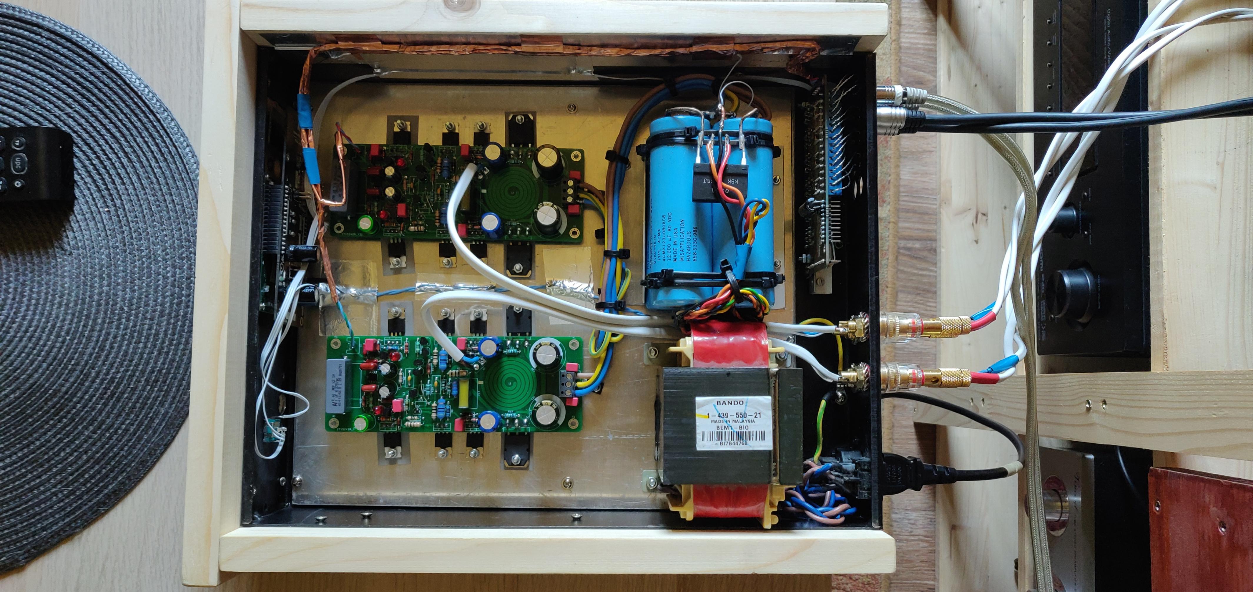

Hi Samu. Could you post more pictures of your amplifier, brighter clearer ones? I am interested in the way the connections are done and the internals.
Here is more or less my diy setup for SE pure Class A amplifier.
PS. Switch and fuse draw backwards...
Here are inside Class A SE
95% Power wiring has made 2.5mm2 fine silicone covered wire.
5% has made 2.5mm2 regular wire.
Audio inputs for Back are parallel connected, and are RCA, 3.5mm and 6.5mm.
There it will trawel forward for shealded microfone cable to driver board where is Gate bias voltage and audio injection for it happens.
For driver board it continues shielded cable to mosfet and center is connected directly with solder Gate pin and ground shiel to negative for main Power side.
Front panel has switch to change between headphone output on front 6.5mm or banana plug output for rear to speakers.
