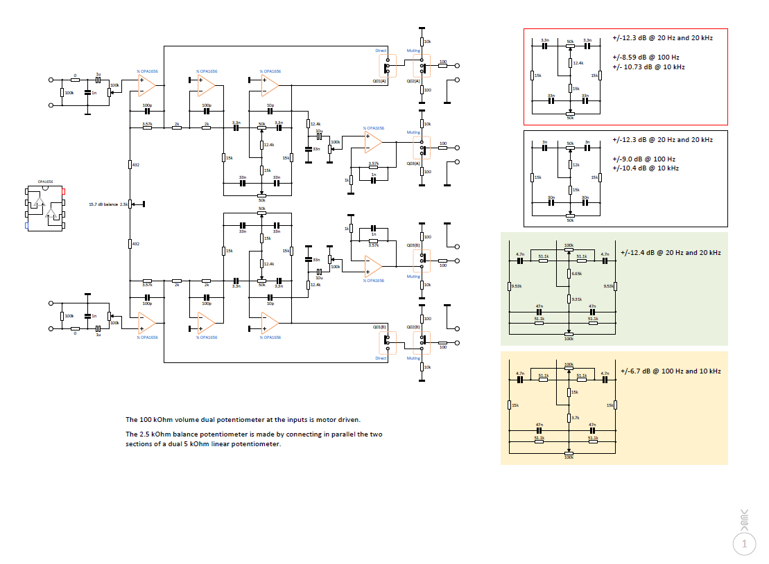

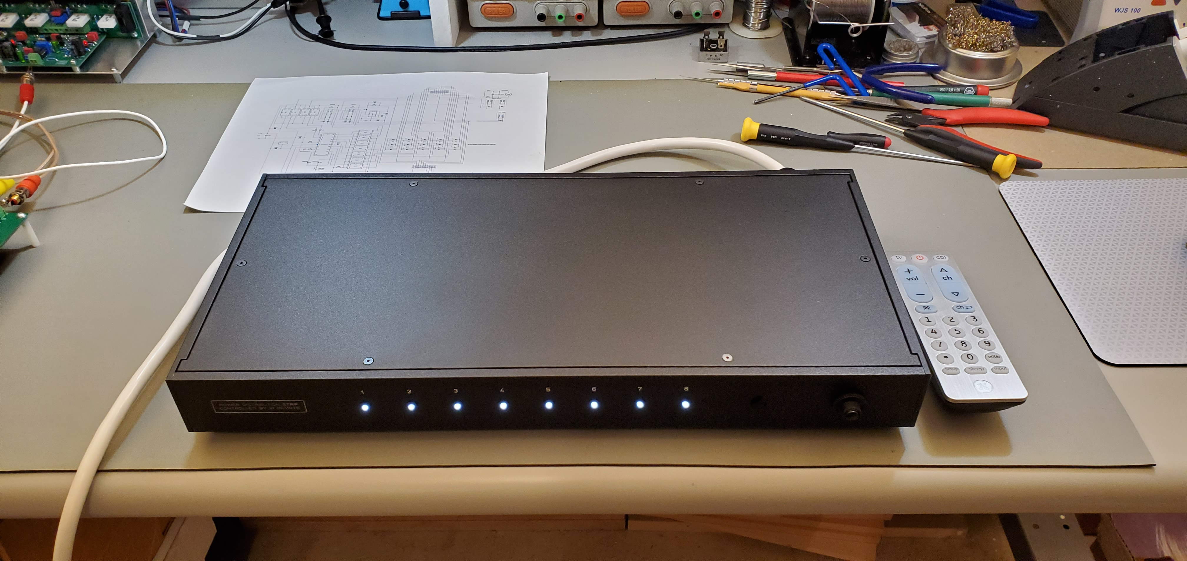

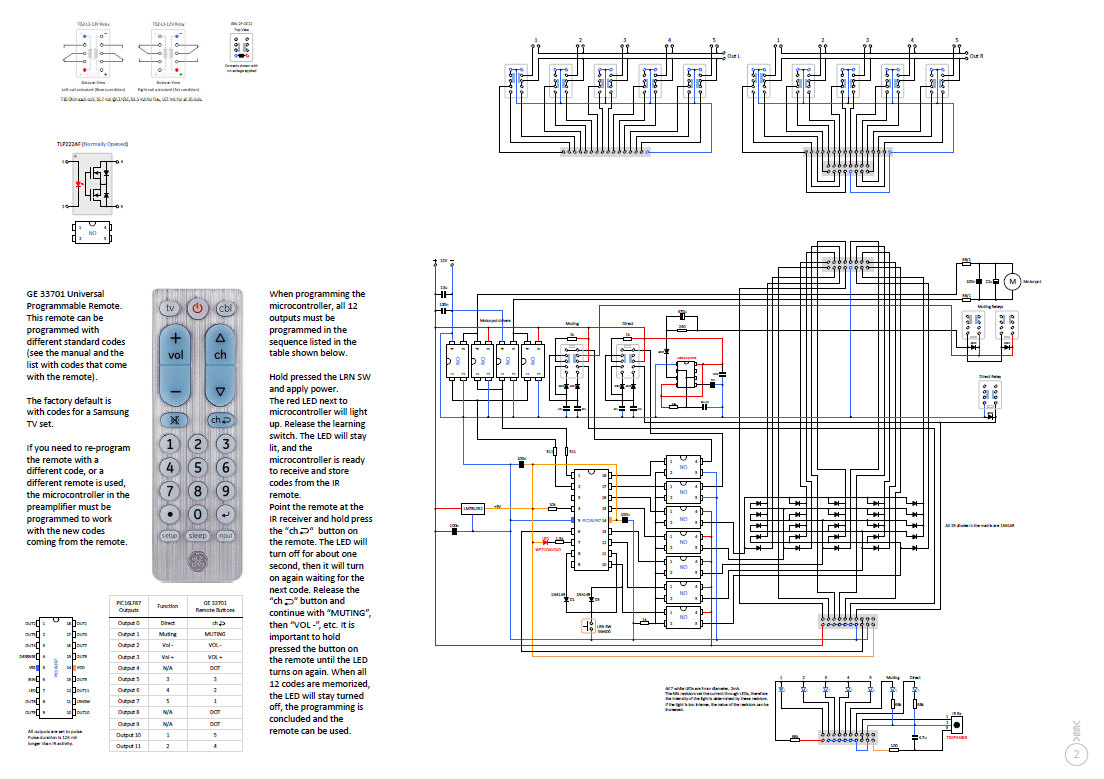

Yes, the relays are latching. Voltage regulators are LM317 for both plus and minus… for some reason the 317 are quieter than the 337s. This is the circuit I designed for this preamp.
VG
VG

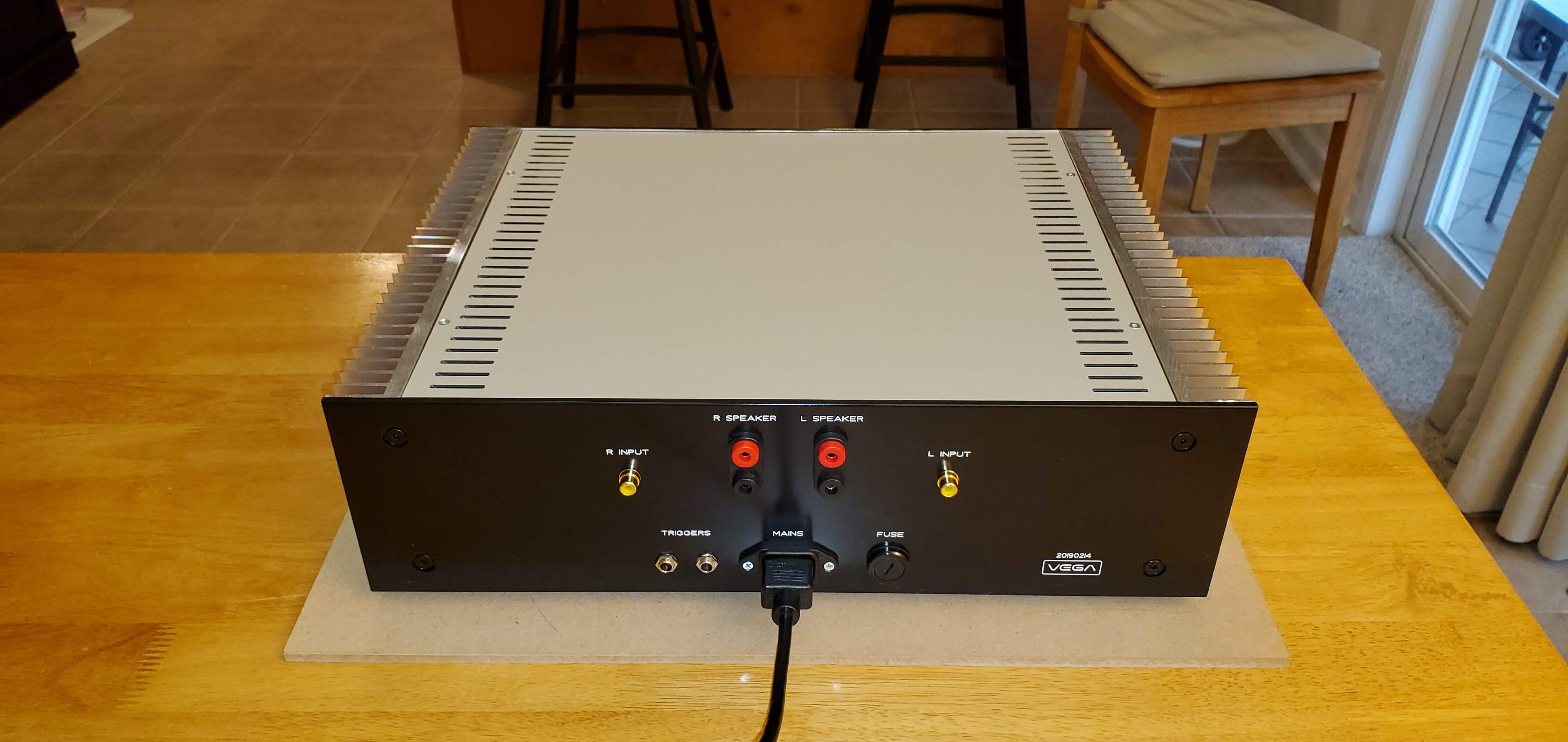

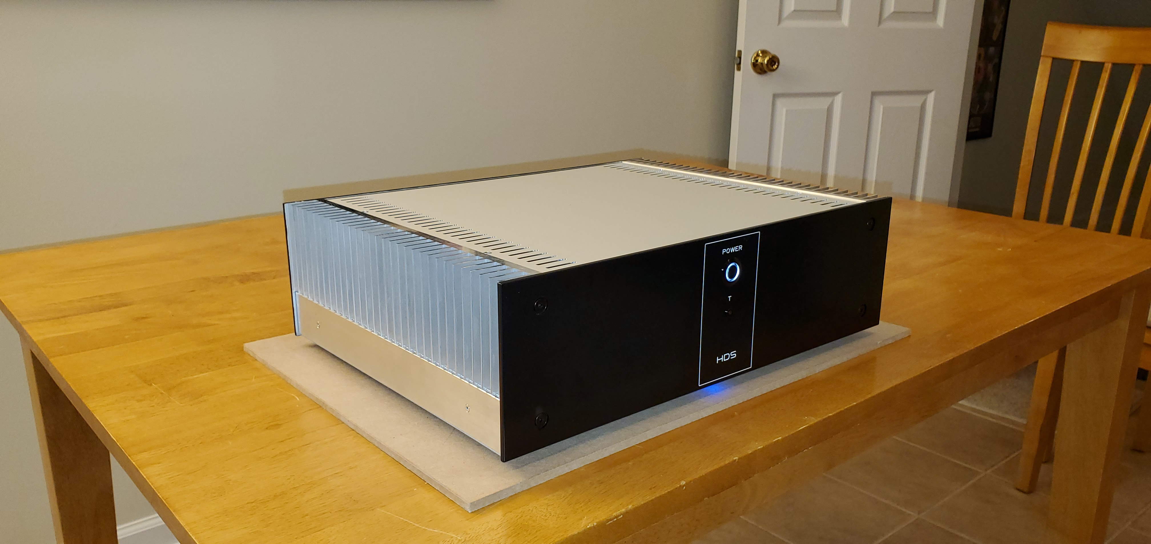

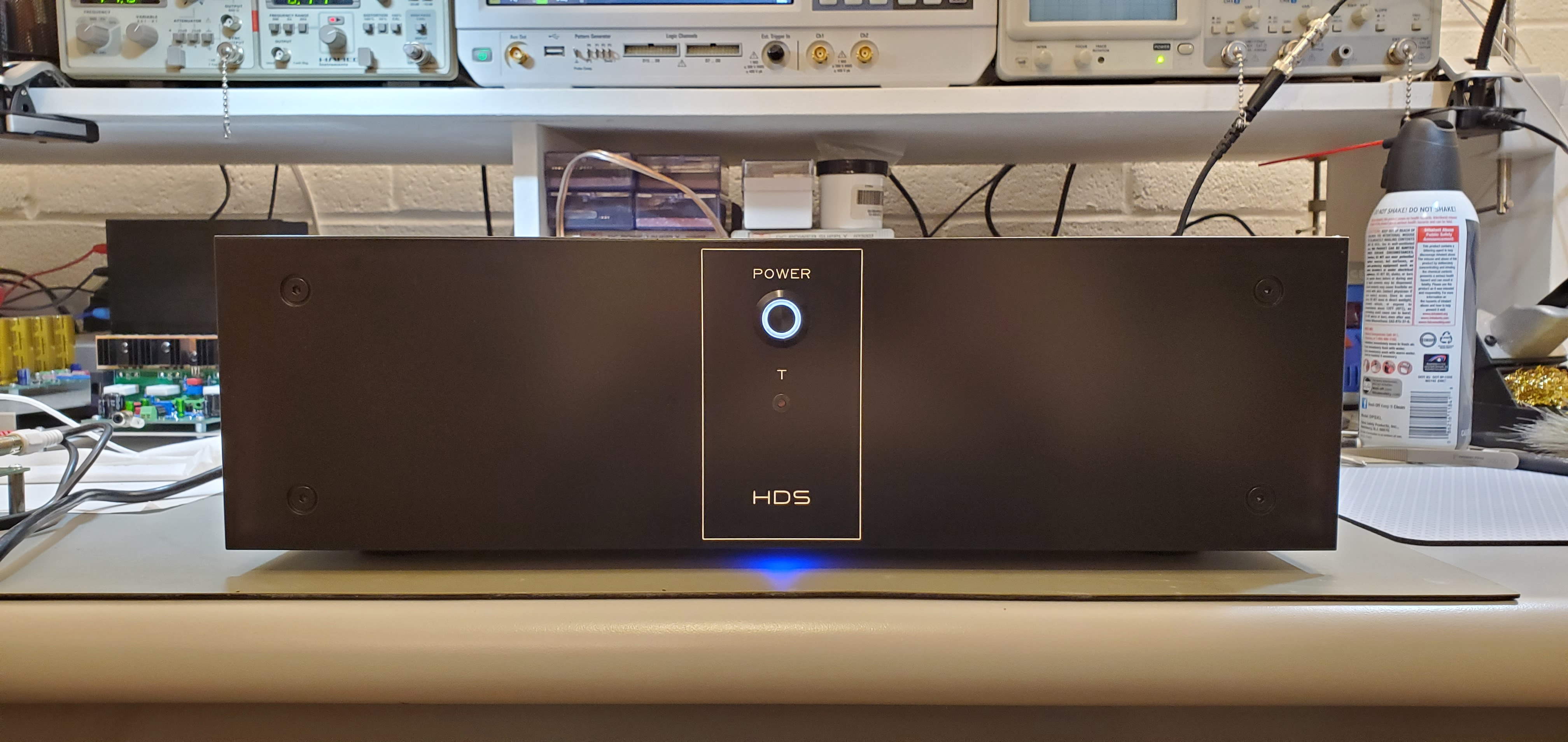

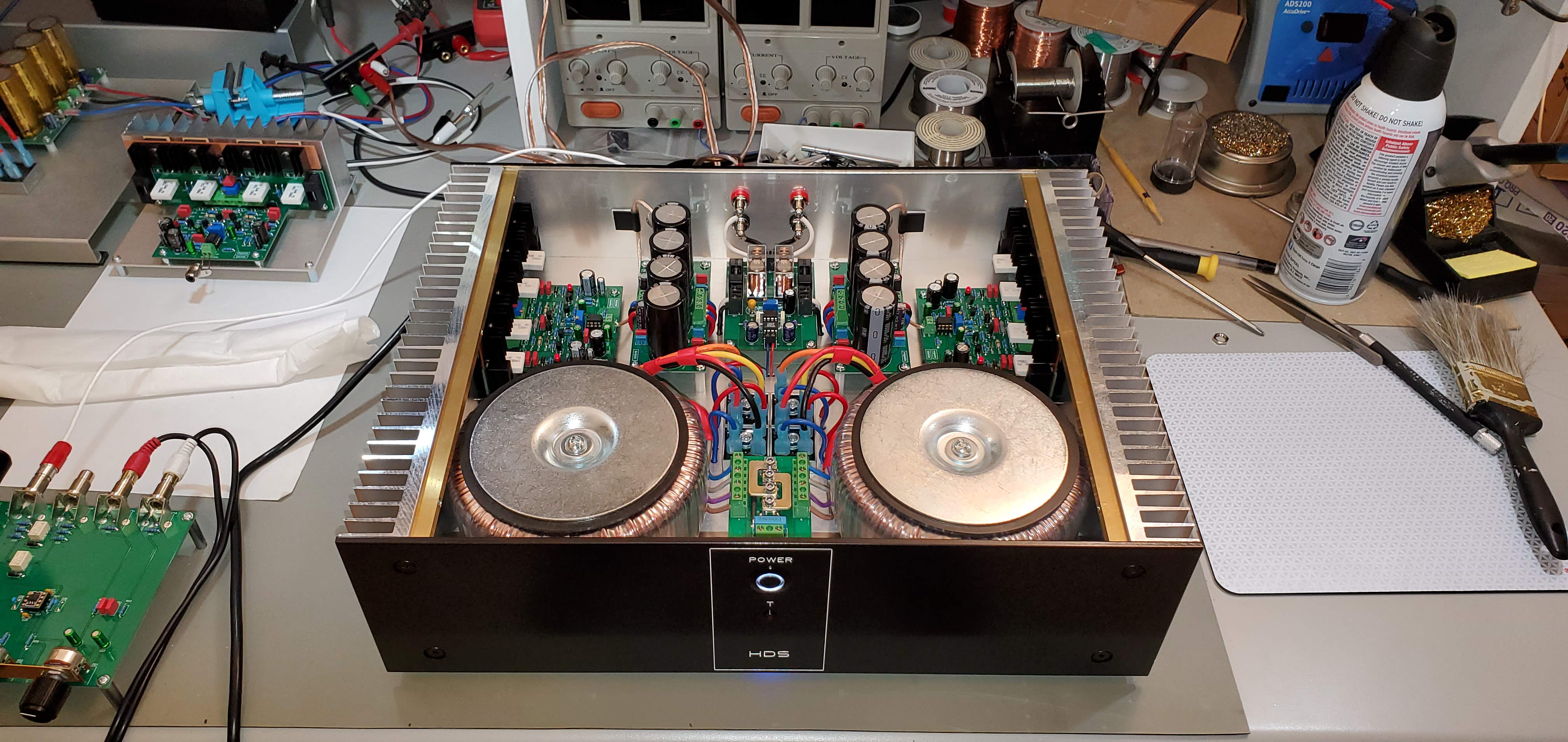

2S2A Power Amp
Before finishing the PreAMP, I built this power amp.
VG
VG

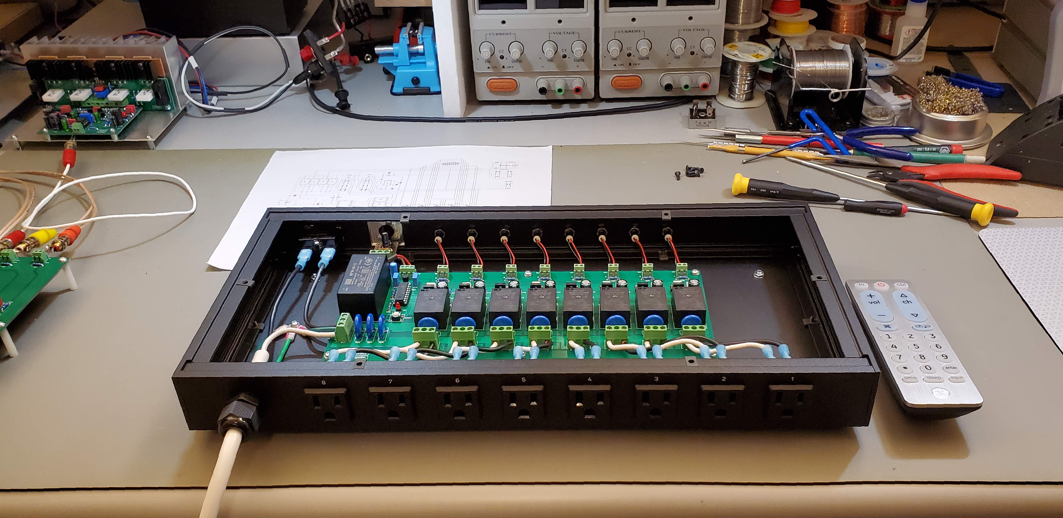

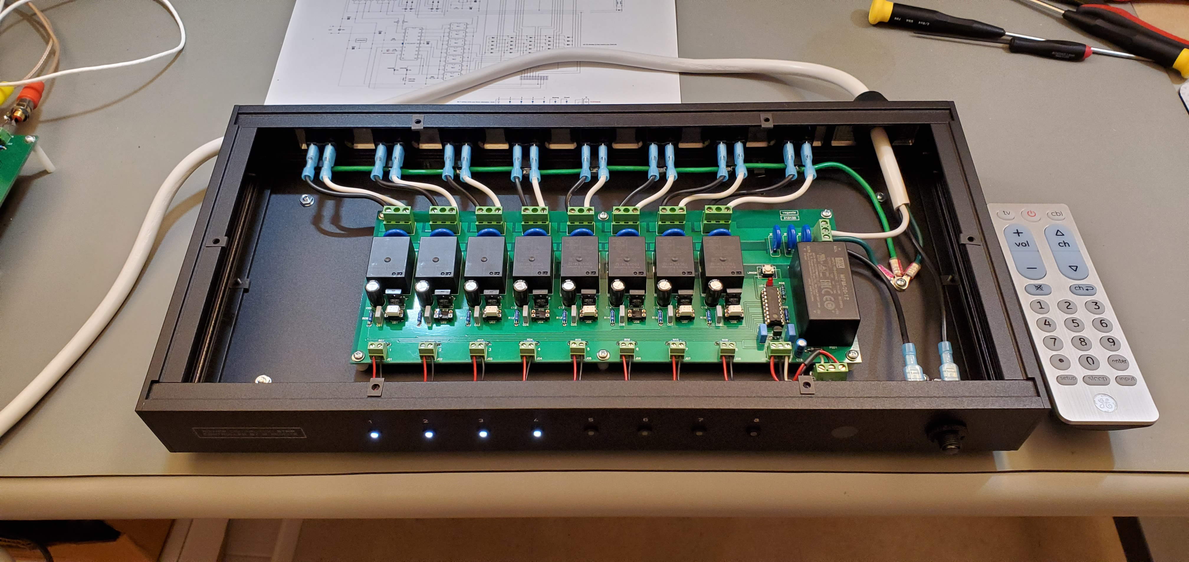

Thanks, von Ah!

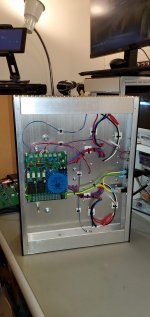

I will, but to power the PreAMP, the 2S2A2 amp, two subwoofers and other stuff I also built this remote-controlled power strip.

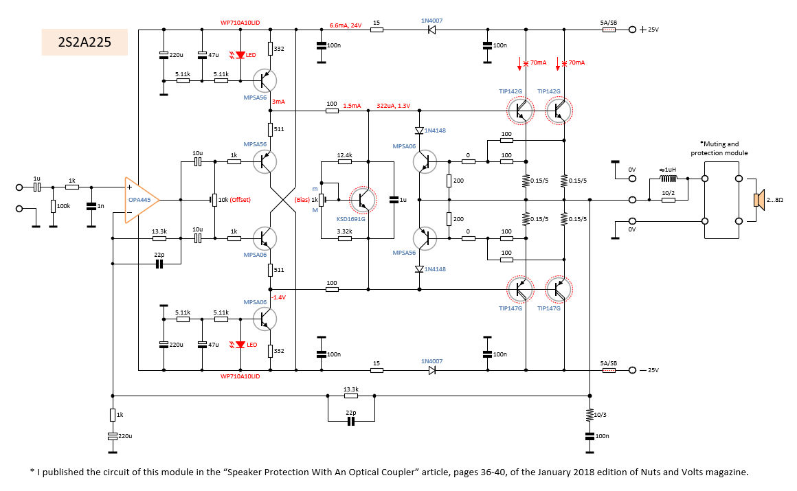

About the 2S2A2 amp…
Again, I do this because I want something better.
This circuit is the result of a few years of research.
Before this amp, I designed and built a good number of other circuits, class A, AB, and a few years back I played some D class off the shelf circuits, mainly the TI variety. I learnt a lot.
I designed this circuit with the OPA445 high voltage opamp at front end. This is the basic circuit. It is designed to work on 2 Ohm loads.
VG

Hi VeGATS,
A very well thought out and constructed project - and a pointer to what looks like a very useful magazine - Nuts and Volts. (Damn, another subscription )
I would like to experiment with some remote control 'stuff' and have a question for you. The chip you used to accept the remote control commands, is that a PIC or an off the shelf chip. I can't quite read the ident on the circuit diagram.
Regards
Mike
Regards
Mike

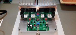

My first version of this legendary preamp came to life today.
Still have to perform some bias tweaking of the input Jfet's and output Mosfets. (2SK389BL/2SJ109BL and 2SK2013 + 2SJ313)
Compared with my PS audio preamp and my Calvin buffers, I have a very very good feeling about of this one. I'm only listening mono sofar and will not build a stereo version of this one, that will be for the final design and PCB's.
The heatsinks on the regulator PCB are to small, temp is 50°C above ambient!

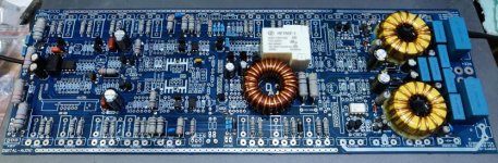

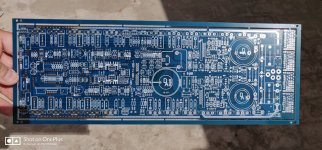

Finally the pcbs have arrivedslow progress
Wow ! A homegrown digital tracking amp like a Lab Gruppen.

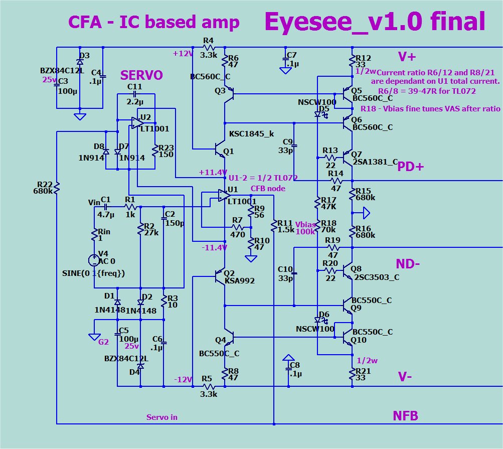

I tried that type design for my "eyesee" IPS. Very problematic in selecting just
the right OP-amp , compensation.
Then I found the inspiration for the "shunt/CFA" version.
I was even surprised with (2 people built it) of the fast CFA squarewaves
and stabilty , even with "junky" old op-amps.
Some ran this (below -with 80V rails). New version will have 12V pass regs.
This one might be coming to the store.
