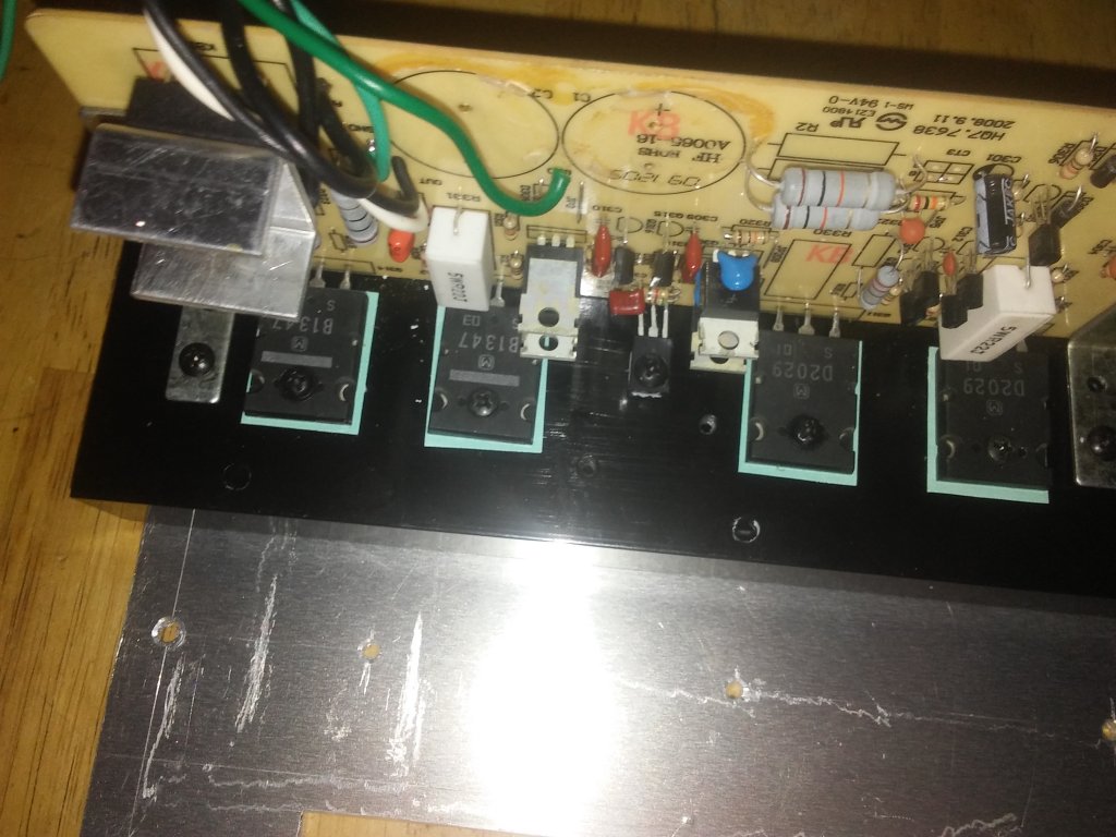

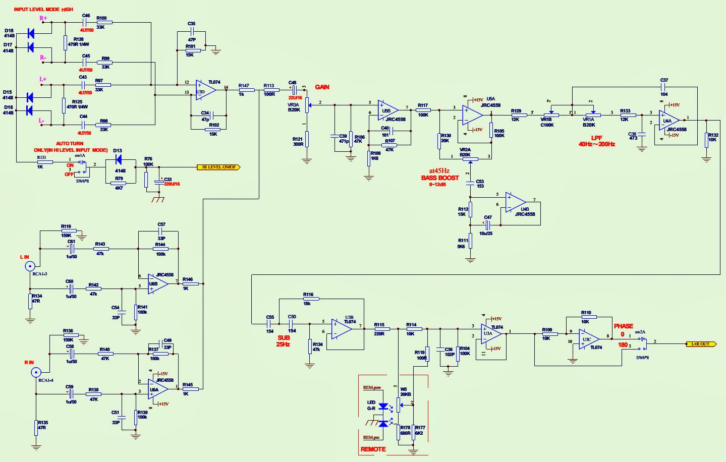

That is pretty much what I bought for 9$ usd on Ebay.
My bigger one will have infinite phase adjustment.
I'm a sub Whoore now. bigger one has 2X D2029/B1347 , (below)
peerless beware !
I' glad I diy'ed instead of
spending 179$usd for a parts express stupid plate amp... China POS
I have 2 way better amps for my 10/12 " subs.
The 10" I'm hearing now is impressive. I can "blow the curtains"
with my keyboard pictured before. C1 / D1 (33/37hz) notes makes my hair blow
where I sit. Polk POS amp never did this , same keyboard.
I'm actually impressed by the polk OEM sub driver - I can't blow it.
OS

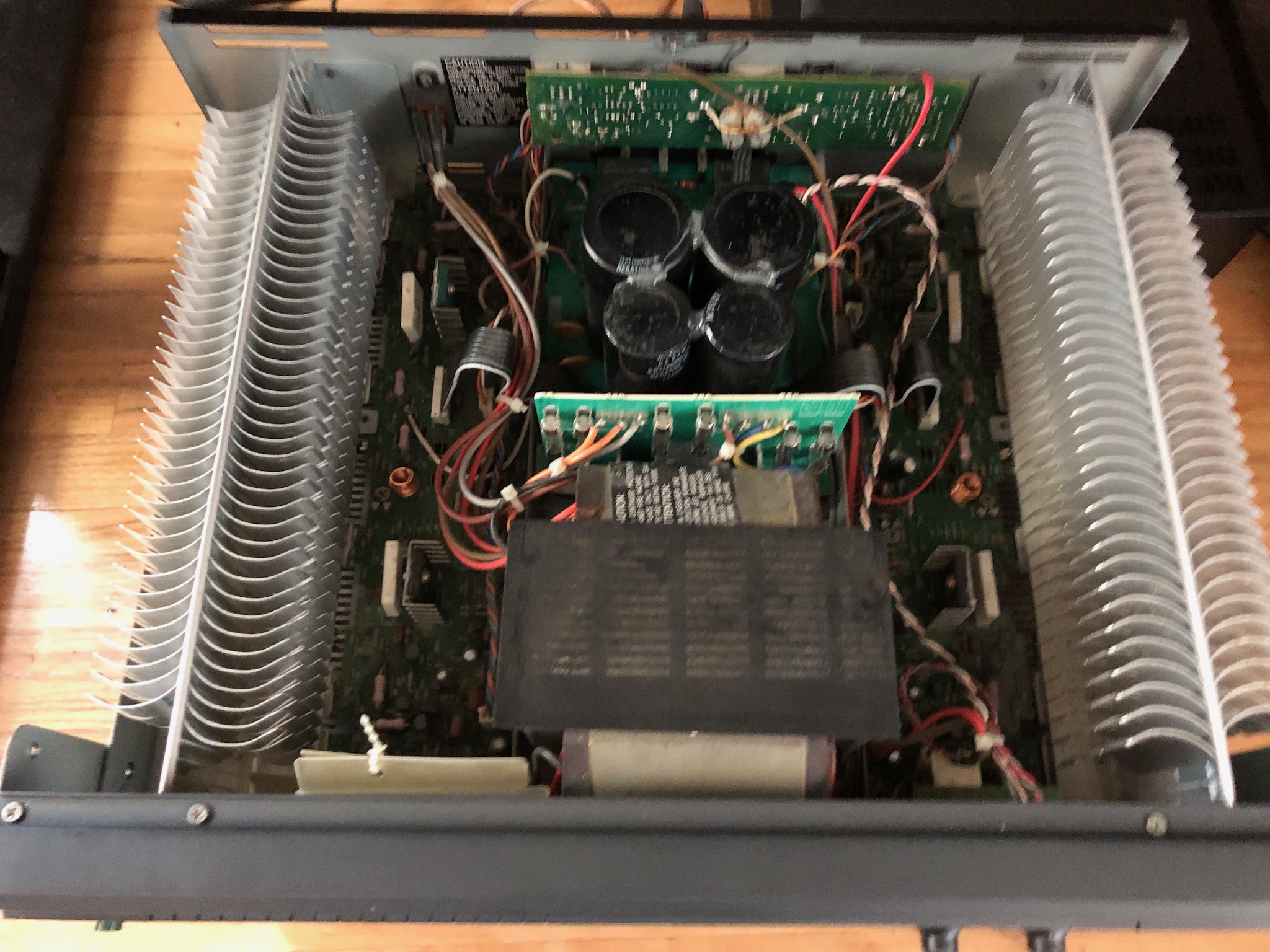

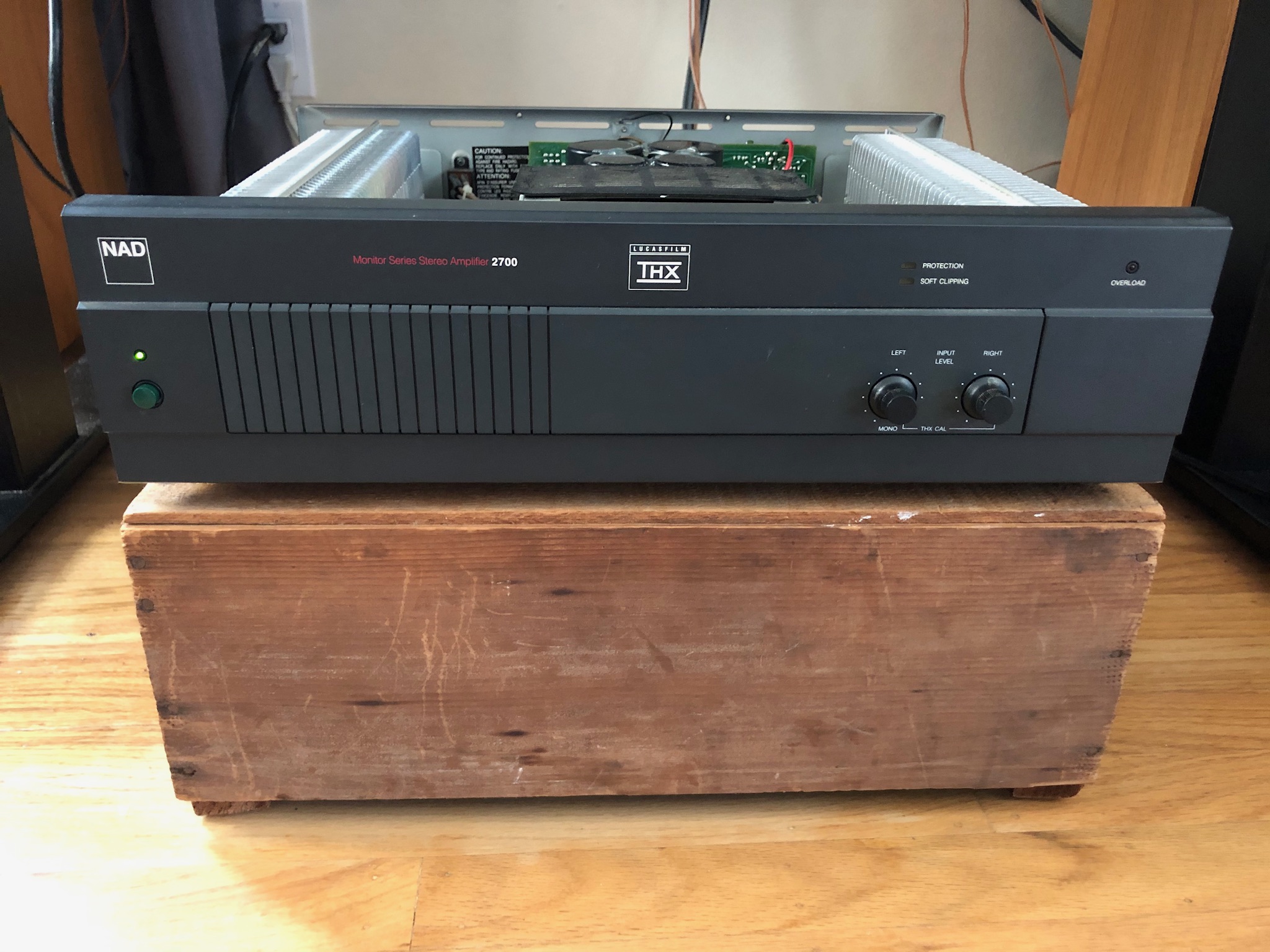

Class G tracking amp with 60V/95V rails. 2 pair toshiba 1302/3281's and
a third pair for the tracker. Input stage looks like a Sansui with 2 stage LTP.
Never seen this one. Electrotanya has the schema.
Input stage was quite liked by my people. Tracking class G is more "audiophile"
than a "dirty switcher" (Class H). Must belt out quite the peaks !
OS

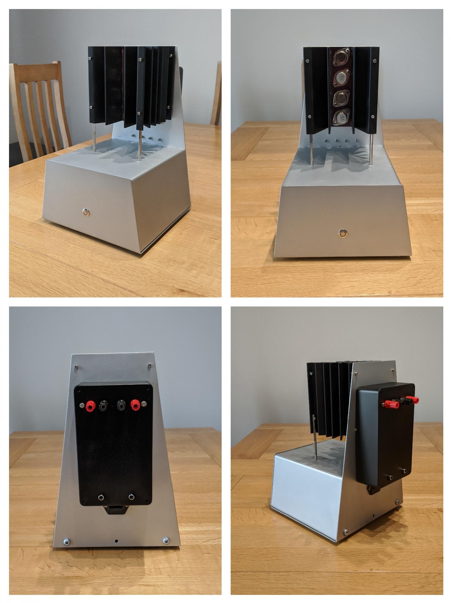

Here's something I originally built around 20 years ago, but renovated/finished off during lockdown.
Dual mono, Class A, 8W/channel into 8 Ohms (Could be biased for more, but that's plenty for the 97dB@1W "Dallas II" horn speakers I built).
Nice, this is a kind of art.
Thank you for the pleasure of witnessing a good scratch build. It’s logical, original and clean.
Amazing! It’s beautiful.
That's a cool looking and stylish machine 🙂
