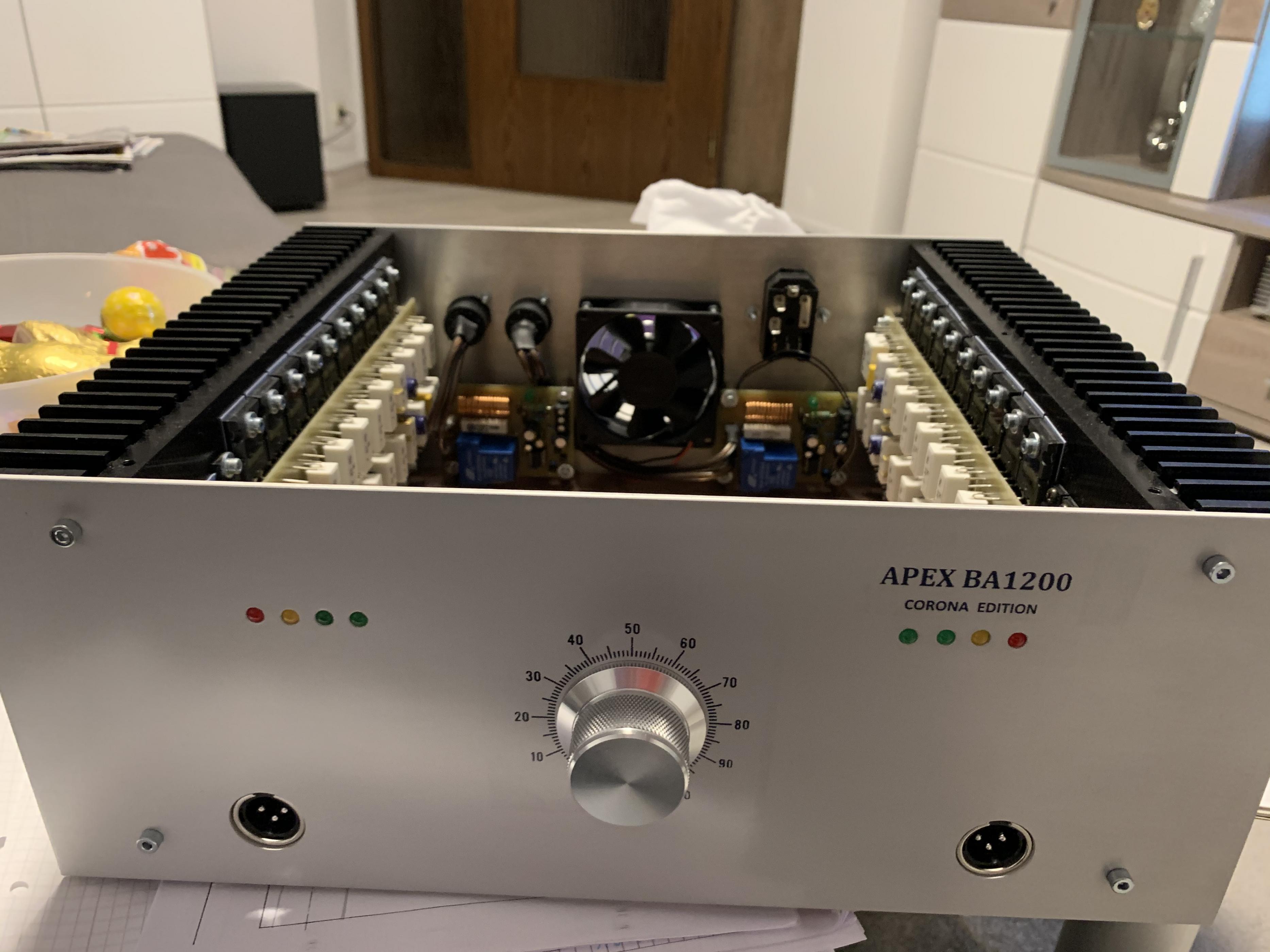

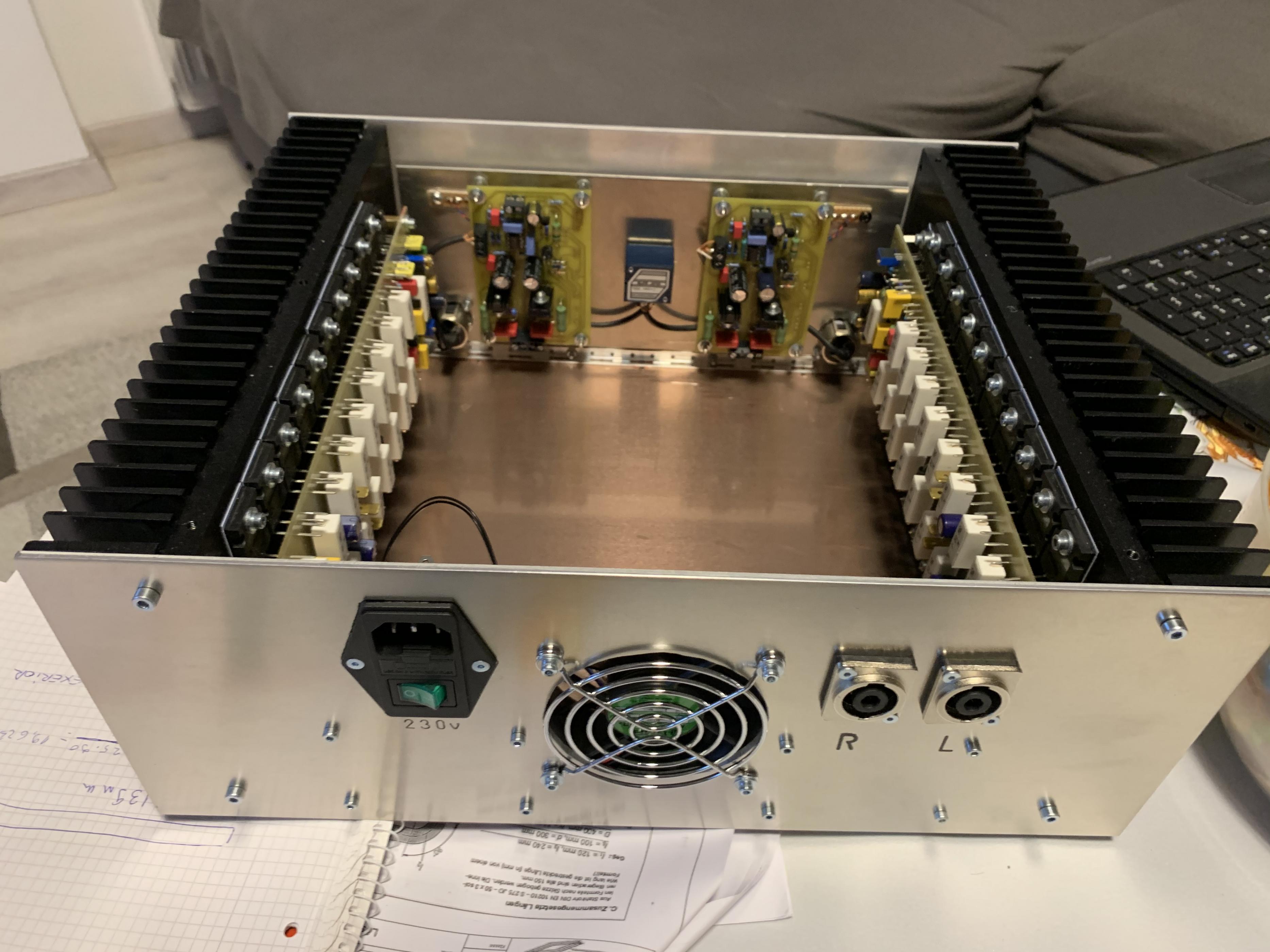

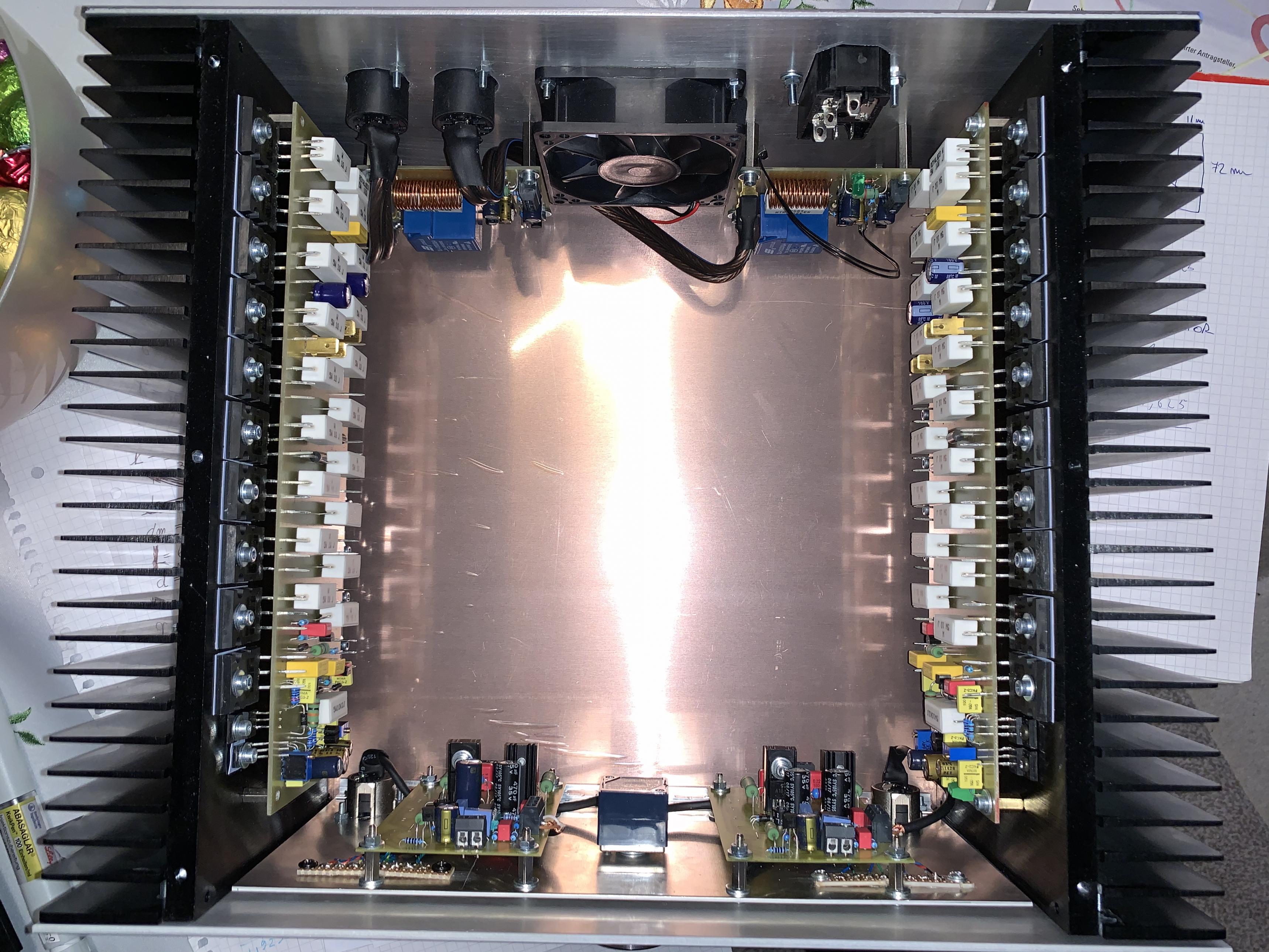

Beautiful build Dijwim. Im curious to know how you managed to secure the top plate the the rest of the chassis? I see holes in the chassis, bit not on the top plate
Thanks for your comment :).
Both the front plate and the top plate are glued on top of another aluminum plate that holds the screws. This way all screws are invisible, but still a tight fix.
I would love to see a pic of what you mean, cant quite picture it.
here you are, a pic of the underside of the top plate
So the top plate just sits on top of the enclosure (it is not screwed)?
By the way: fantastic build !!
Yes for the moment it is not screwed on. But it is a tight fit and I need some force to place or remove it. So if I hold the amp upside down it doesn’t fall off.
But there is a way from the bottom side to place the nuts and tighten the screws.
And thanks!
