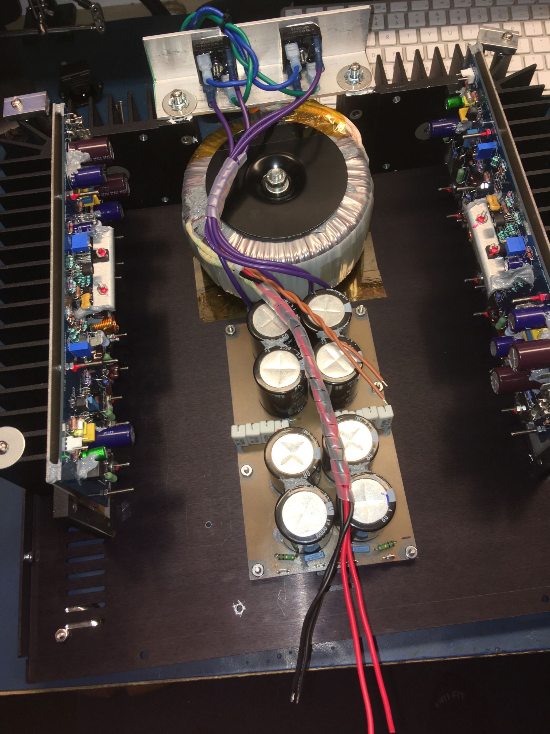

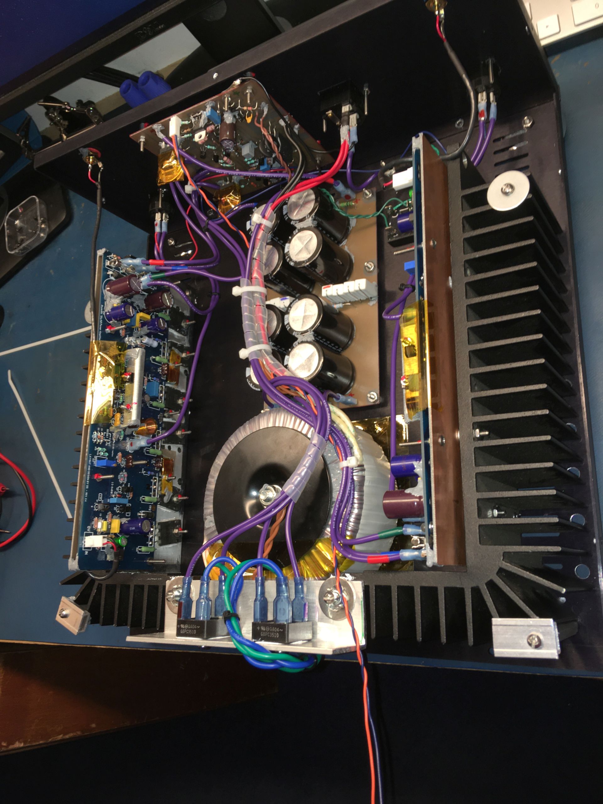

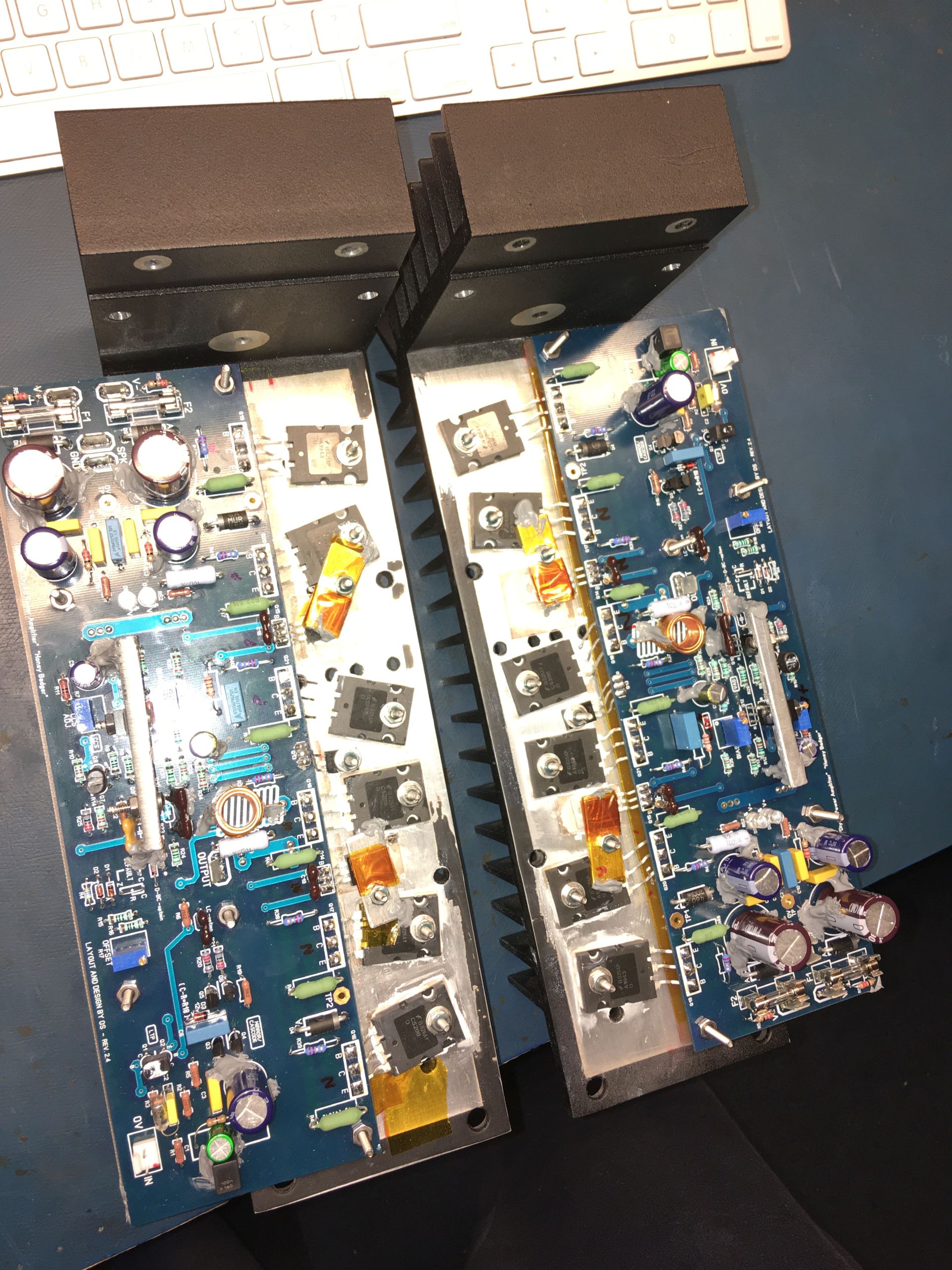

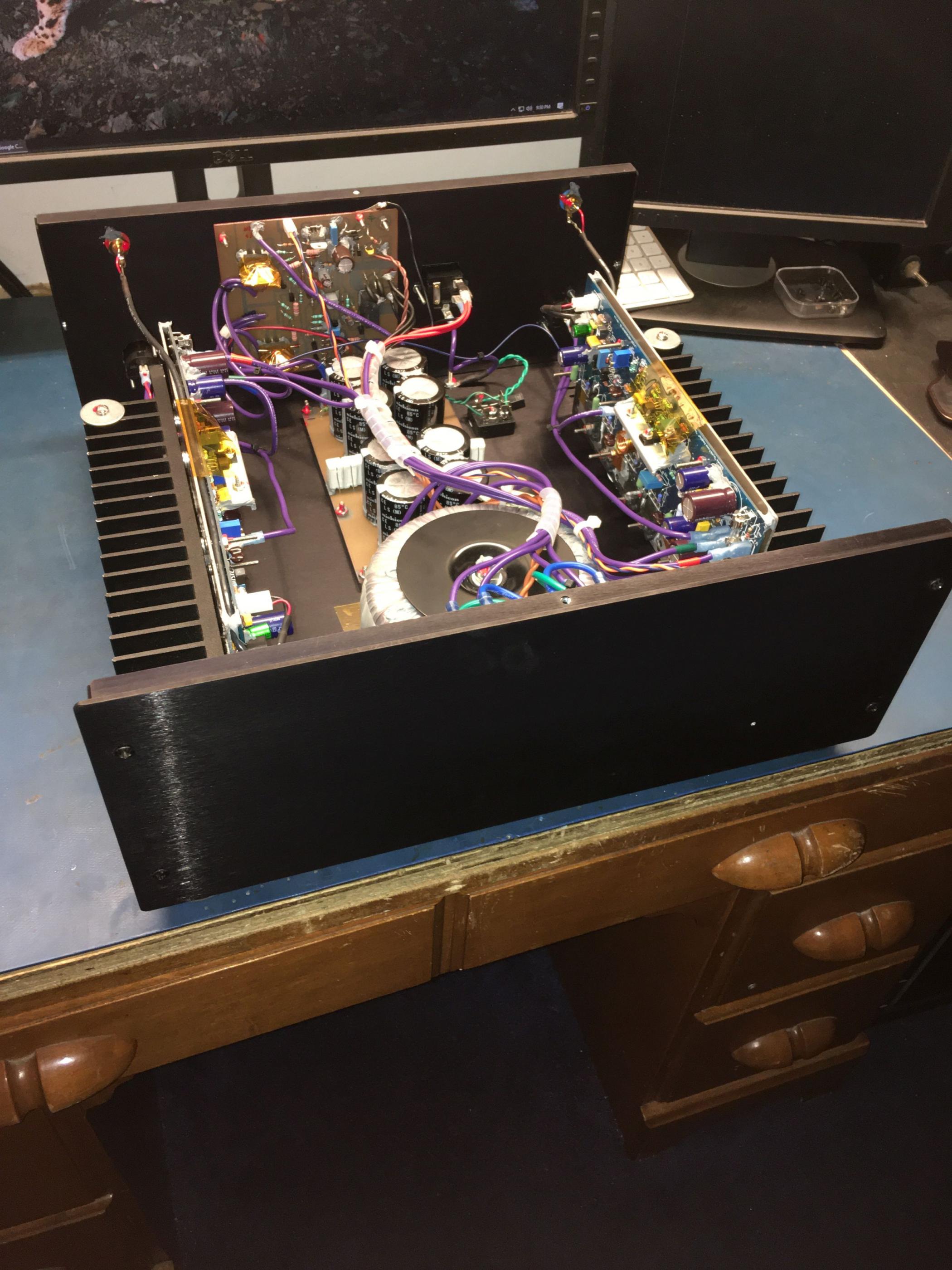

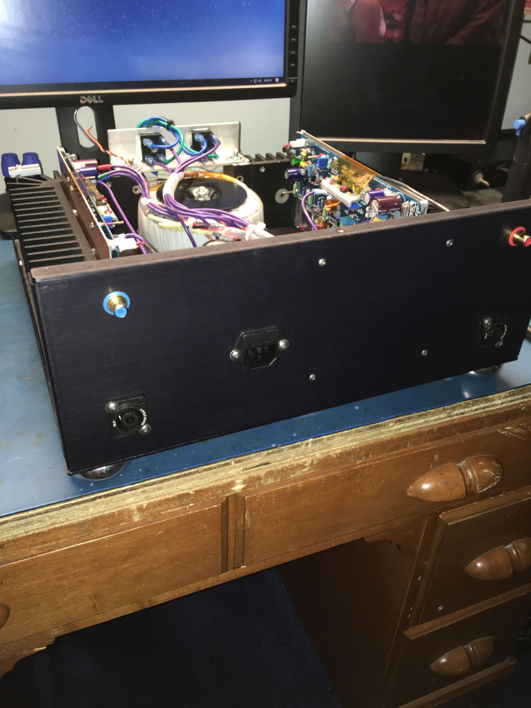

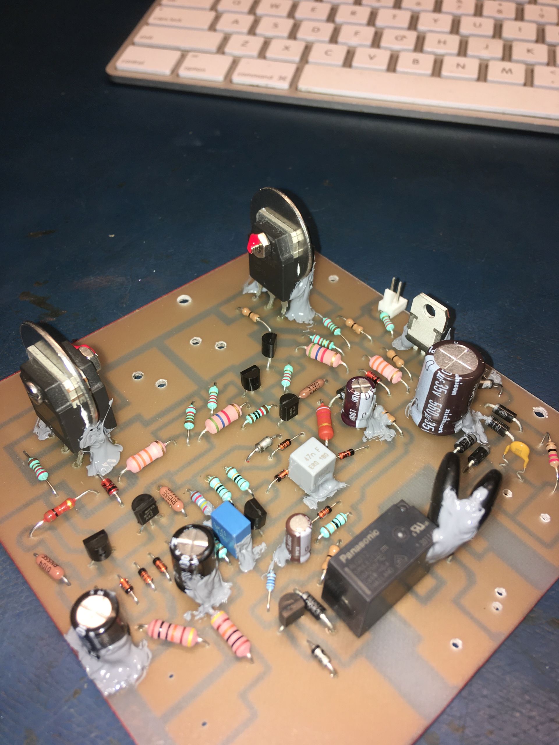

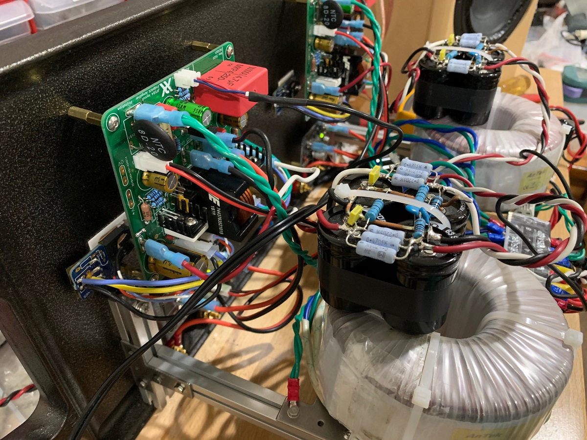

DIYAB HoneyBadger Amplifer
Just finished this today, have had alot more free time lately. It includes my custom designed protection circuit that disconnects the power from the amps with some FET's if it detects DC on the output or any overvoltage.

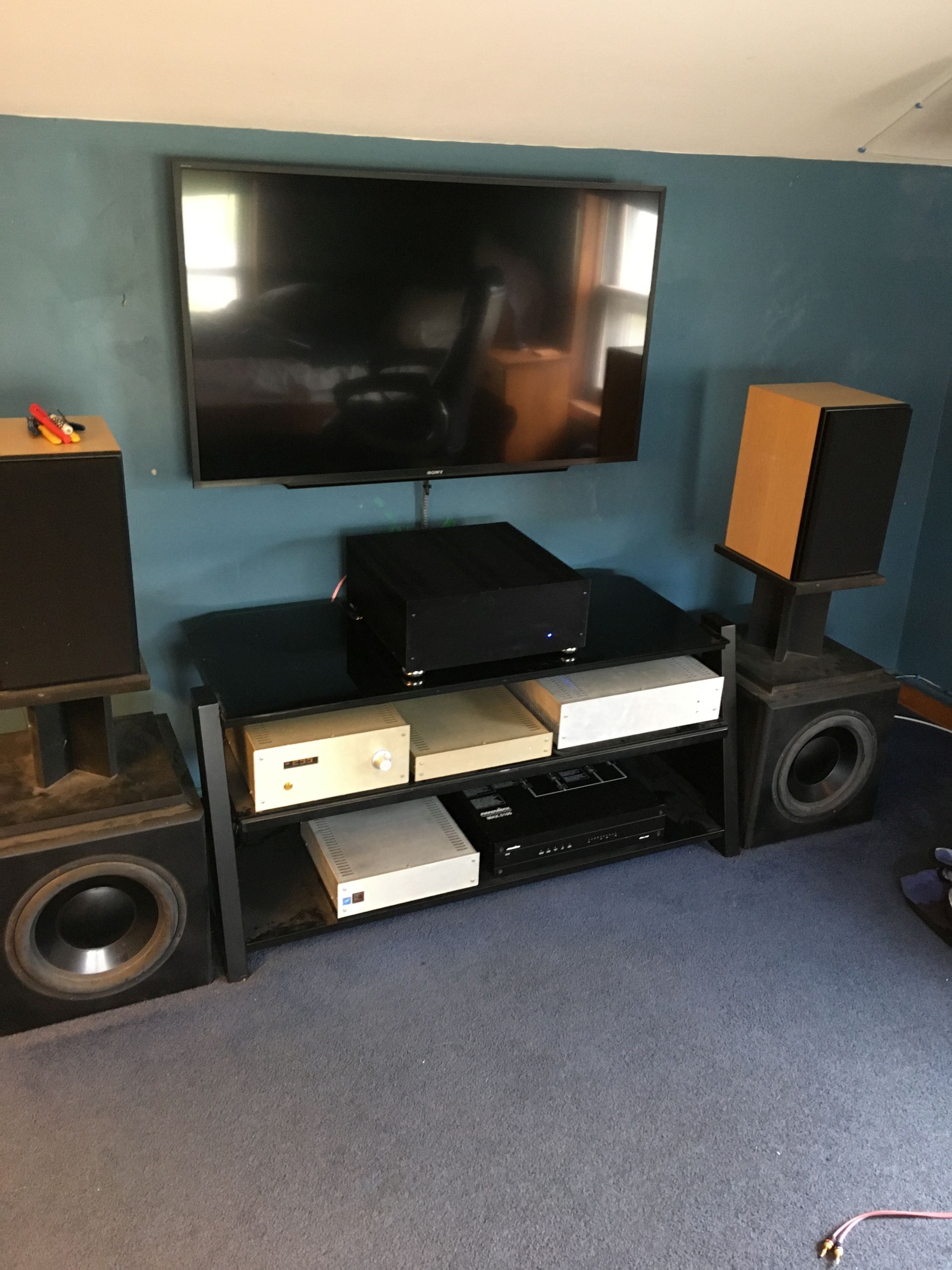

Is that a Purifi woofer in the back ground?Maybe when I run it in Class A 🙂
Yes, that was used as the inaugaral test speaker! 😀
Very nice. Amp and speaker! How do they both sound?
And dual Flukes too... Very nice.
They sound great together. More on the speaker here:
Simple Passive Harsch XO Using PTT6.5 and RS28F in a Waveguide
I am in process of making a TL version but with same passive Harsch XO.

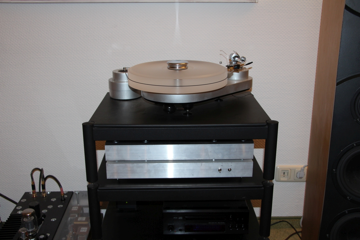

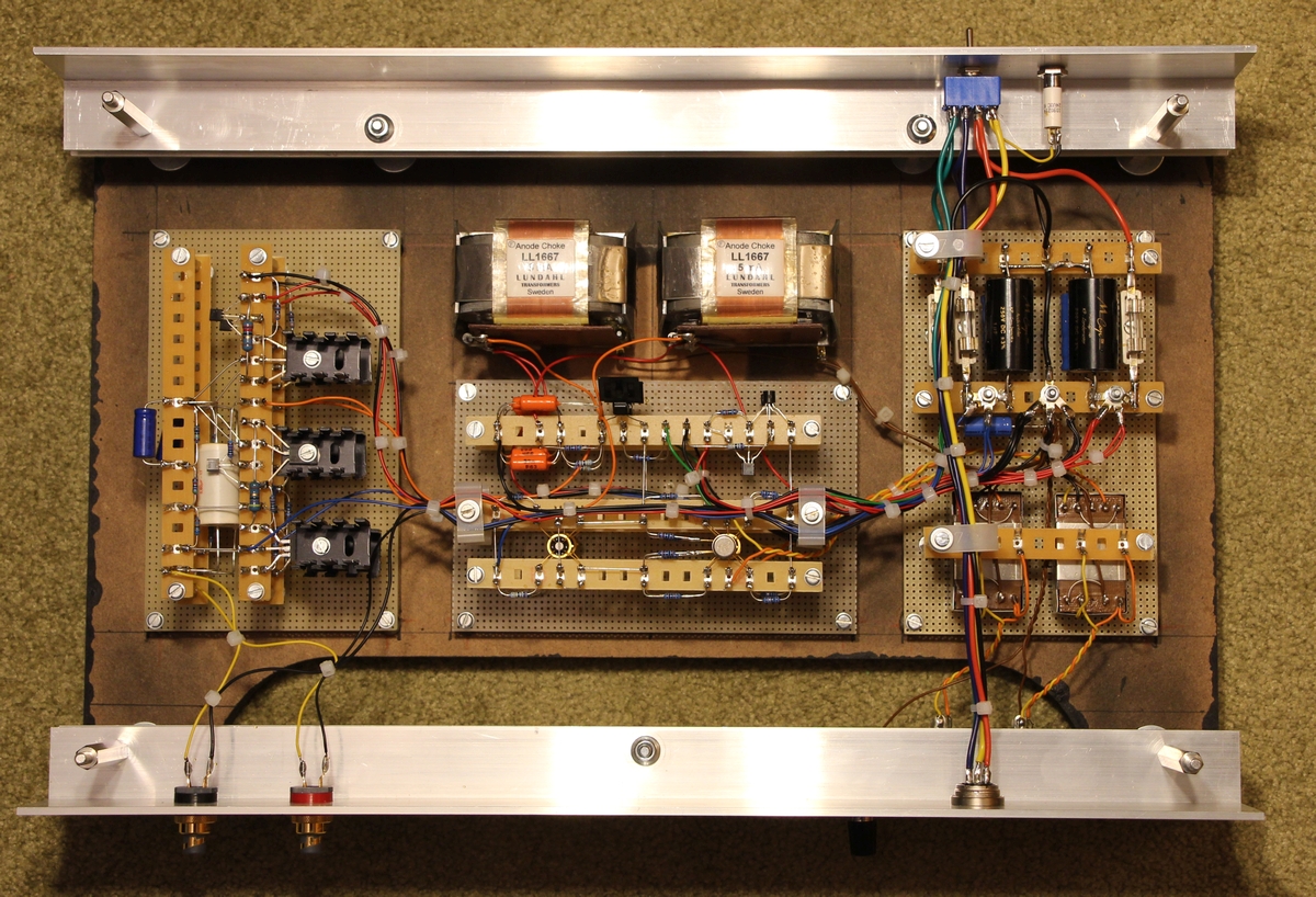

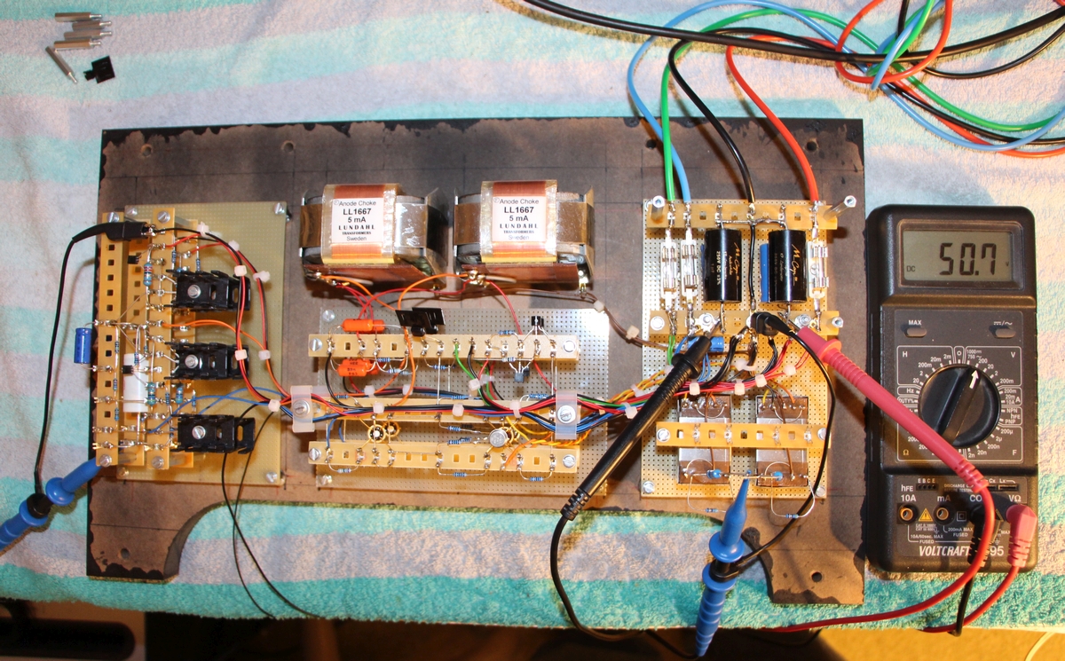

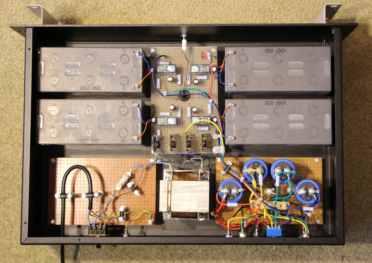

My new Phono Preamplfier
Hi there,
this is my latest moving coil phono preamplifier with an accumulator-based power supply delivering 48V in 12V increments. It comprises a high amplifying input stage with a Lundahl input transformer and low noise 2N3810 and MAT12 input transistors. The concept is a folded cascode with a differential input and a single ended output. The input stage is followed by a passive RIAA-equalization and an impedance converter at the output. The trick to achieve high gain is a choke that allows rather high idle currents on the one hand and a high impedance RIAA network at the cascoding transistor on the other hand. Output voltage is 1Veff with 0.4mV input voltage @1kHz. Maximum output voltage is 30V peak to peak.
Hi there,
