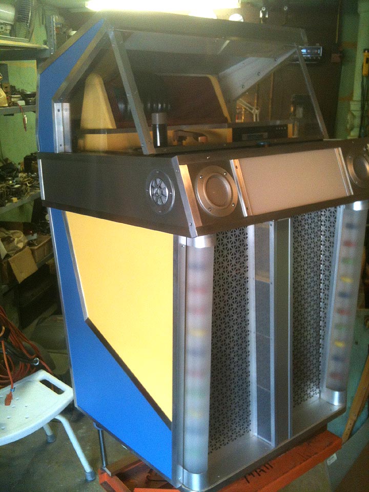

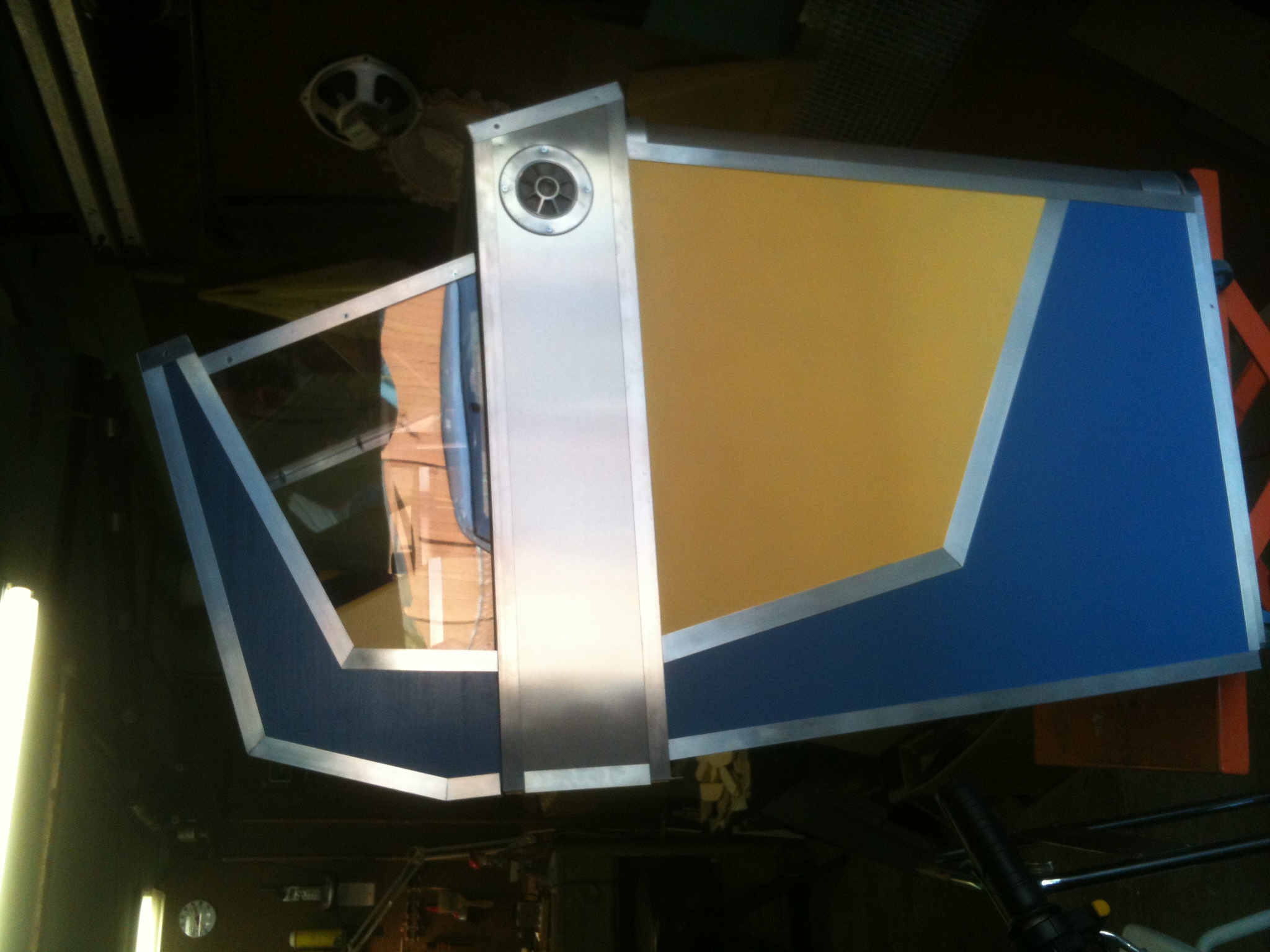

How about my home-made 200 watt jukebox?

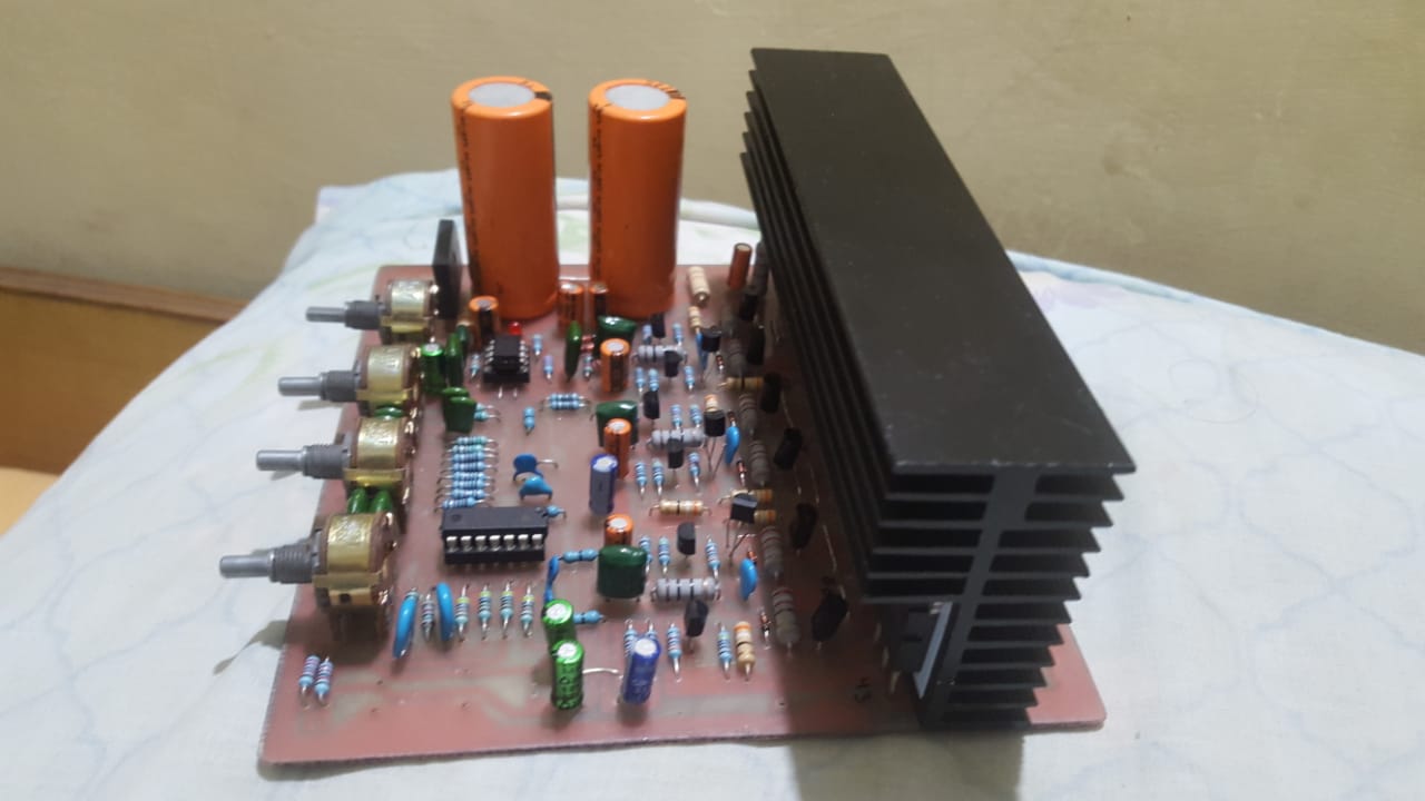

New modification A + A / B
RMS: 300 W 8 Ohm
600 W 4 Ohm
1200 W 2 Ohm
Gain coefficient: 30 dB
Dynamic range: >100 dB
Damping DC coefficient: 5000 @ 8 Ohm
Peak output current: 96 A
Nonlinear distortion coefficient: <0.01 % within the 20 Hz-20 kHz range
Frequency response: 10 Hz-200 kHz +0,-3 dB

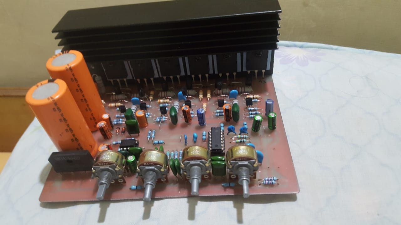

Hi Frantisek,
Don't worry about your language being rough. Mine is worse so you are doing a lot better than I would be.
I was wondering if the copper traces on the circuit board could carry the high currents this design can deliver.
-Chris

All copper traces, for high currents, are well tin-plated and connected by 16A wires.
(rails, ground, power transistor collector / emitter and OUT).
The amplifiers have been working in my gym for nearly two months.
Usually only at 10-20% power 🙂
It's a home gym, not an ibiza disco 😀
