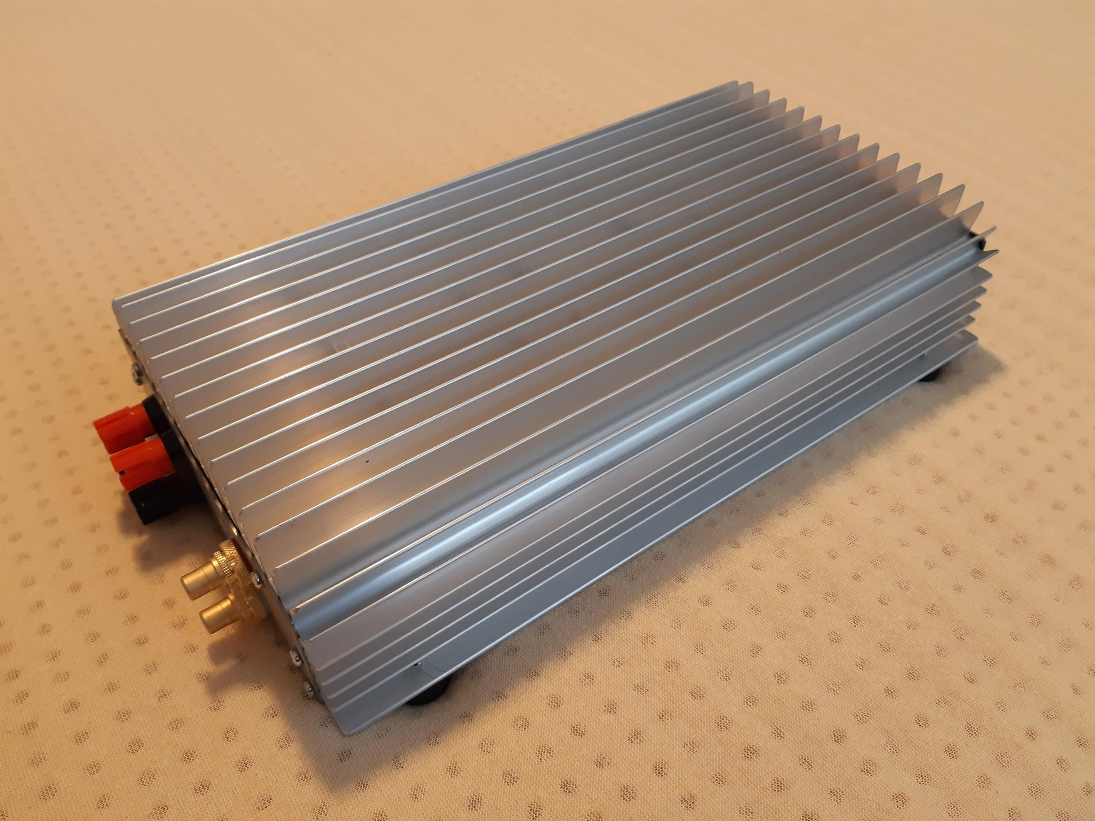

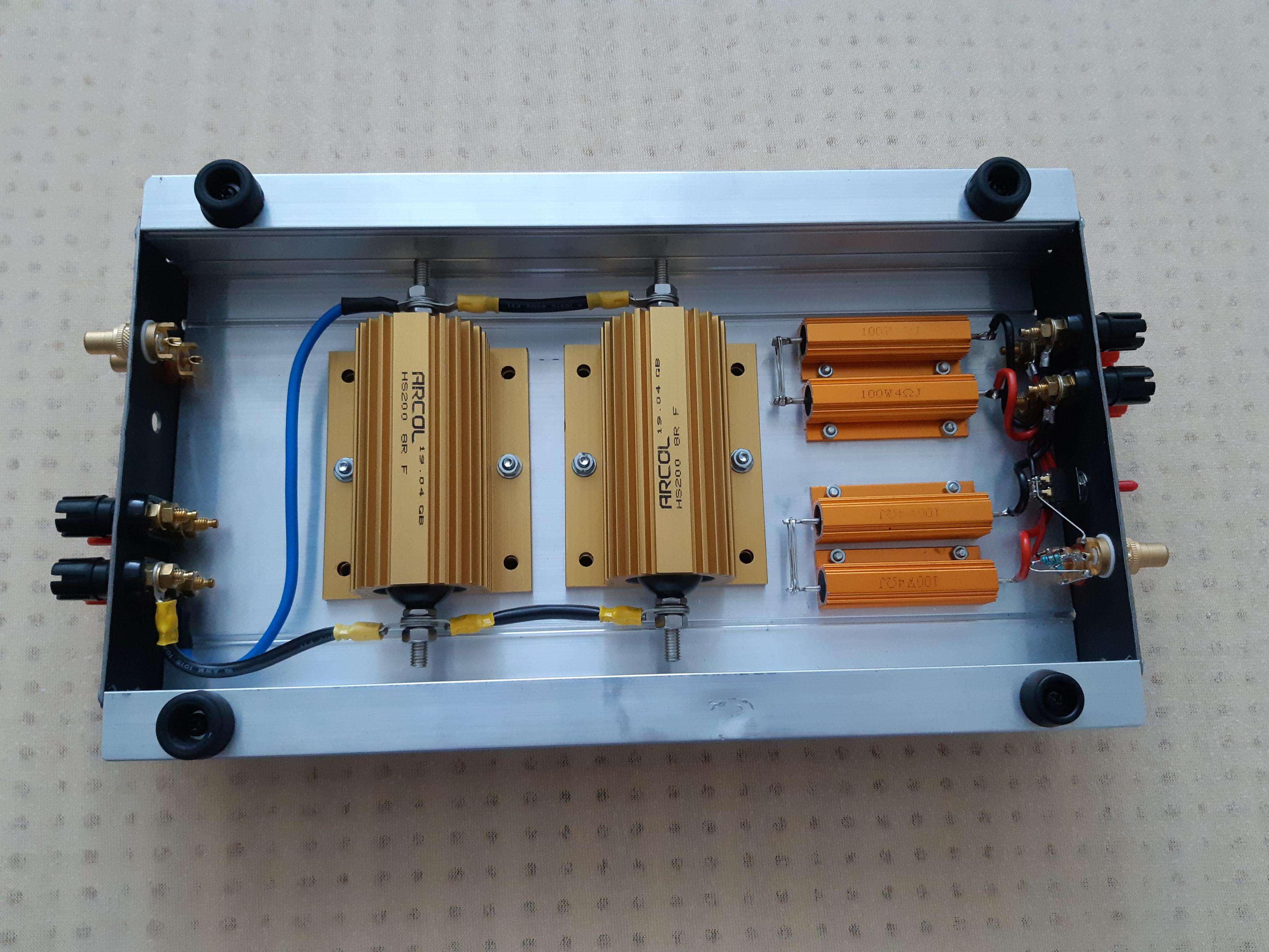

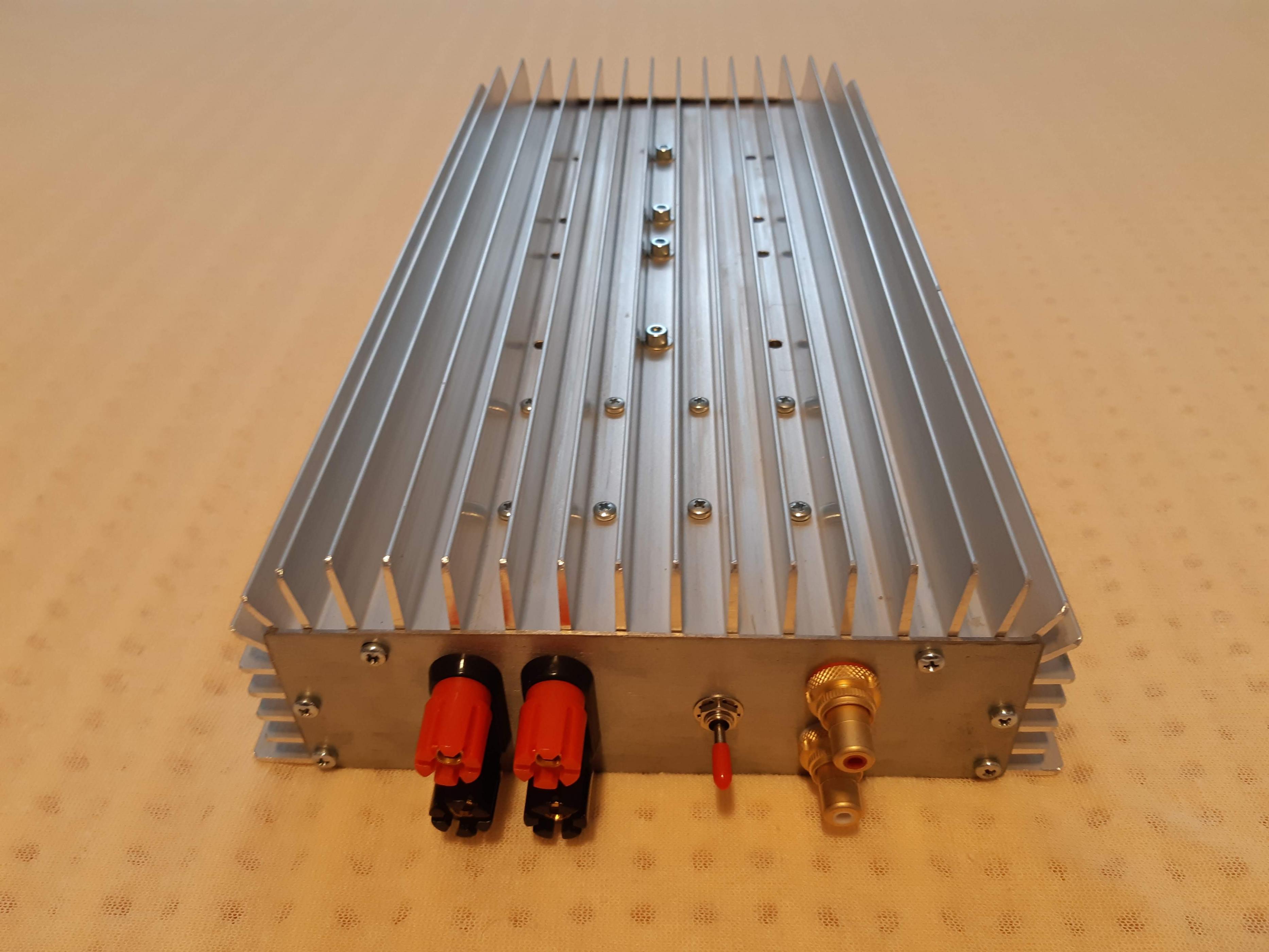

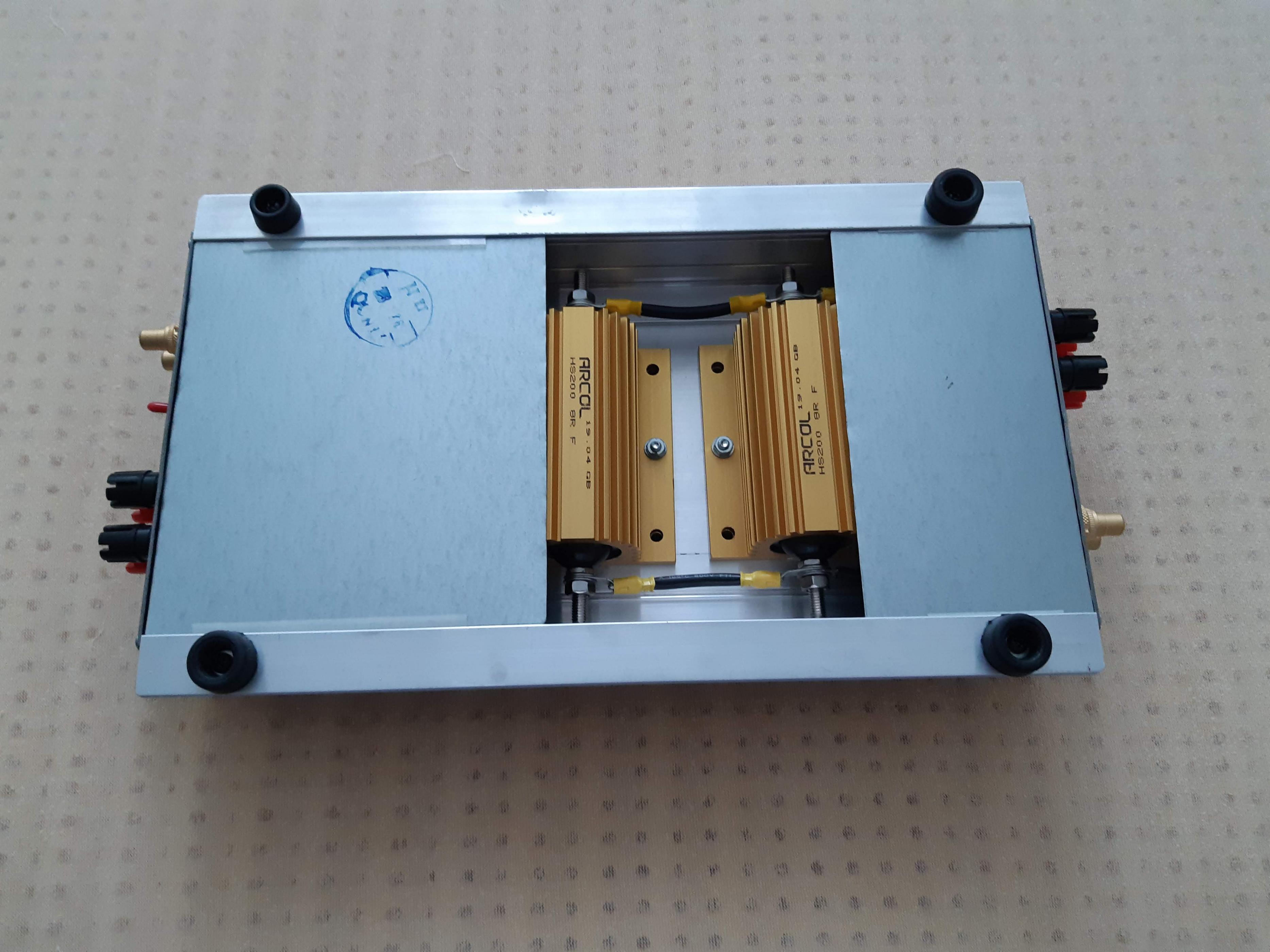

DUMMY LOAD
Not fully completed dummy load. Two independent sections. Big resistors are ARCOL 8R/200W, the others are from ebay, 4R/100W (do you see the difference ? ) I added two RCA monitor ports, one is raw output, the second one is attenuated by factor 30x (4x parallel 6k8/56R+protecting zeners).
very nice - looks very good - i also think about that + dividers - so thd and fft can be measured by the sound card - 1w, 5w, 10w, and 50 w

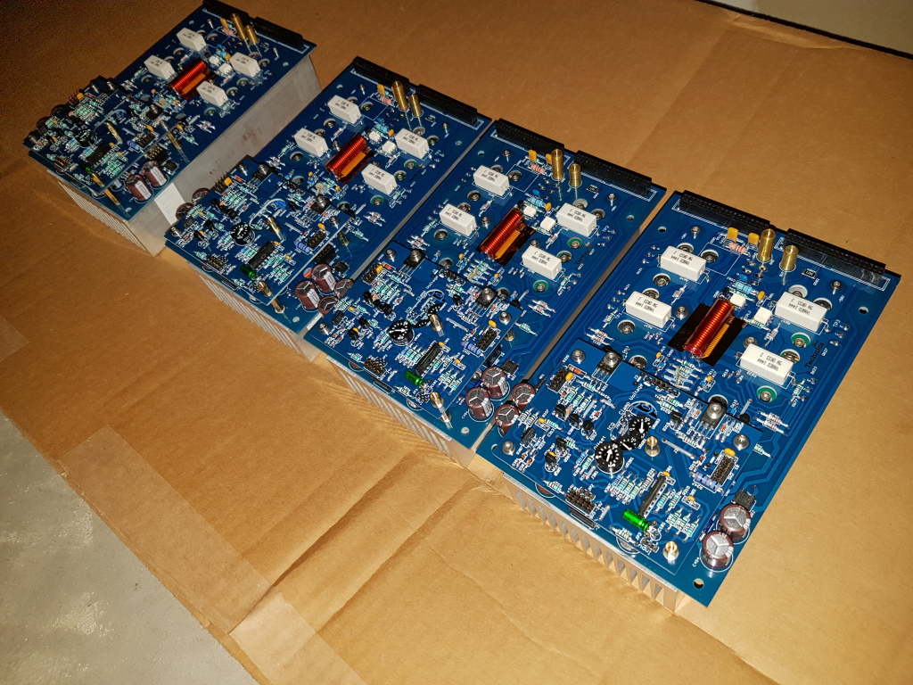

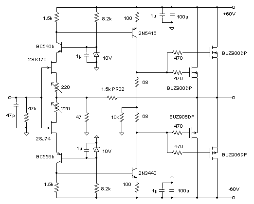

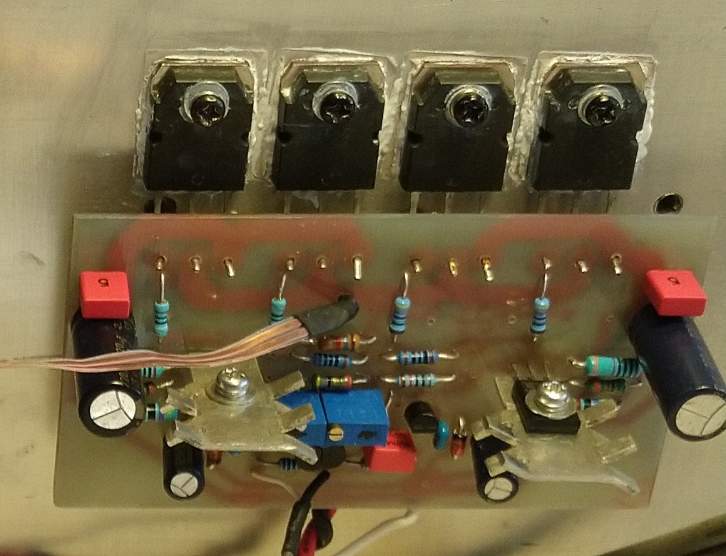

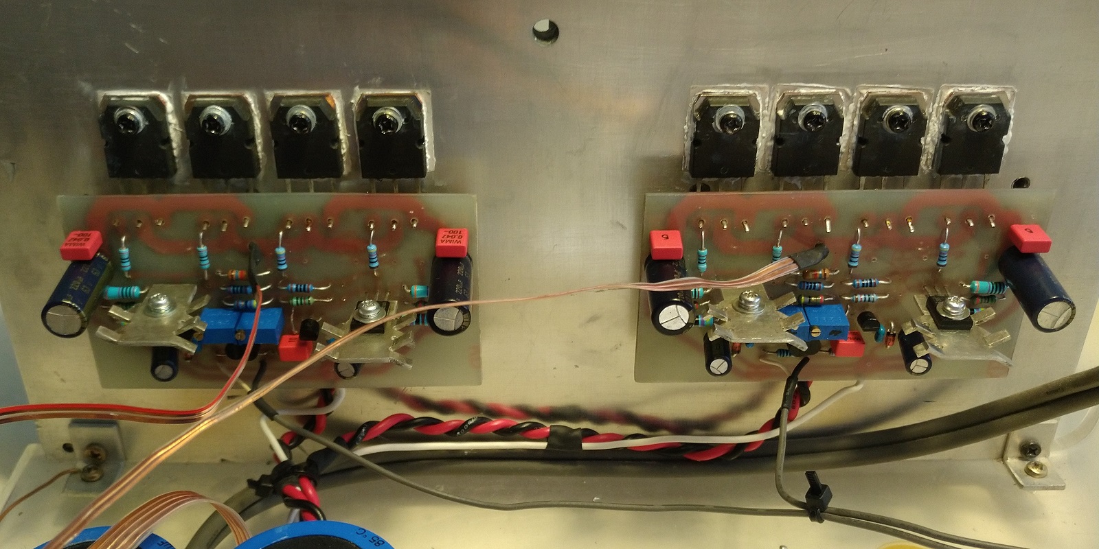

Seven years ago I did my first Mosquito amplifier for test, then I liked the sound and decided to try it again. The first time I had one pair of output laterals and a voltage of +/- 35V, now I made with two pairs and +/- 50V. I use 2SK1058 / J162 for output and 2SC2911 / A1209 for drivers.
The sound is good and I'll probably try how it sounds with other bipolar transistors or 2SK216 / J79 for drivers.
I have a modified JLH69 that sounds perfect . Mosquito has a completely different sound, not in the JLH69 class but a very good option for a good home amplifier.
For now, it promises.

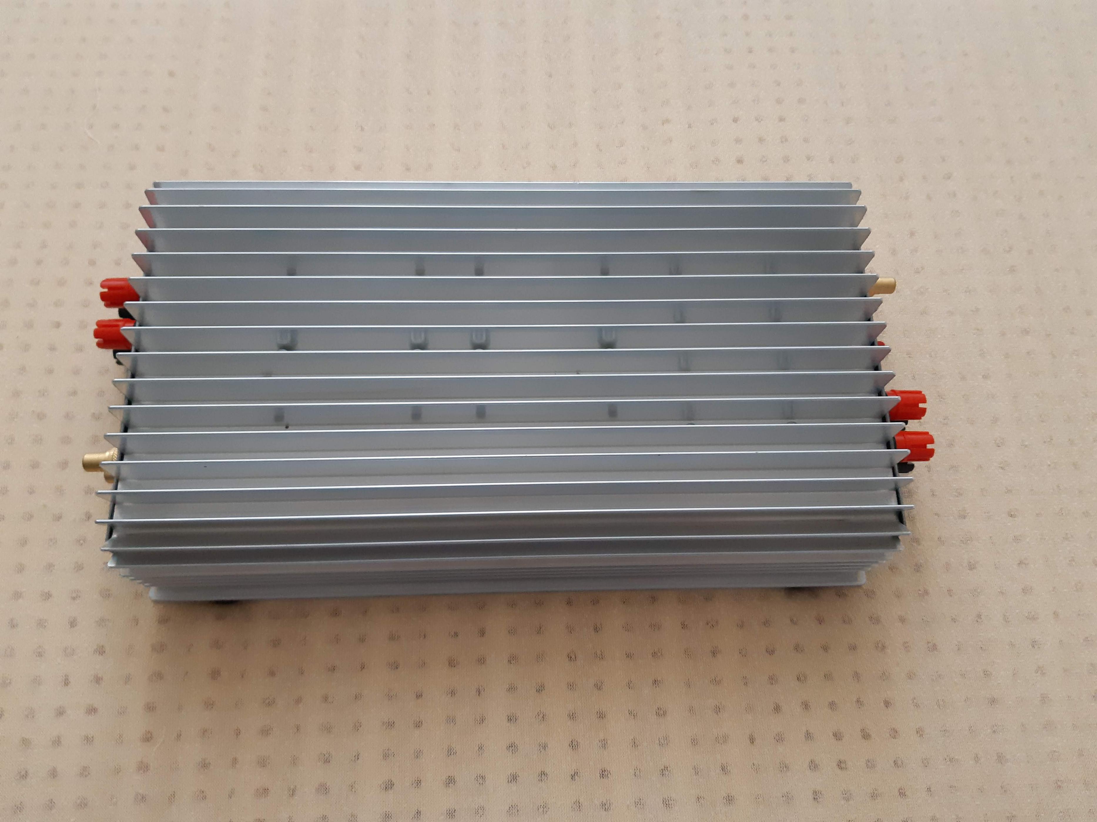

This is really really nice. How are you going to attach it to the chassis / heatsinks
2x 330W/4R for my home gym 🙂
I ran a mobile disco for years with a stripboard amp inside.
Thanks.
They are only laid on heatsink yet.
Amps work like this for two months in my gym 😀
Fasten them through the 4 + 4 holes on the prisms.

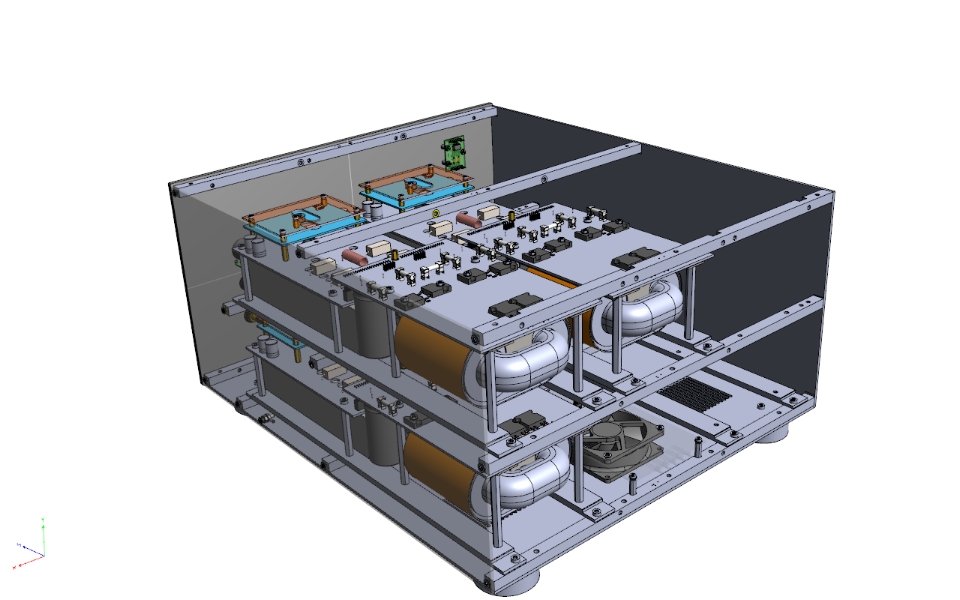

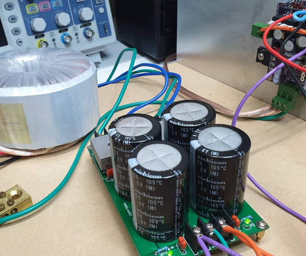

The beginning of my next huge class A mono blocks.
They will be Nelson pass class A mono blocks
drool
