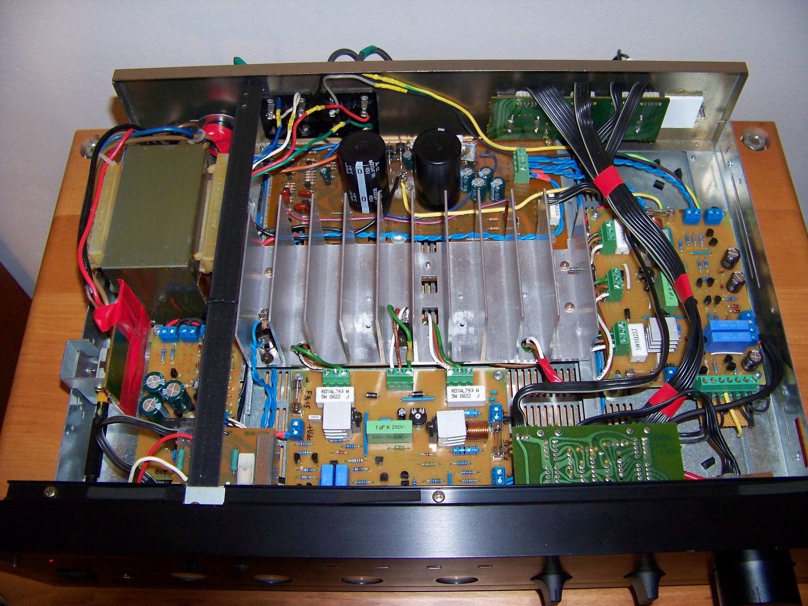

Saved the faulty Harman Kardon PM 645 from the bin

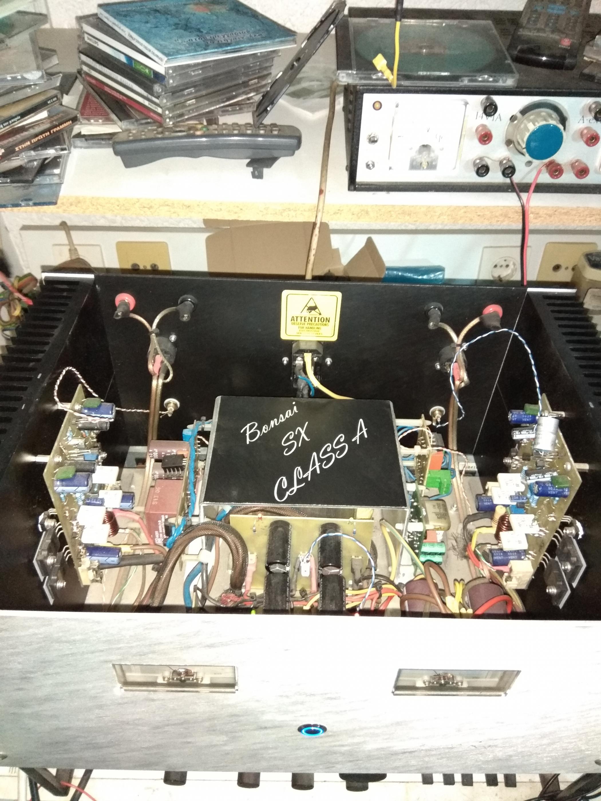

So I have been given a stereo amp that had a functioning transformer and power supply and I thought to myself why not fit it with G.Randy Slone's pro 60 amp modules. This time I fabricated proper pcb's using the toner transfer method and it worked suprisingly well after I figured out how to's. I have added a turn-on delay, dc protection and 75 deg C thermal switch for a peace of mind.
🙂..really nice work, hard to see it's DIY,
Thanks amplidude. The next time I'll be doing any such thing, I'll try to avoid using wires if possible. Everything on one or two large pcb's is the goal. Cheers to all!
Hi Lojzek,
Nothing wrong with wires. They are preferable to traces winding all over. Can we see the back of teh heat sink where your transistors are mounted?
-Chris
-Chris
Hi Chris,
unfortunately, now that it has been modified, it is not so simple to remove the panel as it once used to be. There is not much to see other than 4 output transistors, 2sc3281/2sa1302 and some wires. They are positioned in the same place as original ones.
Hi Chris,
I design everything to have "ease of servicing" in case repairs ever need to be made.
So far, things I've built since the 1980's are still in perfect shape, no servicing required.

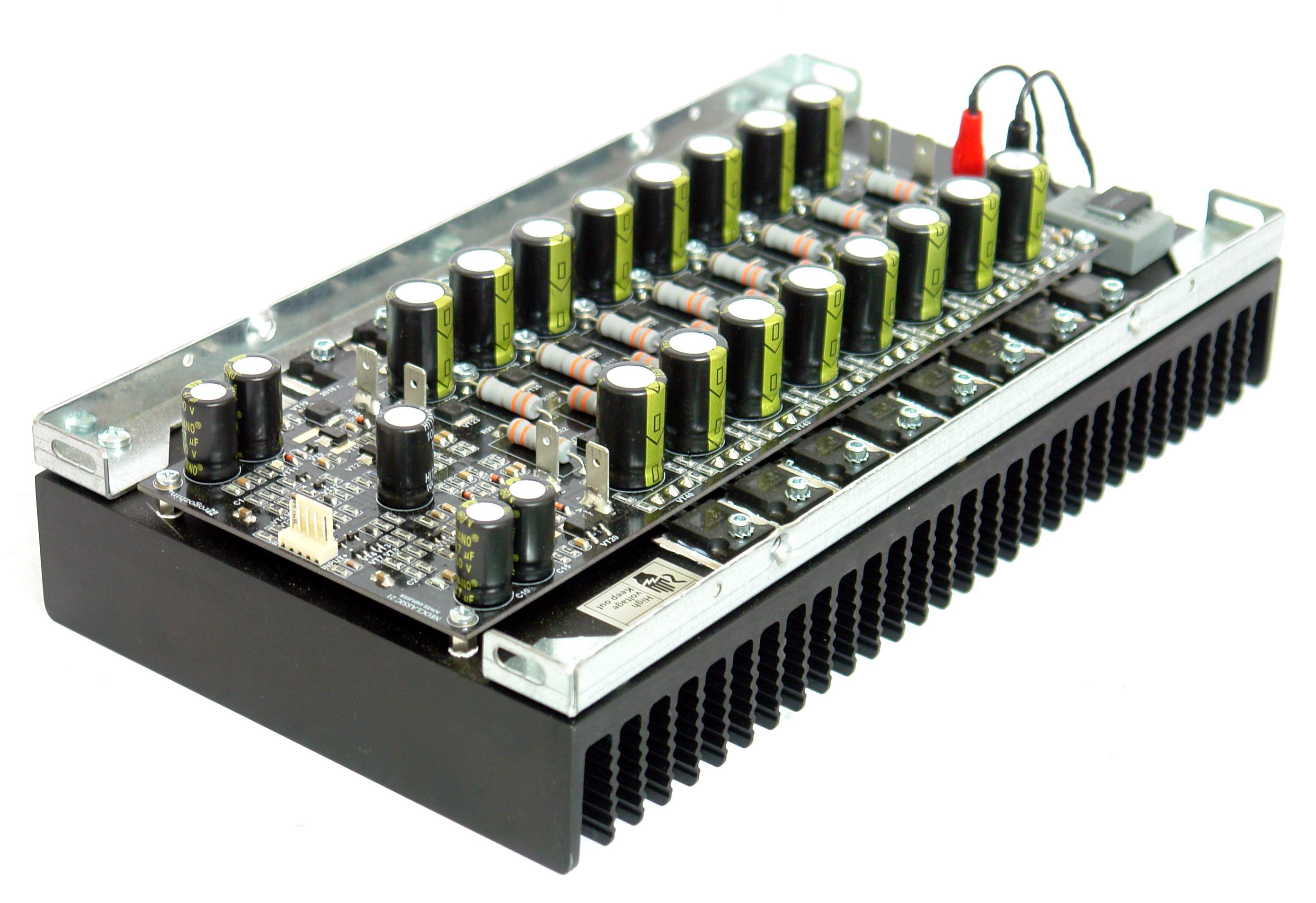

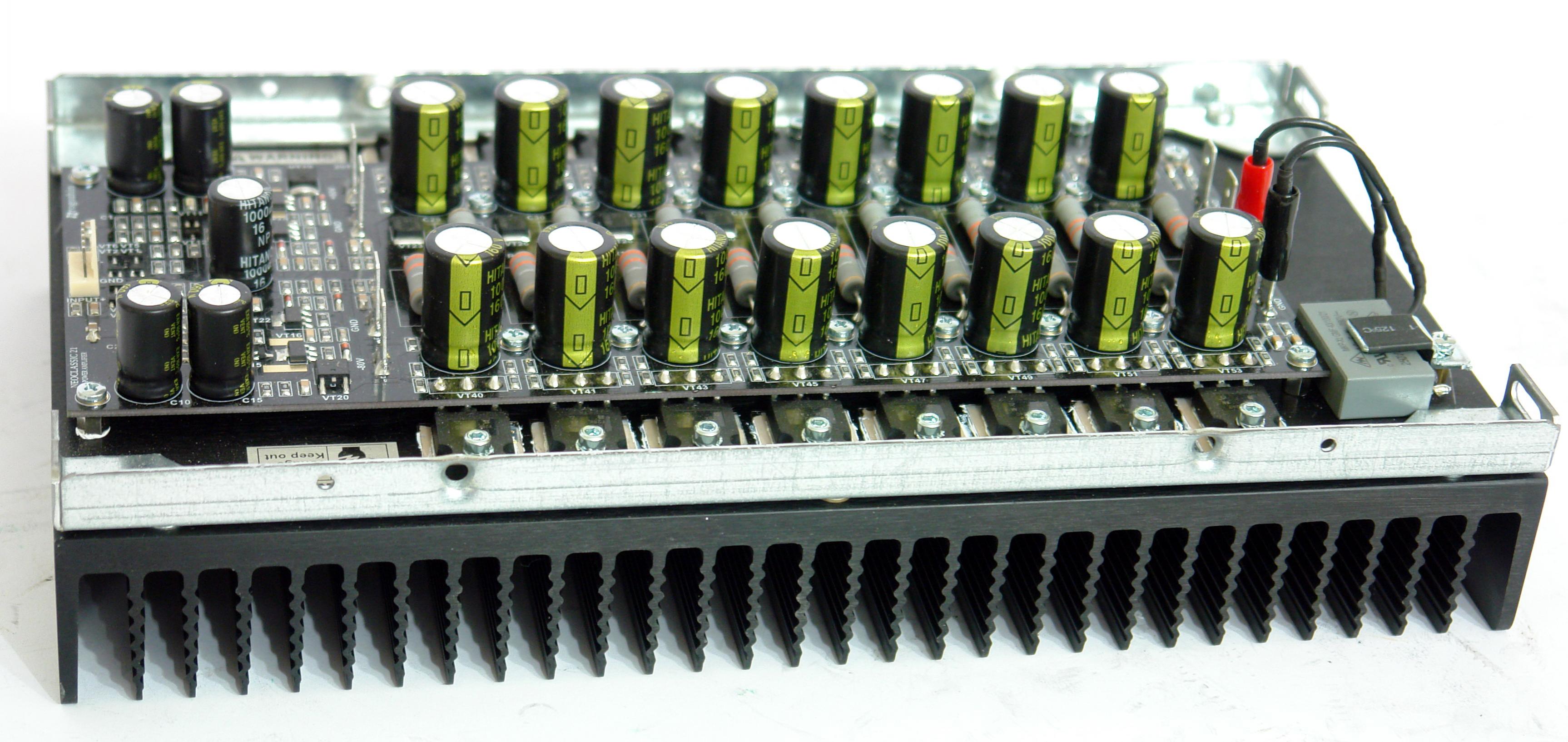

New modification A + A / B
RMS: 300 W 8 Ohm
600 W 4 Ohm
1200 W 2 Ohm
Gain coefficient: 30 dB
Dynamic range: >100 dB
Damping DC coefficient: 5000 @ 8 Ohm
Peak output current: 96 A
Nonlinear distortion coefficient: <0.01 % within the 20 Hz-20 kHz range
Frequency response: 10 Hz-200 kHz +0,-3 dB

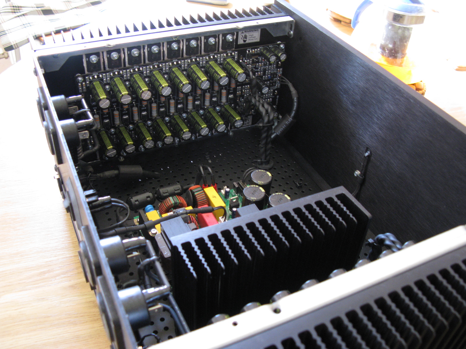

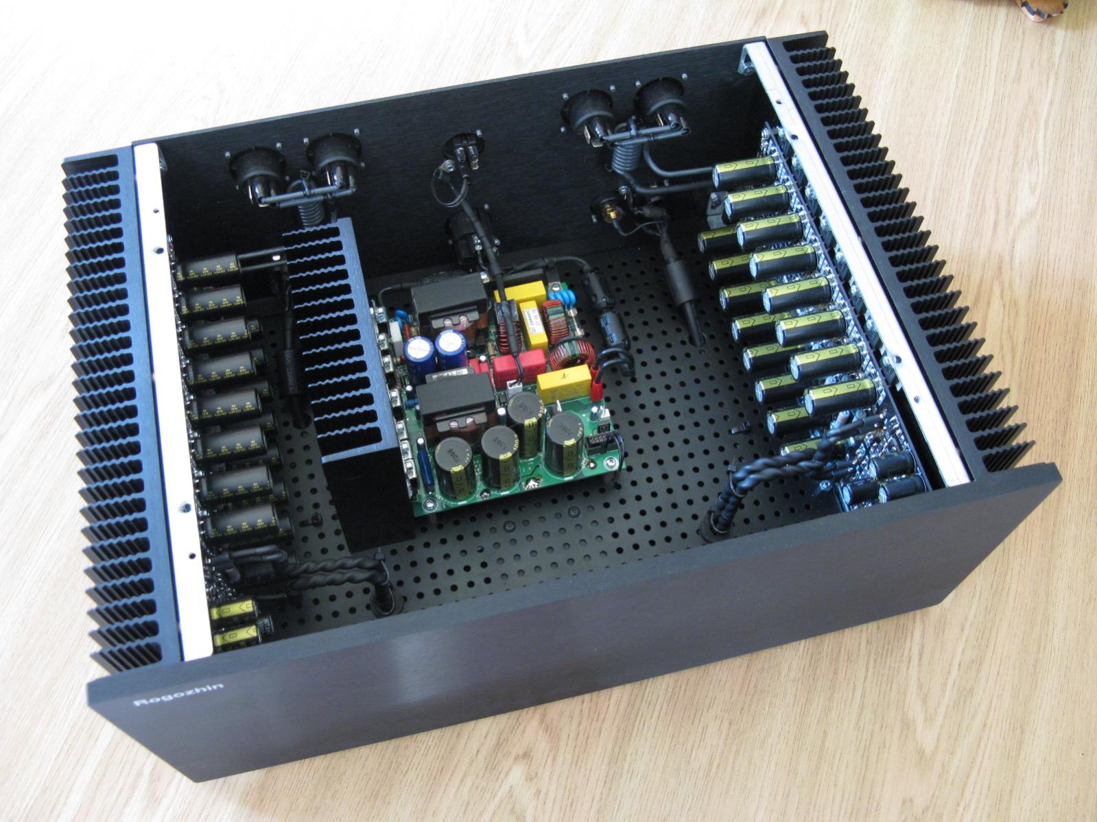

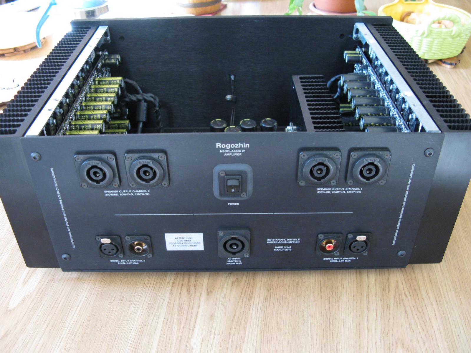

Pretty neat layout.
But where's the big power transformer?
The main filter capacitors?
I hope you don't tell me it's using some sissy SMPS.

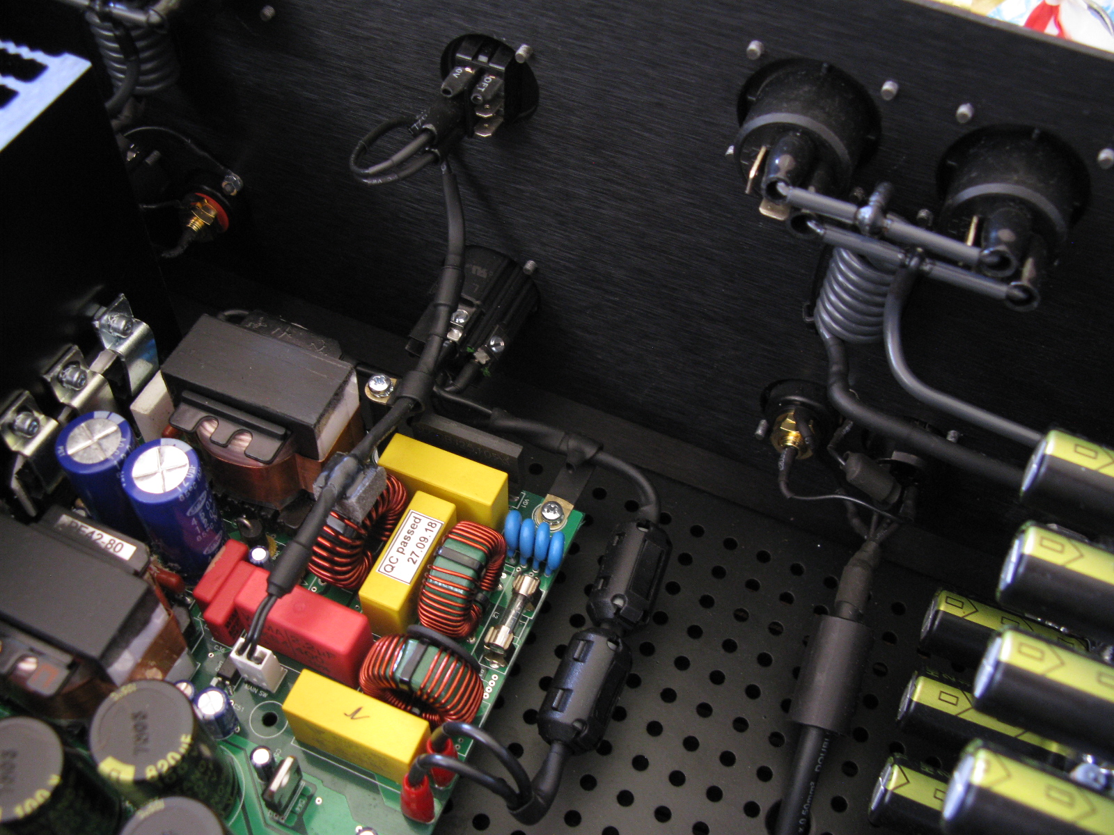

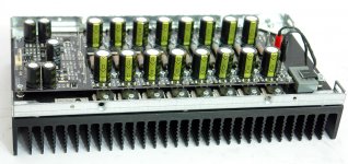

Large transformers and huge banks of capacitors remained in the last century. We use switching power supplies using PFC technology with a frequency of 400 kHz.
Therefore, large capacitance capacitors are not needed, and the amplifier is not afraid of interference, because it is made according to RF interference-proof technologies using a 4-layer printed circuit board, with power supply polygons and a separate shielding layer.
