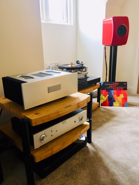

I like,the music of Shostakovich,the amplifier,the turntable,the speakers and...the wine of course.😉Friday is wine time and Shostakovich on the Michel with the class A kx-Amp doing duty
Nice,very nice Andrew!
Andrew, good style in many aspects
