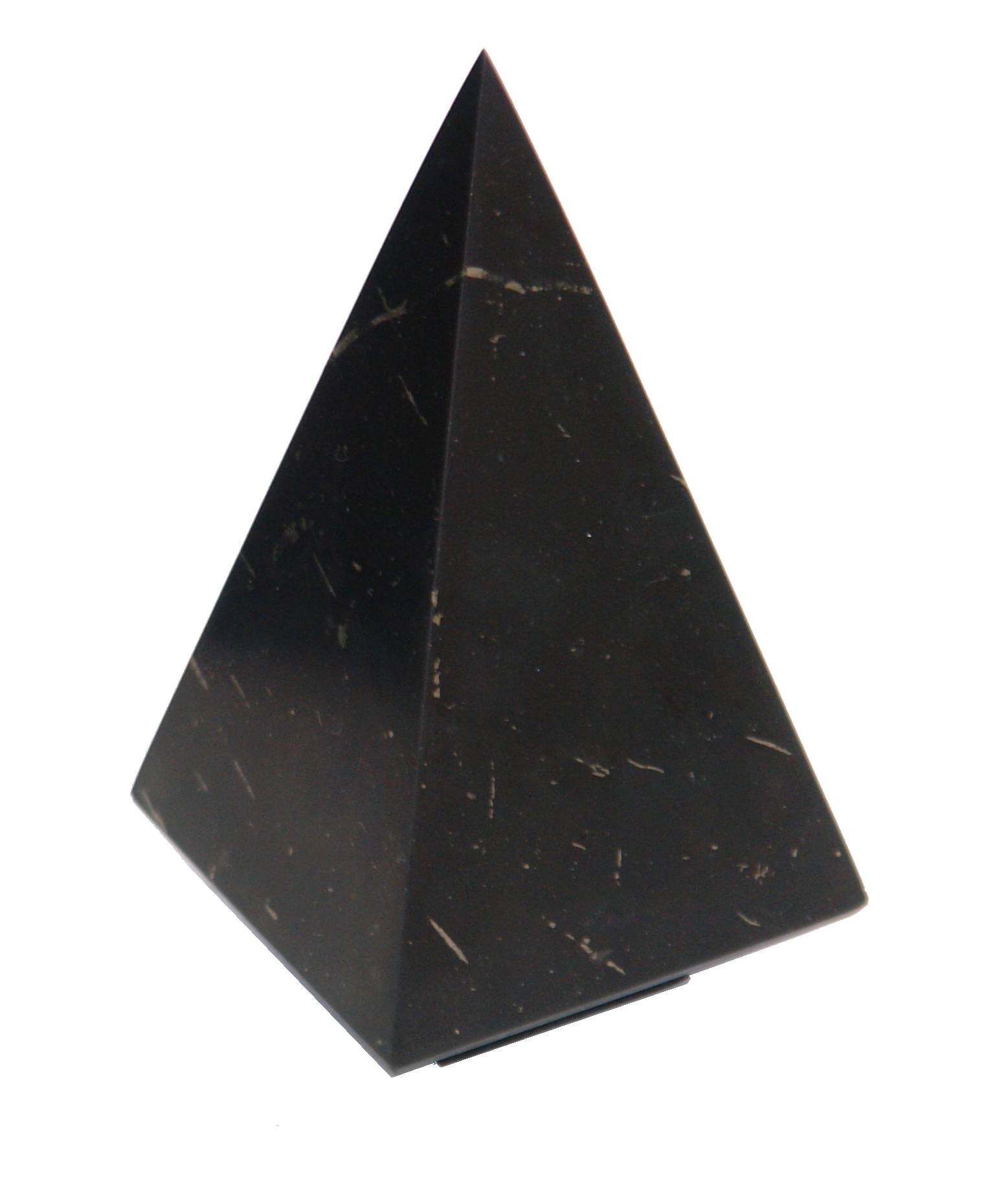

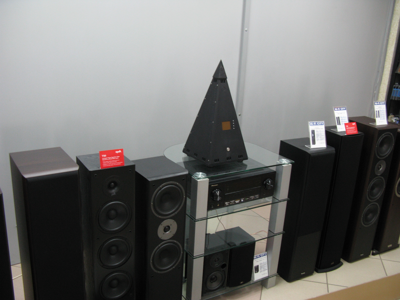

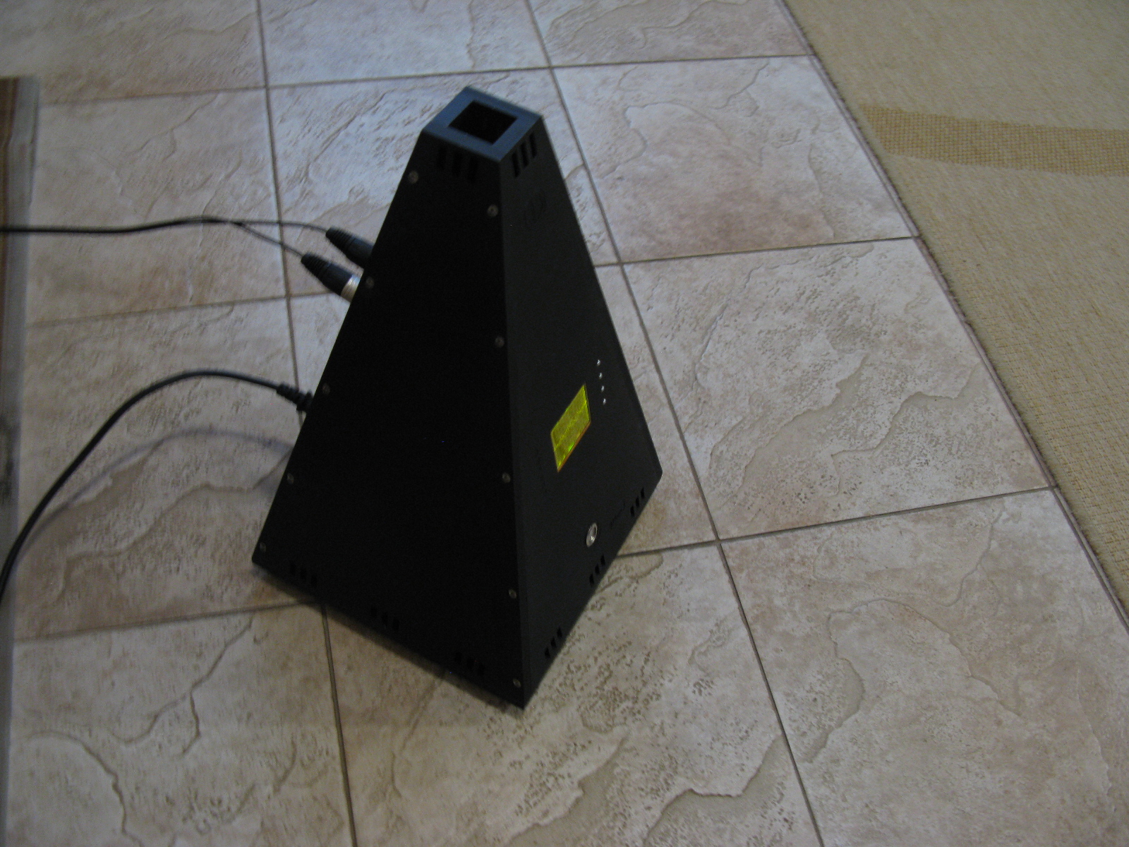

Amplifier for the proportions of the "golden ratio".
Naked Danish can remove "piramidon".
Piramidon made from mineral shungite:
Shungite - Wikipedia

Wow ! power wise , operator 16's amp would "wipe the floor" with the last 10 pages
of solid state projects combined.
Almost a DIYA Lab gruppen .
I see the PFC mosfet + the 2 flyback ones. That SMPS would not be affecting
the mains ,even at 1kw+. And just a few Kuf output will result in smoother rails
than a 100Kuf linear.
Damn , all this coming out of a little pyramid !!
OS
Amplifier is a very small pyramid. It is a revolutionary building and high-tech scheme. Plus power supply with pfc.
Amplifier in the pyramid class A + AB (this is not d class), which includes several dozens of new technologies - 4-layer PCB, smd, rf topology, complete symmetry, thermal stabilization of modes and much more.
The amplifier can work on 1 ohm speakers.
Amplifier power 2x300w / 8 ohm, 2x600w / 4 ohm - RMS.
Pyramid cooling is passively active. When the case is heated to 45 degrees Celsius, a fan is turned on in the pyramid's vertex. At high power, the body can heat up to 55 degrees Celsius and this is normal. (sorry english is not native).
In the photo, the pyramid is tested with different acoustic speakers. there is a risk of damage to weak speakers, you need to be careful with the signal level.
The shape of the pyramid in the shape of a "golden section" works very well for cooling. An air flow occurs inside the enclosure that cools the printed circuit boards through the ventilation openings. Well give heat to the inclined outer edges of the pyramid. Body shape chosen specifically for good cooling with a small size.

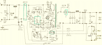

They all try to save a buck. (or 2).
3 levels -
1-8$ ebay switcher , (below 1). Better keep it in a faraday cage , it will kill
bluetooth and wifi otherwise. Scope the mains , you will see how "dirty"
it is under load. LED bulbs and other cheap Chinese plugins are even worse ,
AM radio's will not work too good in a modern "smart" home.
BTW - the 8$ switcher trafo can be rewound to make a 5A 35-0-35V supply
for another 5$ (i did that).😀

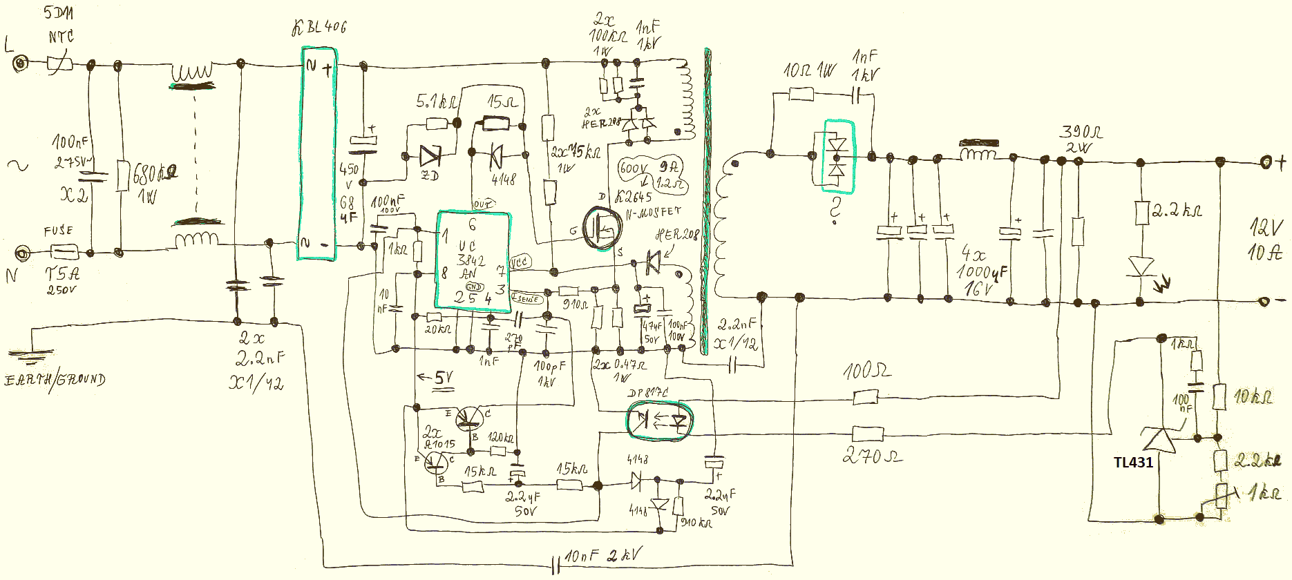

3 levels -

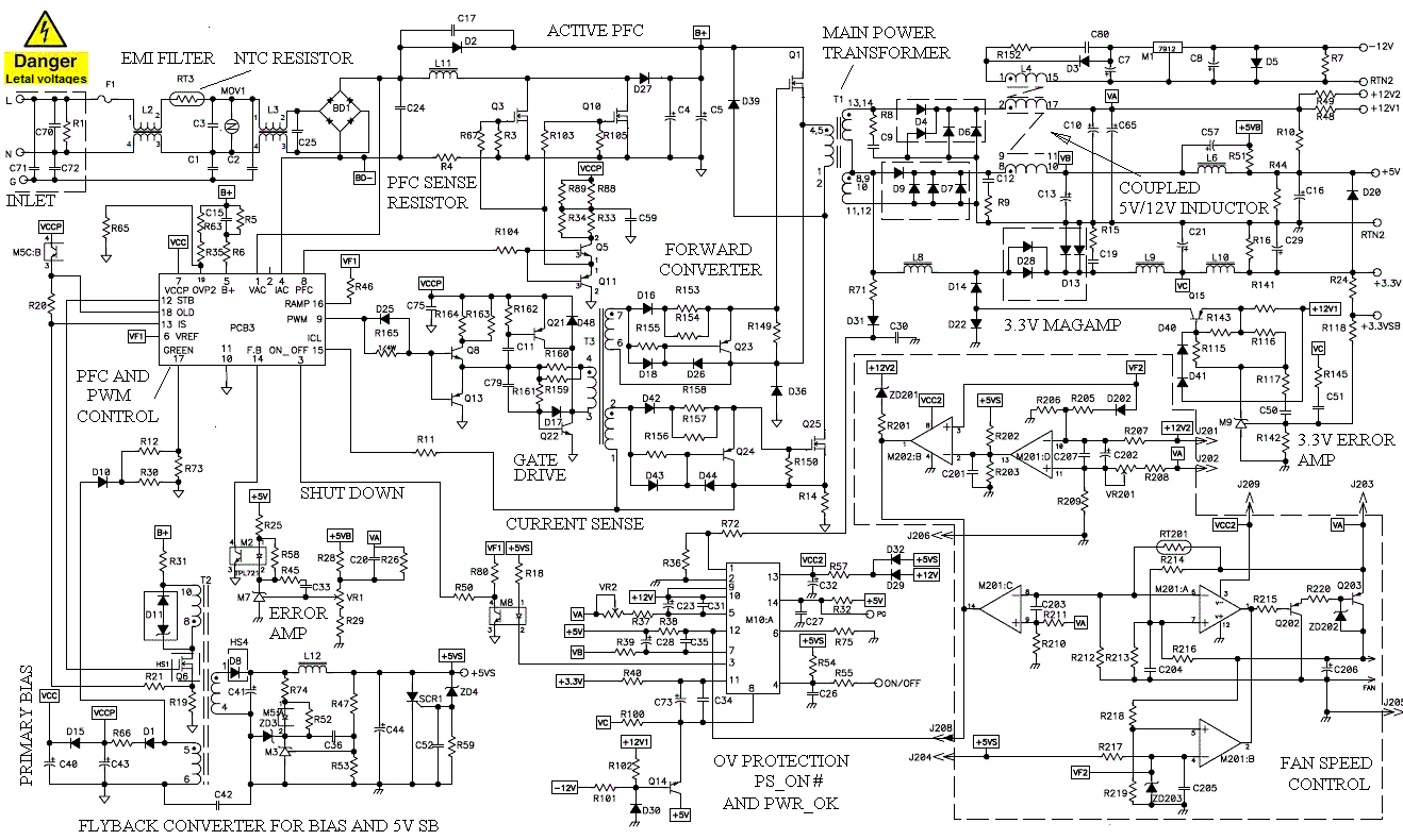

2-PC supply - Corsair (below 2)
PFC + regulation + more safety features. Not all are like this , NO-name OEM
(or EVGA) .... garbage !!! NOPE !
Some will even burn out the PWM on your expensive motherboard or kill a whole house wifi with RF garbage,
3-TOP level = PFC , variable freq , low rdson fet's , regulation , sine wave
flyback operation .
Preferable for audio , these have a more advanced (forward converter/current
sense - second attachment) ,running better mosfets. You won't see the load
on the mains .... they truly replace (and out-perform) , the analog.
IF - you get ANAL on the discrete sourcing , it is possible to achieve safety
and longevity that would put any bulky analog to ABSOLUTE shame.
PS - a good quality used 500w PC supply can be turned into an audio supply for about
10$ in an hour.

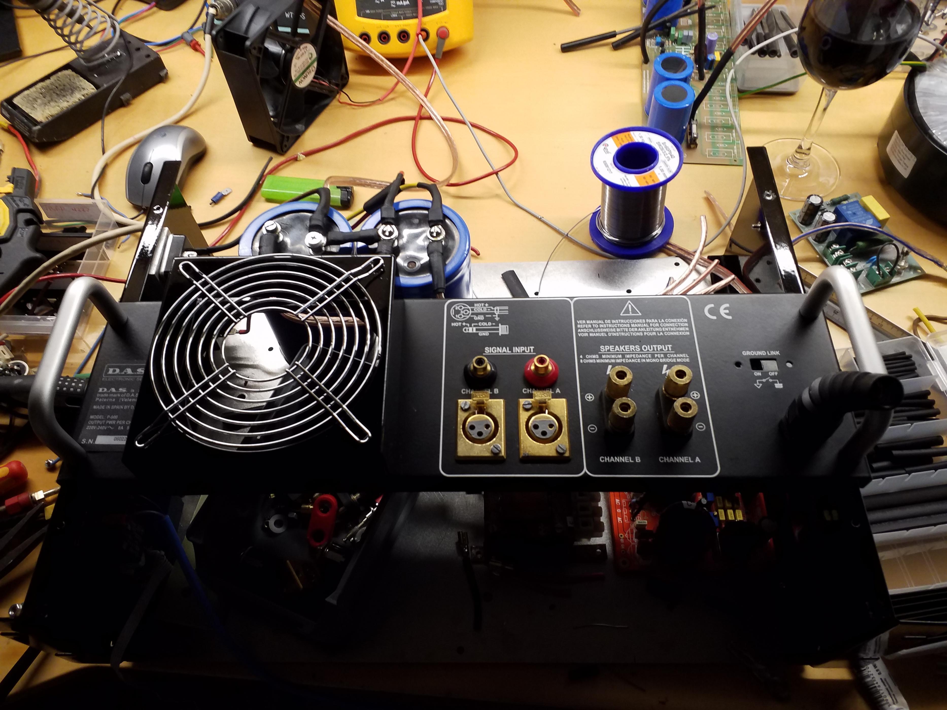

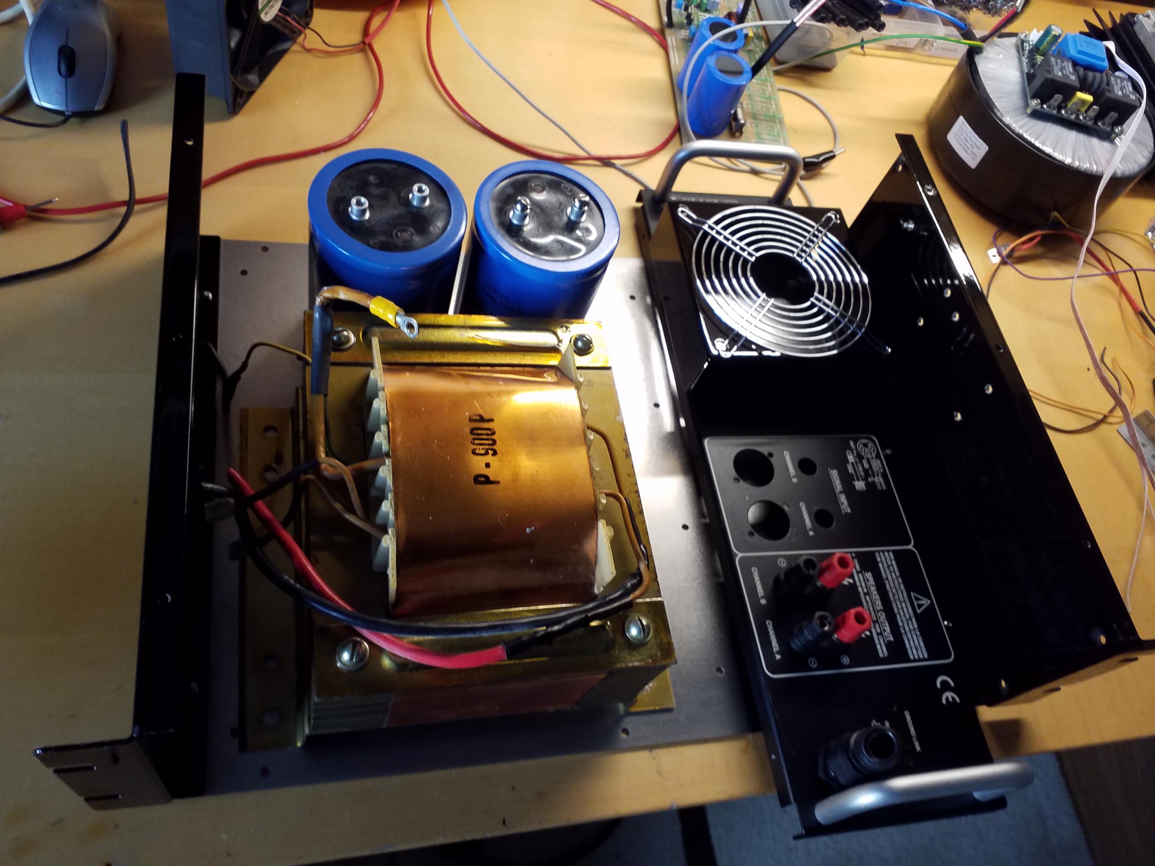

Here's an old D.A.S pa amplifier being retrofitted with irs2092 with 4 irfp4227 output, running +/- 75 volts. Chassis has been to friend who is car painter, handles are from kitchen dealer😛
