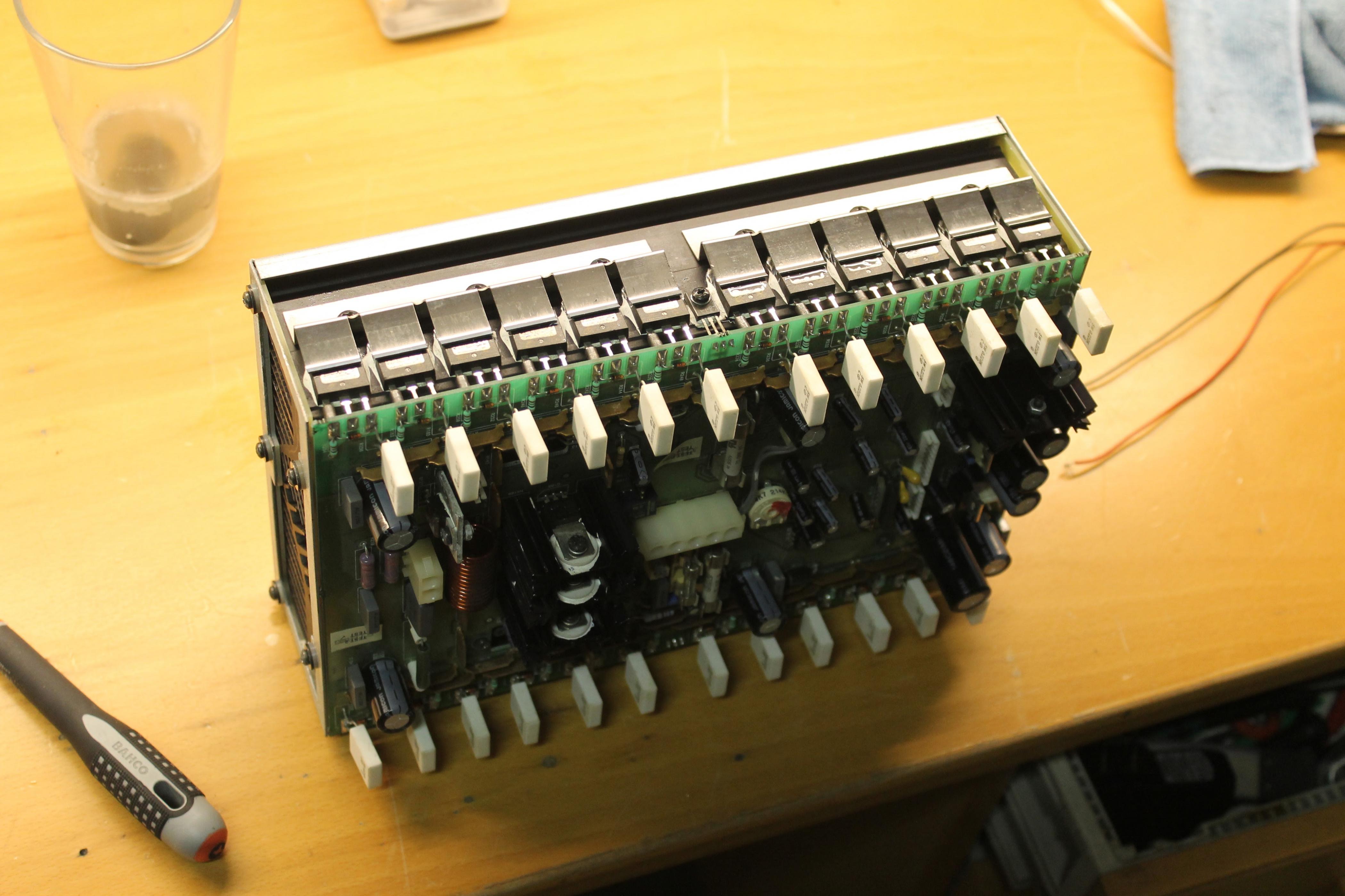

24 irfp240/irfp9240
24 irfp240/irfp9240 mono module +/÷ 150volt.
Not my creation but I'm a bit scared

Hi amplitude,
I like those extra legs!
So tell me, was someone just trying to see how many Mosfets would fit the extrusion? They used the correct type of source resistors. What is the value on those?
With 150 VDC supply rails, you might blow them up unless they are stacked like a Marantz 510 output stage. Those transistors are only good for 200 Vds. Your total supply is 300 VDC. Better check to see if all those power transistors are in parallel, or are there two groups of 3 in parallel per polarity? That should give you a 400 VDC breakdown.
-Chris
