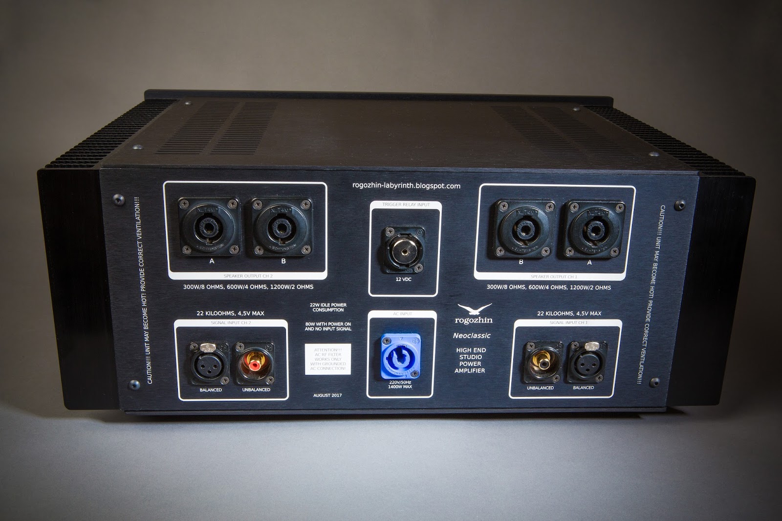

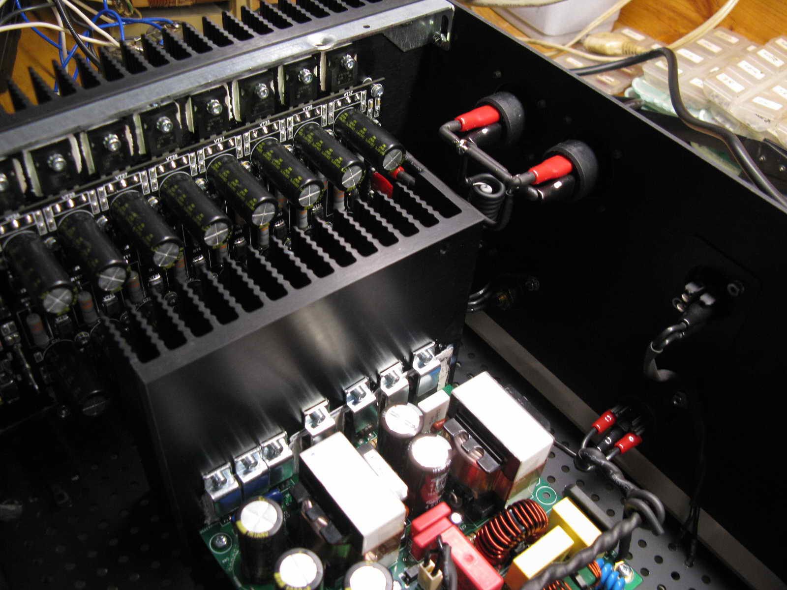

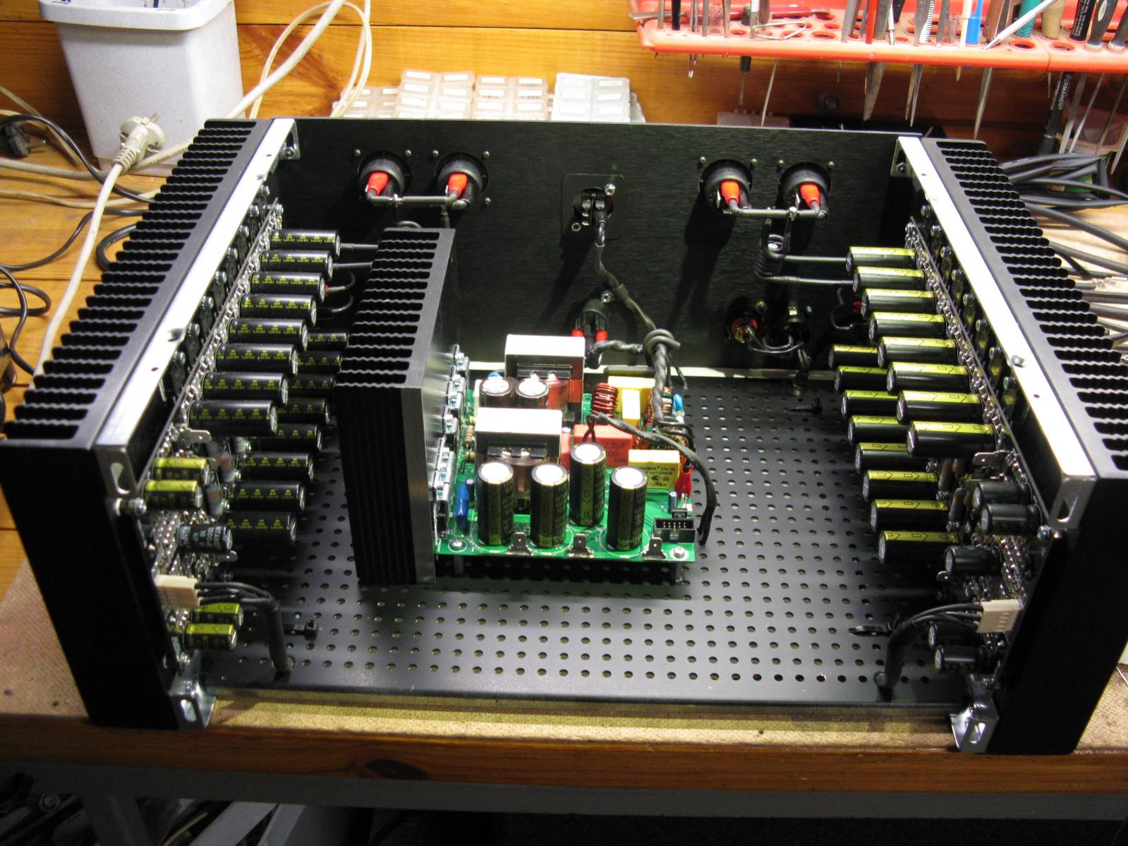

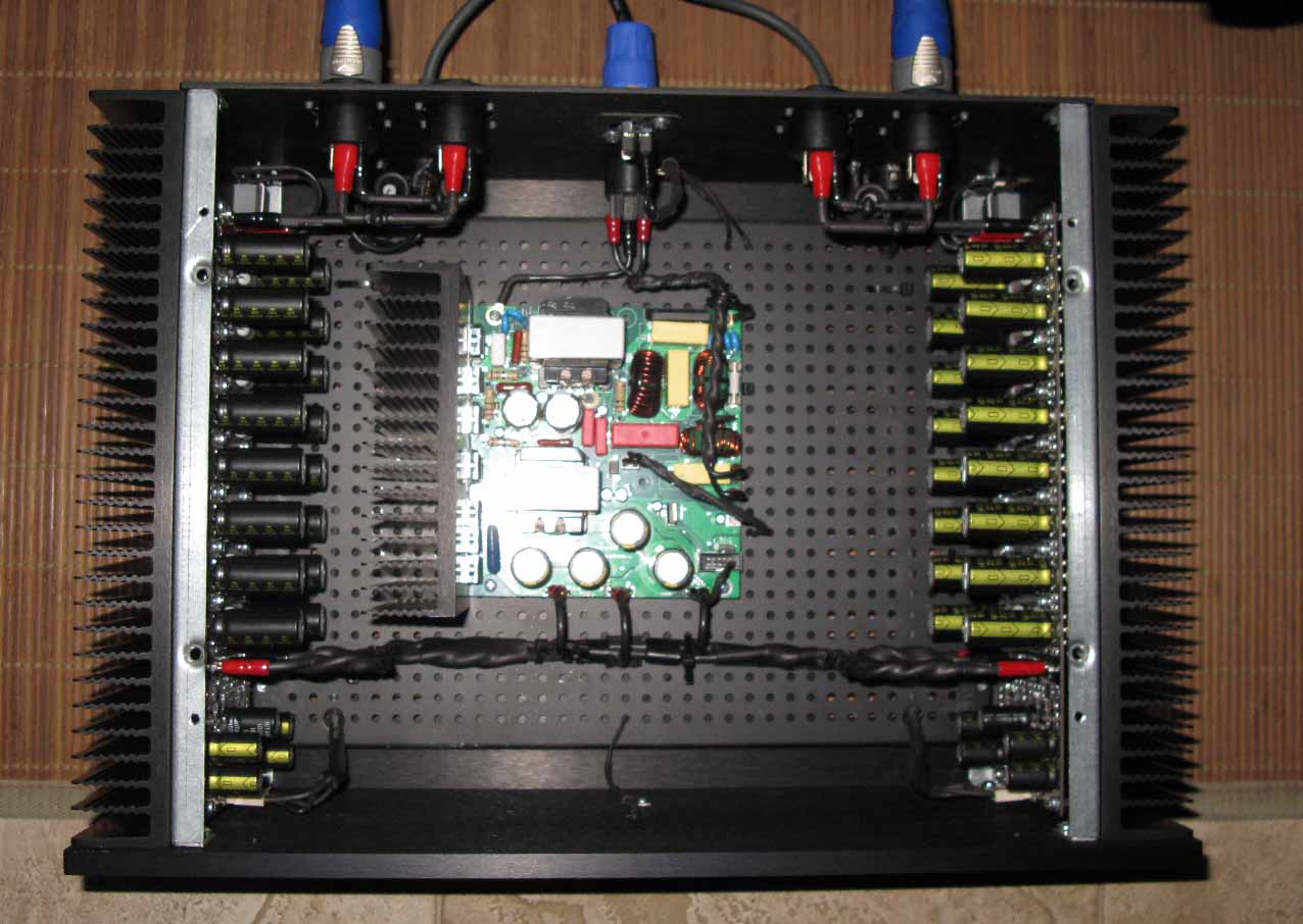

Is a switching psu suitable for such high current peaks? Nevertheless awesome! Tell us more about the prof. speaker connectors!
Amplifier power: 8 ohms / 300 watts, 4 ohms / 600 watts, 2 ohms / 1200 watts/
Current rating 40 Amp continuous, 50 Amp audio with 50% duty cycle:
NLT4MP-BAG - Neutrik
I'm a huge fan of the Speakon and Powercon connectors! 🙂
I'm with diyralf on his question.

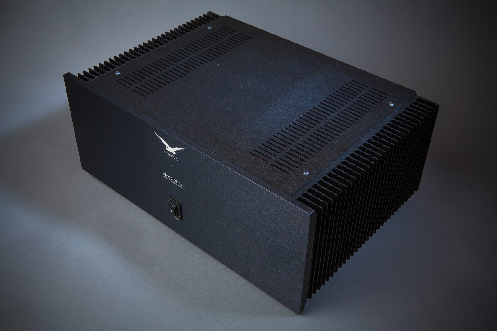

Rogozhin Neoclassic High End Power Amplifier

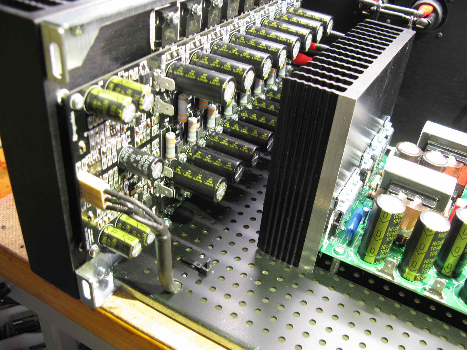

Is that ferrite beads on the DC power lines?
At first, I lol'd, however, it's actually not a bad idea on switching supply DC lines.
Uh, no. That is amazing attention to details. To take every precaution to reduce noise.
Exactly - it's extreme attention to detail.
