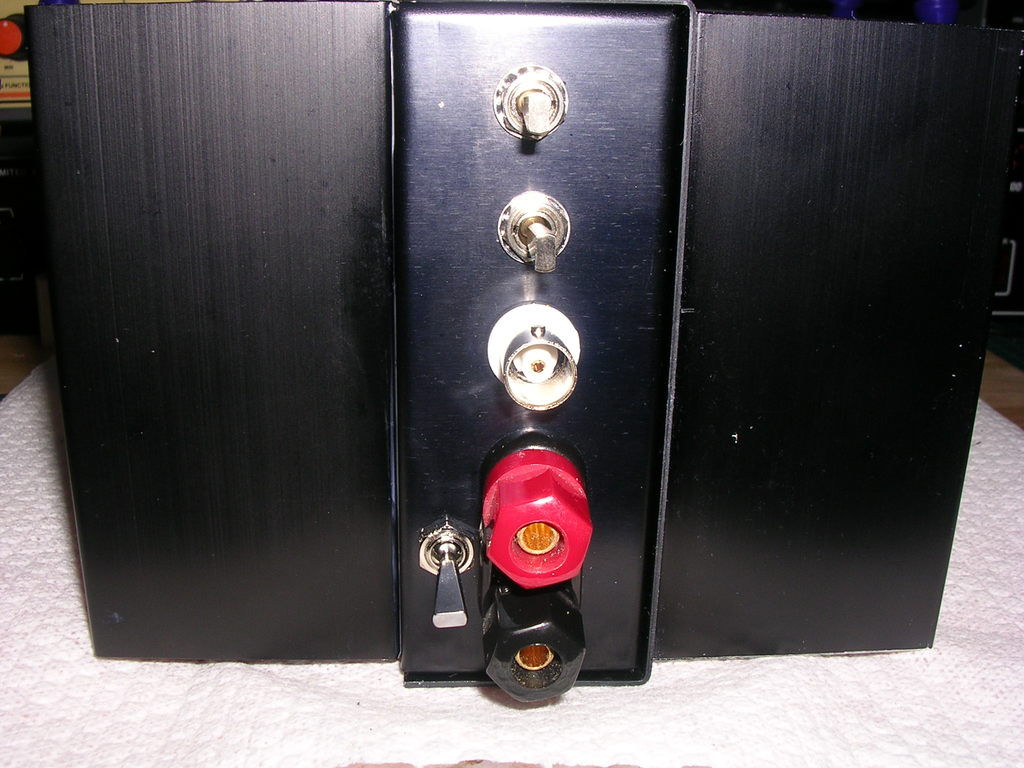

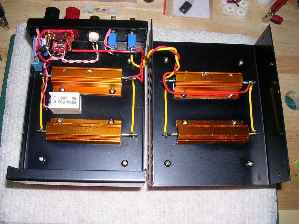

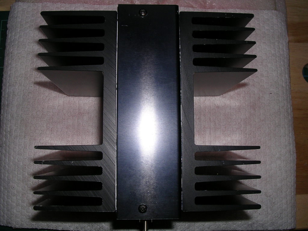

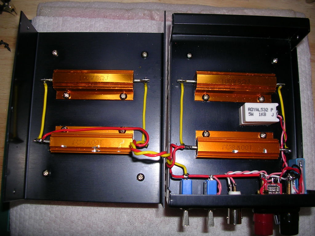

Dummy Load
Got fed up with my scruffy old, ad hoc, dummy load so I decided to build a more durable one. Does 4ohms ( 200W ) or 8ohms ( 400W ), with either 0.1uf, 1uf, or no capacitor in parallel. Monitor output is selectable from directly across the load or via a 10:1 attenuator.

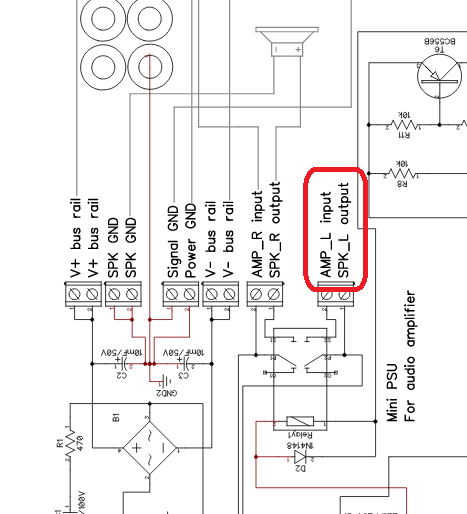

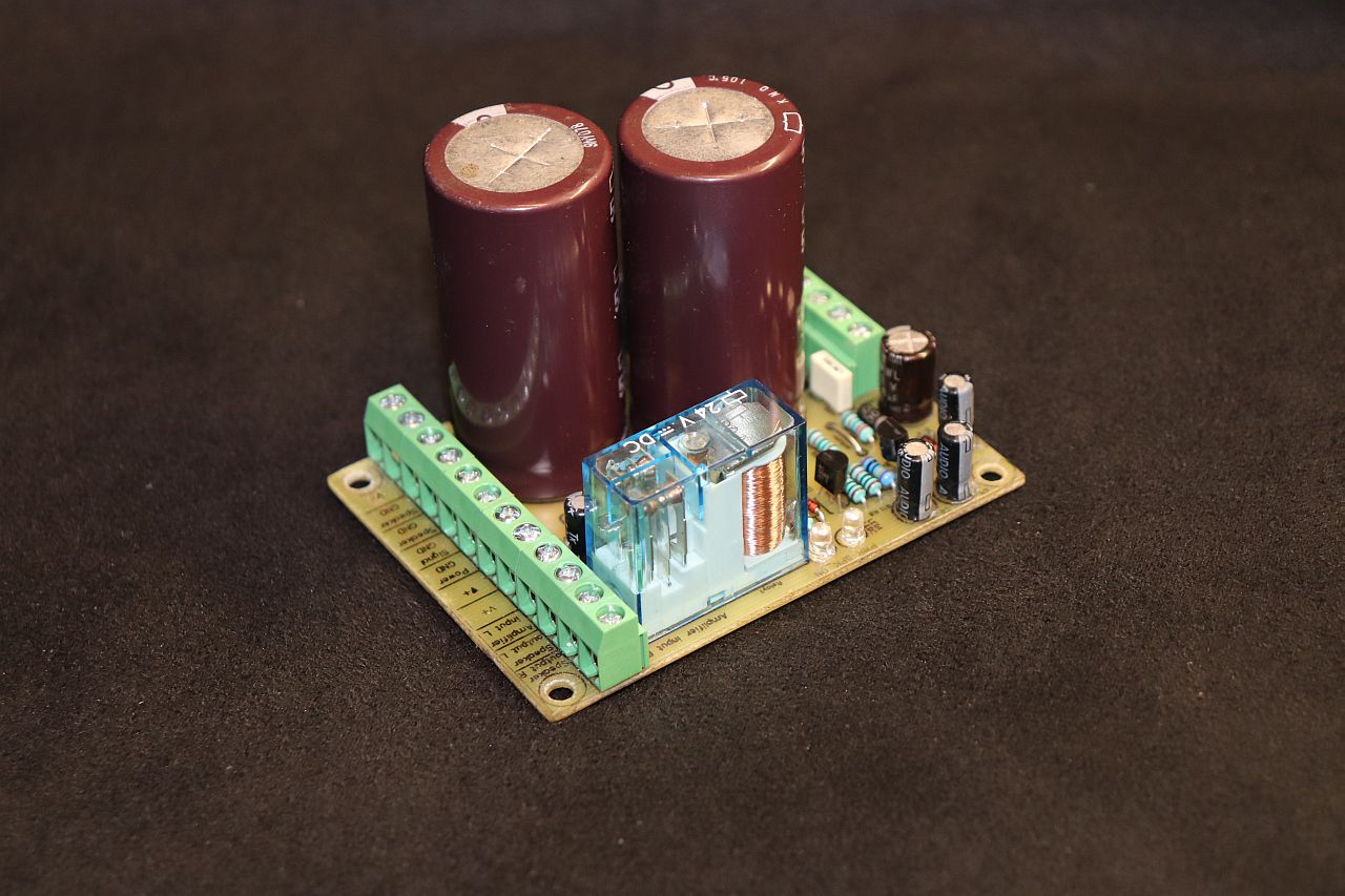

New year, so time for the new projects, some are smaller and some are bigger.
Mini PSU for audio amplifier, DC protect, delayed ON and fast OFF build in.
  • AMP PSU - Documentation.zip
  • Mini PSU 35mm - Documentation.zip
