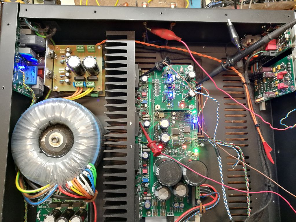

Had a bit of the time to populate BOLT x30 PCB which was hanging around for a past two months 😀
Must say that LazyCat have made some good job with AC coupled CFA, so simple but very good + have some LEDs on the board.
I just added fancier VAS stage on the back of the two MPSa transistors at the front of it.

Hi borys
Yes simple and effective. Although it cannot correct itself deeper but its fast and doesn't congest at complex, saturated musical material, it preserves natural like dynamics and presentation. CFA it is. Nice setup to accept different front-ends, have many more in my library.. maybe you should try this.

For sure Ill try later on. For now I am stuck with some small bootstrap amplifier.

I was thinking about building inverting amplifier (just apply signal from the back of it - through NFB network + ground non inverting input), who knows it may sound good too.
Sansui was using dual inverting amplification in all Diamond Differential amplifiers series.
The only drawback is that the signal source must have quite low output impedance, input must source and sink some current from inverting NFB network.

Even better if preamp has to provide some mA of output current, less interconnect cable's impedance influence, even less an issue if both are in the same chassis. This JFET input front-end should perform even better than the Bolt, from DC up. BTW did you listened to the Bolt yet?
Next week I am going to do some listening tests, just have to explain my wife why she have to go shopping at the evening time 😀

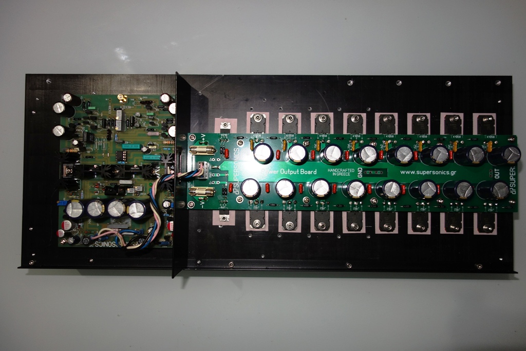

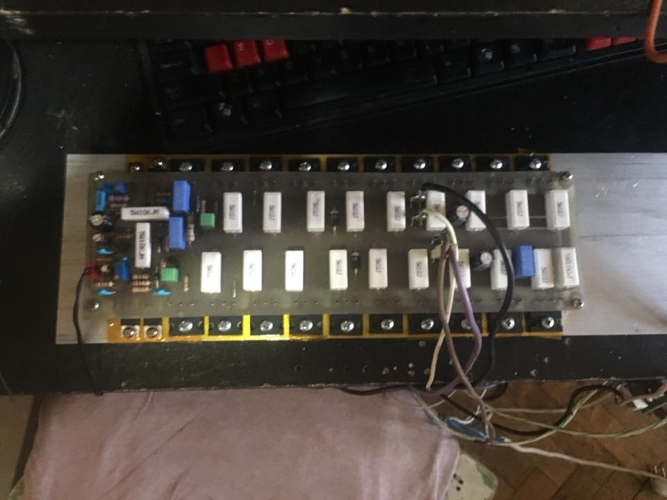

Protection power mosfets on board.😉
I like this as eliminate cables and all the confusion.😀
Μπραβο!left chanel ready...
200W@8Ω-350W@4Ω

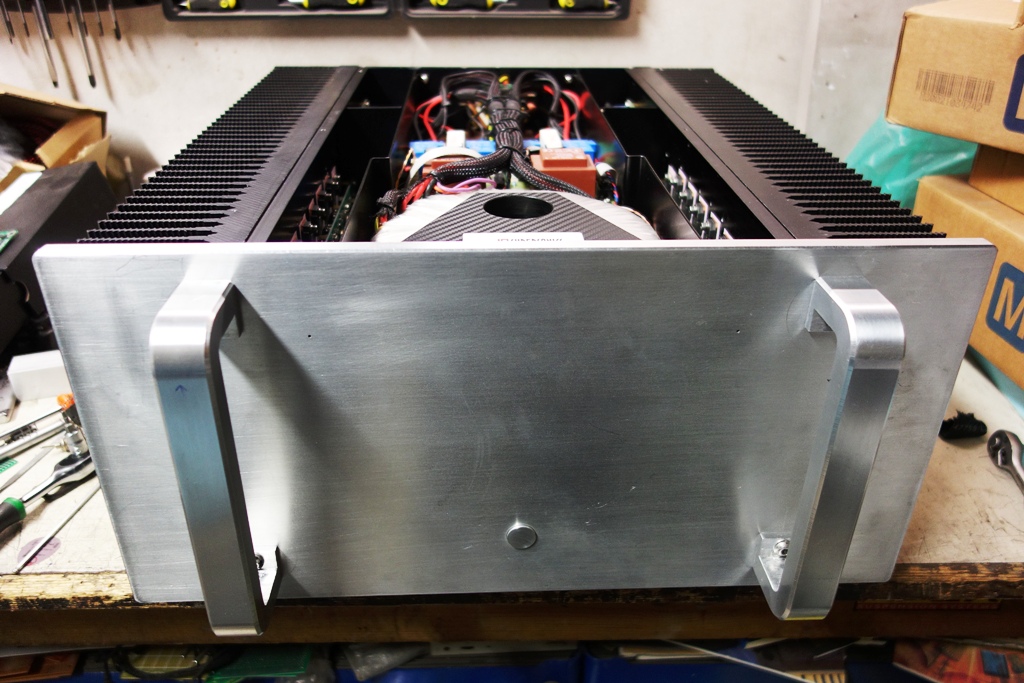

Is that a carbon fibre toroid securing plate?...in progress...
Does it create a shorted turn?
Good point dude
