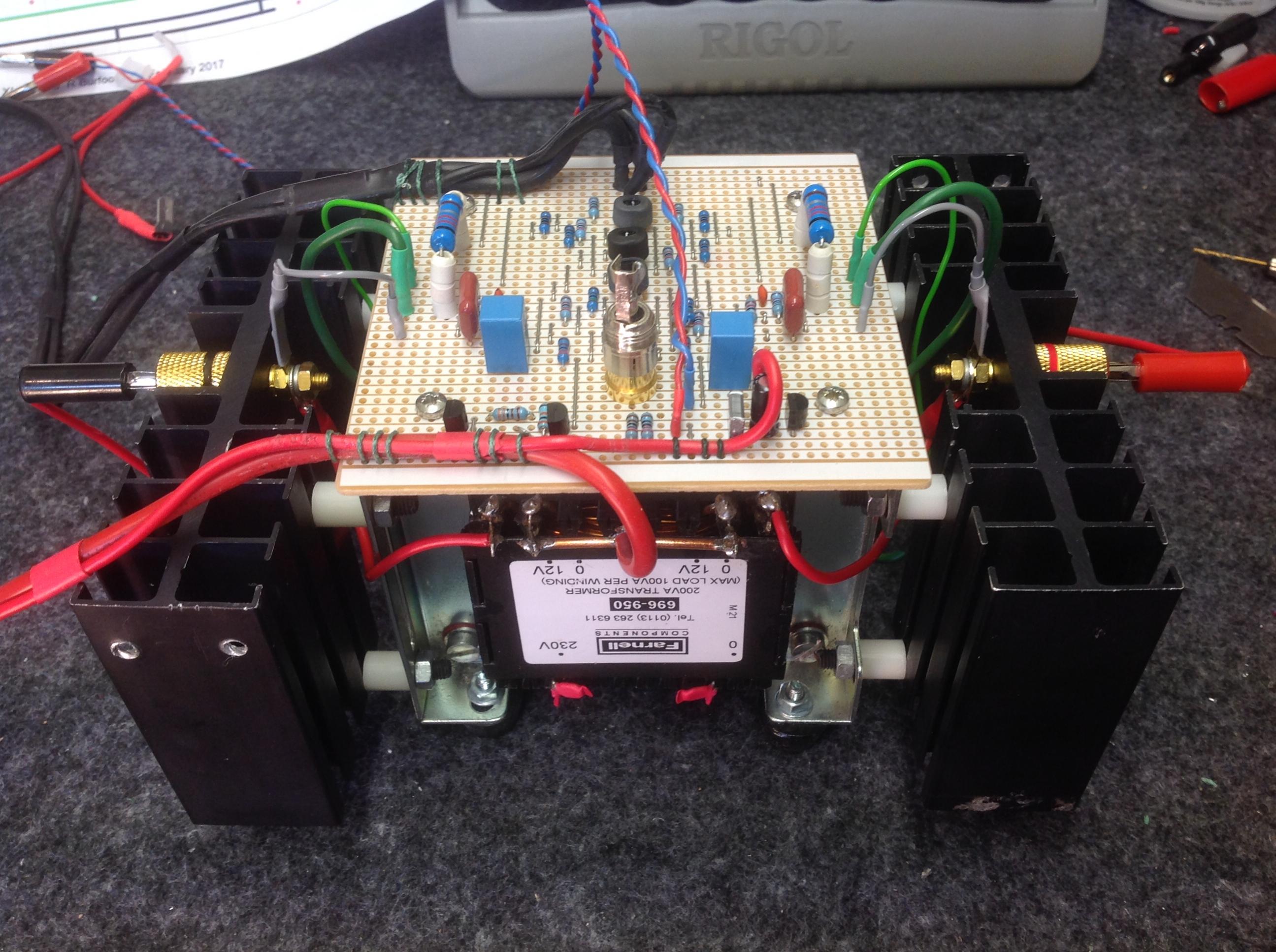

here is the latest version of my inductance loaded Class A amplifier:

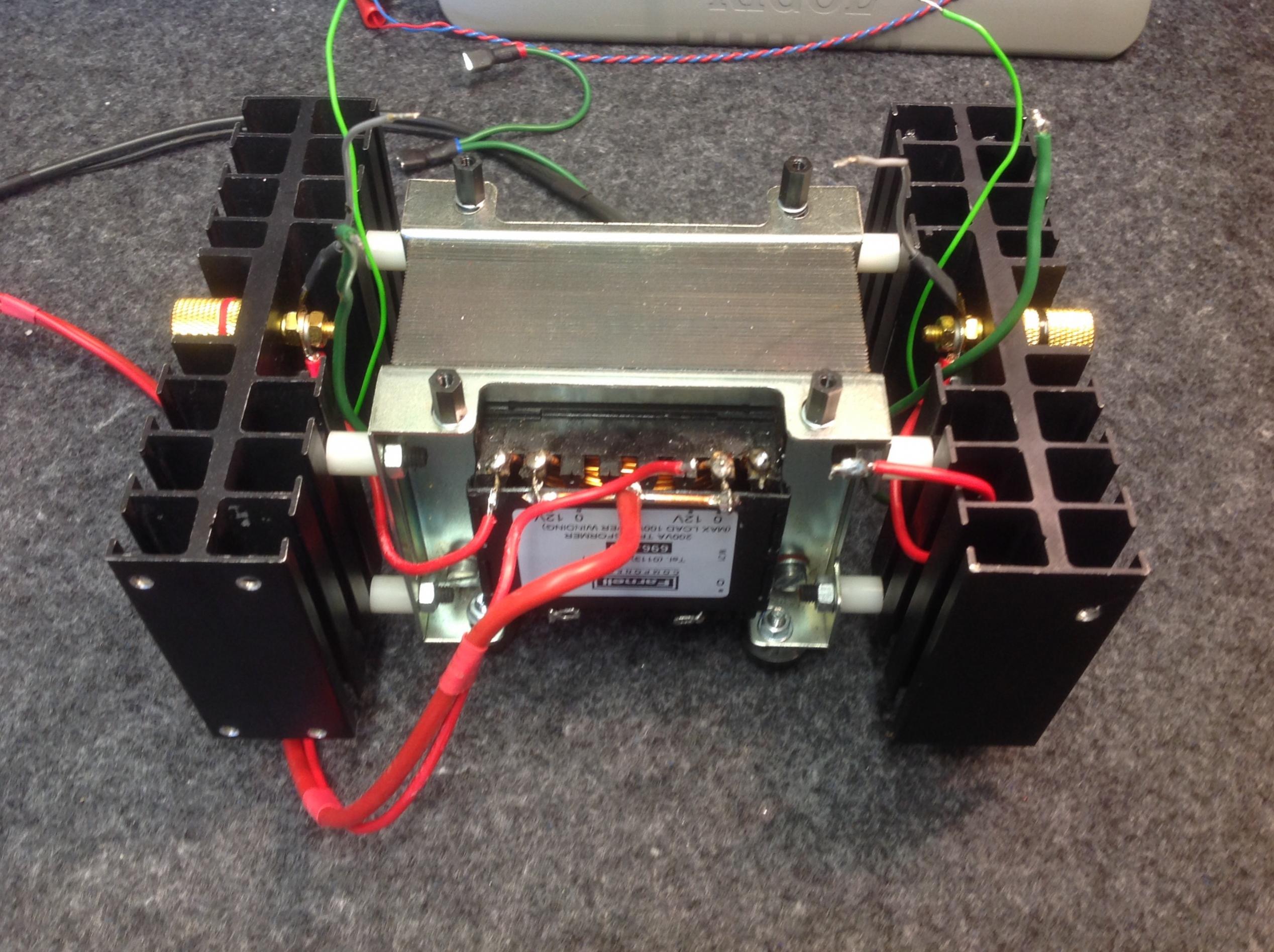

If you look closely you’ll see the transformer primary is taped up, that’s because I’m using it as an inductor, only the secondaries are used. It’s one of a pair BTW.
Here’s a board nearing completion:
I can’t remember why I took this one:
The heat sinks are ‘live’ - to avoid isolating pads - so they are secured to the inductor using plastic screws and stand-off’s.
Oh, I should say, from a 6V supply (I use SLAs), it produces 6W into 8 Ohms at 0.003% THD - according to LTSpice. I’m toying with the idea of reducing that to about 4W - not sure.

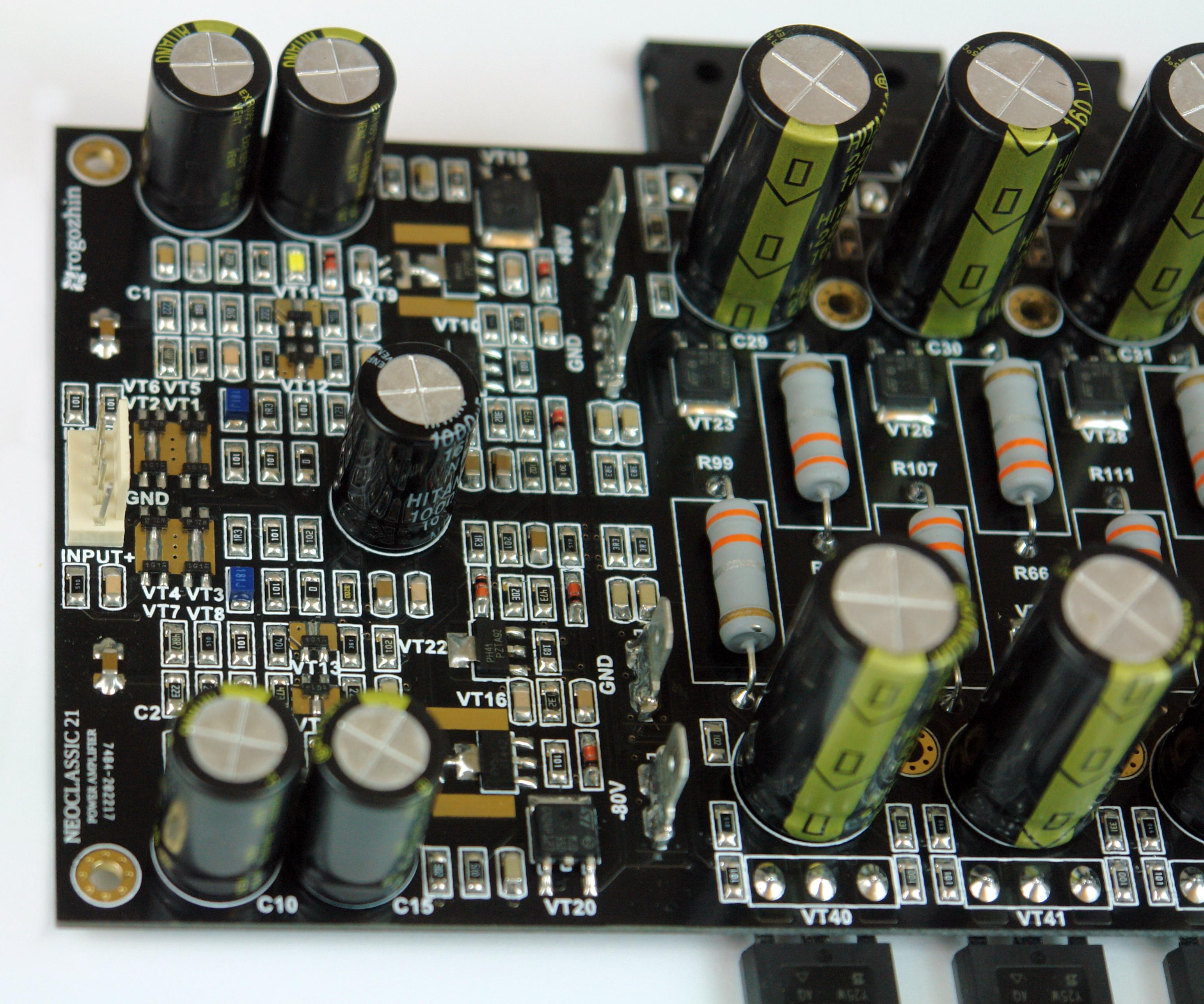

All parts work well because a 4-layer board with double copper thickness is used. No problem.
cmd resistors lie on a solid ground polygon, so the distributed capacitance effect works, image plane effect. There are no ground tracks and power supply, only signal tracks on the board.
805 size are usually 100mW or 125mW.operator16
