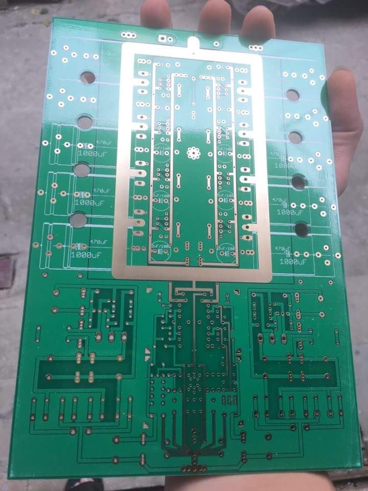

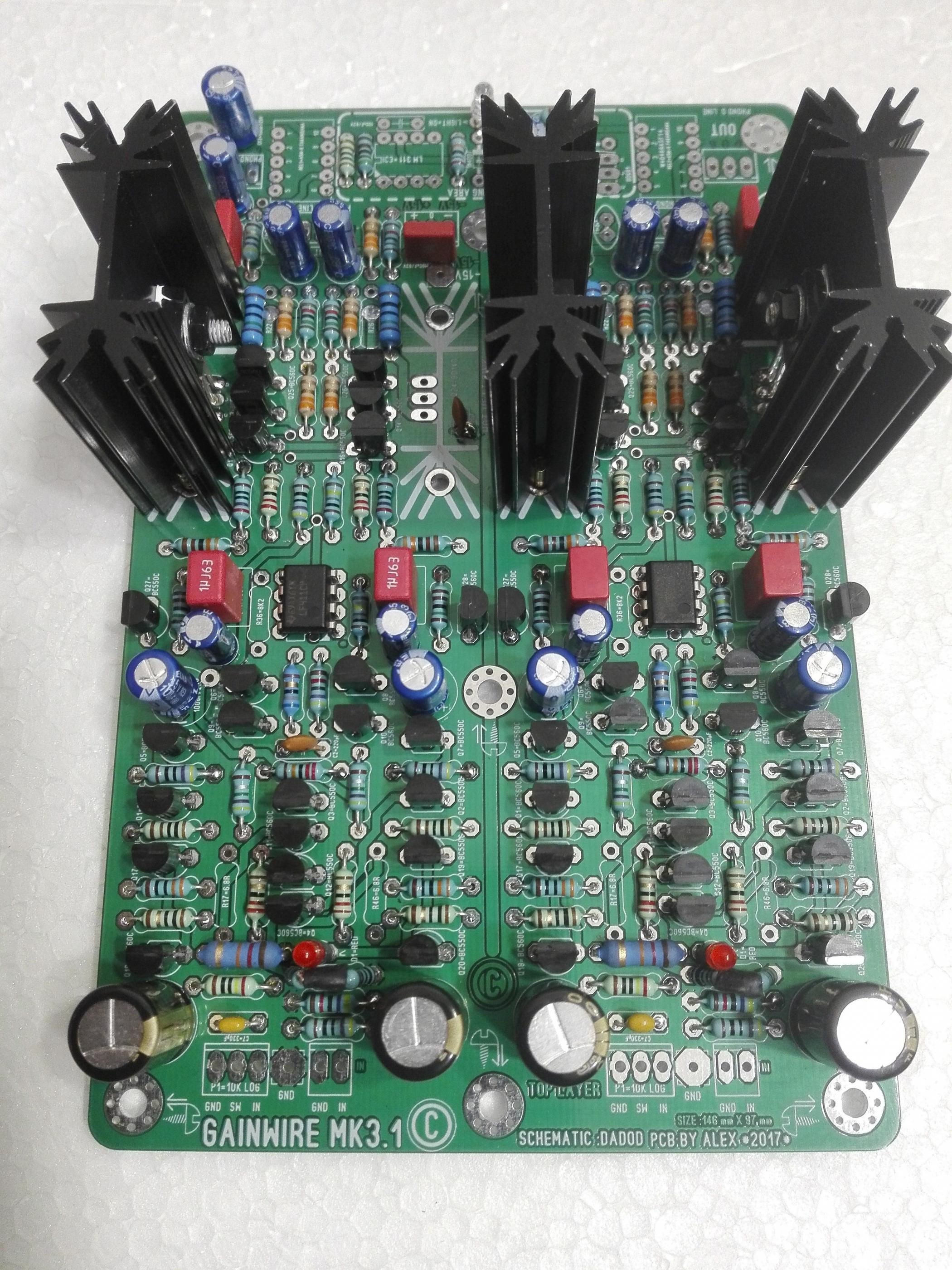

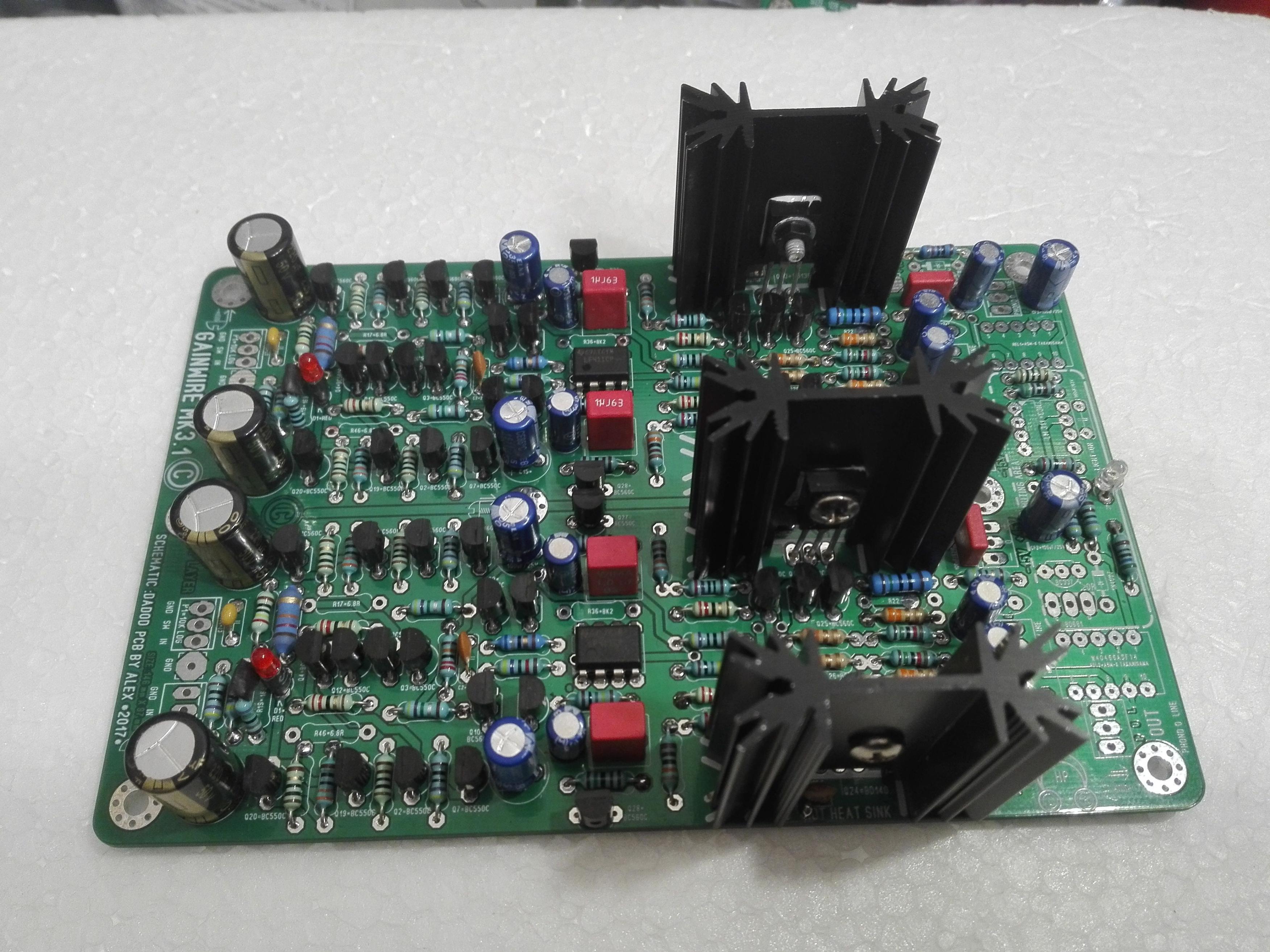

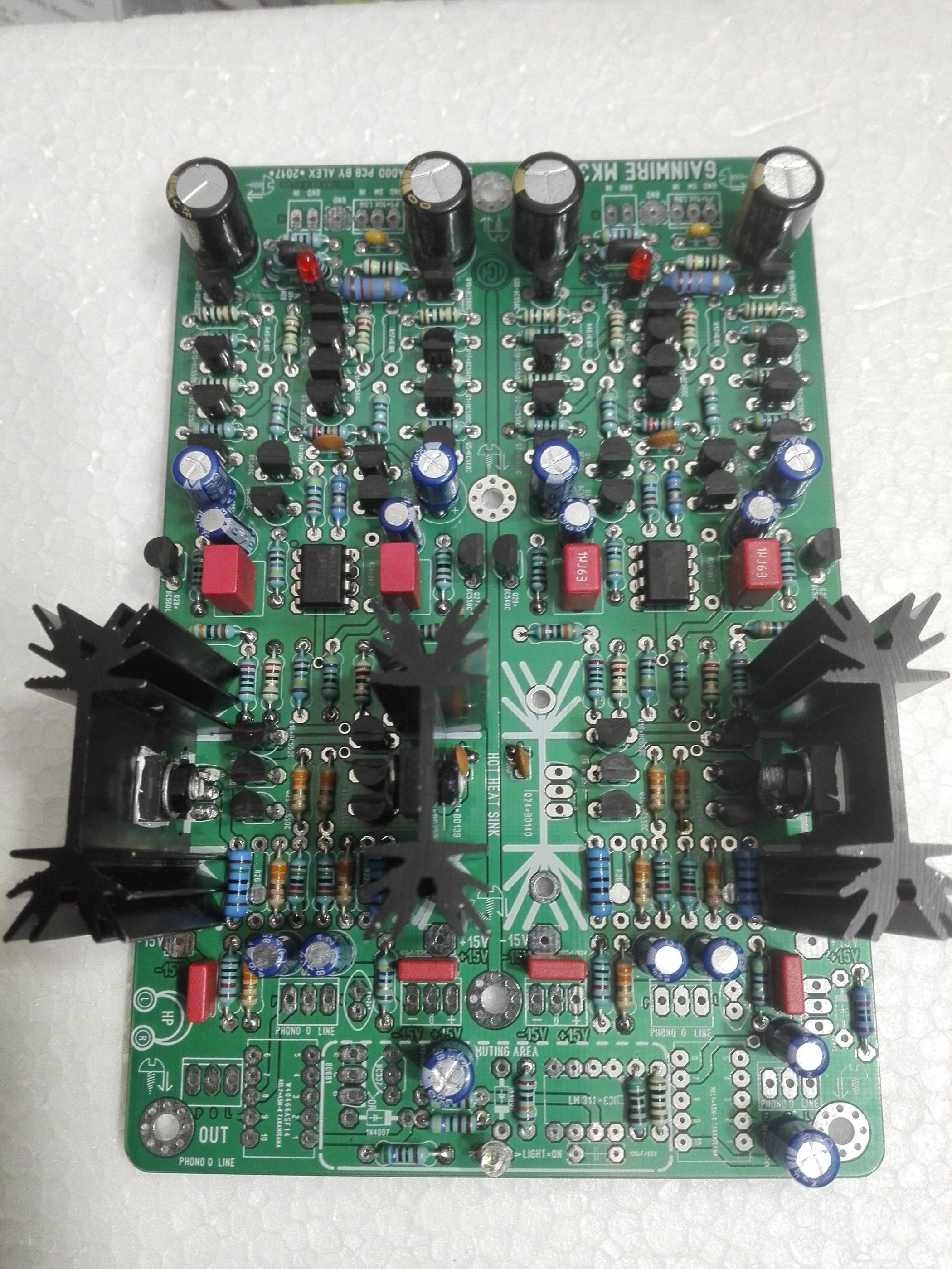

Gainwire 3.1 , work in progress 🙂

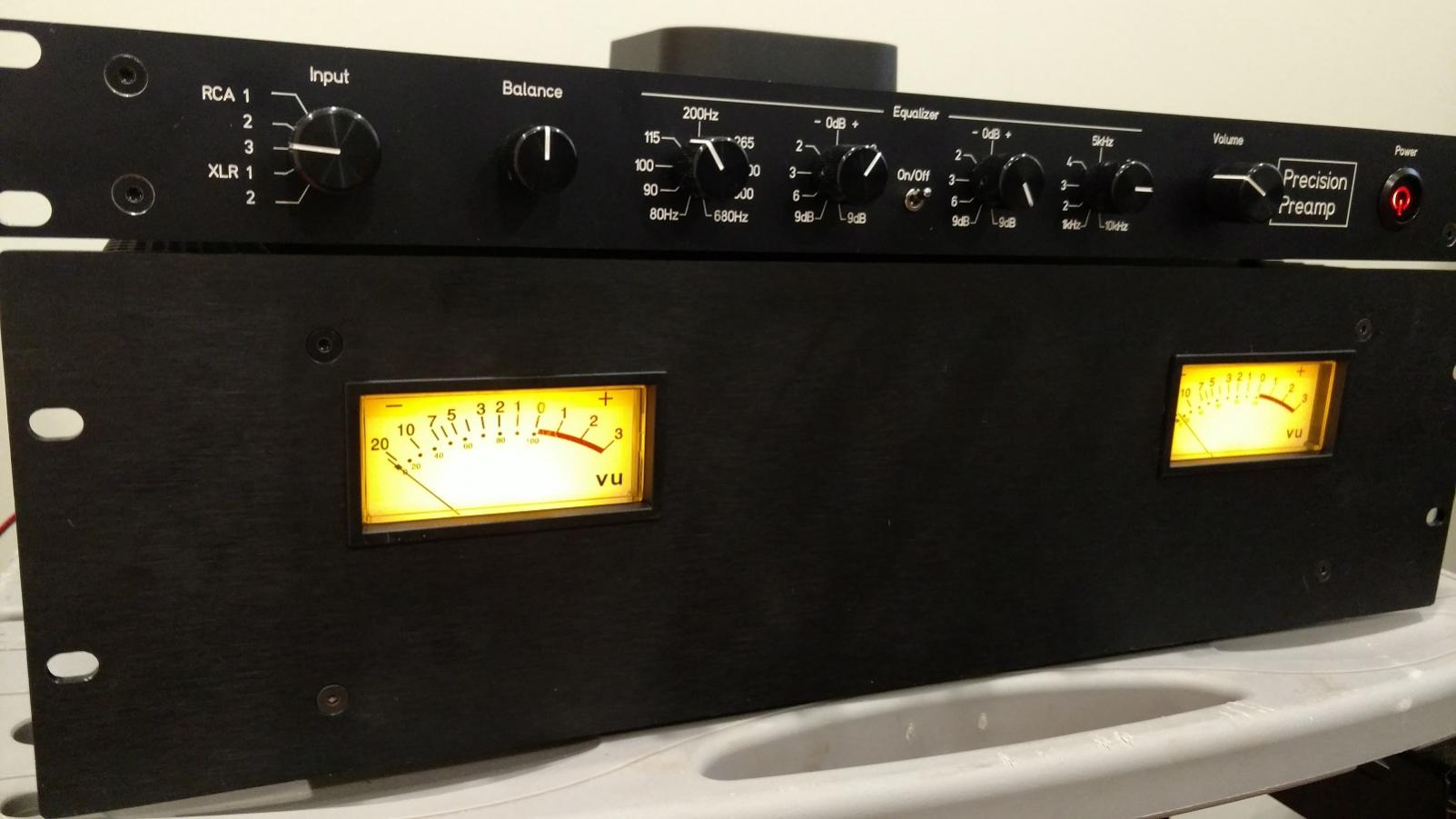

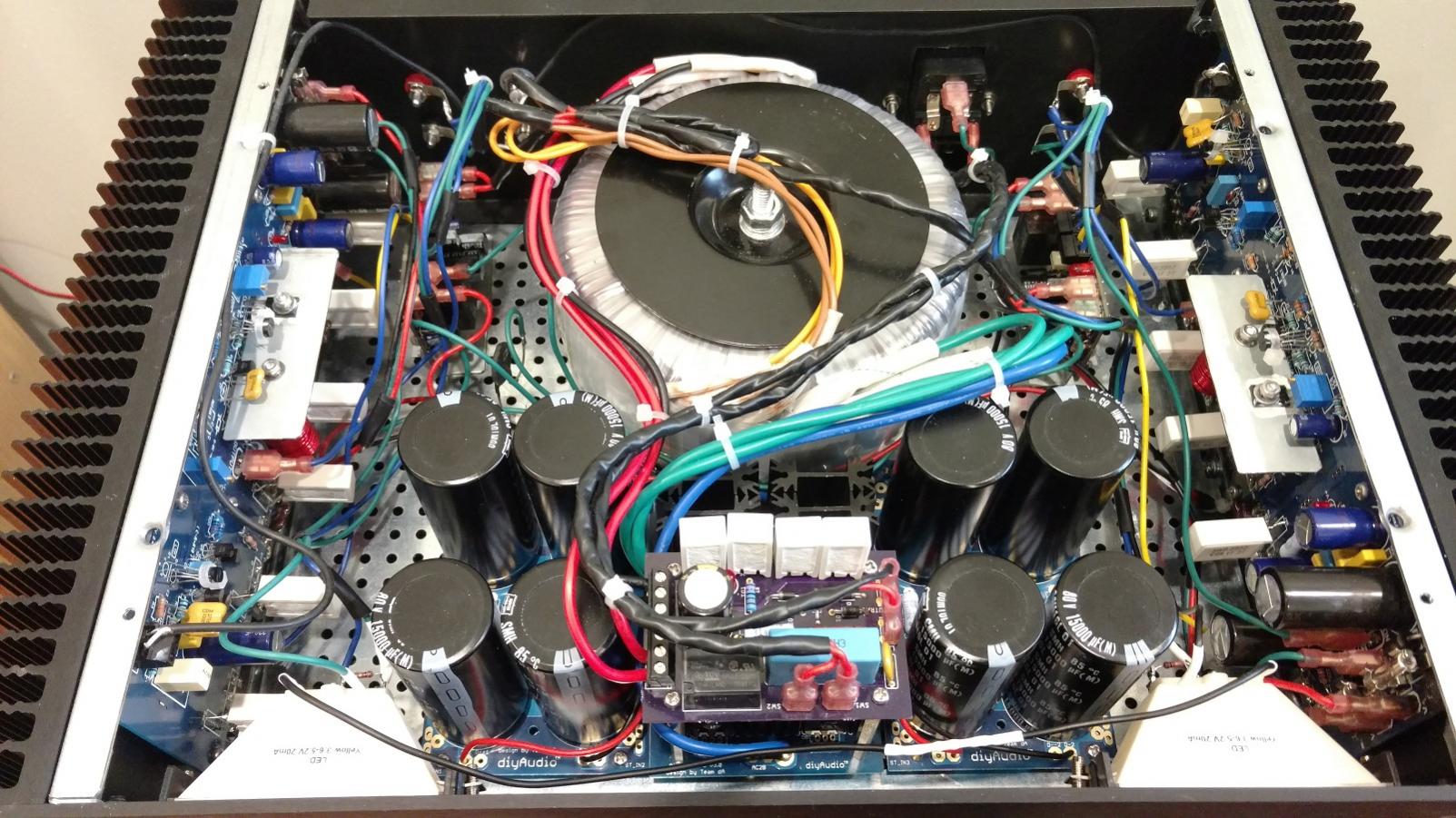

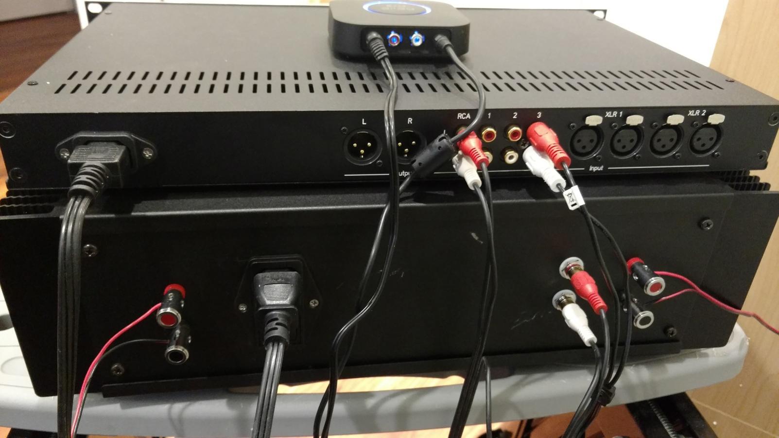

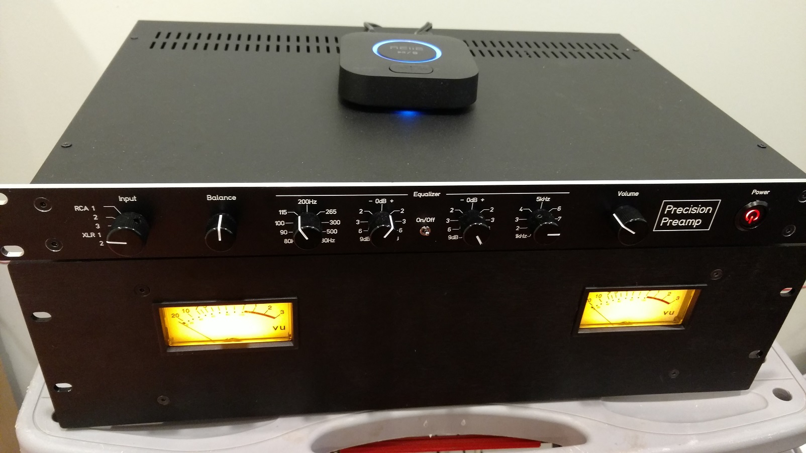

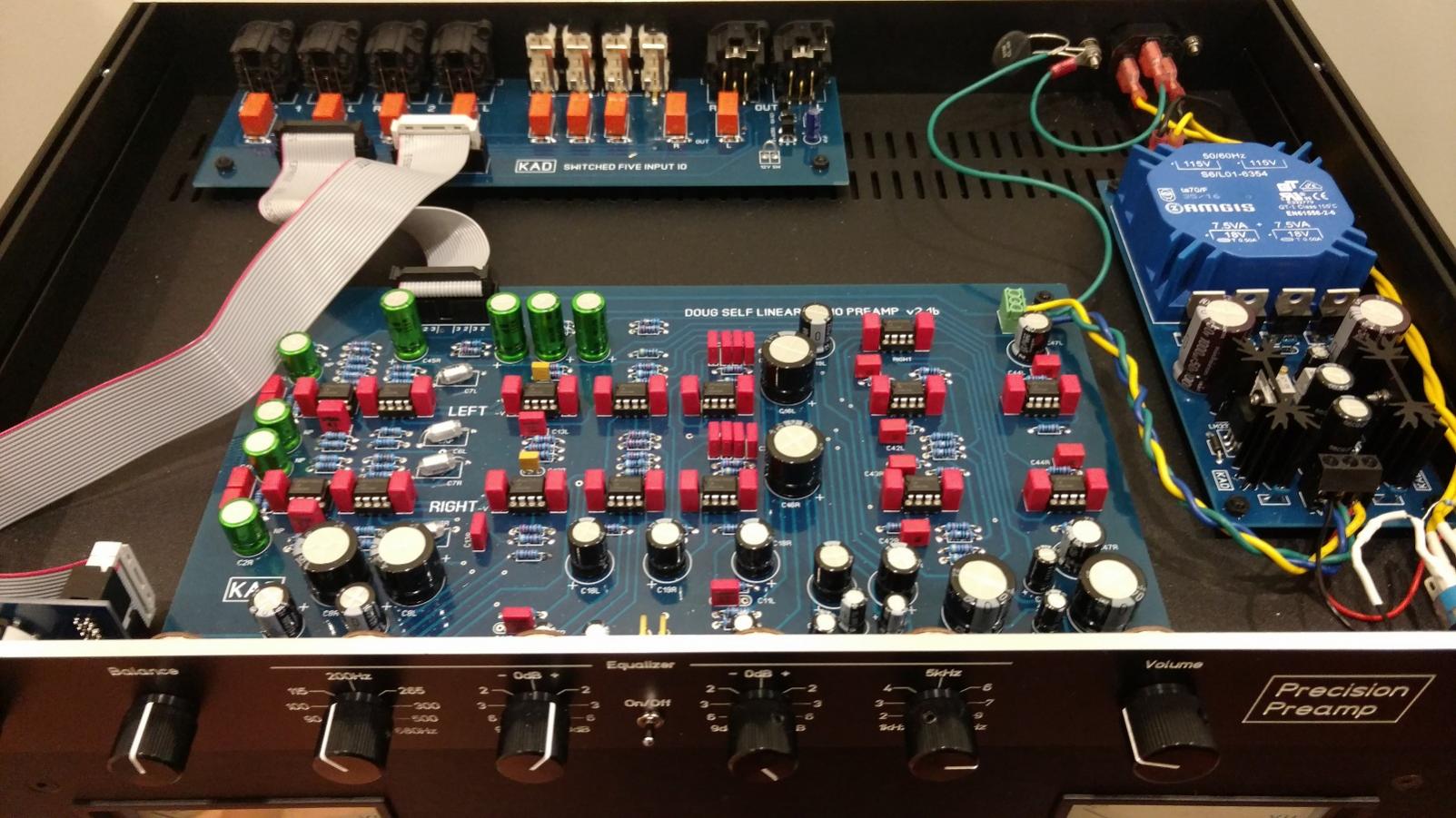

Honey Badger and Doug Self Preamp
Time to contribute back to community.
The power amp is a bit messy. The goal is to eventually free up room by installing an SMPS which will help me organize insides better.
The little box on top is a Bluetooth receiver (not my making). 🙂

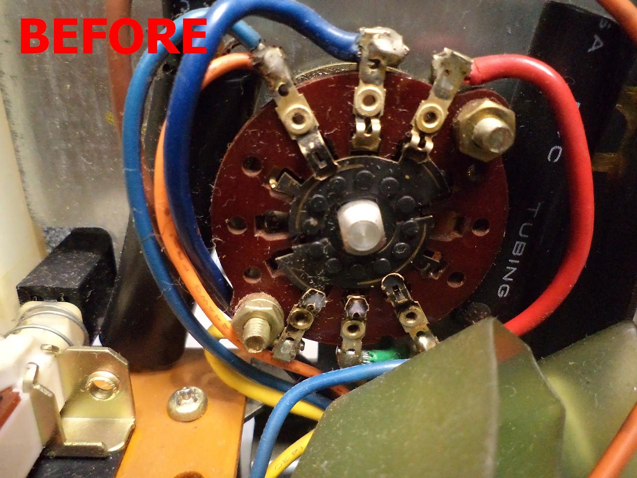

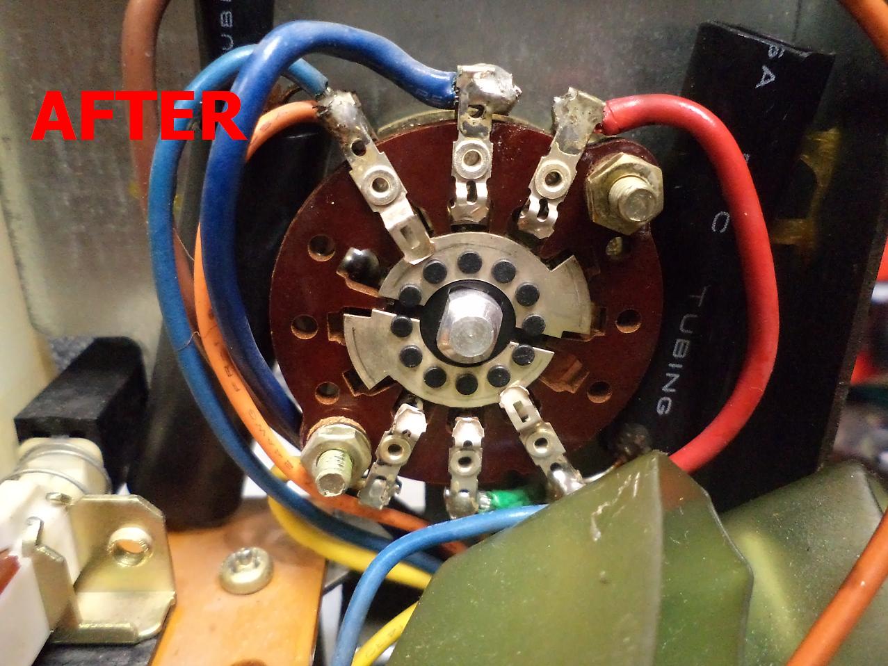

7) expect most of your switches to look like in this picture and you need to find a way to re estate them like ....in the other picture Likewise expect the critical trimmers on the amplifier board to look alike
8) Avoid spraying them ...Too much spray might increase crosstalk and leakage especially in the rotary input selector where except audio signal there is above 30V present to light up he front leds ...Mixing up these to signals might cause plenty of complications ...
If you like this amp and like to keep it alive there is no way around those you will have to do them all

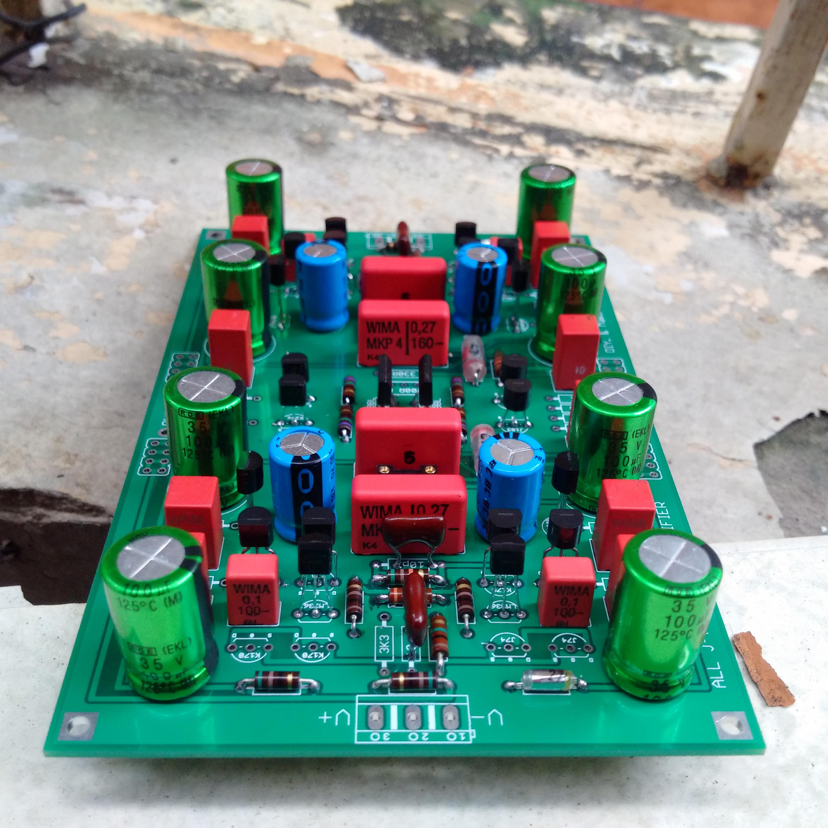

My 'all jfet class A I-V/Pream/Line Amp and Regu' (schematic from Erno Borbely)
