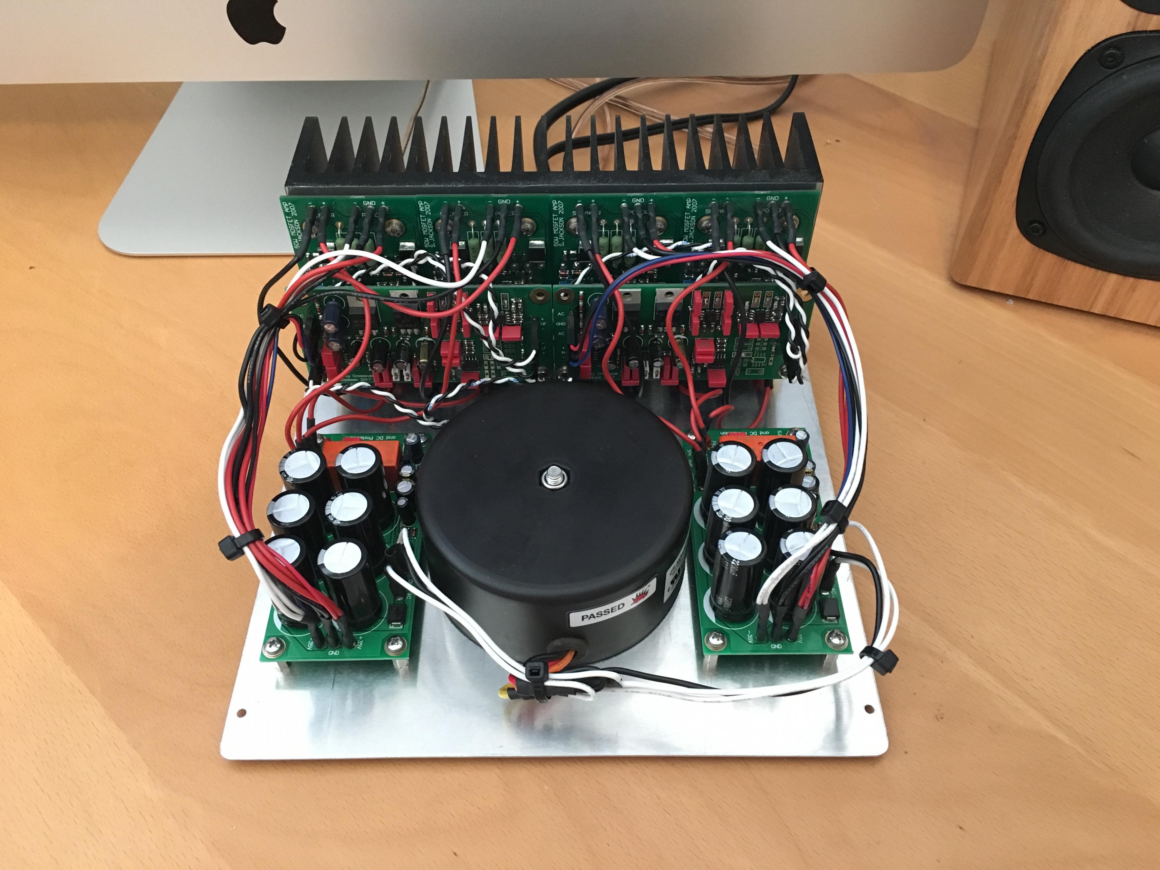

Just finished the amp for my computer speakers. Four 50W lateral mosfet monoblocks (aem6000 derived design), with two-way active crossovers. The two sides (woofer + tweeter) have independent rectifiers and filtering, but share a single transformer. The whole lot sits in a 20 x 20 x 9 box, made from aluminium and tassie Oak.
On the filter boards there’s a dc protect and anti-thump circuit. In use it tucks discretely behind my Mac, plugged into the headphone socket.

Clean build for something so compact. Well done - as usual!
You know what they say about a clean desk or work bench don't you? 😀
Is that an HP 3585 on your bench? Nice instrument, I use one as well.

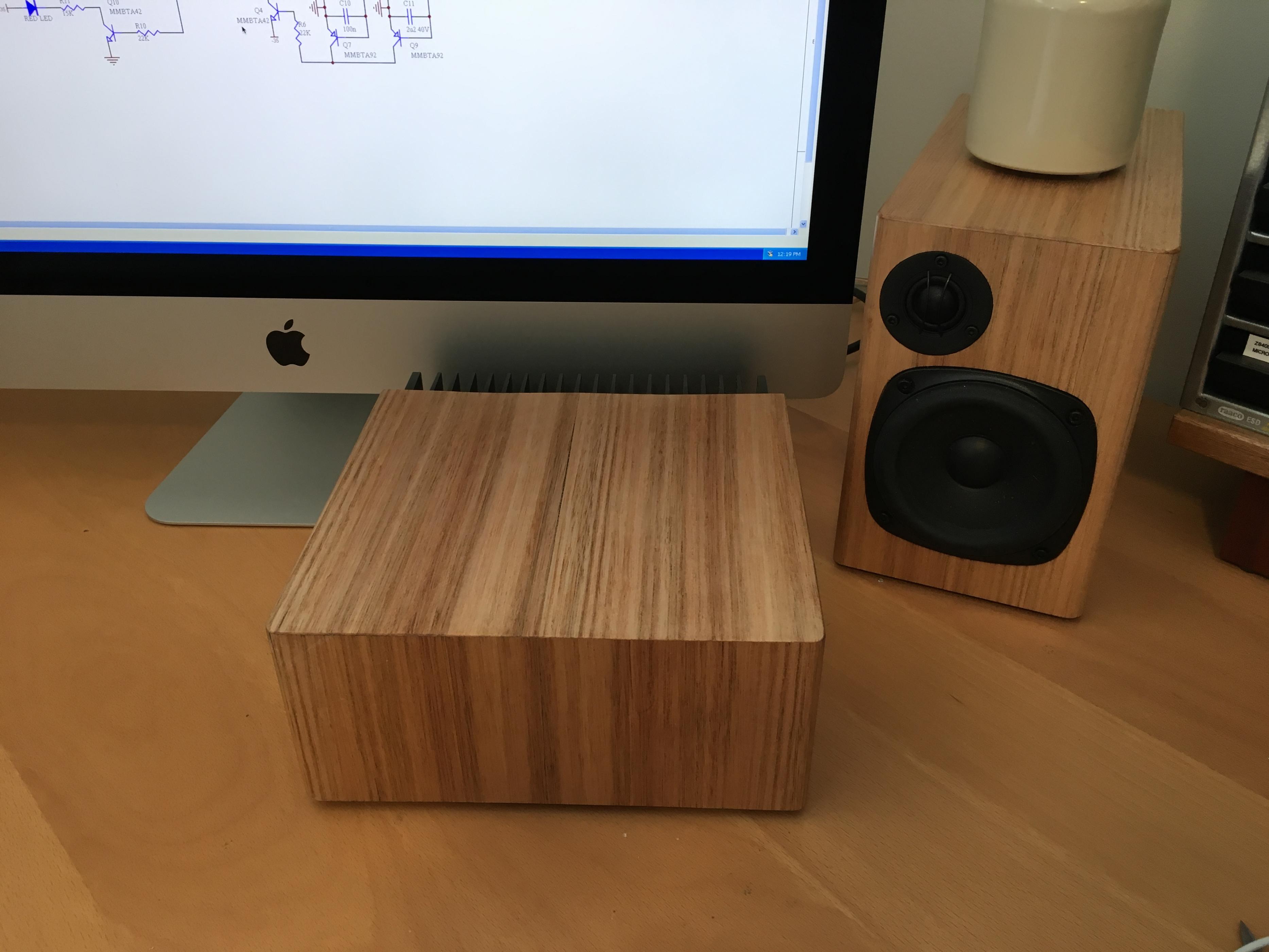

Don’t worry - the rest of the desk is a shambles. It is indeed a 3585b. Bloody lovely spectrum analyser, though I’ve gotta have a bit of a play with it as it keeps losing lock.

A compact and pretty looking amp you got there. It matches nicely with the speakers too. Well done!
