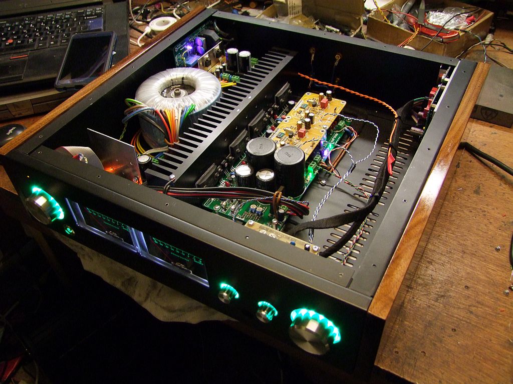

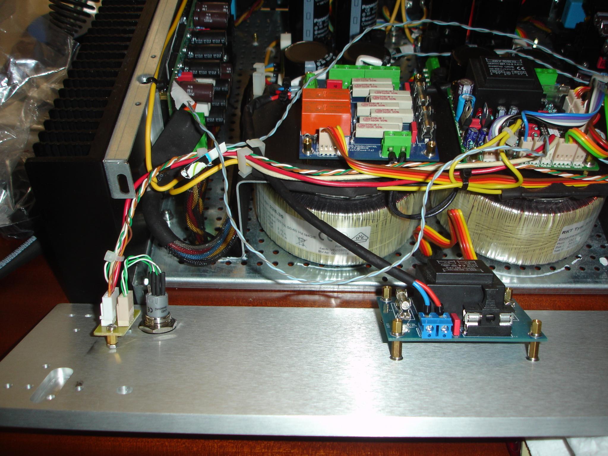

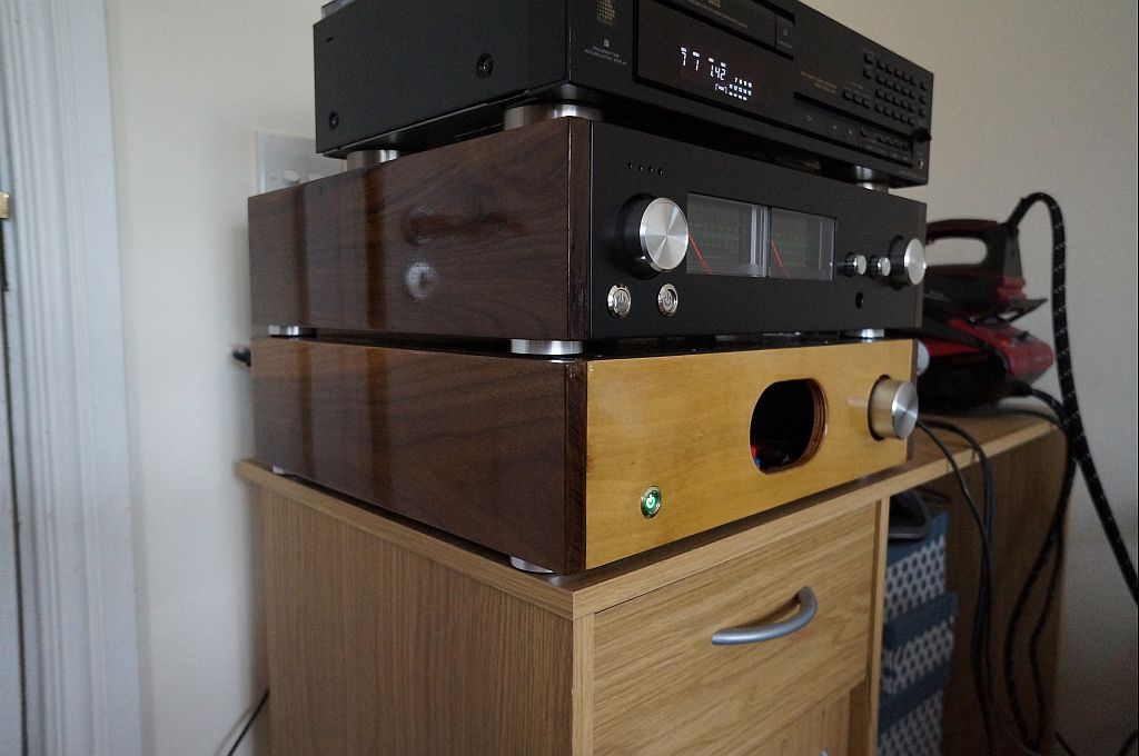

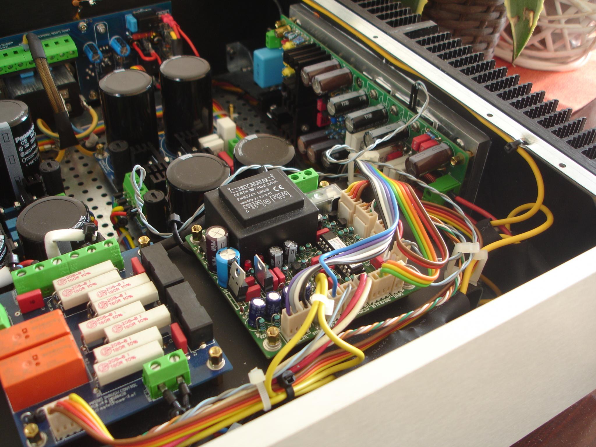

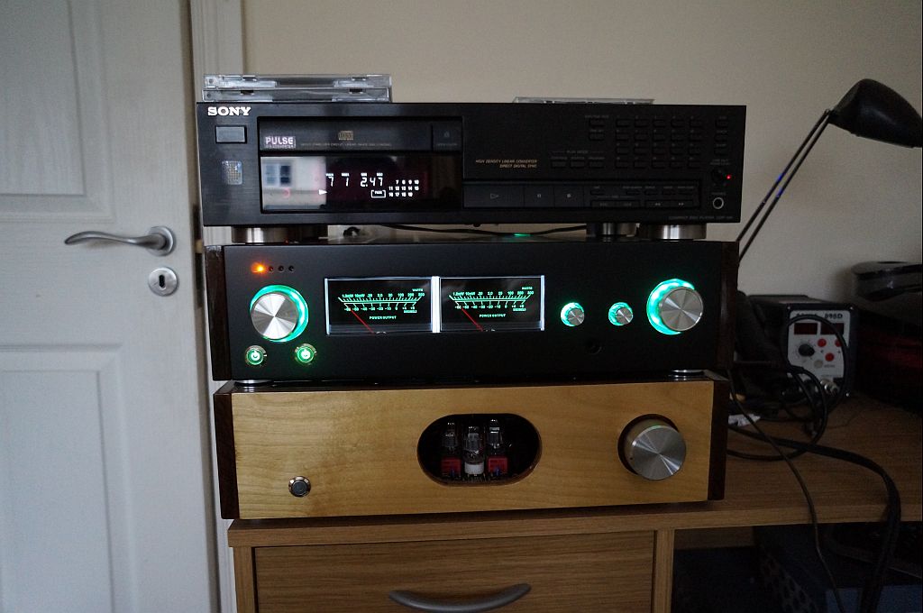

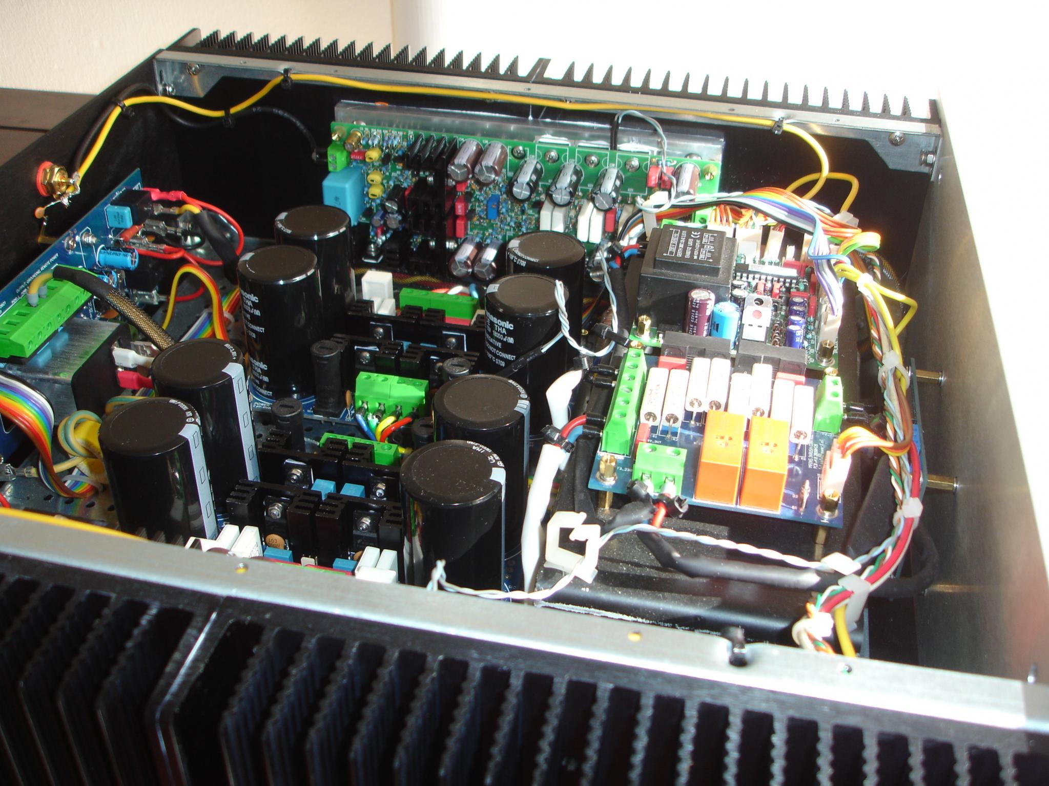

All stuff melted together, up and running. Stereo amp + log VU meter + headphone module + input selector + ak4490 DAC + tube PSU + soft start + DC blocker + 30% free space in enclosure.

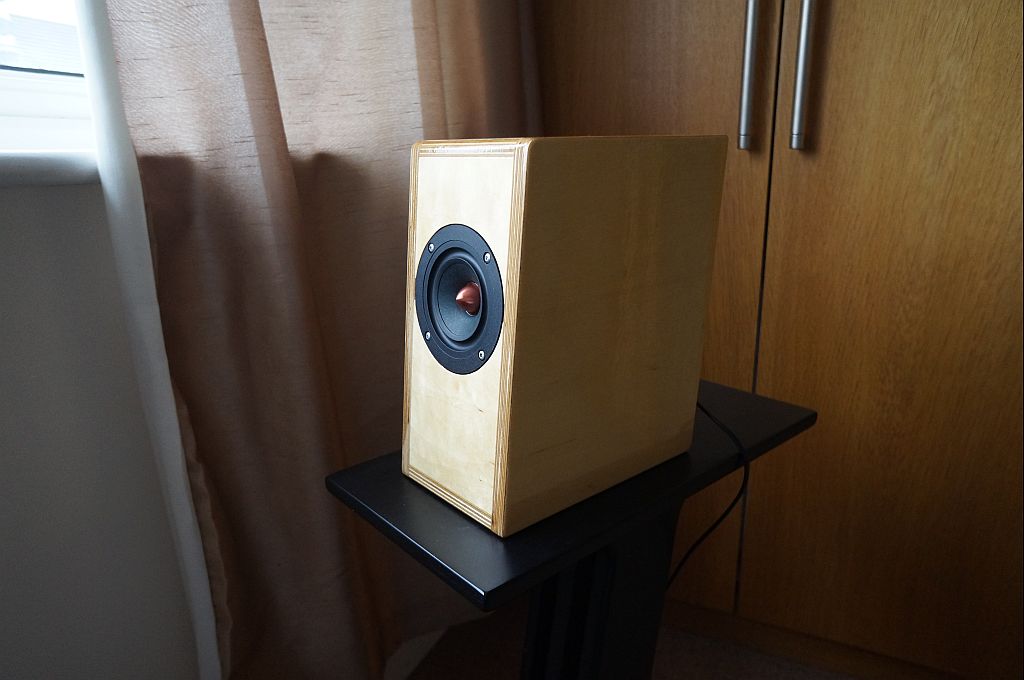

Couldn't resist and made quick 4L box for PS95 - small speaker with big sound.

Nice!All stuff melted together, up and running. Stereo amp + log VU meter + headphone module + input selector + ak4490 DAC + tube PSU + soft start + DC blocker + 30% free space in enclosure.
Regards
I like the DAC integrated in an amplifier.😎
What is the controller?
SA2015 VMOS

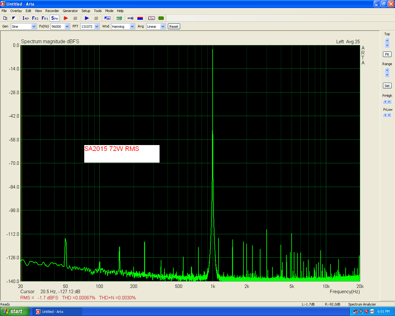

What is inside and how this measured.😉

Input selector controller is simple 4 position rotary switch (but can be raplaced with some remote controll too).
Nice dual mono setup there, Plenty work with enclosure, like it a lot.

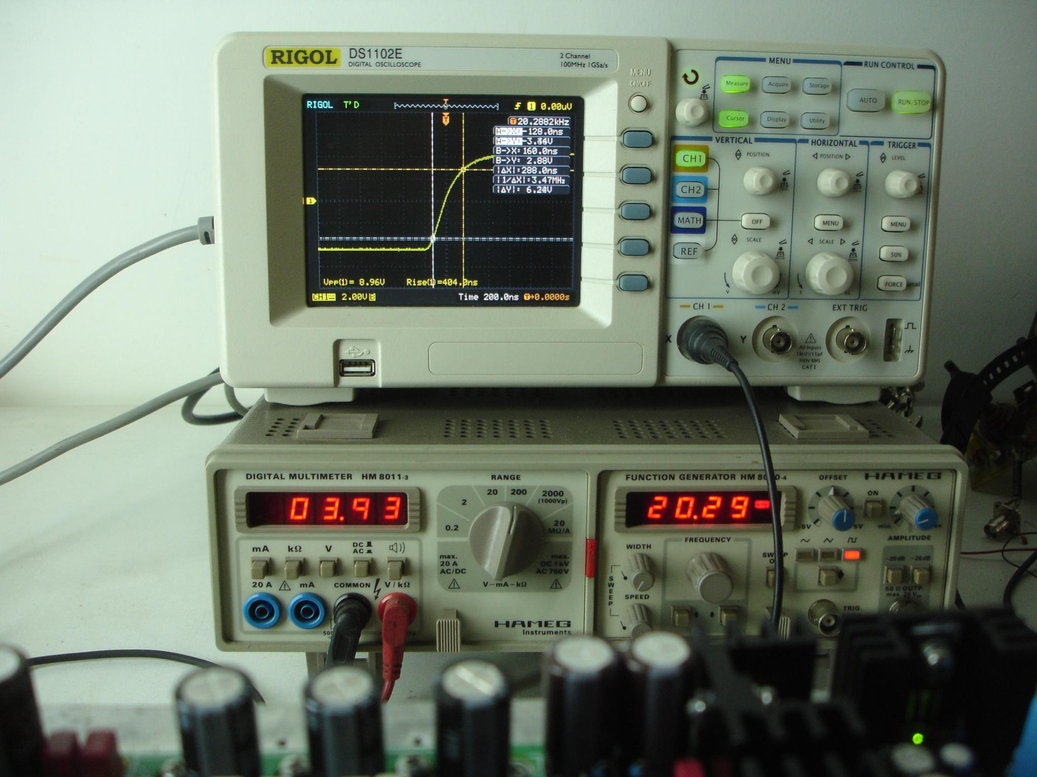

SA2015 slew rate > 100Vus
power bandwith limited by RF input filter.
More details here:
2stageEF high performance class AB power amp / 200W8R / 400W4R
BR, Toni
Here, what it is the RC component of the input filter ?
It's a joke of course 🙂 Input filter 1st order with R-470ohm and C-220pF can not degrade rise time from 100V/us to 21V/us.
If you want discuss SA2015 then this may be the wrong thread.
Where have I said, that the RF input filter reduces the slew rate?
Thimios measurement was from a small signal 20kHz output with 8Vpp after pi zobel filter.
Have a look at my "2stageEF..." thread post #1386. Measured after pi zobel 8R load fullpower with all protection features in situ.
BR, Toni
