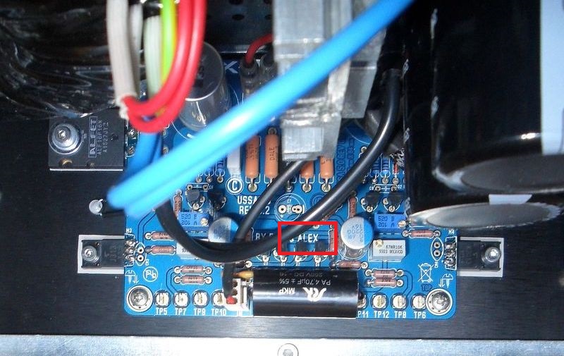

Yes you right , so please erase my name from your PCB , and please forgive me for impertinence .
Hi Alex
In fact this blue colour pcb (v0.2) that you show is your layout. It is different from
the black colour version (v0.4) which is the revised layout from Project16.
Thanks again for your initial layout which is also fine and used.
Fab
Fab
There is no problem Alex and I do not see any impetinence, it is normal to defend his work and in addition I learned a lot of tricks on Sprint Layout thanks to you.Hi,
Yes the blue pcb in my USSA-5 is your excellent job. 😉
I did not understand all the questions because the online translator gives me anything.

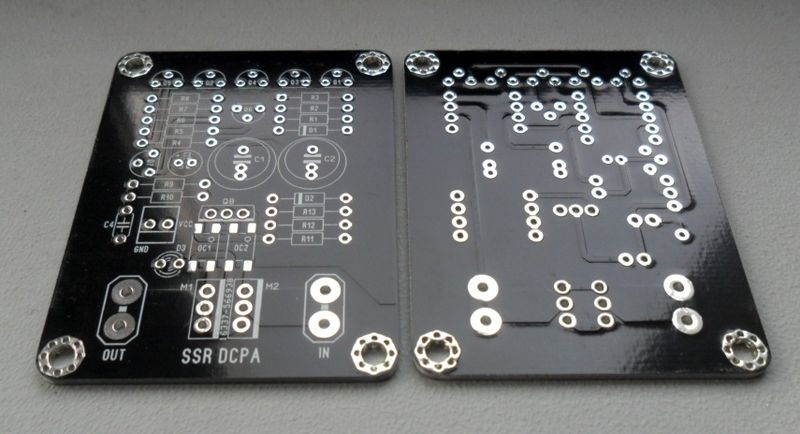

New 50W SECA PCB layout.
